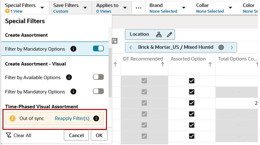

Out of Sync Special Filters
Planners may need to apply a manual show or hide over special filter result for analyzing the data. In such case, an out of sync alert is highlighted in the Special Filter drop-down list. This helps you to highlight that there has been manual show or hide applied over the special filter result.
You can see the out of sync alert icon i highlighted on the Special Filter header. Click the Special Filter drop-down to see an Out of Sync alert at the bottom of the list with a Re-apply Filters link. To revert back to the special filter result, click the re-apply filter link which re-evaluates the filter and hides the manual show or hide updates.
With the manual show or hide applied over the special filter result and you move the page edge scroll to another page, the special filter result will not re-evaluate. In such a case, an out of sync alert is highlighted in the Special Filter drop-down list. You can choose to work with the selection or click the Re-apply Filter link to re-apply special filter.
Figure 13-7 Out of Sync and Reapply Filters Link

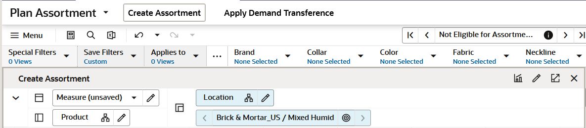

Attribute Filters
Some applications support business practices that are heavily attribute driven. For these applications, the user may want to examine products organized by their attributes instead of products organized by their regular hierarchical structure. Attribute filters can be used to filter by any number of attributes on the fly in order to quickly and efficiently target specific information. Attribute filters are helpful in cases when a user wants to retain the traditional product roll up scheme but simply filter the set of visible positions to those that meet certain attribute-based requirements.
Figure 13-8 Attribute Filters
Attribute Filters
The filtering of positions based on attributes can be done through the Edit View show/hide position functionality but the attribute filters provide an easy and a convenient way and are simple to initiate and clear.
Attribute filters are present, along with the special filters, in the workspace Filters bar and can be used to apply, modify, and remove position filters based upon the attribute values of the positions.

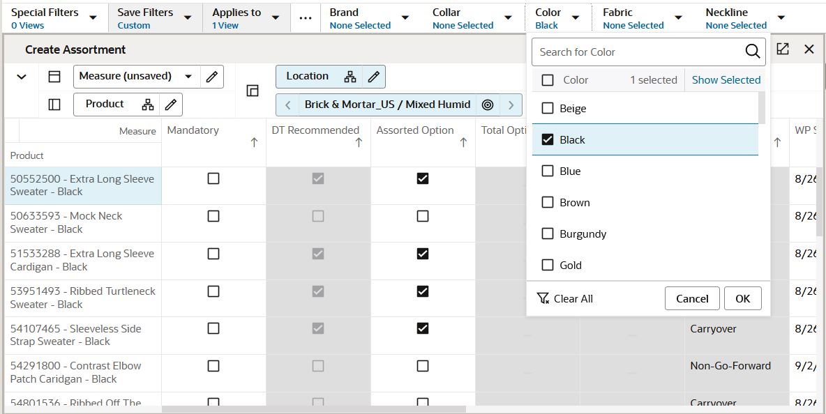

Applying Attribute Filters
You can select the views that the selected attribute filter must apply to: either one view, a number of views, or all views under the tab. Click OK to run the attribute filter. Once the attribute filter is applied, the positions that do not match the criteria are hidden. You can verify the positions using Edit View to view the positions in the hidden area. Any positions that were manually hidden previously will be unhidden if they match the attribute filter.
Figure 13-10 Apply Attribute Filters
When the attribute filter is turned on, a filter icon is applied to the view in the view management drawer. Attribute filters operate by filtering the positions of the dimensions on the row or column axis, based upon the selected attribute of one or more dimensions.

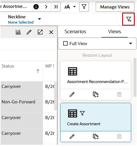

Clear Workspace Filters
To clear all the workspace filters applied, click the Filter icon that is located on the Quick Access Toolbar, and then click Clear All.
