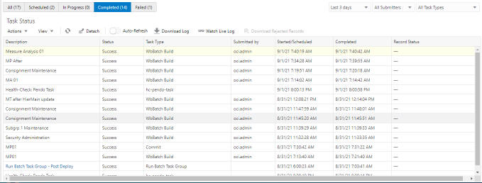

The user can access the log files using the Task Status Dashboard, shown in Figure 20-1.

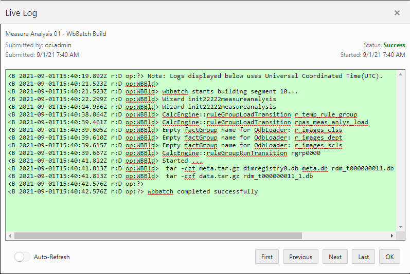

If the user highlights a particular task, the buttons Download Log and Watch Live Log will be enabled. Click Download Log to start a download process that will download the complete task log. Click Watch Live Log to see a pop-up showing the beginning of the log, as shown in Figure 20-2.
The window displays the first section of the task's log. Click Next to display the next N lines of logs. Use First and Last to show the current first or last section of the log.
If the task has not yet finished, the user can enable the Auto-Refresh slide control; the display will then automatically refresh every few seconds to show the latest logs, including the database logs for the task.
