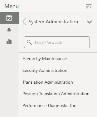

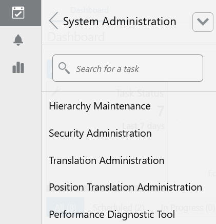

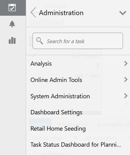

  1. On the main page, click Tasks, then select Administration. The Administration group appears.
  2. In the Administration group, select System Administration.
    Figure 4-2 System Administration
    Description of Figure 4-2 follows
    Description of "Figure 4-2 System Administration"

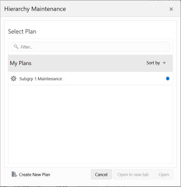

  3. In the System Administration group, select Hierarchy Maintenance. A plan dialog box appears.
    Figure 4-3 Hierarchy Maintenance
    Description of Figure 4-3 follows
    Description of "Figure 4-3 Hierarchy Maintenance"

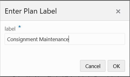

  4. Click Create New Plan to create a new segment. If it is the first segment, the dialog box for entering the label will appear. Otherwise, click Create New Plan, as shown in Figure 4-4, to enter the label for the new segment.
  5. Provide a label for the segment.
  6. A wizard page appears to select the custom dimension to maintain. Select a custom dimension and click Next.
  7. Select the positions to be included into the segment and click Finish.

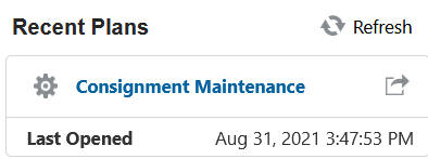

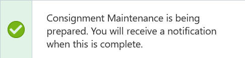

  8. The RPASCE server processes the request. Upon completion, a notification will be sent to the user interface, as shown in Figure 4-6 and a link to open the segment will be available in the Recent Plans box, shown in Figure 4-7.
    Figure 4-6 Recent Plans Notification
    Description of Figure 4-6 follows
    Description of "Figure 4-6 Recent Plans Notification"
    Figure 4-7 Recent Plans Segment Link
    Description of Figure 4-7 follows
    Description of "Figure 4-7 Recent Plans Segment Link"
  9. Click the link to open the segment.

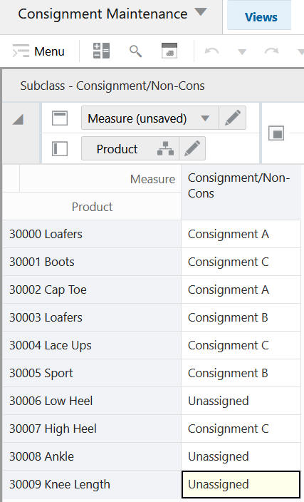

The Hierarchy Maintenance view displays the position assignment fields for the selected custom dimension. Edit the cells associated with the custom dimension as required.

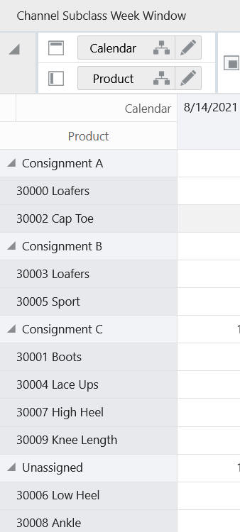

Returning to the example dimension Consignment: You want to classify each selected subclass in your segment as either a Consignment A, a Consignment B, or a Consignment C. This example provides only three positions, or values, in the Consignment dimension; however, you can enter any character string in an individual subclass's Consignment cell. This new string is treated as a separate user-defined grouping. If this is the first time a particular subclass has been mapped to the Consignment dimension, the label assigned to that subclass will not yet be defined. The Consignment field is automatically filled with "Unassigned."
Assign labels to each product with regard to the Consignment dimension. In the following example, products that were previously Unassigned are now designated as Consignment A, B, or C.
Figure 4-8 Hierarchy Maintenance View
Description of Figure 4-8 follows
Description of "Figure 4-8 Hierarchy Maintenance View"
The RPASCE system is case sensitive when a new position label is entered in the Hierarchy Maintenance segment. After the segment is committed, the typing of the group name is not case sensitive. For example, Consignment B can later be entered as consignment b after the Consignment B group label has been committed.
After making the Consignment A, Consignment B, or Consignment C designations for the selected subclasses, you must calculate and commit the segment for any changes to take effect.
For this example, labels have now been assigned to the various positions within the Consignment/Non-Cons dimension, and selected products in the product hierarchy have been classified with regard to the custom dimension.

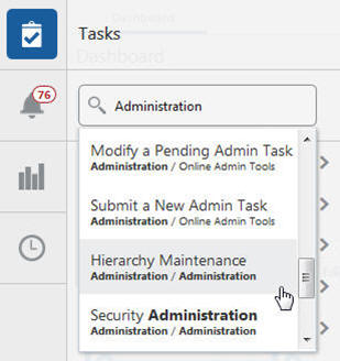

  1. In the taskflow, select Administration. The Administration activity appears with all the subtasks.
  2. Click Hierarchy Maintenance.

    You can also open the segment from recent plans.
  2. Click System Administration.
  3. Click Security Administration.
  4. A new segment is created, and a notification is issued. If the segment already exists, the existing workbook associated to the segment is re-opened. You can also open the segment from recent plans.

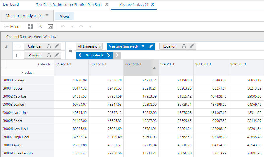

The Measure Analysis view allows the user to view the chosen measure data for the positions selected from the measure's associated hierarchies. Each Measure Analysis view is displayed at a different dimensional intersection, depending on the measure selections made in the wizard. This dimensional intersection is shown in the view title bar.
Figure 4-15 Measure Analysis View Example
Description of Figure 4-15 follows
Description of "Figure 4-15 Measure Analysis View Example"
Figure 4-15 shows a Measure Analysis view that displays Sales data for several items in a particular store. The location/product/calendar dimensional intersection of this view, as shown in the title bar, is SubClass, Channel, WEEK. The Sales measure, because it is registered as a read/write measure, can be edited in this view. However, only an administration user can commit overwrites to writable measures in this workbook.

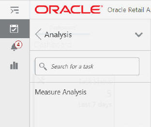

  2. Click Measure Analysis.

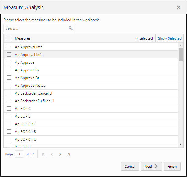

  3. The segment dialog box opens. Select Create New Plan and enter the label of the segment.
  4. A Measure Analysis Wizard window appears. Only measures that are accessible to current users and have the insertable property set to true are displayed. Select the measures to be included in the workbook.
    Figure 4-18 Measure Analysis Wizard

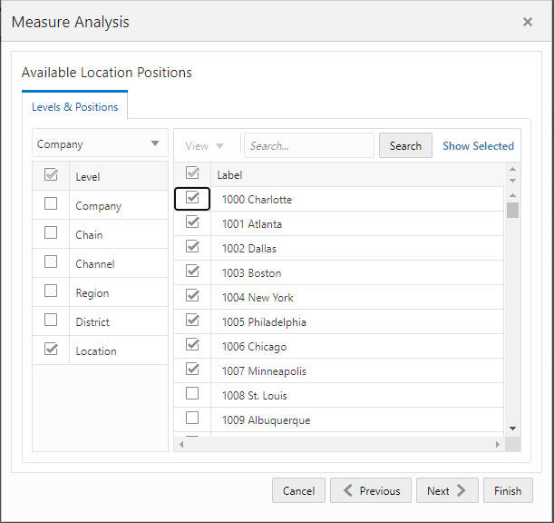

  5. Based on the common base intersection of all the measures selected., a sequence of Hierarchy Selection wizards is displayed. Use these wizards to select the positions to be included in the workbook. The Location Selection wizard (as an example) is shown in Figure 4-19.
    Figure 4-19 Location Selection Wizard
    Description of Figure 4-19 follows

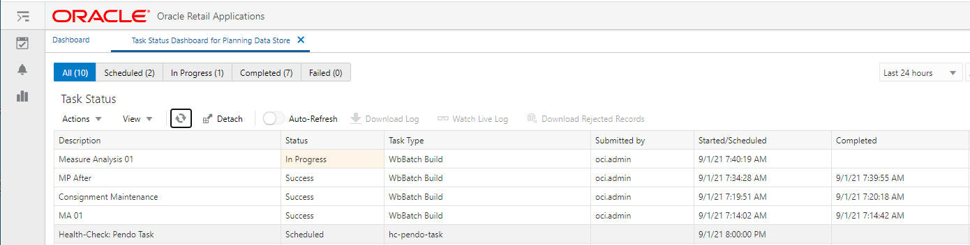

    Description of "Figure 4-19 Location Selection Wizard"
  6. Use the wizards to make the appropriate selections and click Finish. A segment is created, as shown in Figure 4-20.
    You will receive a notification once the segment is built. You can open it from Recent Plans, as shown in Figure 4-21.
  7. Click the segment name to open the newly created Measure Analysis segment. The segment has one window per intersection, named with the level names. All measures that have the same base intersection will be added into the same window.
    You cane edit the measure at the base level if the measure's base state is Write and at the aggregated level if the measure's agg state is Write, provided a valid defSpread method has been configured.
  3. The segment dialog box opens. Select Create New Plan, and enter the label of the segment. A Measure Analysis Wizard window appears.

  4. In the Workbook Wizard window, select the measures you want to include in the new workbook. You can use the Search field to filter the list of items if it is available. Use the check boxes to select items or use the All options to select or deselect items in the multi-select list.
  5. Click Next. Based on each hierarchy specified in the base intersection of the selected measures, a hierarchy wizard appears.
