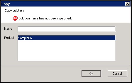

Copy a Solution
Complete the following steps to copy a solution.
  1. Select the solution to be copied.
  2. Right-click in the Configuration Components pane and click Copy. The Copy solution window opens.
    Figure 4-2 Copy Solution Window
    Description of Figure 4-2 follows
    Description of "Figure 4-2 Copy Solution Window"
  3. Type the new name for the solution in the text box.
    This is the name that the solution is called after it has been copied.
  4. Select the project where the solution is to be copied.
  5. Click Finish to save the copied solution in the specified project.

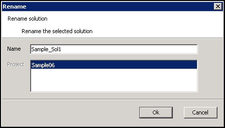

Rename a Solution
Complete the following steps to rename a solution.
  1. Select the solution to be renamed.
  2. Right-click in the Configuration Components pane and select Rename. The Figure 4-3 opens.
  3. Delete the old name from the resulting field and type the new name.
  4. Click OK to save the new name.

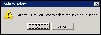

Delete a Solution
Complete the following steps to delete a solution.
Select the solution to be deleted.
Right-click in the Configuration Components pane. The Figure 4-5 opens.
Figure 4-5 Confirm Delete Window
Description of Figure 4-5 follows
Description of "Figure 4-5 Confirm Delete Window"
Click OK to complete the deletion.

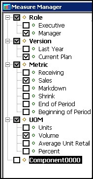

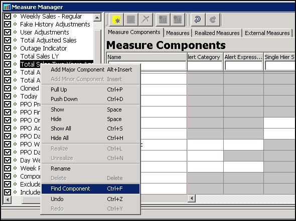

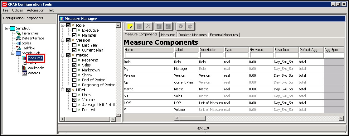

Measure Manager

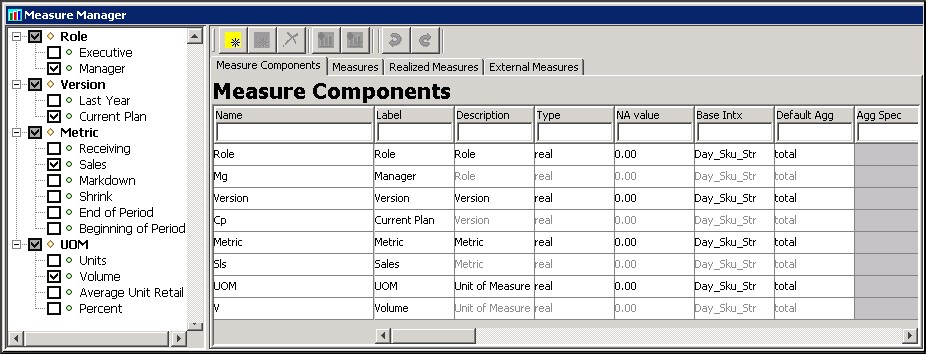

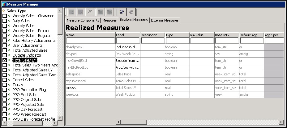

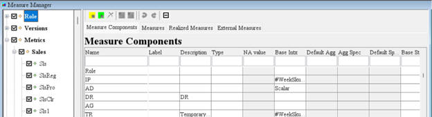

The Measure Manager window allows you to define major and minor components of measures and to specify properties for each component. Once the component structure is defined, the Measure Manager generates measures by combining the components that are selected. You may then select (realize) the valid measures and further update the properties for individual measures.
Figure 4-6 Measure Manager Window
Description of Figure 4-6 follows
Description of "Figure 4-6 Measure Manager Window"

Create a Major Component
Complete the following steps to create a major component.
Navigate: In the Configuration Components pane, select Project then Solution then, Measures and then the Measure Components tab. The Measure Manager window opens in the workspace.
Figure 4-7 Measure Manager Window - Measure Components Tab
Description of Figure 4-7 follows
Description of "Figure 4-7 Measure Manager Window - Measure Components Tab"

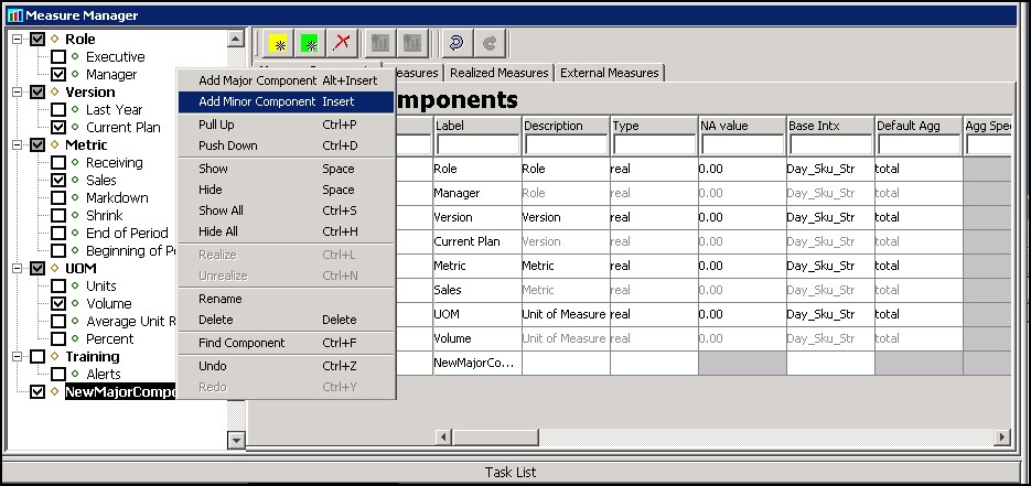

  1. Right-click in the left-hand pane of the Measure Manager window and select Add Major Component or click Add Major Component. The major component displays in the Measure Manager navigation tree with a default name.
    Figure 4-8 Measure Manager Navigation Tree
    Description of Figure 4-8 follows
    Description of "Figure 4-8 Measure Manager Navigation Tree"
  2. To change the component name, right-click on the component and select Rename, or select the component from the navigation tree and then modify its Label field from the Measure Components tab.

  1. Select the major or minor component that the new minor component is to be added beneath. In Figure 4-9, NewMajorComponent is selected.
  2. Choose one of the following methods:
    • Right-click the Measure Definition navigation tree and select Add Minor Component.
    • Click Add Minor Component.
    • Press Insert.
    The minor component displays in the Measure Manager navigation tree with a default name.

Defining Measure Component Properties
Complete the following steps to define the Measure Component properties.
Once components have been created, open the Measure Manager and select the Measure Components tab.
Select the major or minor components you want to view from the Measure Manager navigation tree. The selected components display in the Measure Components tab.
Figure 4-11 Measure Components Tab
Description of Figure 4-11 follows
Description of "Figure 4-11 Measure Components Tab"
Specify the information for the component properties (for example, Name, Label, Description, and so on), which will apply to the measures that are inheriting property values from the component.
The values that are entered for major components are inherited by the child minor components and the auto-generated measures. Not all properties need to be entered for all components. Properties that are grayed out in the component properties table cannot have a value in the current context. Typically, this is based on the data type of the measure. For example, only components of Boolean data type can have an alert category or an alert expression.

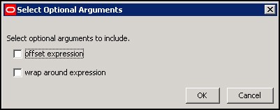

  • When a measure is specified for hybrid agg, the agg spec (aggregation specification) field becomes editable.

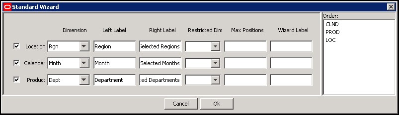

  • An agg spec can be typed in or built through a window (double-click the agg spec editor or select Ctrl-Space to launch it).
  • This window looks very similar to the standard wizard for workbooks. On the right, the ordering of hierarchies in the intersection of the measure is set by dragging the hierarchies in the list. On the left, a separate aggregation type is selected for each hierarchy. For the most part, these are the aggregation types that are available for the measure based on its type.

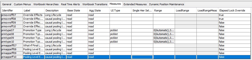

The ability of the measure at the base level to be modified. The available options are read or write.
Agg State
The editability of the measure at the aggregate level, which are all intersections higher than the base intersection (read or write). Set the Base State to write and the Agg State to read for those measures that need to be manipulable, but where there is no business requirement to manipulate them other than at their base intersection. Usually there is no sensible way to spread such measures. The manipulability of measures will change according to protection processing principles. Therefore, base state and agg state should only be used to override the result of protection processing (for example, to make a measure non-manipulable that protection processing would otherwise allow to be manipulated). See Appendix – Calculation Engine User Guide and Appendix – Rules Function Reference Guide for more information on the Agg State of measures.

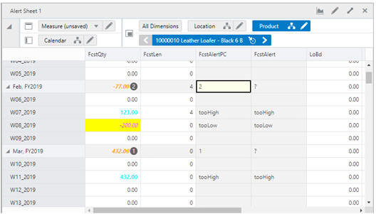

Range
Specify an allowed range for the measure at edit time. For numeric values, the syntax is specified as Lower Bound:Upper Bound. If the RPASCE UI user attempts to enter a value in the RPASCE Client outside of this range, the modification is rejected. For string measures, any entry in this field is ignored.
For date measures, the lower and upper bounds specify both the date and the time. The default time for the lower bound is 12:00:00 AM. The default time for the upper bound is 11:59:59 PM. The time portion of the bounds is included regardless of the style setting because users can change the style setting on the client side.
For numeric or string measures with a UI Type of picklist (numeric and string), values are comma separated value/label pairs, where the label is given in brackets, such as a(labela), b(labelb), and c(labelc). If a label is not specified (for example, a, b, c, d), the value is also used as the label. The value of the cell is used in calculations; however, labels (if specified) will be displayed in the user interface, both in the grid and in the picklist.
The symbols of , (comma) and : (colon) are reserved characters for picklist and range definitions of a measure with a UI Type of picklist. These characters cannot be used to define the Label part of a picklist Value/Label pair.
If a cell contains a value that is not valid for the picklist, the value is displayed in the grid. When the measure's range is specified in this manner, all cells in the RPASCE Client will display these same values as valid options for the picklist. The valid set of options for a picklist measure can also be defined in such a way that they are context sensitive, which means that they vary from position to position. For example, a picklist measure with a base intersection at the SKU dimension could have valid values that vary according to which class the SKU belongs. The configuration administrator sets this up by setting the range property of the picklist measure as measurerange = measS where measS is the name of a string measure that holds the valid picklist options (in the valid formats described earlier) in each of its cells. The measure that holds the valid picklist values (in this example, measS) can have a base intersection at any of the dimensions in the hierarchies and the values shown in the picklist measure for any intersection are effectively “looked up" using normal ‘nonconforming measure' handling.
The valid values for a picklist for a cell are referenced from a measure dynamically. If required, it is possible for the valid values of picklists to change during the life of the workbook as a result of calculations or end-user edits. The value used will always be that of the last calculate, so direct or indirect (through calculation) edits to the picklist value measure are ignored when a calculation is pending.

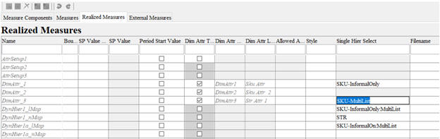

Dim Attr Type
This check box option is used to indicate that the measure must be registered as a 1-dimension attribute. Dimension attributes allow for additional information to be defined for the positions of a given dimension. This is commonly used to define and display an alternate label for a position (other than the loaded position label) or to display supplemental information about a position (such as the status of a given position).
The following requirements must be met for a measure to be eligible to be a dimension attribute:
  • The measure must be realized.
  • The measure must be 1-dimensional, which means that its base intersection must only have one dimension.
  • The measure must be stored, which means that it must have a defined database.
Dim Attr Name (optional field)
This is only to be used if the measure is set to be a dimension attribute measure. When a dimension attribute is displayed within the RPASCE Client, the Dim Attr Name will be used in place of the measure name. If no Dim Attr Name is supplied, the RPASCE Client displays the measure name.
Dim Attr Label (optional field)
This is only to be used if the measure is set to be a dimension attribute measure. When a dimension attribute is displayed within the RPASCE Client, the Dim Attr Label will be used in place of the measure label. If no Dim Attr Label is supplied, the RPASCE Client displays the measure label.

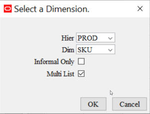

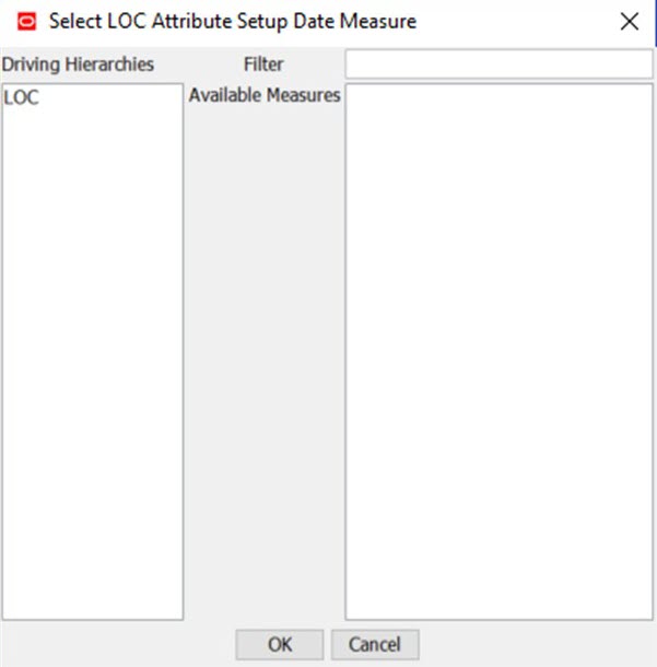

Single Hier Select
This property is only valid for components that have a Type (data type) of string and non-picklist. It specifies that cell contents are to be entered by users using the Single Select Widget. This is a widget in the RPASCE Client that presents the end user with a view of the positions along the dimension set in the configuration. The user may then select any single position. When a user double clicks the Single Hier Select field, a Select a Dimension window pops up where the user must select the hierarchy and dimension whose positions will be displayed to the user in the RPASCE Client.
Figure 4-12 Select a Dimension Window
Description of Figure 4-12 follows
Description of "Figure 4-12 Select a Dimension Window"
For the Single Hier Select measures that have both Agg State and Base State properties set to READ, the pop-up dialog box contains an additional Multi List check box. Users can select the Multi List check box to enable the Multi Item Display on RPASCE UI, so users can see a concatenated list of positions that meet different criteria for a measure (For example, alert or promotion) so that users can see which positions have alerts or offers and what details that apply to them.
Figure 4-13 Measure Definition Table
This image shows the Measure Definition table.

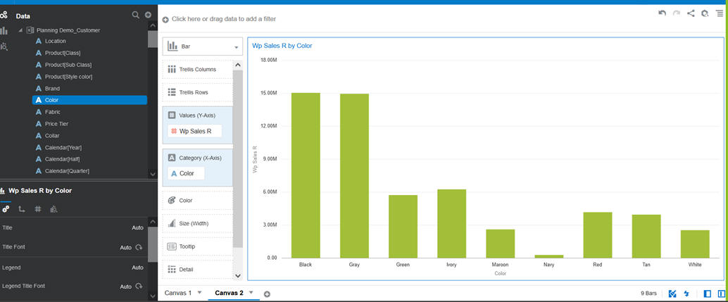

Enable Viewing Fact Data by Dimension Attributes in Data Visualization (DV)
To provide better support for attribute analysis, users can use RPASCE attributes as DV attributes when creating reports and visualizations. Either a one-dimensional or a two-dimensional attribute is used to join with other fact views in DV. The attributes are used to group data in a series, and the columns of a data source are treated as either metrics or attributes. See "Create Reporting Views in PDS" in the Oracle Retail Predictive Application Server Cloud Edition Administration Guide for details.
Figure 4-14 An Example of Viewing Sales Data by Color Attributes in DV
This image shows an example of viewing sales data by color attributes in DV.
The one-dimensional and two-dimensional attribute measures must have the Report Category values configured; the following assumptions and requirements apply.

Find a Component
  1. Right-click in the Measure Manager navigation tree and select Find Component. The Input window opens.
    Figure 4-15 Find Component Menu Option
    Description of Figure 4-15 follows
    Description of "Figure 4-15 Find Component Menu Option"
  2. Type in the name of the desired component and click OK. The tree will scroll to bring the specified component into view.
  3. Select the desired component.
    The full name (case sensitive) of the component is required in order to find it. If there is no component with the exact name entered, the tree will not scroll.

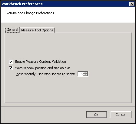

  1. Select File and then Tools Preferences. The Workbench Preferences window opens.
    Figure 4-17 Workbench Preferences – General Tab
    Description of Figure 4-17 follows
    Description of "Figure 4-17 Workbench Preferences – General Tab"
  2. Clear the Enable Measure Content Validation check box.
  3. Click OK.

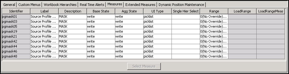

Working with Measures
Measure Manager Overview
The Measure Manager allows you to create and name measures by selecting major and minor components that are already defined. By default, the measures inherit the properties that are defined for the components. To create a measure, select the components that will be used to construct measures. The Measure Manager will generate measures for all of the combinations of selected components. This saves you from the tedious task of manually creating all required measures.
Figure 4-18 Measure Manager Components
Description of Figure 4-18 follows
Description of "Figure 4-18 Measure Manager Components"
You may then override the properties for individual measures by entering them the same way as on the Measure Components tab. Once properties are overridden at the measure level, changes made at the component level will no longer spread down to that measure as it will retain the overridden value. An overridden value can also be restored to its inherited value or you may override an inherited value to be unspecified.
When a measure is auto-generated by the Measure Manager, it cannot be edited or used in any other configuration component such as rules and workbooks until it is realized. A measure does not need to be realized if it is not going to be used.
The Measures tab displays all auto-generated measures for the selected components.
Figure 4-19 Measure Manager Measures Tab
Description of Figure 4-19 follows
Description of "Figure 4-19 Measure Manager Measures Tab"

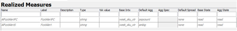

The Realized Measures tab only displays those measures that are realized.
Figure 4-20 Measure Manager Realized Measures Tab
Description of Figure 4-20 follows
Description of "Figure 4-20 Measure Manager Realized Measures Tab"
Realized and Unrealized Measures
Complete the following steps to access the Measure Manager window - Measures Tab.
Navigate: In the Configuration Components pane, select Project, then Solution, and then Measures. The Measure Manager window opens in the workspace.
  1. Select the Measures tab.
    Figure 4-21 Measure Manager Measures Tab
    Description of Figure 4-21 follows
    Description of "Figure 4-21 Measure Manager Measures Tab"

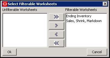

  2. In the components tree, select the check boxes for the components that will be filtered. The Measure Manager will show measures using all the combinations of selected components. This process filters the list of prototype measures that are shown from all combinations of components to the combinations of components that have been selected. It uses those components to determine which prototype measures to show.
Realizing a Measure
  1. Select the components that are used for the measures to be realized.
  2. Select the check box in the Realized column for each auto-generated measure to be realized.
Unrealizing a Measure
  1. Select the components that are used for the measures to be unrealized.
  2. Clear the check box in the Realized column for each auto-generated measure to be unrealized.
Rename a Measure
  1. Select the components that are used in the measures to be renamed.
  2. In the Measures tab, or the Realized Measures tab, click the name of the measure that is to be renamed.
  3. Type the new name for the measure.
    The measure must be realized before it can be renamed.
Show All Measures
Right-click in the Measure Manager window and select Show All.
Due to memory constraints when working with very large numbers of components, all auto-generated measures may not be displayed. In this case, the configuration administrator will receive an error message indicating that some measure components should be cleared.
Hide Measures by Component
  1. In the Measure Manager window, select the Measures tab.
    • Clear the check boxes next to the components to hide.
    • Select the component used in the measures to hide.
  3. Right-click in the Measure Manager navigation tree and select Hide or press the spacebar.
Hide All Measures
  2. Right-click the Measure Manager navigation tree, and select Hide All.
Sort Measures by Property Value
In the Realized Measures tab, measures can be sorted by property value.
  1. Select the Realized Measures tab.
  2. Hold down the control key (Ctrl) and click in the filter field at the top of the table for the property of the measures to be sorted.
    The measures are sorted in alphabetical order according to the value of the property.
Filter Measures by Property Value
In the Realized Measure tabs, the configuration administrator can filter measures by property value.
  1. In the Realized Measures tab, click in the filter field at the top of the table for the property of the measures to be filtered.
  2. Enter the value on which ti filter the measures.
    This field is case sensitive.

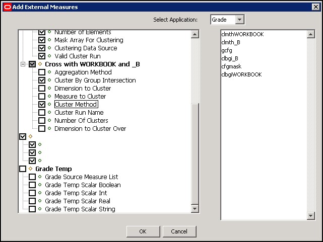

External Measures
Under most circumstances, measures exist only within the solution in which they are defined. When working with a project with multiple solutions, it is sometimes desirable to make use of a measure defined in a different solution. The Measure Manager allows the import of a measure defined in a different solution (but not a different project) into the current solution. These measures (called external measures) then become visible in the External Measures tab of the Measure Manager. Within this tab, it is possible to modify certain measure properties so that the use of the measure in the Solution into which it has been imported will differ from its use in the Solution in which it was originally defined. For example, the configuration administrator may want to modify a writable measure so that it is read-only in the solution into which it is imported.
Figure 4-22 Measure Manager External Measures Tab
Description of Figure 4-22 follows
Description of "Figure 4-22 Measure Manager External Measures Tab"
Within the Measure Selectors present in the Rule and Workbook tools and the Expression Builder, there is a check box named Include External Measures. When this check box is selected, the Measure Selector will include those measures that were imported into the solution in addition to those that are present due to component selections in the Measure Selector.
The following properties may be overridden for an external measure:
  • Label
  • Description
  • Base State
  • Agg State
  • UI Type
  • Range

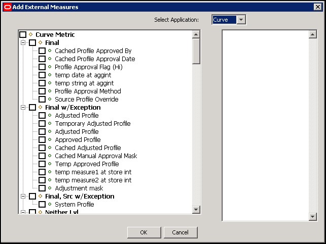

Import a Measure
You may only import a measure into a solution for a project that has at least one other solution.
  1. Select the External Measures tab, and click Import Measure on the toolbar. The Figure 4-23 opens.
    Figure 4-23 Add External Measures Window
    Description of Figure 4-23 follows
    Description of "Figure 4-23 Add External Measures Window"
  2. In the Add External Measures window, select the solution in which the desired measure is defined.
  3. Use the measure selector (left-hand side) to select the measures to import.
    Figure 4-24 Selecting Measures to Be Imported
    Description of Figure 4-24 follows
    Description of "Figure 4-24 Selecting Measures to Be Imported"
    External measures that are already imported display in bold.
  4. From the right-hand list, select the measure to import and click OK. The selected measures display in the External Measure tab.
Remove an Imported Measure from a Solution
  1. Click the External Measures tab, and select the measure to remove.
  2. Click Remove Imported Measure from the Measure Manager toolbar, or right-click and select Remove Import. The selected imported measure is removed from the External Measures tabs.

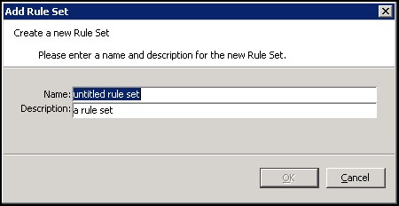

    Figure 4-26 Add Rule Set Window
    Description of Figure 4-26 follows
    Description of "Figure 4-26 Add Rule Set Window"
  2. Complete the following:
    1. In the Name field, enter the name of the rule set.
      A rule set name can be a maximum of ten alphanumeric or underscore characters. It must not have a name that is the same as any other rule set that exists in the project.
    2. In the Description field, enter a description of the rule set.
    3. Click OK to save any changes and close the window. The rule set displays in the Rules navigation tree.

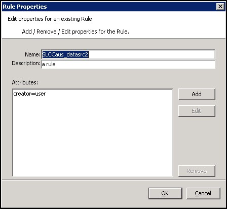

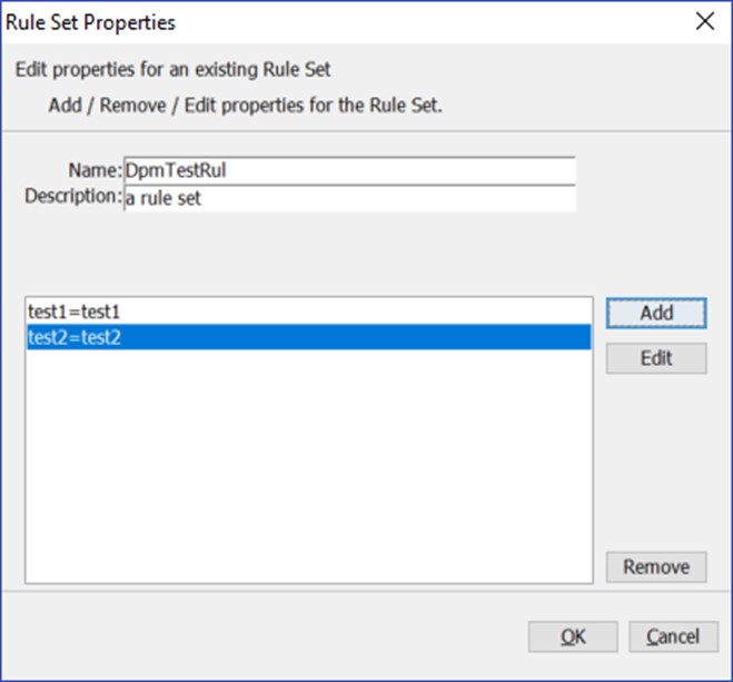

Edit Rule Set Properties
Navigate: In the Configuration Components pane, select Project, then Solution, and then Rules. The Rule Definition window opens in the workspace.
  1. In the Rule Definition window, select the rule set, right click, select Edit Properties, then select Rule Set. The Rule Set Properties Window opens in the workspace.
    Figure 4-27 Rule Set Properties Window
    Description of Figure 4-27 follows
    Description of "Figure 4-27 Rule Set Properties Window"

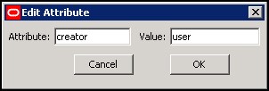

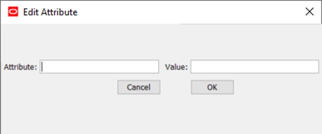

  2. In the Rule Set Properties window, Click Add to open the Edit Attribute window in order to add a new rule set attribute.
    Figure 4-28 Rule Set Edit Attribute Window
    Description of Figure 4-28 follows
    Description of "Figure 4-28 Rule Set Edit Attribute Window"
  3. To edit an existing rule set attribute, select the attribute/value pair and then click Edit. The Edit Attribute window opens in the workspace. The window is pre-populated with the selected rule set attribute and value that the users can edit.
  4. To remove an existing rule set attribute, select the attribute/value pair and then click Remove.

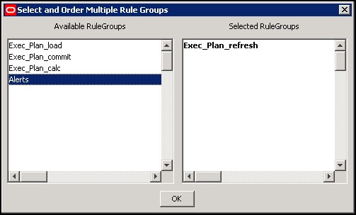

Multiple Refresh Rule Groups
The Refresh Rule Group updates (supplies new values for) data, which can generally be thought of as being external to the workbook. An example would be actuals:
  • If a workbook is built in week 5, the user would have actuals for weeks 1-4.
  • In week 6, the user can refresh the actuals to get the actuals for week 5.
The Configuration Tools and RPASCE support the use of multiple refresh rule groups. Within the rule tool, there is the ability to create multiple refresh rule groups within a rule set. These multiple refresh rule groups can then be assigned to a workbook template using the Workbook Designer, and they will be available for selection within the RPASCE Client.
  • A workbook contains all of the rule groups in a single rule set, so if multiple refresh rule groups are required in a workbook, they must all be in the same rule set.
  • You may consider naming rule groups so the usage of the refresh rule groups are reflected in their names, such as refresh_all, refresh_actuals, and refresh_manager.

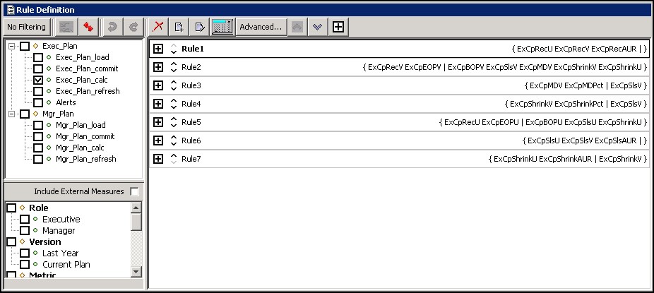

Figure 4-29 Rule Definition Window
Description of Figure 4-29 follows
Description of "Figure 4-29 Rule Definition Window"

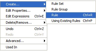

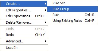

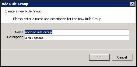

  1. In the Rule Definition window, select the rule set to be used to create a new rule group.
  2. From the toolbar, click New and select Rule Group, or select Create – Rule Group from the right-click menu.
    Figure 4-30 Rule Group Menu Option
    Description of Figure 4-30 follows
    Description of "Figure 4-30 Rule Group Menu Option"
    The Figure 4-31 opens.
    Figure 4-31 Add Rule Group Window
    Description of Figure 4-31 follows
    Description of "Figure 4-31 Add Rule Group Window"
  3. Complete the following:
    1. In the Name field, enter the name of the rule group.
      A rule group name can be a maximum of 16 alphanumeric or underscore characters. It must not have a name that is the same as any other rule group that exists in the project.
    2. In the Description field, enter a description of the rule group.
    3. Click OK to save any changes and close the window. The new rule group displays in the Rule Definition tree window.

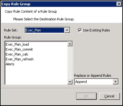

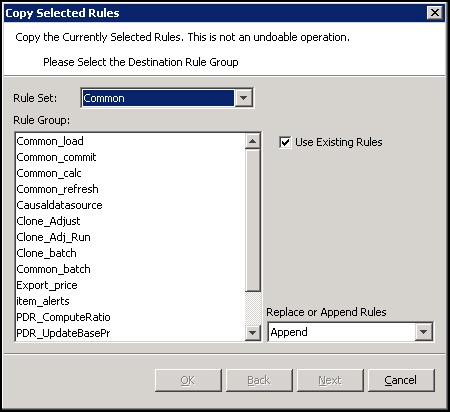

Copy a Rule Group
If two rule groups are similar, it may be beneficial to copy one rule group into the other to prevent having to create a rule group from scratch. When copying the rules of a rule group into another rule group, it is possible to specify whether existing rules will be used or copies of the rules will be created. The Use Existing Rules check box defaults to using any existing rules in the rule pool. If this check box is selected, the copy rule group operation will use the same rules that the source rule group has. If this check box is unchecked, the copy rule group operation will create copies of the rules and use those copies for appending to or replacing rules in the destination rule group.
The rule group to be copied into must already exist. A new rule group cannot be created through this process.
Navigate: In the Configuration Components pane, select Project, then Solution, and then Rules. The Figure 4-29 opens in the workspace.
  1. In the Rule Definition window, select the rule group to be copied.
  2. From the toolbar, click Advanced, and select Copy Rule Group. The Copy Rule Group window opens.
    Figure 4-32 Copy Rule Group Window
    Description of Figure 4-32 follows
    Description of "Figure 4-32 Copy Rule Group Window"
    1. Using the Rule Set list, select the destination rule set.
    2. From the Rule Group area, select the desired destination rule group.
    3. Using the Replace or Append Rules list, select either:
      Replace – To overwrite all rules that already exist in the destination rule group.
      Append – To add to the rules already in the destination rule group.
    4. Click OK. The Confirm Operation window opens.
  4. Click OK. The rules are copied to the selected rule group.

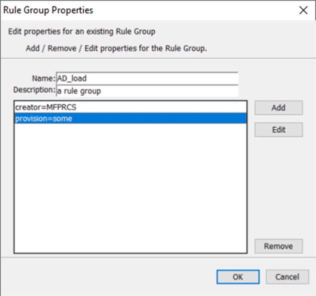

Edit Rule Group Properties
  1. In the Rule Definition window, find the rule set containing the rule group to be modified. Select the rule group, right click, select Edit Properties, then select Rule Group. The Figure 4-33 opens in the workspace.
    Figure 4-33 Rule Group Properties Window
    Description of Figure 4-33 follows
    Description of "Figure 4-33 Rule Group Properties Window"
  2. In the Rule Group Properties window, click Add to open the Edit Attribute window in order to add a new rule group attribute.
    Figure 4-34 Rule Group Edit Attribute Window
    Description of Figure 4-34 follows
    Description of "Figure 4-34 Rule Group Edit Attribute Window"
  3. To edit an existing rule group attribute, select the attribute/value pair and then click Edit. The Edit Attribute window opens in the workspace. The window is pre-populated with the selected rule group attribute and value that the user can edit.
  4. To remove an existing rule group attribute, select the attribute/value pair and then click Remove.
Measure Validation in the Rule Definition Window
If Enable Measure Content Validation is not selected in the Workbench Preferences window, measure content validation is turned off in the Measure Manager. Measure validation must be manually initiated in the rule tool. See Measure Validation within the Measure Manager.
From the Rule Definition window, click Perform Measure Content Validation on the Rule Definition toolbar.

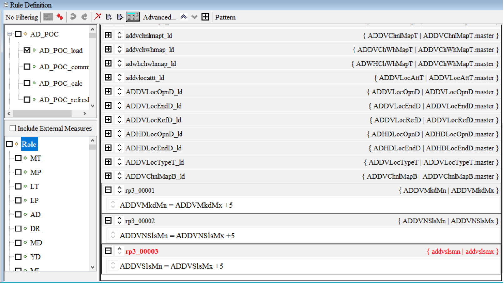

Rule Definition
The Rule Definition tool allows the configuration administrator to define, organize, and manage rule sets, rule groups, and rules. It also allows for the creation of expressions and addition of expressions to rules.

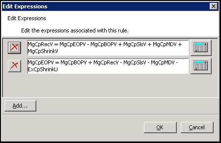

Rules are groups of expressions that describe the relationship between measures.
When a rule has multiple expressions, those expressions are given a priority sequence to help the calculation engine select a calculation path that follows business priorities. When given a choice, the calculation engine will always select the highest priority expression in the rule that is available to be selected. Considerable care should be taken in the design of rules to ensure that appropriate expression priorities are established. The business priority may vary from implementation to implementation, and it may vary from one type of plan to another in the same implementation.
Rules are also given a priority sequence within a rule group to help the calculation engine select a calculation path that follows business priorities. When given a choice, the calculation engine will always select the highest priority rule that needs to be calculated.
Those who are configuring the calculation requirements of a solution are expected to fully understand the operation of the RPASCE calculation engine.

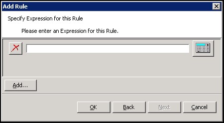

Create a Rule and Add It to a Rule Group
Complete the following steps to create a rule and add it to a Rule Group.
  1. In the Rule Definition window, select the rule group in which you want to create a rule. If you want the rule to be created in a particular position in the sequence of rules in the rule group, select the rule before which you want the new rule to be placed. The new rule will be created higher than the selected rule.
    • From the toolbar, click New and select Rule.

  3. In the Name field, enter the name of the rule.
    A rule name can be a maximum of 24 alphanumeric or underscore characters. It must not have a name that is the same as any other rule that exists in the project. Rule names may start with a letter or an underscore but may not start with the letter r or R followed by a number.
  4. In the Description field, enter a description of the rule.
  5. Click Next. The Expression Builder window of the Add Rule window opens.
    Figure 4-37 Specify Expression for Add Rule
    Description of Figure 4-37 follows
    Description of "Figure 4-37 Specify Expression for Add Rule"
  6. Type the expression in the input box or complete the following to use the Expression Builder.
    1. Click Expression Builder (located to the right of the text box). The Expression Builder window opens.

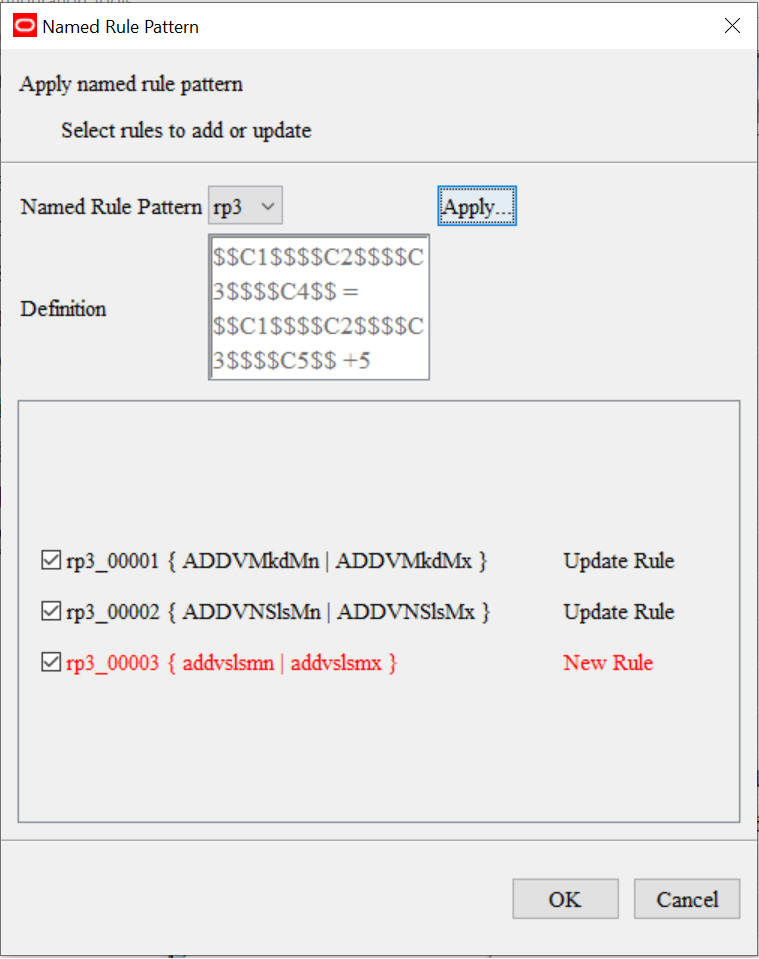

Apply a Rule Pattern to Create New Rules or to Update Existing Rules
The Apply Rule Pattern functionality allows you to create new rules or update existing rules according to a pattern established by a selected base or template rule. The rule tool recognizes inherent similarities or patterns in measure components used in some rules when compared to the base or template rule. Based on these similarities, the rule tool allows for the creation of new rules or update of existing rules to fit the pattern set by the base or template rule.
When the Apply Pattern capability is enabled, there is a possibility that some of the New or Updated rules will have the same expressions as a rule that already exists in the rule pool. If this happens, the Similar Rules Found window opens and provides the option of using the existing rule or actually creating a new one.
  1. In the Rule Definition window, select any rule group that contains the rule to use as the pattern basis.
  2. Select the rule whose pattern is to be used as a basis for creating or updating rules.
  3. From the toolbar, click Advanced and then select Apply Pattern, or right-click and select Advanced and then, Apply Pattern.
    A Figure 4-48 opens containing a set of rules that are presented for selection. This set is composed of rules whose measures follow the selected rule's pattern in terms of the individual measure components used. The set of rules are composed of potential new rules or potential updated rules.
    You can click the four corners of the Apply Rule Pattern window to see the resize arrow. You can resize the window by dragging the arrow.
    Figure 4-48 New Apply Rule Pattern Window
    Description of Figure 4-48 follows
    Description of "Figure 4-48 New Apply Rule Pattern Window"
    Example:
    Consider a configuration with three components in the measure naming scheme:
    • a version (such as Wp)
    • a metric (such as Shrink)
    • a unit of measure (such as V)
    If the selected base rule is:
    { WpShrinkU WpShrinkAUR | WpShrinkV }
    ...then the rules:
    Rule1: { WpSlsU WpSlsV WpSlsAUR | }
    ...and
    Rule2: { WpRecU WpRecV WpRecC | }
    ...would fit the pattern and be included in the list.
    Rule1 fits the pattern because its measures use the same measure components with the exception of the metric component. For the Metric component, the base rule uses Shrink, and Rule1 uses Sls consistently. In this case, the tool will present the rule:
    { WpSlsU WpSlsAUR | WpSlsV }
    ...as a possible update for Rule1.
    The update results in the conversion of Rule1 to a rule that uses the same measures as the original Rule1, but it has the expression pattern of the base rule.
    Rule2 fits the pattern because it uses the same Version as the base rule. For the Metric component, the base rule uses Shrink, and Rule2 uses Rec consistently. Unlike Rule1, Rule2 uses C as the Unit of Measure in one of its measures. This is not an exact fit like Rule1. In this case, the tool will present the rule { WpRecU WpRecAUR | WpRecV } as a possible new rule. Notice that this rule is forced to be an exact fit as Rule1 was.
  4. Select the rule replacement policy in the Use Existing Rules drop-down menu. This allows the user to select, on a rule-by-rule basis, which rules to reuse and which to re-create. By default, this is set to Always.
    • When Always is selected, rules that already exist elsewhere in the configuration will always be used in place of the newly generated rules.
    • When Never is selected, new rules will always be created, even if an identical rule already exists elsewhere in the configuration.
    • When Prompt is selected, the Rule Locator window will be presented for each rule whose expressions already exist elsewhere in the configuration.
  5. From the list of possible new and updated rules, select those to be updated or added to the rule group. In either case, if rule reuse is specified in Step 4, a new rule will not be created, but the rule existing elsewhere in the configuration will be used in its place.
  6. Click OK.
    A selected rule that is labeled New Rule will be added to the end of the rule group. The new rule's name will default to the template rule's name suffixed with a number to keep the name unique. A selected rule that is labeled Update Rule is already in the rule group and will be replaced. This means that the old rule will be removed and replaced with a new rule whose expressions follow the base rule's expression pattern. In both cases, the rule will follow the pattern of the base rule's expression.

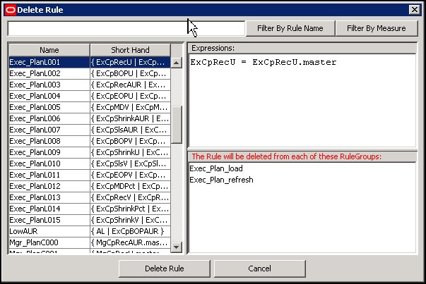

Delete a Rule from All Rule Groups
This procedure deletes the rule from all rule groups that contain this rule as well as from the Rule Pool. If the desired action is to remove the rule from a rule group, but to retain it in other rule groups, follow Remove a Rule from a Rule Group.
  1. In the Rule Definition window, select any rule group that contains the rule to be deleted.
  2. Select the rule to be deleted.
    If multiple rules are selected, only the last selected rule is deleted.
  3. From the toolbar, click Delete and select Delete Rule, or select Delete, then Remove, and then Delete Rule from the right-click menu. The Figure 4-49 opens.
  4. Verify that the rule selected in the table is the rule to be deleted or click to select a different rule in the table.
  5. Click Delete Rule to delete the rule and close the window.

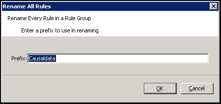

Rename All Rules in a Rule Group
Complete the following steps to rename all rules in a Rule Group.
  1. In the Rule Definition window, select the rule group that contains the rules to rename.
  2. From the toolbar, click Advanced and select Rename All Rules, or select Advanced – Rename All Rules from the right-click menu. The Figure 4-52 window opens.
  3. In the Prefix field, enter a prefix up to ten characters in length, which is the start of all rule names.
  4. Click OK. The Figure 4-53 window opens.
  5. Click Yes.
    All of the rules in the rule group are renamed with the prefix followed by a 4-digit numeric identifier generated by the rule tool. The rule tool will maintain the order that the rules were in before they were renamed, and it uses that order in generating the numeric identifier.
