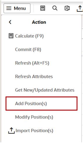

The DPM can be launched from the main menu or the context menu to both add and modify positions.
To add new positions to a dimension, complete the following steps:
  1. From the Action menu, select Add Positions. The Figure 14-3 window opens.

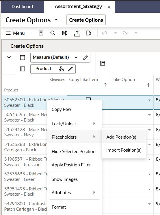

    Alternatively, you can right-click the position level to access the Add Positions context menu.
    Figure 14-2 Add Positions Context Menu
    From the context menu, the dimension positions are pre-selected based on the launch context.

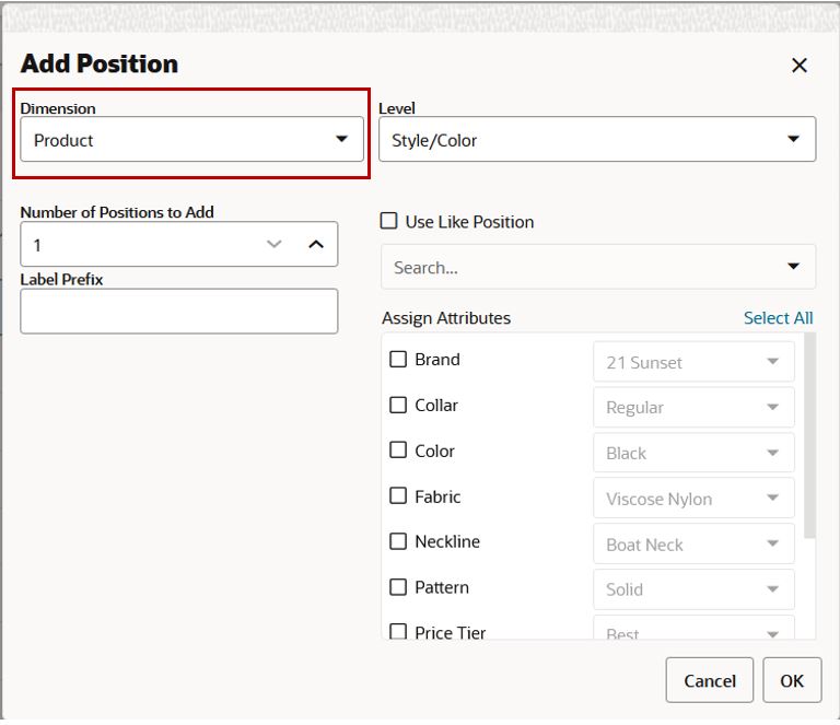

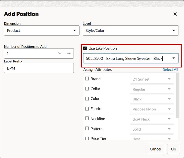

  2. The Figure 14-3 window opens with values that defaults to first option available. The Dimension and Level selection options are always available.
    Selecting Dimensions
    • You can select the dimension for which you want to create the placeholder positions. Only the list of dimensions for which the DPM functionality is enabled displays.
    • You can select the level at which you want to create the placeholder positions. The list of levels depends on the dimension selected and also on the user's ability to create new levels.
    Figure 14-3 Add Position
    Add Position
    You can either:
    • Enter the number of positions to add in the Number of Positions to Add field.
    • Select the number of positions to add by using the up and down arrow keys.
    Create placeholder positions with when you enter details in the Label Prefix field. The label is used for all of the number of positions specified in the Number of Positions to Add field.

    • Use Like Position
    • Assign Attributes.
    When you Choose the Option Then
    Use Like Position
    You select a like position by choosing a position from selection list of existing items.
    Assign Attributes
    Default attribute values are assigned and the attributes enabled in configuration for that level are displayed.
    Specify Attribute Information

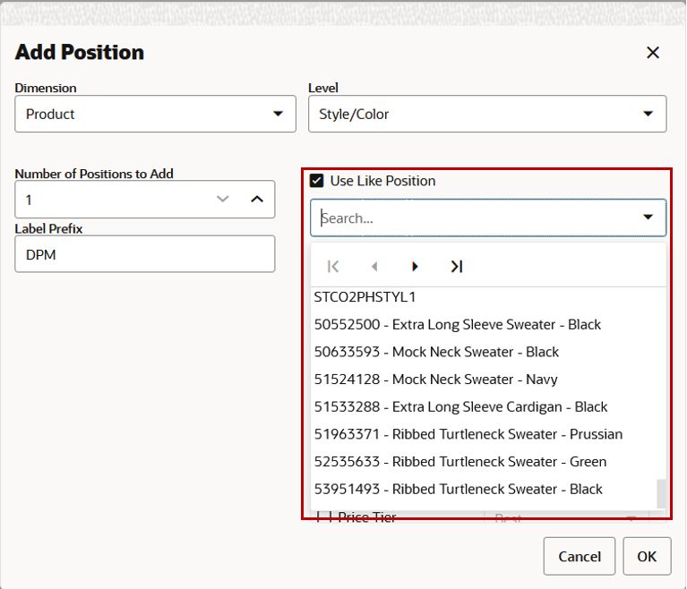

    If you select the Use Like Position option and then select a position from the list of existing items, you can simplify the process of specifying attribute information for new positions. You can copy the attribute information in part or whole from the Like Position to the new positions using the Copy Attributes with Like Position. This prevents you from having to manually enter the information on an attribute-by-attribute basis. Using Edit Mode.
    A row becomes editable when you either:
    • Press Enter and then press F2.
    • Double-click the current row.
    Press Tab to navigate to the next cell. Exit Edit mode by pressing either Esc or F2 again.
    Figure 14-4 Add Position - Use Like Position

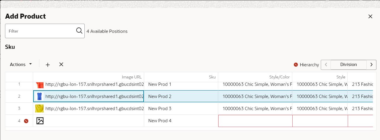

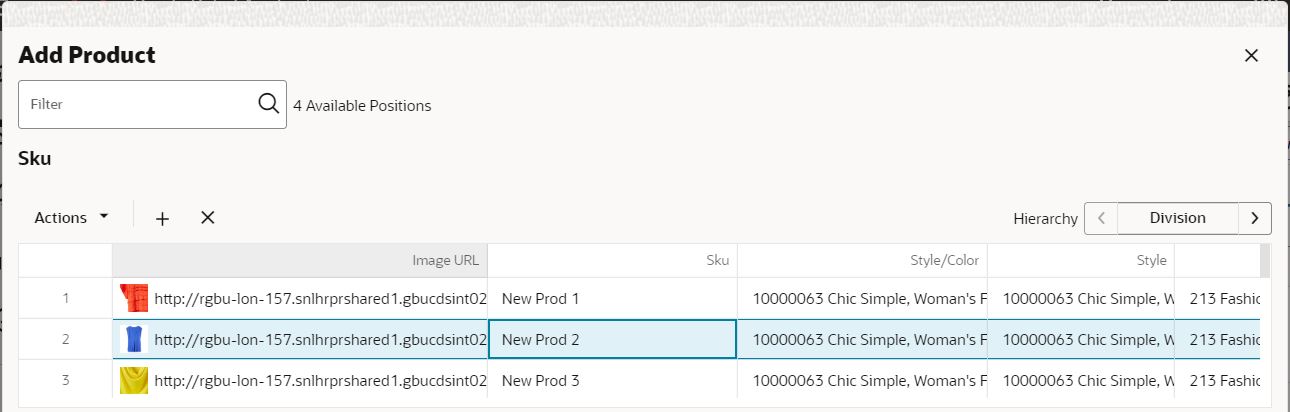

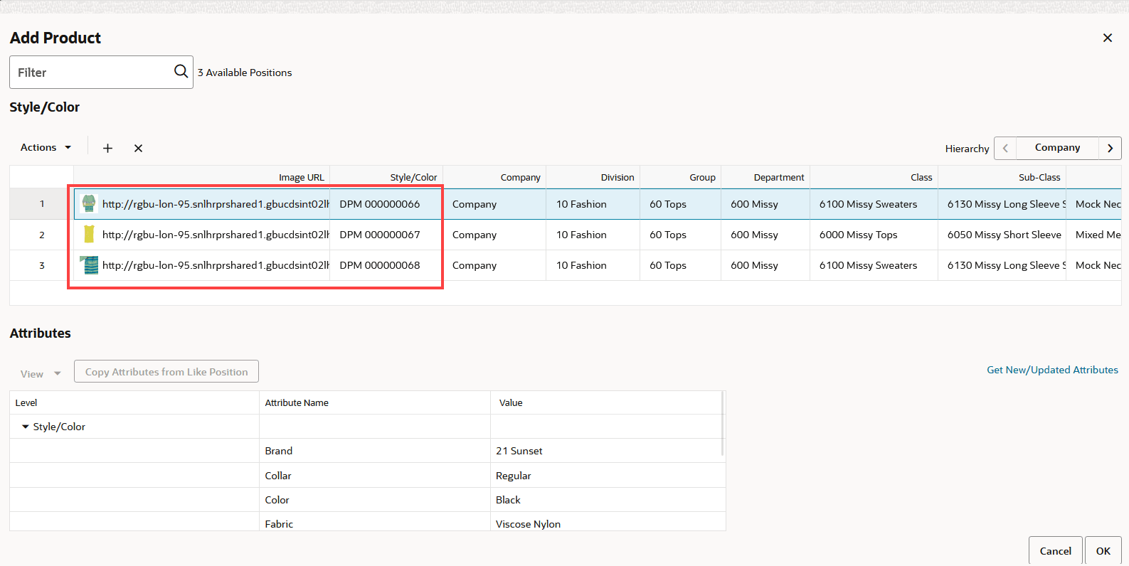

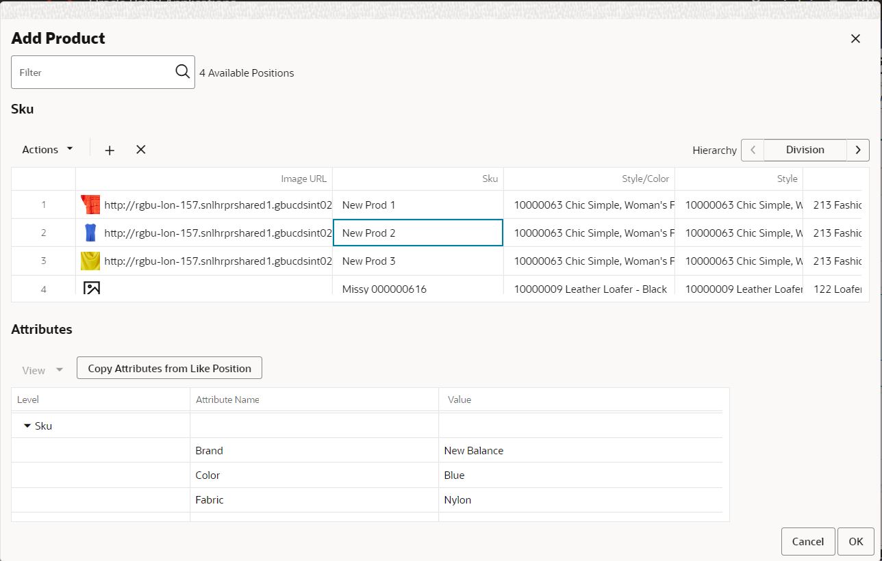

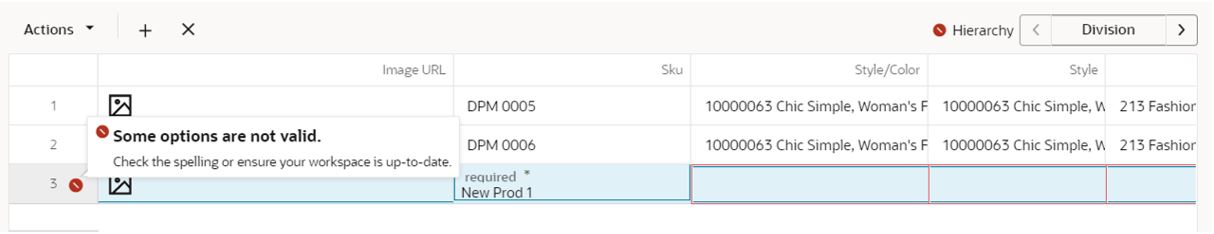

  3. The Figure 14-5 window adds the positions at the launched dimension position level. A unique number is added to the duplicate position labels in the Figure 14-5 window. This unique number is to avoid the addition of duplicate informal positions. You can edit the position label in the Figure 14-5 window

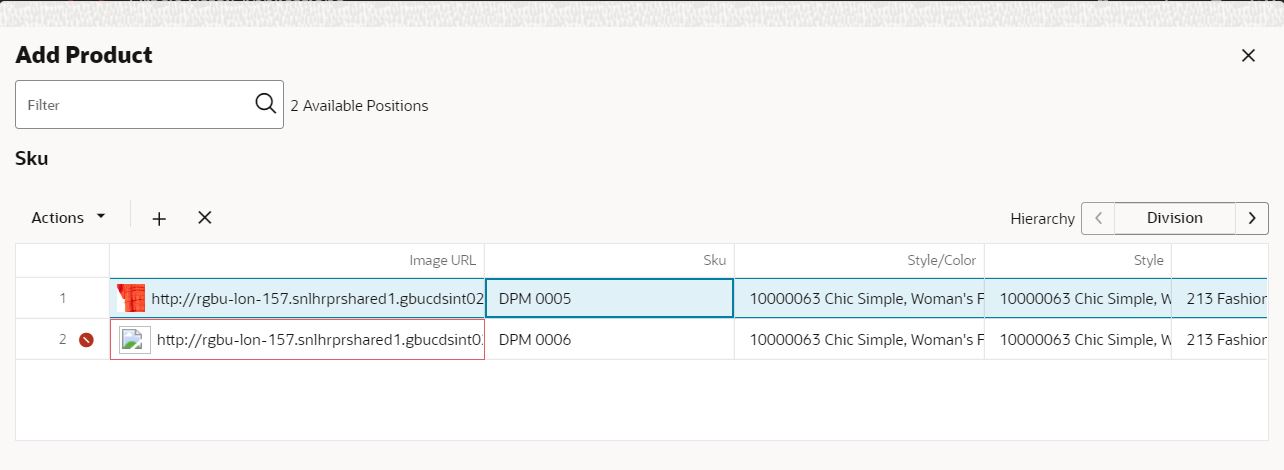

    When adding informal positions, a validation error appears in case of duplicate values with the Figure 14-5 or Figure 14-12 windows.
    You can add an image for the informal position added from the Add Product window. The first column shows the image and URL text input field. The images added for the informal position defaults to both the thumb and full image designated to main facet for the first media attribute. The Image URL field is not mandatory field, so you can skip addition of an image.
    Use the Add Product dialog box to update the position hierarchy parent level positions for the placeholder position. You can view the parent positions displayed in descending order next to the placeholder position.
    You can update the position hierarchy or position parent values using the drop-down list available from the dialog box. When you select position hierarchy such as, department, you can see that the child positions are filtered for the selected department for easy selection of respective class, sub-class, style.
    Figure 14-5 Add Product
    Add Product

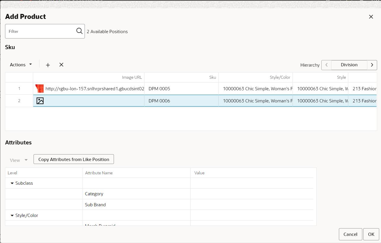

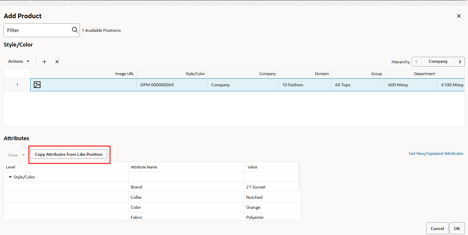

  4. Copy the attribute information from the like position selected to the new positions and click Copy attributes from Like Position. In this way, you do not have to enter the information manually on an attribute-by-attribute basis.
    Figure 14-6 Copy Attributes
    Copy Attributes
    Click the left and right arrow keys to update alternate hierarchy details of the newly created placeholder position.

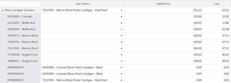

Like Item Support in Placeholder Maintenance
You can use Placeholder Maintenance to copy the information from a similar position (Like Item) to the new positions. It facilitates the copying of attribute and metric information from Like Positions to the New positions, under the assumption that the new position will perform in a manner similar to the source of the copied metric data. For details on choosing the level of history cloning and defining a measure on that level for each dimension that supports Placeholder Maintenance, see the Oracle Retail Predictive Application Server Cloud Edition Configuration Tools User Guide.
Figure 14-8 Use Like Position
Use Like Position

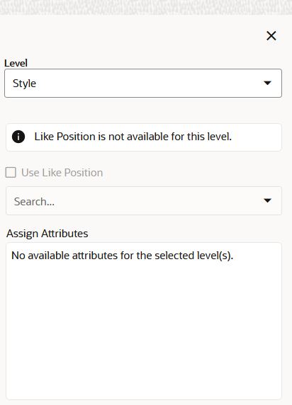

When a measure is not defined, the message Like Position can only be used to copy attributes for the currently selected level displays. When both the measure and the attributes are not present, the message Like Position is not available for this level displays and the Use Like Position checkbox is not available.
Figure 14-9 Like Position Not Available

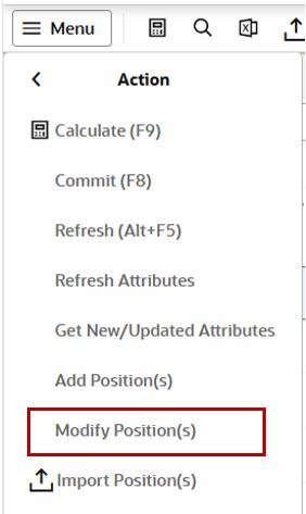

  1. Launch Modify Position(s) from the Action menu. Select the dimension and level in the Figure 14-11 window for the placeholder positions that must be modified.
    Figure 14-10 Action Menu -Modify Positions

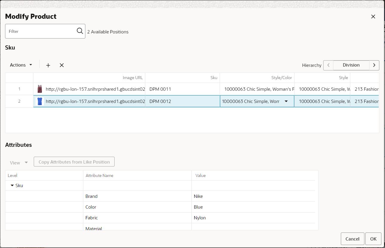

  4. The Modify Product window opens. Select the existing dynamic position and then modify the position window label or position name. Alternately, select any parent to change the parent values of the dynamic position that has been created. The parent can be Style/Sub-Class/Class and so on, or an alternative hierarchy. You can the image URL to update the image associated with position. You can also see that the Like Position column of the window contains the like position you set during the position creation.
    Figure 14-12 Modify Product
    Modify Product
  5. When finished, click OK to save and close.

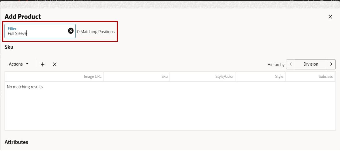

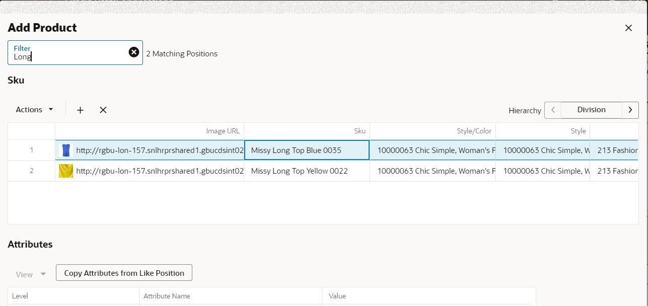

Search an Informal Position

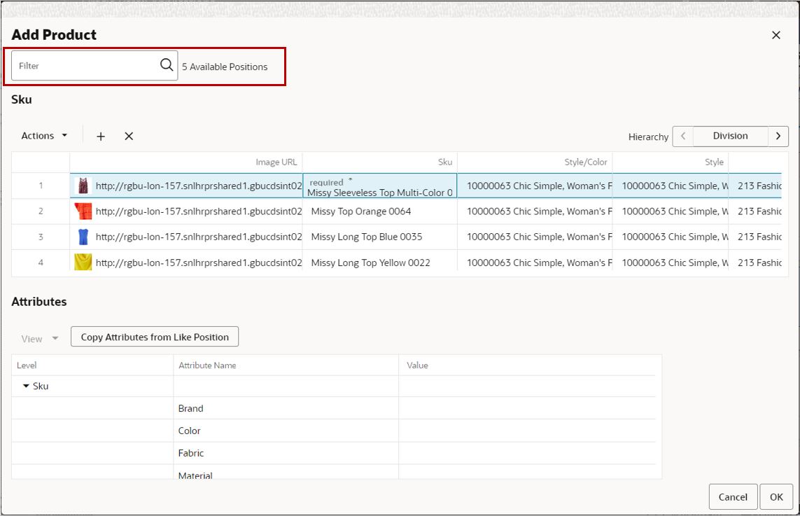

You can search for a position in the list of the informal positions added. In the Figure 14-5 or Figure 14-12 window a search text box is available to locate the required position. The total number of informal positions available are displayed next to search text box. The search functionality makes it easy for you to find the required position and make modifications.
Figure 14-13 Search Box
Search Box
Perform the following steps to search for an informal position in either the Figure 14-5 or Figure 14-12 window.
  1. Enter your text characters in the search box to locate the position. You can search for position by position label or related parent position label. While entering characters, the matching results display in the list of positions.
    The number of matching positions available are displayed next to the search box. To remove the search result either delete the entered characters or click X within the search box.
    Figure 14-14 Search Position Result
  2. If there are no matching positions, then the number of matching positions available displays 0 Matching Positions as shown in Figure 14-15
    Figure 14-15 Search Position – No Matching Position

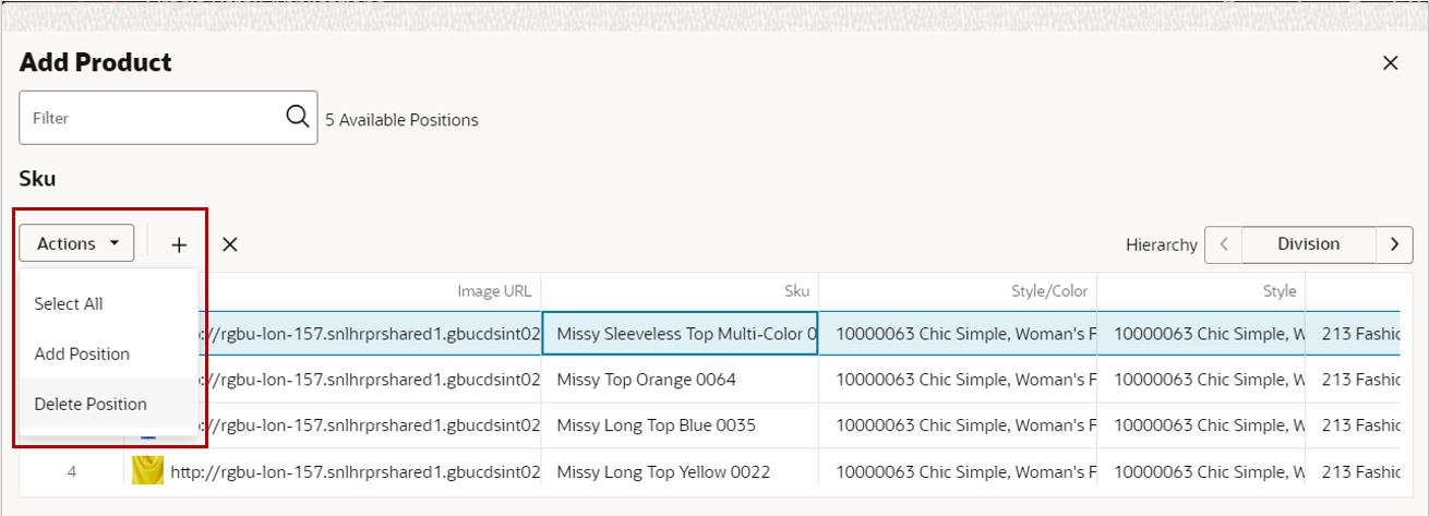

Select All Positions
You can select all positions in the Figure 14-5 and Figure 14-12 windows with Select All from the action Menu. This option helps in selecting all the informal positions in the Figure 14-5 and Figure 14-12 windows.
  1. Select the Action menu and then select the option, Select All to select all the informal positions in the Figure 14-5 and Figure 14-12 windows.
    Figure 14-16 Select All Position
    Select All Position

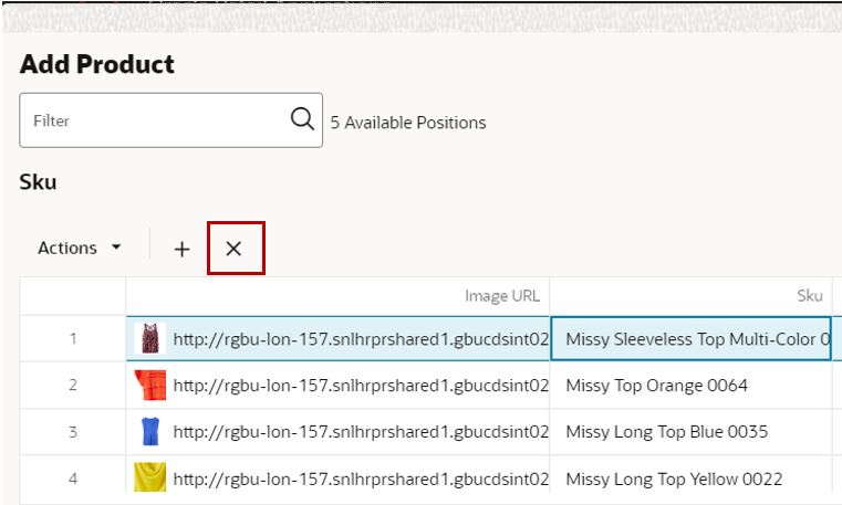

  1. Right-click the informal position you want to delete.
  2. From the right-click menu, select Modify Position and then click X to delete the specific placeholder position.
    Figure 14-17 Delete Position
    Delete Position

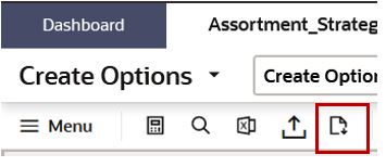

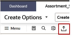

  1. To import placeholder positions, click the Import Positions icon on the Quick Access Toolbar as shown in Figure 14-20.
    Alternately, select the Import Positions menu item in Action Menu or perform a contextual launch of Import Positions.

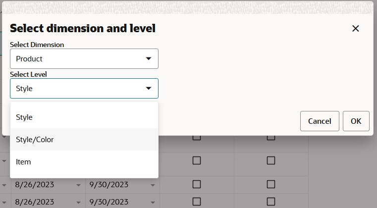

  2. Select the dimension and level.
    After clicking the Download DPM Import File Template icon, you are presented with the Select Dimension and Level dialog box. Select the dimension you want to import (for example, Product, location) and then select the level for the specific Dimension (for example, the Product dimension levels can be Style, Style/Color, Item).
    Click OK to download a template for the selection dimension and level. You can import up to the lowest level of the dimension supported by the workbook.

  4. As the upload occurs, it loads the position list to the Figure 14-24 where you can validate and correct any errors.
    To add the positions, click OK.
    Figure 14-24 Add Product Window
    Add Product Window
Points to Remember when Importing Placeholder Positions
  • The item level position adding is enabled only in Item planning.
  • The entry in format for Dimension, Level, and Attribute name should be same as given in format. If the value entered is incorrect the DPM import will fail and it shows an error describing which row has the issue.
  • The image uploaded for the position defaults to both the thumb and full image. The image is designated as the main facet for the First Media Attribute.
  • The value of attributes, parent label can be added or changed post uploading the template in the Figure 14-24.
    The DPM import shows an error if there is an attribute value not entered or faulty while uploading. Figure 14-25 displays an example of import errors. Fields with errors can be modified on the Add Product dialog window
Figure 14-25 Highlighted Errors in the Add Product Window
Depending on the hierarchy, the file is validated for the rows to select levels and attributes accordingly. You can only create the new levels for which DPM is enabled.
Add Images for a Placeholder Position
You can add an image URL for informal positions from the Add Product window. The image URL added for the position defaults to both the thumbnail and full size image designated to the main facet for the first media attribute. The image URL field is an optional field, so you can skip the specification of an image.
You can add bulk images along with the Excel template while importing the placeholder position. The Excel template for DPM has the field for entering the image URL. The image associated with the placeholder position helps in visual reference for the planner.
To add an image from the Add Product window, then enter the valid image URL in the first input text field provided. Along with the text field, you see an error icon at the row header when the image URL is not valid. The image URL field is also highlighted by a red boundary when there is an error as shown in Figure 14-27.
Figure 14-26 Image URL - Add Product
Figure 14-27 Error Validation in Image URL
Validations in Add or Modify Product Windows
With the placeholder positions you are trying to import, add, modify or delete, you can see an error icon at the row header for any validation errors on the product hierarchy or attributes associated to the placeholder item. The fields that have errors are highlighted by red boundaries. When you hover over the error icon, a tool tip with the following message appears: Some options are not valid. Check the spelling or ensure your workspace is up-to-date.
Figure 14-28 Validation Errors
Validation Errors
If the attribute values entered are not valid, the following message appears, Some of the Attribute values entered are not valid. Please select a valid attribute value or remove the invalid value.
