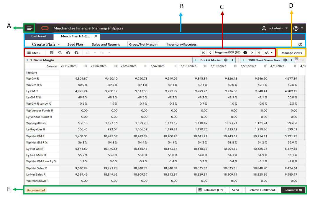

This chapter introduces you to the user interface for the workspace and describes the screen components labeled in Figure 2-1.
Figure 2-1 User Interface
User Interface
Key for Figure 2-1:
A: Navigation Menu
B: Mega Menu
C: Quick Access Toolbar
D: View Management
E: Action Buttons

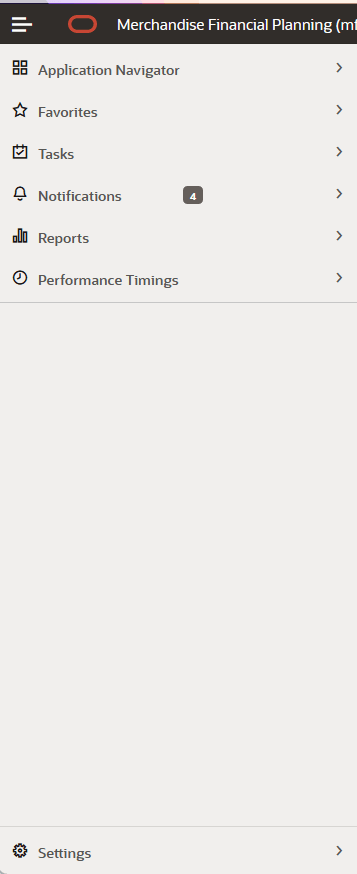

Navigation Menu
The Navigation menu contains the following options:
Figure 2-2 Navigation Menu
Navigation Menu

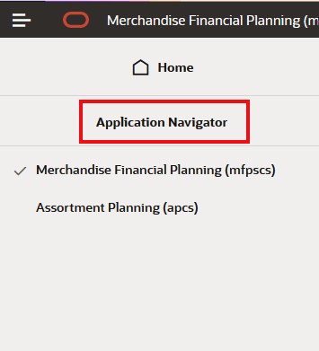

Application Navigator
The Application Navigator displays the list of authorized applications beneath its menu. You can switch between applications that are launched in separate browser tabs. You can see the dashboard profiles and specific tasks based on the selected application.
Figure 2-3 Application Navigator to Access Applications
Application Navigator to access applications

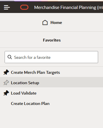

Favorites
The Favorites option provides you the ability to bookmark the templates that are often used. It provides quick and easy access to frequently used work flows. These bookmarks save you navigation time through the task list. For more details, refer to Favorites in this guide.
Figure 2-4 Favorites
Favorites

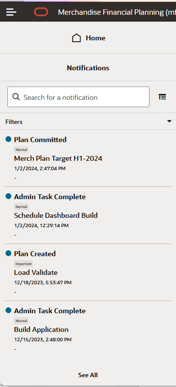

Notifications
You can use the Notifications module to determine the status of different RPASCE activities, such as Online Administration Tasks, segment build completions or failures, segment commit completions or failures, approvals and rejections, and so on.
Figure 2-6 Using Notifications
Using Notifications

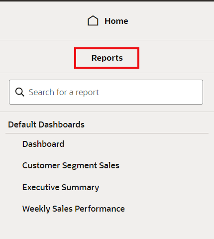

Reports
You can use the Reports module to view the reports or dashboards available with in the application. Also use this module to link Data Visualization (DV) Reports. You can launch DV reports from the Planning application into separate browser tabs. For more details on linking DV reports with the Planning application, refer to the Oracle Retail Predictive Application Server Cloud Edition Administration Guide.
Figure 2-7 Reports Module
Reports Module

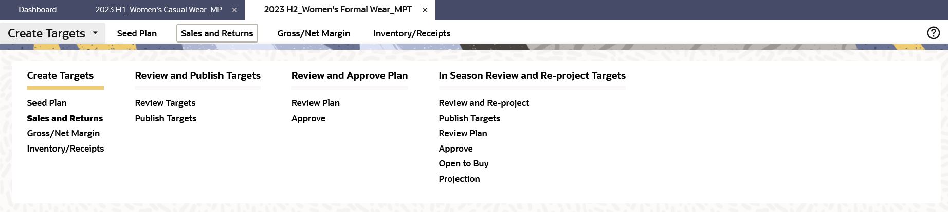

Mega Menu
Once a task or workspace is open, you can use the Mega Menu to access the different workflow steps for each task.
You can move between the different steps within a task without reopening a segment or going through the wizard process again.
Each step has different views to choose from in the View Manager on the right side of the screen. You can use each view to complete a different type of activity.
Figure 2-8 Mega Menu
Mega Menu

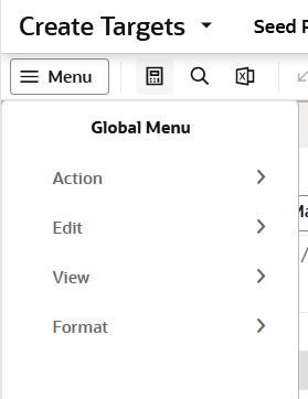

Menu
Menu contains the following menu options:
  • Action menu
  • Edit menu
  • View menu
  • Format menu
Figure 2-10 Quick Access Toolbar Menu Options

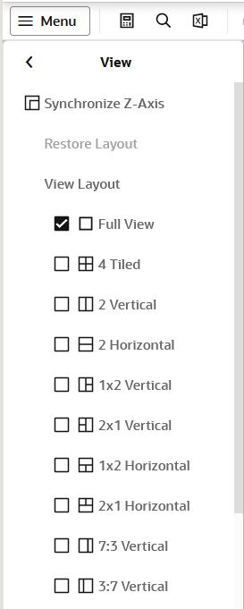

View
Synchronize Z-Axis
Restore Layout
View Layout

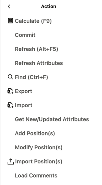

Action Menu
This section describes the Action Menu options.
Figure 2-11 Action Menu
Action Menu
Table 2-2 Action Menu Options
Menu Option Description
Calculate (F9)
After you edit the cells within the workspace, use the Calculate menu to calculate and update the associated cells within the workspace.
Commit
Use to commit the changes to the master domain. After the changes are committed, all other users with access to the workbook will see the changes as well.
Refresh (Alt + F5)
Use to update a workspace with the data that is currently stored in the domain. This allows you to work with the most current data without having to rebuild the workspace. Workspaces can be refreshed with a single refresh rule group or multiple ones.
Make sure to switch on the FnLock key if present on your keyboard in order to use this shortcut.
Note: Depending on system configuration, the Refresh option may be disabled when no valid refresh rules are available for the workspace.
Refresh Attributes
Use to update the attribute values displayed in the pivot table. Manually trigger this action to get the latest attribute values in order to plan more accurately. This action is separate from the Refresh action.
Find (Ctrl + F)
Use to search for a string within the rows and columns of the current view. The search does not include the data within the cells of the view.
Export
Use to export the data from view to excel or text file.
Import
Allows you to transfer large amounts of data to a pivot table using an Excel spreadsheet. You can upload writable measures using a template without the assistance of an Administrator.
Get New/Updated Attributes
Newly created or updated attributes and attribute values using Placeholder Maintenance will be made available for use throughout the workspaces.
Add Positions
Use to add new placeholder positions using the Placeholder Maintenance functionality
Modify Positions
Use to modify or delete the already created placeholder positions using the Placeholder Maintenance functionality
Import Positions
Use to manually import a list of placeholder positions that you have already entered into an Excel file format.

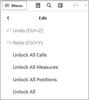

Edit Menu Options
This section describes the Edit Menu options.
Figure 2-12 Edit Menu
Edit Menu
Table 2-3 Edit Menu Options
Undo (Ctrl + Z)
Use to undo the last action performed within the workspace (not just the current view).
Redo (Ctrl + Y)
Use to redo the last action undone within the workspace (not just the current view).
Unlock All Cells
Use to unlock all the locked cells on the current view.
Unlock All Measures
Use to unlock all the locked measures on the current view.
Unlock All Positions
Use to unlock all the locked positions on the current view.
Unlock All
Use to unlock all the locked cells, measures and positions simultaneously on the current view.
View Menu
This section describes the View Menu options.
Figure 2-13 View Menu
View Menu
Table 2-4 View Menu Options
Synchronize Z Axis
Use to simultaneously scroll through the page edge of multiple views. It is useful when you want to compare multiple views containing the same page or slice dimension.
Restore Layout
Use to restore view layout size to default. Restore Layout will be enabled only when you resize the view manually.
View Layout
Select a view layout from the options available to see a single or multiple views at a time.

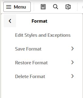

Format Menu
This section describes the Format Menu options.
Figure 2-14 Format Menu
Format Menu
Table 2-5 Format Menu Options
Menu Option Sub-Menu Description
Edit Styles & Exceptions
Opens the Format window. Here, you can set and clear formats that apply to measures or dimensions. You can make changes to single or multiple measures and dimensions and apply those changes across one, many, or all views in the workspace. For more information, see Formatting.
Save Format
Only For Me
Save the format only for my use.
For My Group: Group Name
Save the format for my group. All the users in the group are able to see and edit the formatting.
Workspace Template
Save format to the workspace template.
Restore Format
From Template
Restores my current formatting to the saved workspace template format.
Restores my current formatting to my group's saved format.
Delete Format
Only For Me
Deletes the format only for me.
Deletes the format for all the users in my group.
Workspace Template
Deletes the saved format for workspace template.

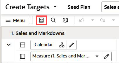

Calculate
After you edit the cells within the workbook, use the Calculate button to calculate and update the associated cells within the workspace. You can also access this option from the Action menu.
Figure 2-15 Calculate Button
Calculate Button

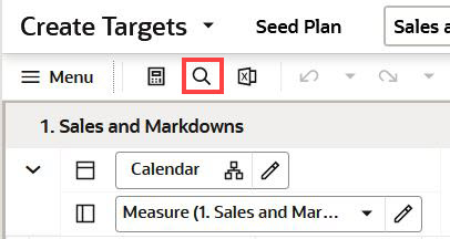

Find
You can use the Find button to find any specific string within rows and columns of the current view. You can also choose to search the string in all open views or current view of the workspace or all dimensions or specific dimensions available in the current view.
Figure 2-16 Find Button
Find Button

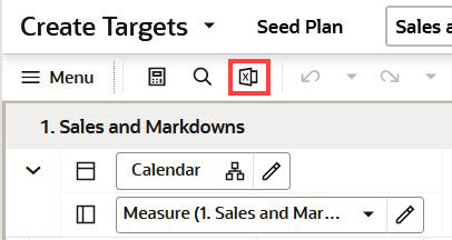

Export
You can use the Export functionality to export slices of data to a text file or to a Microsoft Excel file by using different format and export options. You can print data to an Excel spreadsheet using the Print option in the Export window.
Figure 2-17 Export Button
Export Button

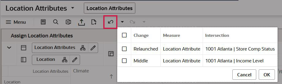

Undo
You can use the Undo functionality to undo the list of actions performed within the workspace until the last calculate operation. All the actions performed are displayed in descending order in the Undo list, and you can choose to undo the latest action or the series of actions one step at a time or all the actions performed (until the last calculate operation) by choosing the first action (the last one in the list).
Figure 2-20 Undo Button
Undo Button

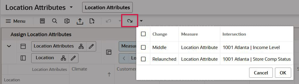

Redo
You can use the Redo functionality to redo the list of actions undone within the workspace previous to the last calc operation. All the actions undone are displayed in descending order in the Redo list, and you can choose to redo the latest action, the series of actions one step at a time, or all the actions undone (previous to the last calc operation) by selecting the first action (the last one in the list).
Figure 2-21 Redo
Redo

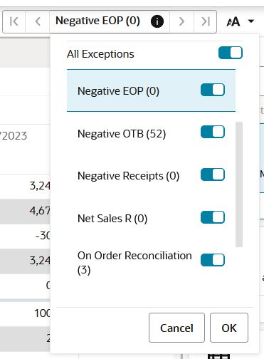

Real Time Alerts Exceptions List
Real time alerts are interactive alerts that are displayed within a workspace. The alerts are then updated each time you edit data and click Calculate. You can see the alert count and other information about the alerts as required. Clicking > or < launches the alert navigation mode.
Figure 2-22 Real Time Alerts Exception List

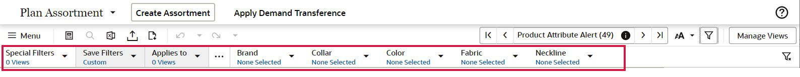

Workspace Filters
You can use the Workspace Filter Icon to view/hide the workspace filters. You can choose to enable/apply the special filters and attribute filters in a view or selected views of the workspace.

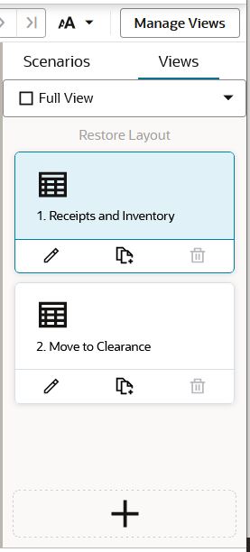

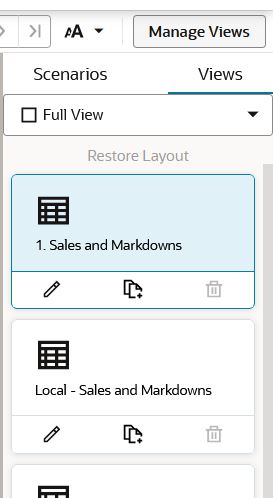

Managing Views
Click Manage Views to display the view management drawer. It allows you to show or hide the view management drawer if you need more area to view the content. When a new workspace is built, the Manage Views drawer is collapsed and hidden by default.
Figure 2-25 View Management Drawer: Show
Figure 2-26 View Management Drawer: Hidden

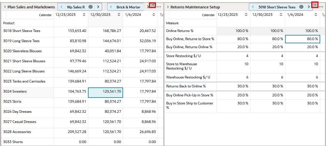

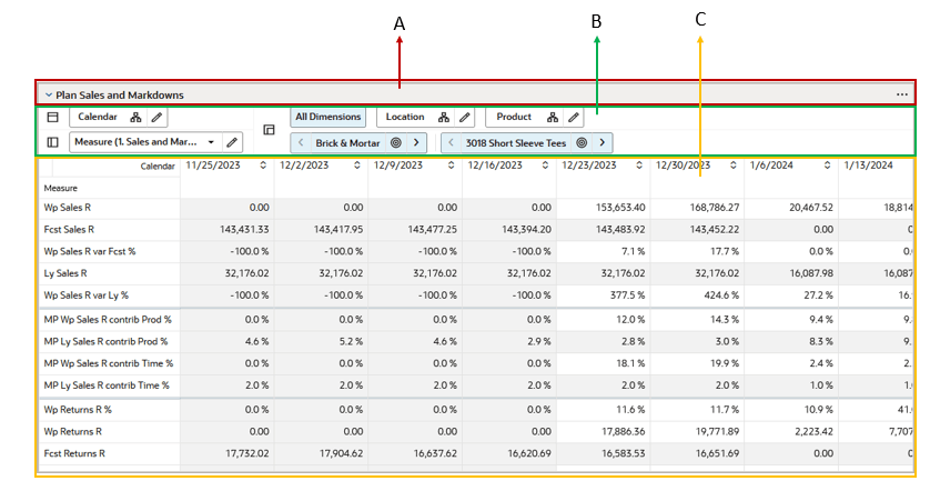

Content Area
The content area appears on the center of your screen and includes the views associated with each step within the business workflow. It provides a spreadsheet-like view or a chart type view that displays multidimensional data selected at the dimension levels in Edit view. Each view includes a set of measures relevant to the step that help you view, analyze information, and make decisions.
Figure 2-27 shows the various components in the content area.
Figure 2-27 Content Area Components
Table 2-6 describes the Content area.
Table 2-6 Content Area
Legend Area Description
A
View Title Bar
Displays the name of the View and Action menu (ellipsis icon) includes View-level actions such as Synchronize Z-axis, Switch to Chart, Edit, Expand, and Close View options.
B
Page Edge and Dimension Tiles Area
Use to move or swap individual dimensions to view the information in a more effective manner. See Page Edge and Dimension Tiles Area.
C
View Area
Displays the data either in a pivot table view or a graphical view with the help of different chart types. The data represented here is at the dimension levels and axes selected in the Page Edge and Dimension Tiles area.

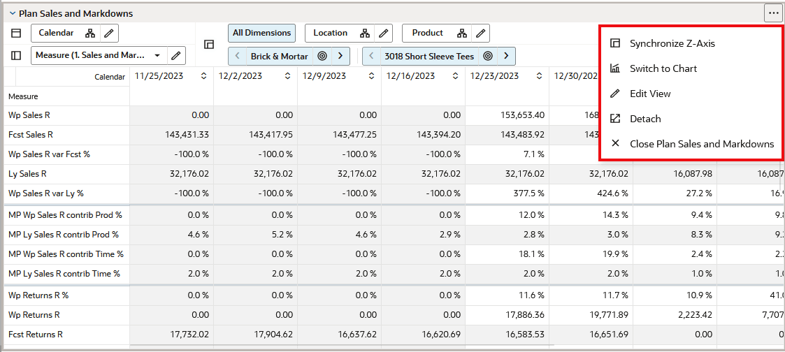

Action Menu in the Content Area
As shown in the following image, the view’s Action menu in the Content Area includes the actions for the displayed views such as Synchronize Z-axis, Switch to Chart, Edit View, Detach, and Close <View name> where <View name> is the current view.
Figure 2-28 Action Menu
Action Menu

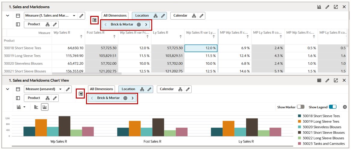

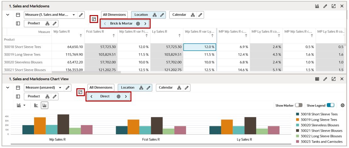

This area displays all the dimensions involved in the view. The information in the view is organized based on the dimension positions set up at the page edge, row, and column axes.
The RPASCE Client is designed to help you to work with the easy selection of dimension levels within the Edit view. You can manage the way the information is presented in a view. You can arrange and present the information in a layout you want by rotating or pivoting dimensions across the axes, changing the data roll ups and measure profiles and showing or hiding measures. You can view the information at a low level of detail or aggregate to view the information at summary levels.
When the workspace is built, the Page Edge and Dimension tile area is collapsed by default. You can expand it using the Expand/Collapse button (arrow icon) that is available from the top left side. Only the Page Edge scroll and Action menu display when the Page Edge and Dimension Tile area is collapsed.
Figure 2-29 Page Edge and Dimension Tiles Area (Expanded)
Figure 2-30 Page Edge and Dimension Tiles Area (Collapsed)

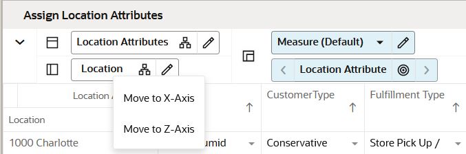

Pivoting and Rotating Dimensions
In the View area, you can rotate or pivot the dimensions across the axes to display data in different orientations. You can pivot the dimensions in two ways.
  • Dimension Move: Moves a dimensional layer to another position on an axis. To perform a dimension move, in the Dimension Tile Area click and hold the dimension tile you want to move. Then, drag the tile next to the area you want and release the mouse.
    Figure 2-31 Dimension Move - Drag & Drop
    Alternatively, you can move dimension by right- clicking the dimension tile. To move dimension tile, right- click on tile you want to move and select the destination axis option to which you require to move the dimension tile.
    Figure 2-32 Dimension Move - Right- click Option
    To move the dimension tile along the axis, right- click on the tile you want to move and select the move along axis option. This option will move the tile along the axis when two dimension tiles are placed at same axis.
  • Dimension Swap: Swaps a dimension with another dimension on the axis. To perform a dimension swap, in the Dimension Tile Area, click and hold the dimension tile you want to move. Then, drag the dimension tile over the one you want to swap it with and release the mouse.

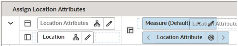

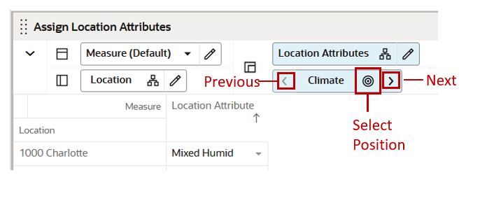

Paging and Position Navigation
On the Page Edge area, you can select any position displayed and page through or navigate to the positions using the navigation icons (Previous, Next, Select Position) available below the dimension tiles. In the view, data relevant to each position is displayed in the content area when you navigate to a new position in a level.
Figure 2-34 Position Navigation
Position Navigation

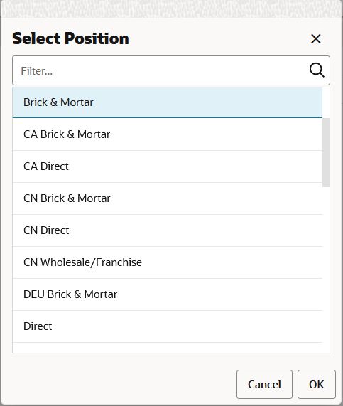

Use the Previous and Next icons to navigate to the previous and next position in the level that is selected. The position to which you navigate depends on the current position. When you navigate to a new position, all associated positions at the higher and lower visible levels of the same dimension are updated recursively.
The Select Position icon opens a Select Position pop-up, which you can use to directly select the required position from the available list of positions.
Figure 2-35 Select Position
Select Position

Synchronize Z-axis Scrolling
Synchronized Z-axis scrolling lets you simultaneously scroll through the z-axis of multiple views. When Synchronized Z-axis scrolling is enabled, all views that contain the same slice dimension scroll to the new slice position when one of those views is scrolled to a new position. When scrolling is disabled, scrolling through slice positions in one view does not affect the slice position display of other views.
Synchronized Z-axis scrolling works for all views within a single workspace, and it remains enabled as you move through the tasks and steps within that workspace. Synchronized Z-axis scrolling is useful when you want to compare multiple views containing the same page or slice dimension.
To enable synchronized Z-axis scrolling, click Synchronize Z-axis icon in the Z-axis and Dimension Tiles area, as shown in Figure 2-37.
When the Page Edge and Dimension Tile area is collapsed, you can synchronize the Z-axis using the view's Action menu. In the collapsed Page Edge area, a synchronized view is displayed using the Z-axis synchronized icon, as shown in Figure 2-38.
Figure 2-36 Before Synchronizing Page Edge (Z-axis)
Figure 2-37 Enabling Synchronize Z-axis
Figure 2-38 Z-axis Synchronized In the Collapsed Page Edge Area
The View Management Drawer shows the different views available for the tasks and steps. You can drag an existing view into the Content area to activate that view. You can choose to display one, two horizontal, two vertical, or four views at one time to view in the content area. You can also click + to add a new view, modify an existing view, or delete an existing view.
Figure 2-39 View Management Drawer
Action Tray
The Action Tray includes Application Actions and System Actions. Application actions are specific to different applications configured in RPASCE. System actions are common across all the views, irrespective of the application.
Examples of Application Actions include Seed, Refresh Fulfillment, Submit Plan, Approve Plan, Copy Approved Plan, and so on in MFPCS and Seed Sales, Calculate What-If, Flow Receipts, Approve Plan, and so on in APCS. Application Actions are highlighted in red in Figure 2-40 and Figure 2-41.
The System Actions allows you to Calculate. System Actions are highlighted in green in Figure 2-40 and Figure 2-41. As you can see, they are common across different applications, in this example across both MFPCS and APCS.
Figure 2-40 Example of Application Actions and System Actions in MFPCS
Figure 2-41 Example of Application Actions and System Actions in APCS
