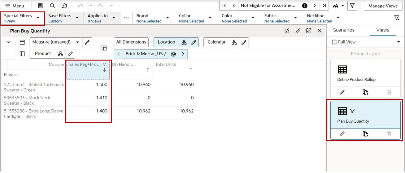

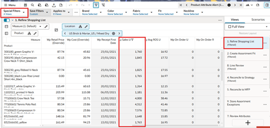

When you apply a measure filter over special filter you can see the position matching with measure filter and special filter criteria. Figure 17-10 shows the combination of special filter (Filter by NGF Items) and a measure filter (Ly Sales U greaer than and equal to 1000).
Figure 17-10 Special Filters and Measure Filters
