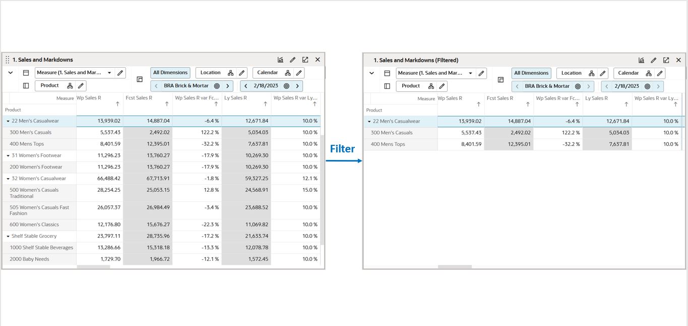

  • When applied to the current view it acts as a rapid show/hide, hiding all non-selected cells.
  • When using selections in the current view to filter a second view, all dimensions that are common in the second view will be filtered.
In Figure 16-1, a set of positions is selected in a single view. When position filtering is applied, the cells displayed in the view are reduced to those specified by the selected positions.
Figure 16-1 Position Filtering in a Single View

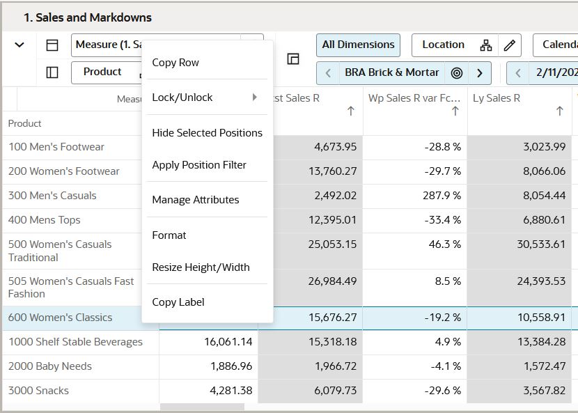

Initiating Position Filtering
The position filtering option is available from the menu when you right- click on a position from the selected rows or columns or a specified set of cells. Note that the position filter cannot be applied to the Measure dimension; as a result, the Apply Position Filter context menu is not available for measures.
Selecting from a Row or Column
Position filtering can also be initiated by selecting rows or columns. The right- click menu can be used to initiate position filtering, as shown in Figure 16-3. It can be applied to the current view or to other views in the worksheet.

Selecting from Cells
Position filtering can also be initiated by selecting one or more cells using the right- click menu, as shown in Figure 16-4. It can be applied to the current view or to other views in the worksheet.

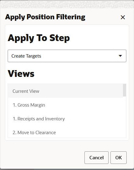

Using Position Filters
Position filters can be applied to all views in the current workbook.
  • You can filter the current view. The current view will be filtered to show only those rows and columns selected in the filter. This is equivalent to using the Show and Hide options in the Edit View window for any dimension.
  • You can filter another view in the workbook. For this to be effective, the workbook template must be configured with two or more views. There must also be one dimension hierarchy in common with both the views or a filter cannot be applied.
If the worksheet template is only configured to show a single view, only the Current View option will be available in the Apply Position Filtering window.
In Figure 16-5 and Figure 16-6, a worksheet has been opened for the Curve by Assortment step. The available views are the Current View: 1. Approve and 2. View Assort Period. The previous task (Define Curves) also has three views available: 1. Define Parameters, 2. Define Curves, and 3. View Sales Source.
  • If you select one of the other views in the current step (Approve or View Assort Period), the selected view will be filtered to show only the specified data.
  • If you select a view in the Define Curves step, the views will switch to the Define Curves step views and the specified view will be filtered to show only the specified data.

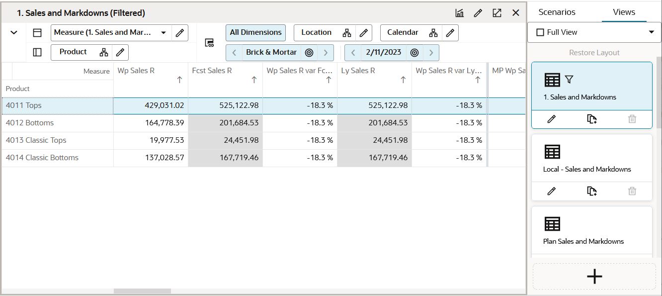

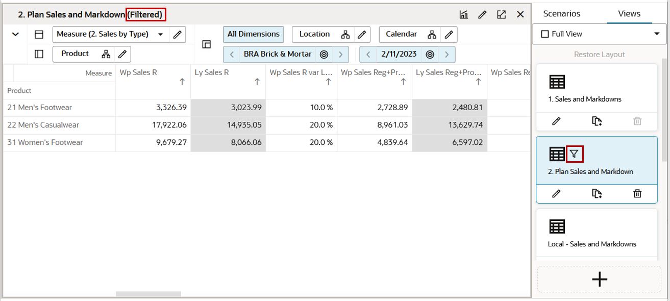

After the filter is applied, you will receive a snack bar notification. The view title will be appended with (Filtered) text and a funnel (filter) icon will be shown in the view tile in Manage Views, as shown in Figure 16-7.
Figure 16-7 Position Filtering Icon and Filtered View

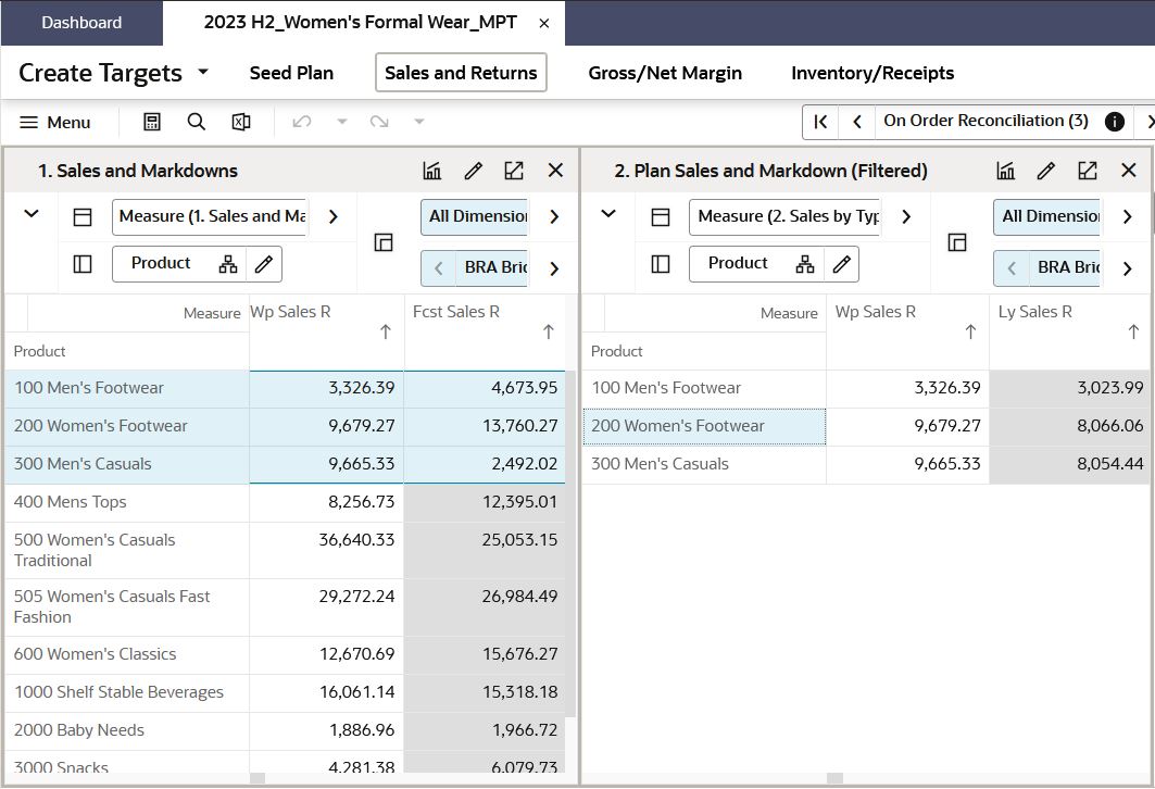

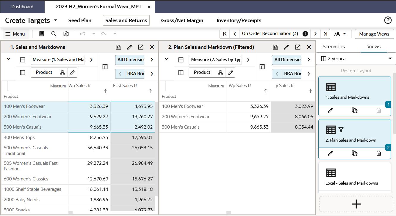

Applying Position Filters Example
In the example shown in Figure 16-9 and Figure 16-10, two views are open. A set of positions are selected in the left hand view and the right hand view is selected from the Position Filtering option using the right- click menu.
Figure 16-9 Position Filtering: Stage 1 Example
The positions selected for position filtering are highlighted during the selection process. They remain highlighted after the position filtering operation so that the user can see which rows are in use for position filtering.
Figure 16-10 Position Filtering: Stage 2 Example
When the position filter is applied, the right hand view is restricted to those positions selected with the position filter in the left hand view. Filtering is based on all dimensions found in the row, column, and page (x, y and z) axes.
In the example shown in Figure 16-9 and Figure 16-10, the position filter has been used in the left hand view to select a subset of items from the total range available. The right hand view now only contains data restricted to this items.
For example, you may want to isolate data restricted to a range of items covering a promotional campaign for those particular products. As the promotional campaign may increase the quantities sold over the duration of the promotion, position filtering can make it easier for you to focus on the data pertinent to an advertising campaign.
This is an effective way to open a workbook with a large amount of data and then use position filters to isolate a subset of the data to edit.

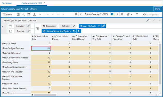

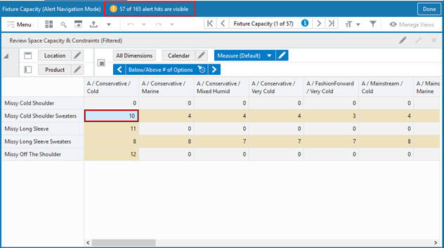

Page Edge Synchronization
When a position filter is applied, the information in the page edge is also filtered. If the Synchronize Page Edge option has been selected, synchronized page edge navigation may not always be possible if a position filter has been applied.
Figure 16-11 Position Filtering: Page Edge Synchronization
In Figure 16-11, a position filter has been applied to View 2. Review Space Capacity & Constraints. This results in a single position, A/Cold/Conservative. If you now go to View 1. Determine # of Options and use the page edge controls to scroll through the available locations, View 2 cannot synchronize because it only has a single location position. This situation will persist until more locations are made visible when another position filter is applied (or the Show and Hide option is used).

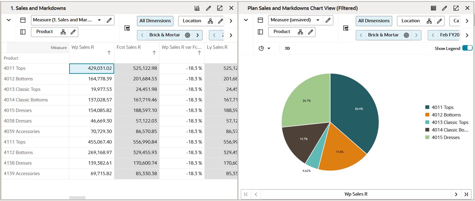

Position Filtering and Charts
Position filtering updates charts. Where positions are hidden by the position filter, the graph is updated to reflect the changed data. In Figure 16-12, the pie chart is showing data for all stores in the district of France.
Figure 16-12 Chart Before Position Filter is Applied
A position filter is then applied. As a result, the district of France is filtered so that only three stores are visible. The pie chart is updated accordingly, as shown in Figure 16-13.

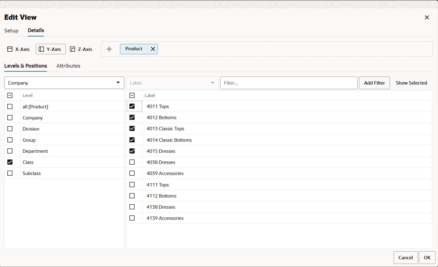

Position Filtering and Hidden Positions
Position filtering only operates on visible measures. In addition, if the measures are hidden when the filter is applied, they will remain hidden after the filter has been applied. In order to see which measures are hidden, open Edit View for the required dimension. The Details Tab shows which measures are visible and which are hidden, as shown in Figure 16-14.
Figure 16-14 Edit View: Details Tab

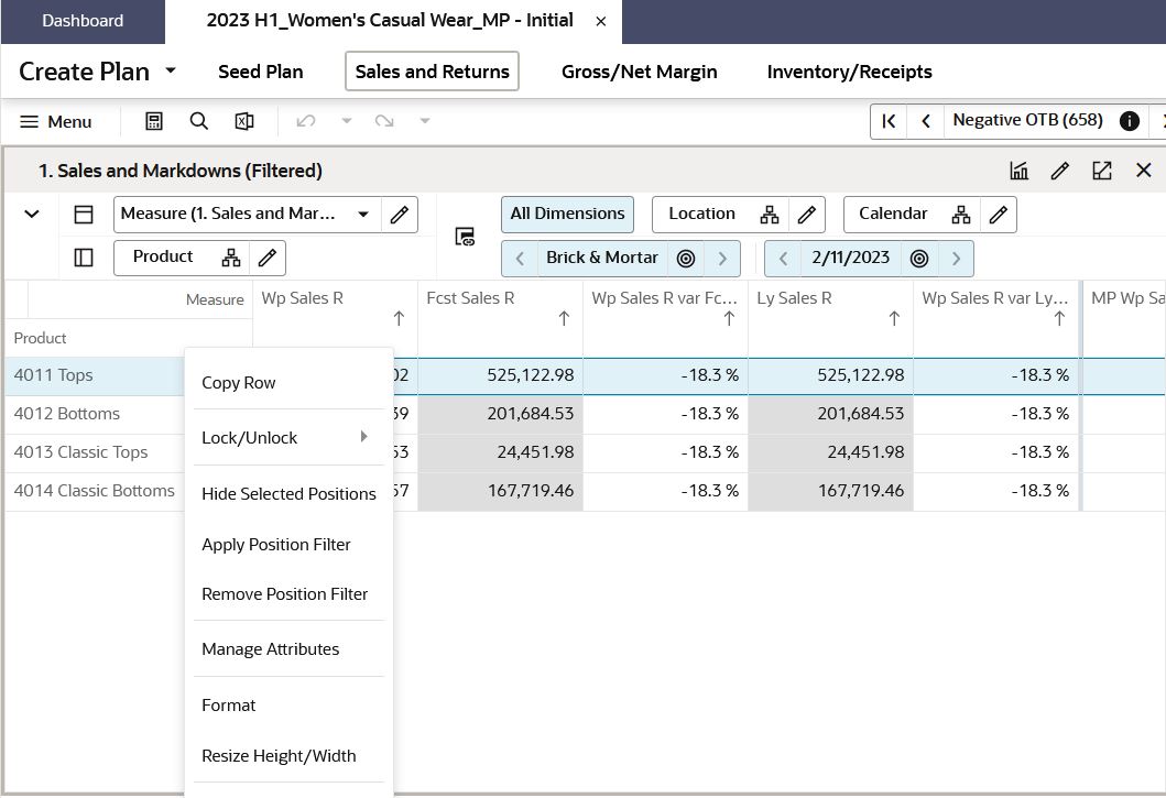

Removing Position Filters
Once applied, position filters can be removed using the Remove Filter option available from the right- click menu, as shown in Figure 16-17. This option is not available until a position filter has been applied.
If show or hide is applied from edit view over position filter results, then you cannot see the Remove position filter option.
Figure 16-17 Remove Position Filter Option Enabled
