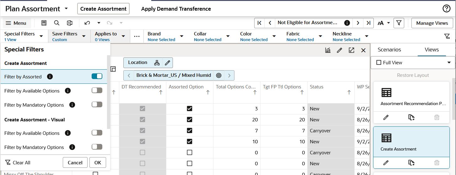

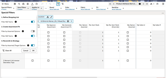

Special Filters Definition
You can select the Special Filters Definition that must apply. The Special Filters Definition is also known as the Position Query Definition (PQD).
You can select the special filter from the Special Filter drop-down list. The special filter drop-down list has the filters listed per views. To apply special filters, you can slide the toggle to on or off.
Special filters can be configured to be either on by default or off by default. When a filter is set to be on by default, the application initially displays only the filtered results, and users can toggle the filter off to view all positions. Conversely, when a filter is set to be off by default, the application shows all positions first, and users can toggle the filter on to display only the filtered results.

Applying Special Filters

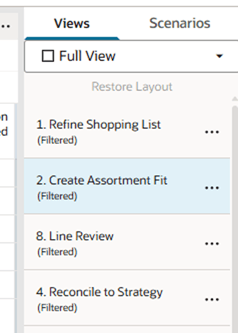

Once the special filter is applied, the positions that do not match the criteria are hidden. You can verify positions using Edit View to view the positions in the hidden area. Any positions that were manually hidden previously will be unhidden if they match the special filter.

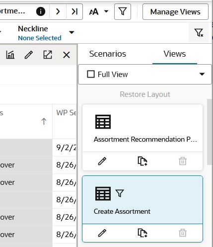

When the special filter is turned on, the Filtered indicator is visible to the view in the view management drawer.
Special filters operate by filtering the positions of the dimensions on the row and the column axes based upon the selected position of one or more dimension on the page axis. As the selected position on the page axis changes, the set of visible row and column positions will update automatically.
Not all dimensions on the page axis necessarily affect the row and column position filtering. Those dimensions that do affect the filter are called driving dimensions.
Special filters are auto-applied when the workbook is built.

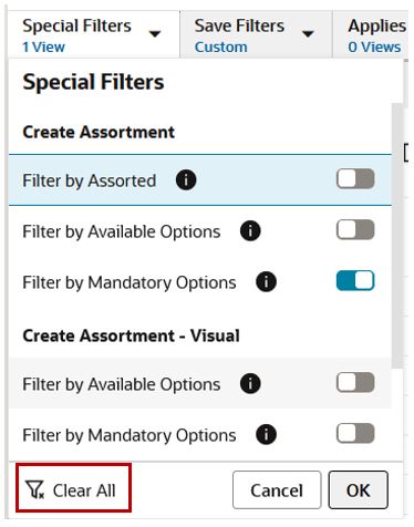

You can clear all the special filters applied by clicking on the special filters LOV, clicking Clear All, and then clicking OK.

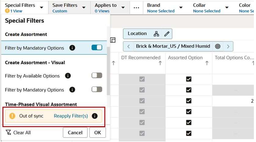

Out of Sync Special Filters
Planners may need to apply a manual show or hide over special filter result for analyzing the data. In such case, an out of sync alert is highlighted in the Special Filter drop-down list. This helps you to highlight that there has been manual show or hide applied over the special filter result.
You can see the out of sync alert icon i highlighted on the Special Filter header. Click the Special Filter drop-down to see an Out of Sync alert at the bottom of the list with a Re-apply Filters link. To revert back to the special filter result, click the re-apply filter link which re-evaluates the filter and hides the manual show or hide updates.
With the manual show or hide applied over the special filter result and you move the page edge scroll to another page, the special filter result will not re-evaluate. In such a case, an out of sync alert is highlighted in the Special Filter drop-down list. You can choose to work with the selection or click the Re-apply Filter link to re-apply special filter.
Figure 13-7 Out of Sync and Reapply Filters Link

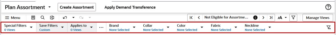

Attribute filters are present, along with the special filters, in the workspace Filters bar and can be used to apply, modify, and remove position filters based upon the attribute values of the positions.

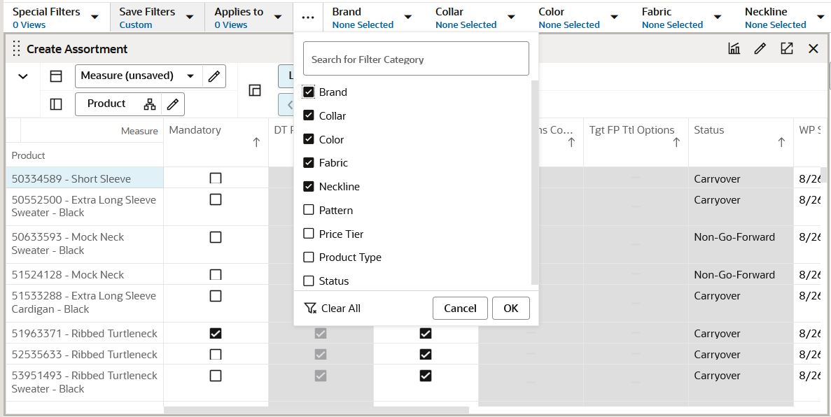

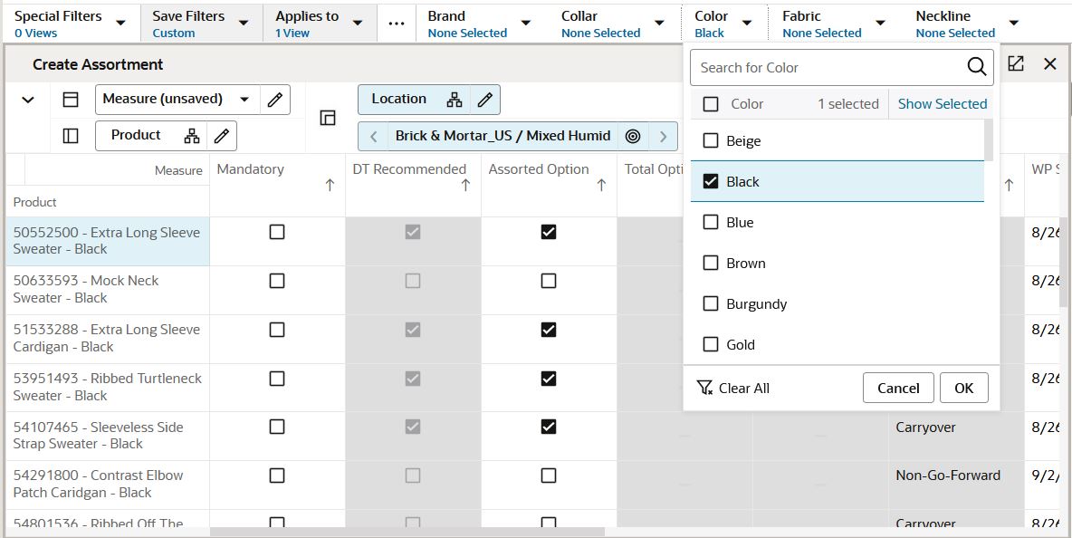

Attribute Filter Category
You can select or hide the attribute filters from the Filter Category selection menu. The number of categories selected as filters cannot exceed five. If this value is exceeded, OK is unavailable. The first five attribute filters are displayed on the filter bar by default.
Figure 13-9 Attribute Filters Category
You can also search for the Filter Category. The Clear All button can be used to clear the selections. Click OK to see the selected filters on the bar. Special Filters are managed separately from attribute filter categories. Use the Special Filters control to turn individual special filters on or off.
Hiding a filter category will also remove its applied filters. It is assumed that the attributes are unique across levels, that is, the same attribute cannot exist in multiple levels.

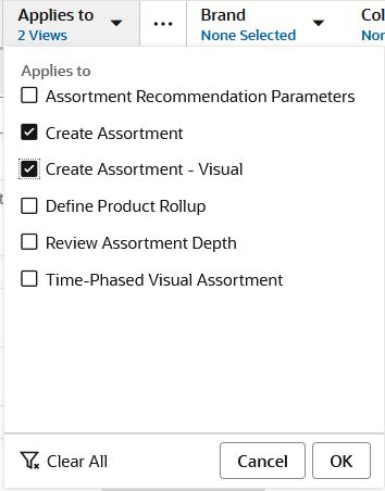

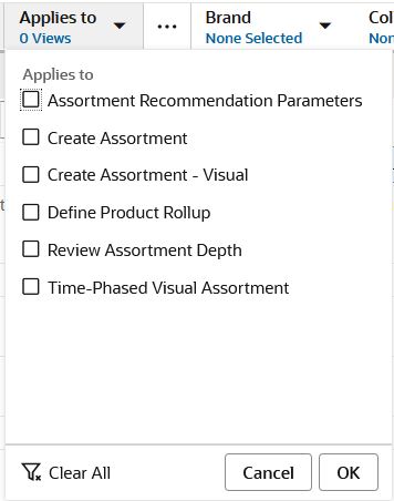

Applying Attribute Filters
You can select the views that the selected attribute filter must apply to: either one view, a number of views, or all views under the tab. Click OK to run the attribute filter. Once the attribute filter is applied, the positions that do not match the criteria are hidden. You can verify the positions using Edit View to view the positions in the hidden area. Any positions that were manually hidden previously will be unhidden if they match the attribute filter.
Figure 13-10 Apply Attribute Filters
When the attribute filter is turned on, a filter icon is applied to the view in the view management drawer. Attribute filters operate by filtering the positions of the dimensions on the row or column axis, based upon the selected attribute of one or more dimensions.
You can clear all the attribute filters applied to a view when you click the Applies to LOV and then click Clear All, and finally click OK.

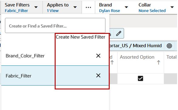

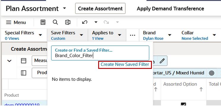

Saving Attribute Filters
Once you have selected the attribute filters and their values, you can save the filter selections for later use. Saved Filter represents a combination of attribute filters only; it does not contain special filters or views.
Figure 13-12 Save Attribute Filters
To create a new saved filter, type in the filter name and click Create New Saved Filter to add Brand_Color_Filter to the list of saved filters. To select an existing saved filter, select it from the list of saved filters. To find the saved filter, enter the name of the filter in the Save Filters text box.
Deleting Saved Attribute Filters
To delete a saved filter located in Save Filters, click the X icon next to the name of the filter.

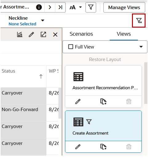

Clear Workspace Filters
To clear all the workspace filters applied, click the Filter icon that is located on the Quick Access Toolbar, and then click Clear All.
