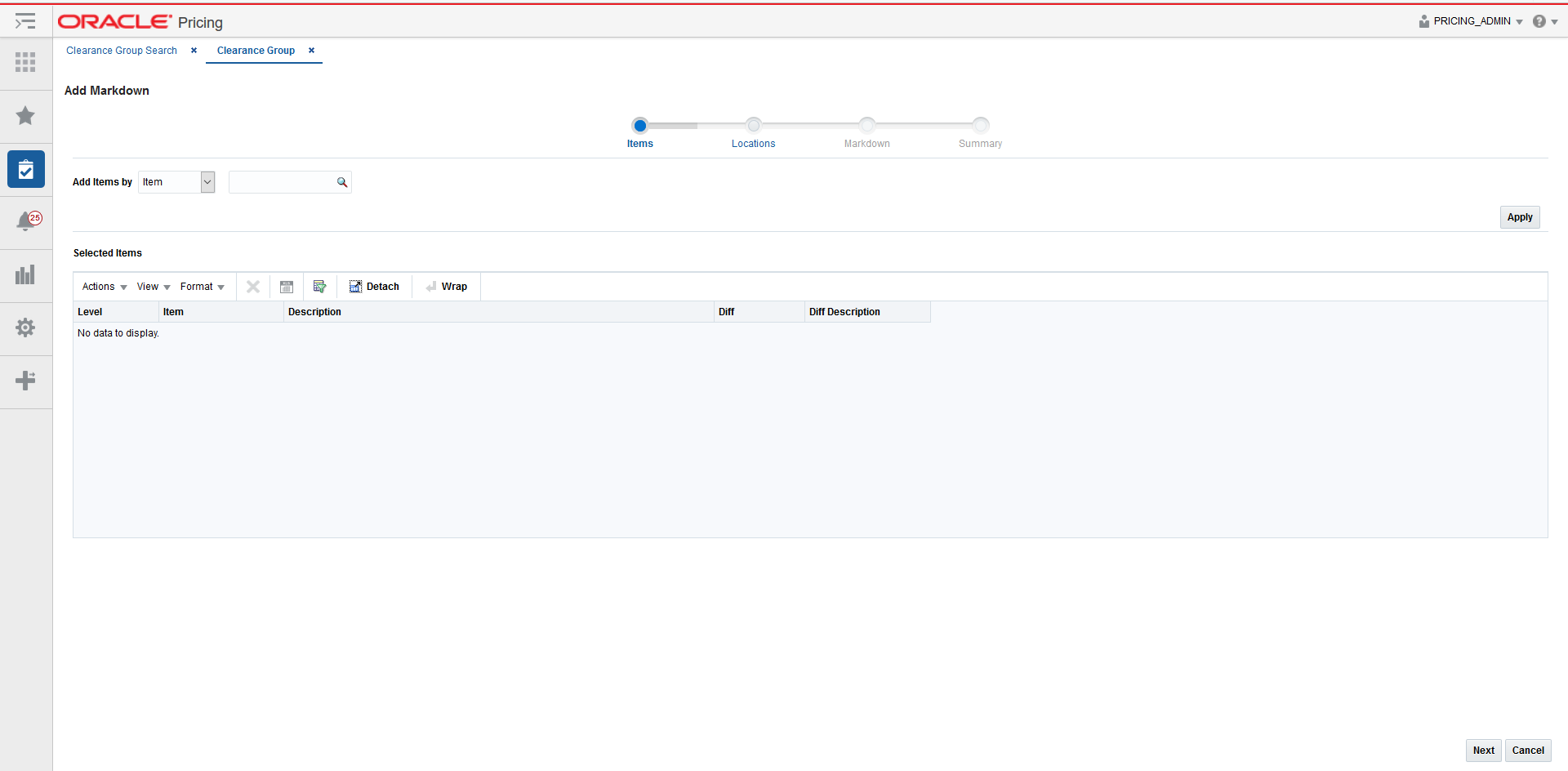

Add Items
The initial page in the Markdown Wizard allows you to select the items that you want to add to the markdown.
Figure 2-2 Add Markdown Items Page
From the Item Markdowns table, select Add from the Actions menu
The Add Markdown Wizard launches.
From the Add Markdown Items page, enter the items to add to the new markdown using the following criteria:
Table 2-1 Items Page Fields
Field Description Add Items by
The Add Items by field allows you to select a category by which you can narrow the list of things to add to the markdown. Options are:
Item
Parent/Diff
Item List
Upload List
Item
The Item field is active if you select Item in the Add Items by field. Click the magnifying glass to search for an item to add to the markdown.
Parent/Diff
When Parent/Diff is selected for 'Add Items by' the display of the screen changes, showing an item field and diff type field as the top row, with a Diffs table directly below. Entering an Item and Diff type will populate the diff table where diffs can then be selected. Combinations of the entered parent item and the selected diffs are added to the Selected Items table when the apply button is selected.
Diff Type
The Diff Type field is active if you select Parent/Diff in the Add Items by field.
Item List
The Item List field is active if you select Item List in the Add Items by field. Click the dropdown to select a defined list of items to add to the markdown.
Source File
Source File is active if you select Upload List in the Add Items by field. Click Browse to select the file to upload.
Once you have entered your criteria, click Apply to move entered or selected data for the item selection option to the Selected Items table. In the case of an Item List or Upload List, the items in the list are populated into the Selected Items table. Once all your items are added to the markdown, click Next. The Add Markdown Locations page appears. Continue with Add Locations.

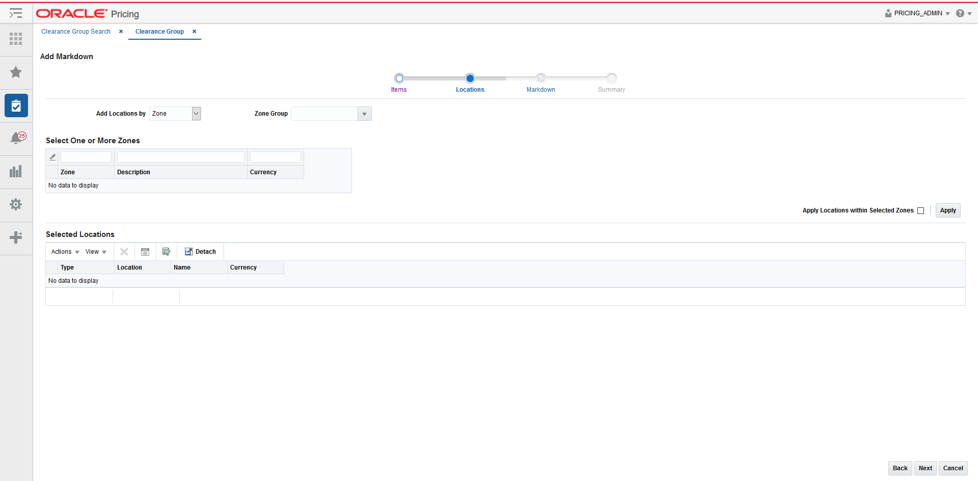

Add Locations
The Locations page of the Markdown Wizard allows you to define the locations associated with the markdown.
Figure 2-3 Add Markdown Locations Page
From the Add Markdown Location page, select the location type you want to use for adding locations using the following criteria:
Table 2-2 Locations Page Fields
Field Description Add Locations by
The Add Locations by field allows you to select a category by which you can narrow the list of locations to add to the markdown. Options are:
Zone
Location List
Store
Warehouse
Note: The Warehouse option is only displayed if the Recognize Warehouses as Locations system option is set to Yes.
Zone Group
The Zone Group field is active if you select Zone in the Add Locations by field.
Zone Table
The Zone Table is active if you select Zone in the Add Locations by field. When a zone group is entered, the Zone Table will be populated with the zones in the zone group.
Apply Locations within Selected Zones
The Apply Locations within Selected Zones check box is active if you select Zone in the Add Locations by field. This checkbox allows exploding the zone into stores and warehouses for populating the Selected Locations table. If you have access to one location in a zone, you can create events for the entire zone and markdowns can be created for all locations under the zone after exploding the zone.
Location List
The Location List dropdown list is active if you select Location List in the Add Locations by field. Click the dropdown to select from a defined list of locations to add to the markdown.
Store
The Store dropdown list is active if you select Store in the Add Locations by field. Click the dropdown to select from a defined list of stores to add to the markdown.
Warehouse
The Warehouse dropdown list is active if you select Warehouse in the Add Locations by field. Click the dropdown to select from a defined list of warehouses to add to the markdown.
From the search results pane, select the location(s) to add to the markdown and click Apply.

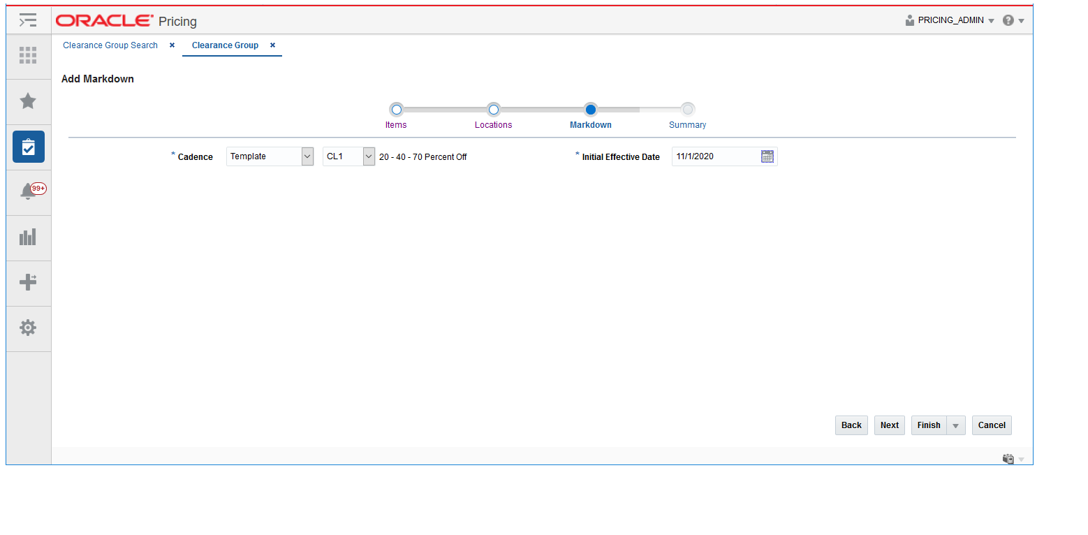

Field Description Cadence
This field is used to decide whether a single markdown or multiple markdowns will be created for each item/location combination based on the cadences in the template. The options are:
Single Markdown
Template
When Template is selected, the wizard will create multiple markdowns for the item/locations selected based on the number of markdowns defined in the template.
Template
Select the template you which to use to generate multiple markdowns for the item/location combinations selected.
This field only shown in the Cadence Template view of the Add Markdown screen.
Initial Effective Date
Enter the date on which you want the first markdown of the cadence template to take effect. The effective date of subsequent markdowns is based on the initial effective date plus the days after first markdown parameter from the template.

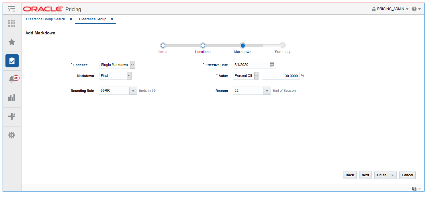

The fields described below are only shown on the Single Markdown view of the Add Markdown screen.
Markdown
The Markdown field contains a predefined identifier for the Markdown to describe what the new markdown represents in the clearance lifecycle. For example, this could be first, second, final, and so on. This field can be left blank, if not required by a system option setting.
Value
The Value field provides the options that derive the new retail price. If a system option default has been defined, a value will be automatically added for your event. But this can be changed, if desired. Options are:
Percent Off: A percent is defined in the change value field that subtracts from the retail price to determine the new retail.
Amount Off: An amount is defined in the change value field that subtracts from the retail price to determine the new retail.
Fixed Price: The item is at a specified retail that is defined in the change value field.
Note: A rounding rule may impact entered retail.
After selecting the change type, you will enter the actual value for the change. This field is required entry for every change type. The field supports up to four decimal places for Percent Off value. For Amount Off and Fixed Price decimal placement is based on currency of selected locations.
Effective Date
The date on which the markdown is set to take effect. You have the option to key in a date or select one using the calendar widget.
Rounding Rule
The Rounding Rule field provides the ability to smooth retails for an item or location.
If a system option default has been defined, a value may be automatically added to your event. But, this can be changed or removed, if desired.
Reason
The Reason value defines the reason the markdown is being created.
Once all your markdown information is entered, click Next. The Add Markdown Summary page appears. Continue with Review, Submit and Approve.

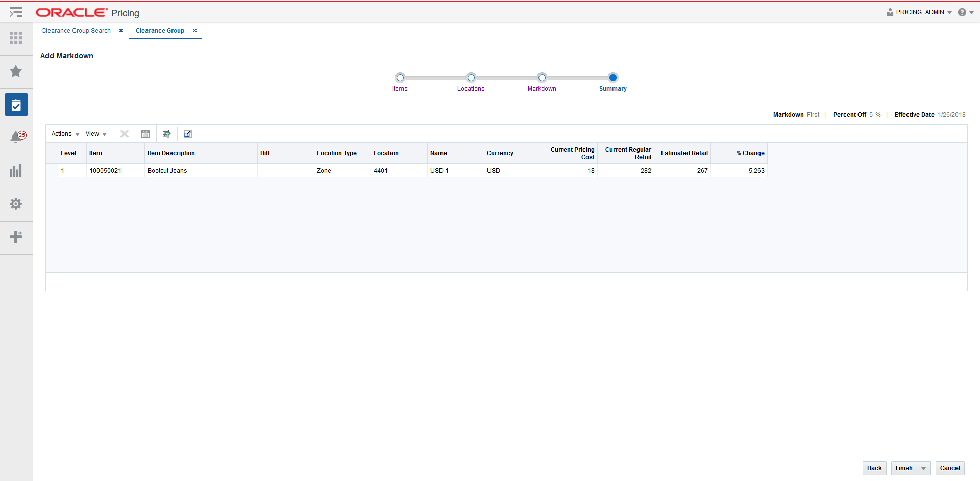

The Summary page displays the details of the markdown before it is added to the Clearance Group.
Figure 2-6 Add Markdown Summary Page
Confirm the markdown settings and click on Finish or select Submit or Approve from the Finish drop down menu. You are returned to the Clearance Group screen. Your new markdown events are listed in the Item Markdowns table.
The Summary Page also allows individual markdowns to be removed before they are added to the Clearance Group.
