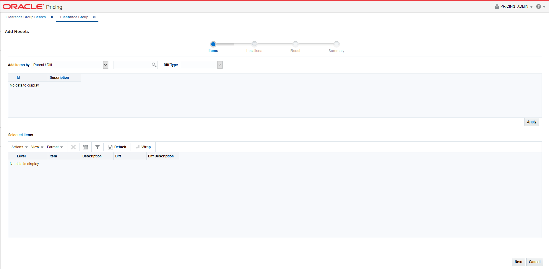

Items
The initial page in the Reset Wizard allows you to select the items that you want to add to the reset.
Figure 3-2 Add Resets Items
From the Add Resets Items page, enter the items to add to the new reset using the following criteria:
Table 3-1 Items Page Fields
Field Description Add Items by
The Add Items by field allows you to select a category by which you can narrow the list of things to add to the reset. Options are:
Item
Parent/Diff
Upload List
Item List
Item
The Item field is active if you select Item in the Add Items by field. Click the magnifying glass to search for an item to add to the reset.
Parent/Diff
When Parent/Diff is selected for 'Add Items by' the display of the screen changes, showing an item field and diff type field as the top row, with a Diffs table directly below. Entering an Item and Diff type will populate the diff table where diffs can then be selected. Combinations of the entered parent item and the selected diffs are added to the Selected Items table when the apply button is selected.
Diff Type
The Diff Type field is active if you select Parent/Diff in the Add Items by field.
Item List
The Item List field is active if you select Item List in the Add Items by field. Click the dropdown to select a defined list of items to add to the reset.
Source File
Source File is active if you select Upload List in the Add Items by field. Click Browse to select the file to upload.
Once you have entered your criteria, click Apply to move entered or selected data for the item selection option to the Selected Items table. In the case of an Item List or Upload List, the items in the list are populated into the Selected Items table. Once all your items are added to the reset, click Next. The Add Reset Locations page appears. Continue with Locations.

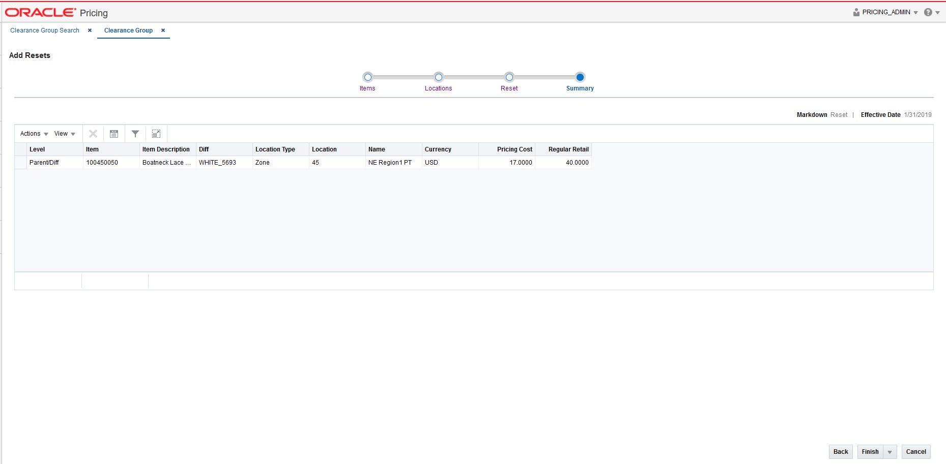

Summary
The Summary page displays the details of the reset before it is added to the Clearance Group.
Figure 3-5 Add Reset Summary
Confirm the reset details and click on Finish or select Submit or Approve from the Finish drop down menu. You are returned to the Clearance Group screen. Your new reset is listed in the Item Markdowns table.
The Summary Page allows individual resets to be removed before they are added to the Clearance Group.

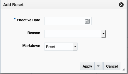

From the Clearance Group page, highlight the item markdown or location to which you want to add a clearance reset and select Reset Item from the Action menu. The Add Reset pop-up appears.
Figure 3-7 Add Reset Pop-Up
Table 3-4 Add Reset Fields
Field Description Effective Date
The date on which the clearance reset is set to take effect. You have the option to key in a date or select one using the calendar widget.
Reason
The Reason value defines the reason the clearance reset is being created. This field is optional.
Markdown
The Markdown field defaults the reset markdown value as defined in system options for the reset, but you can update, if desired.
