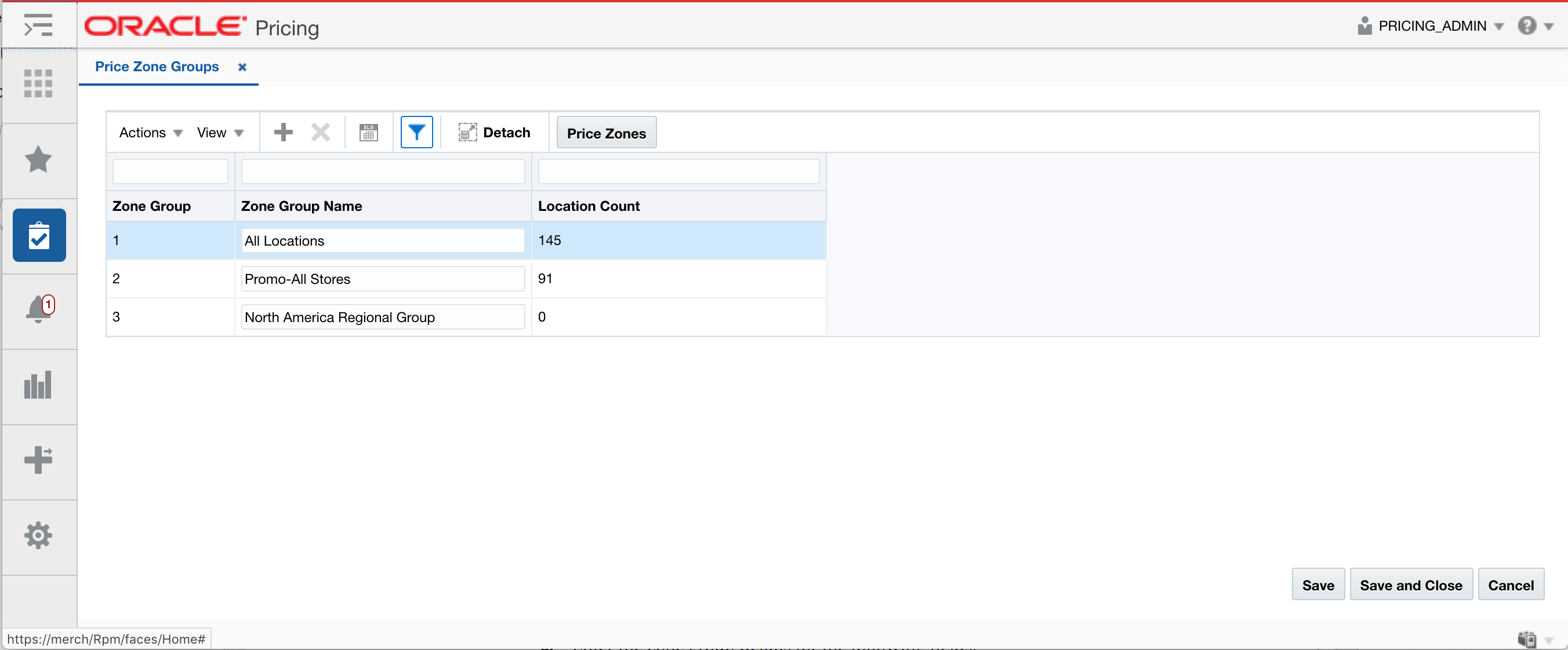

  1. From the Tasks menu, select Price Zones under Foundation Data. The Price Zone Groups tab appears.
    Figure 1-1 Price Zone Groups Tab
    price zone groups tab

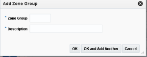

  2. Select Add Zone Group from the Action menu. The Add Zone Group dialog appears.
    Figure 1-2 Add Zone Group Dialog
    Add Zones Group dialog
  3. Enter the zone group details for the following fields:
    • Zone Group – This field is a unique price zone group identifier.
    • Description – The description of the zone group.
  4. Click OK to add the new price zone group. You are returned to the Price Zone Groups tab.
    Click OK and Add Another to add the current price zone group to the table and add another without leaving the Add Zone Group dialog.

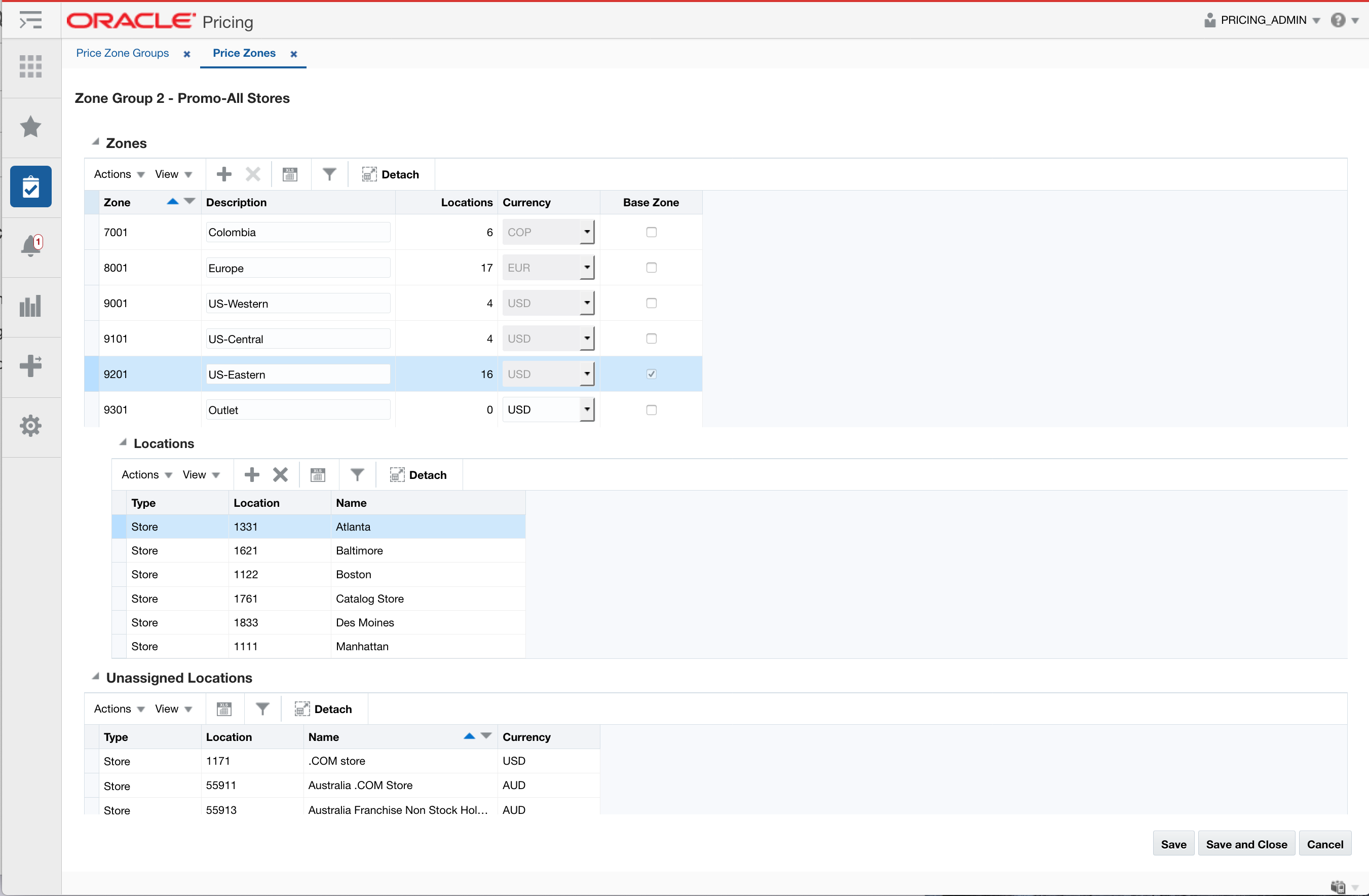

  2. From the Zone Group table, highlight the zone group you want to edit and select Price Zones from the Actions menu. Alternatively, highlight the zone group and click the Price Zones button. The Price Zones tab appears.
    Figure 1-3 Price Zones Tab
    price zones tab
  3. From the Zones tab, you can perform the following actions:
Add Zones

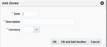

  1. From the Zones table, select Add Zone from the Actions menu. The Add Zones dialog appears.
    Figure 1-4 Add Zones Dialog
    Add Zones dialog
  2. In the Zones field, enter a unique price zone identifier.
  3. In the Description field, enter a description for the zone.
  4. In the Currency field, select the currency for the price zone from the drop-down list.
  5. Click OK to add the new zone. You are returned to the Zones tab.
    Click OK and Add Another to add the current zone to the table and add another without leaving the Add Zones dialog.

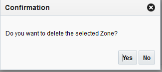

Delete Zones
  1. From the Zones table, highlight the zone you want to delete and select Delete from the Action menu. The delete zone confirmation dialog appears.
    Figure 1-5 Delete Zone Confirmation Dialog
    Delete Zone Confirmation dialog
  2. Click Yes to confirm the deletion. You are returned to the Zones tab.

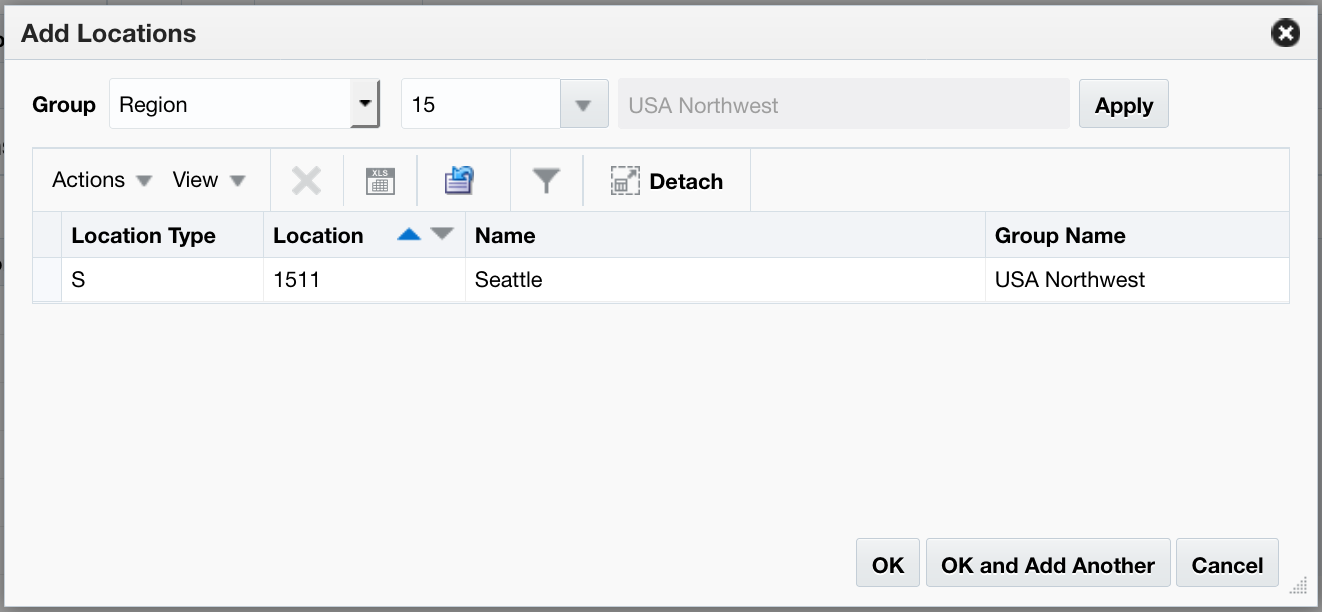

  1. From the Locations table, select Add Locations from the Actions menu. The Add Locations dialog appears.
    Figure 1-6 Add Locations Dialog
  2. From the Group field, select the group type for the location. Options are:
    • Location List
    • Chain
    • Area
    • Region
    • District
    • Store
    • Warehouse
      Warehouse is only shown as an option for group type if the Recognize Warehouses as Locations system option is enabled.
    • Unassigned Locations
  3. Once a Group is selected, select or enter a Group Value.
  4. Click Apply to add the new location to the Location table.
  5. When all locations are added, click OK to add the new locations. You are returned to the Zones tab.
    Click OK and Add Another to add the current location to the table and add another without leaving the Add Locations dialog.

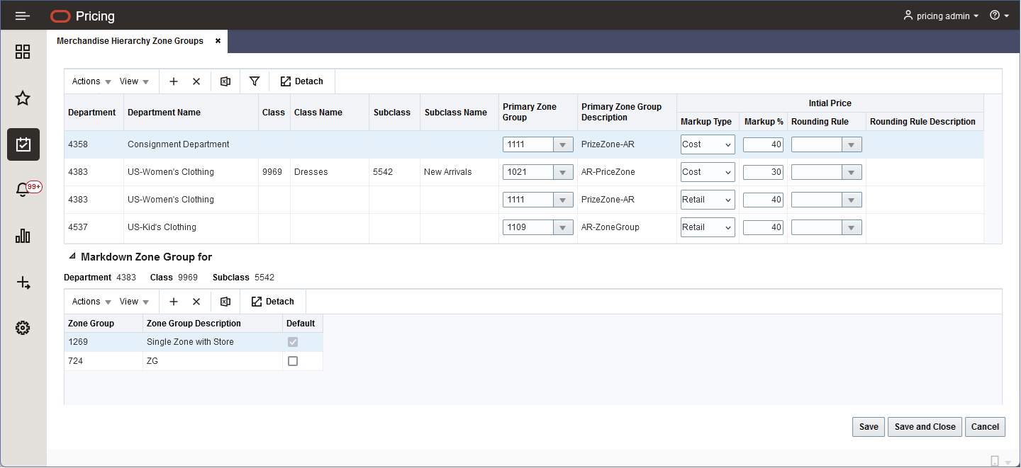

Perform the following procedure to assign a primary price zone group with departments, classes or subclasses to be used for initial price setting within Merchandising and various optimization functions such as markdown recommendations via the Lifecycle Pricing Optimization Cloud Service:
  1. From the Tasks menu, select Merchandise Hierarchy Zone Groups under Foundation Data. The Merchandise Hierarchy Zone Groups tab appears.
    Figure 1-7 Merchandise Hierarchy Zone Groups Tab
    Initial Price Zone Definitions tab

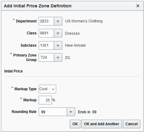

  2. Select Add from the Action menu of the top table. The Add Initial Price Zone Definition dialog appears.
    Figure 1-8 Add Initial Price Zone Definition Dialog
  3. Enter the level of merchandise hierarchy with which you wish to associate the price zone group. This association can be done for a department, a department/class, or a department/class/subclass combination:
    • Department – Enter or select a single department.
      The Department, Class, and Subclass fields have a cascading relationship. You can enter or select values for the three fields in any order but the values will vary depending on selections.
    • Class – Enter or select a single class.
    • Subclass – Enter or select a single subclass.
    • Primary Zone Group – The Zone Group specified here is used as the structure for the initial price setting for new items when added to the provided Merchandise Hierarchy. This price zone group may also be used for markdown recommendations by the Lifecycle Pricing Optimization Cloud Service if no price zone groups are added as Markdown Zone Groups for this merchandise hierarchy.
    • Markup Type – The value entered in this field determines how markup is calculated for items existing in the defined hierarchy.
    • Markup – This percentage field is used to calculate the initial retail based on the item's cost.
    • Rounding Rule – This field allows you to assign a rounding rule to the initial price zone definition. The rounding rule is used to adjust final price used for the initial price of new items to meet the retailer pricing strategy.

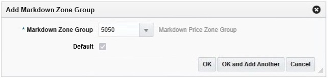

  4. Optionally, assign alternative zone groups to the merchandise hierarchy that may be used for the purposes of markdown recommendation generation in the Lifecycle Pricing Optimization Cloud Service. Select Add from the Action menu of the Markdown Zone Groups table. The Add Markdown Zone Group dialog appears.
    Figure 1-9 Add Markdown Zone Group Dialog
    Add Markdown Zone Group Window
  5. Enter the Markdown Zone Group to be associated with the merchandise hierarchy selected on the main page:
    • Markdown Zone Group – Enter or select a single price zone group as an alternative zone group for the selected merchandise hierarchy that may be used for the purposes of markdown recommendation generation.
    • Default – Indicate if the entered Markdown Zone Group should be considered the default markdown zone group for the selected merchandise hierarchy. The first Markdown Zone Group added to a given merchandise hierarchy must be flagged as the default. When subsequent Markdown Zone Groups are added, you may designate one of them to be the default. There can only be one default Markdown Zone Group for a given merchandise hierarchy.
