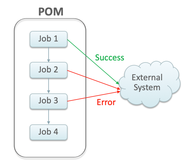

External Status Update
The External Status Update feature provides the ability for external systems to register with POM to receive the Job status notifications as a callback to their ReST interface.

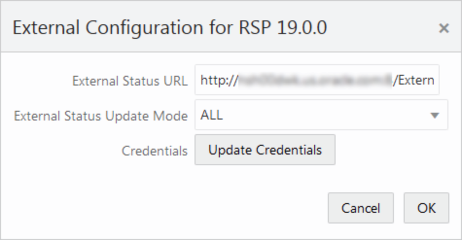

Navigate to the System Configuration screen.
Click the Edit icon on the External Configuration Panel to open the External Configuration window.
Figure 3-2 External Configuration Window
Enter the configuration values:
External Status URL - External system's URL that needs to be called for status updates.
In addition to this configuration, you must work with Oracle support to get the External Status URL allowlist.
External Status Update Mode - Choose one of the options below:
ALL - POM will send a status update to the external system for each job's execution in the schedule regardless of success or failure.
FAILED - POM will notify only for failed jobs.
NONE - No status updates will be sent by POM.
The External Status Update Mode defined on this screen applies to all the jobs in a schedule. If status update is desired only for specific jobs then set the mode on the above screen to NONE and follow the steps defined in the Job Configuration section below.
Click Update Credentials and provide the credentials for the external system.

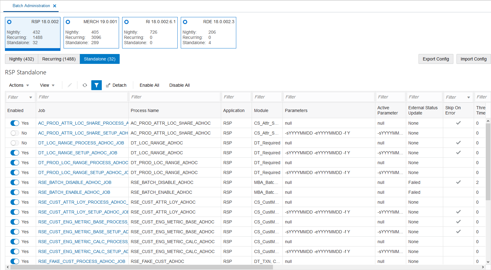

Job Configuration
This section describes the steps to configure the External Status Update Mode at job level.
Navigate to the Batch Administration screen and select the schedule to update with the external status.
Figure 3-3 Batch Administration Screen
Select one of the Cycle - Nightly/Recurring/Standalone

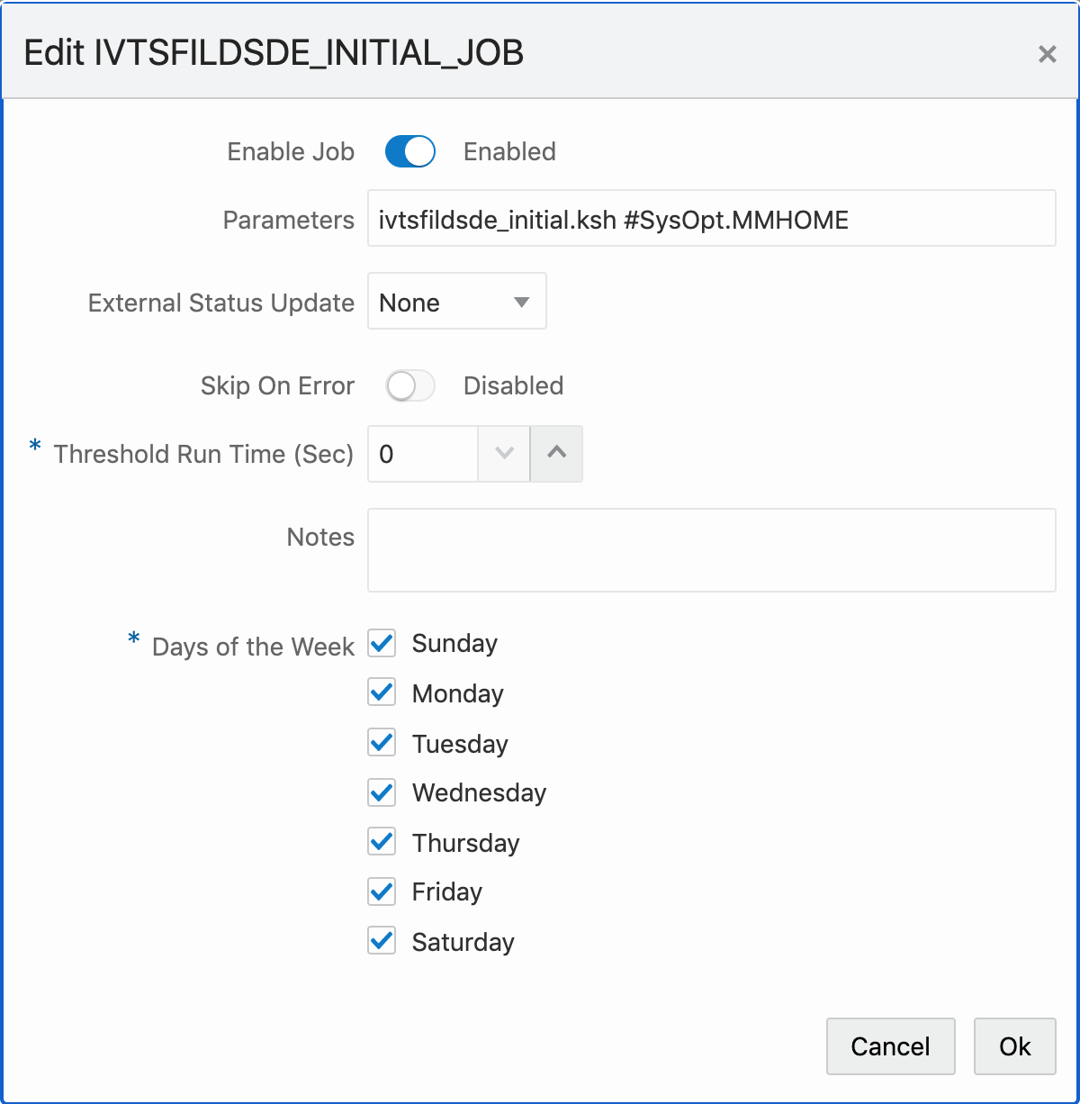

Select the Process/Job combination and click Edit from table action menu to open the popup below.
Figure 3-4 Edit Job Dialog
Set the External Status Update Mode one of the following values:
ALL - POM will send a status update to the external system for each job's execution regardless of success or failure.
FAILED - POM will notify only for when this job fails.
NONE - No status update will be sent by POM for this job.

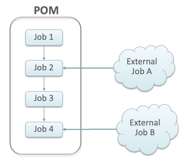

External Dependency
This feature allows customers to control the execution of a schedule running in POM by defining custom pre-dependencies. POM pauses the schedule execution on encountering these external pre-dependences and resumes the execution once they are released by customer.

This section details the steps involved in setting up the external dependency.

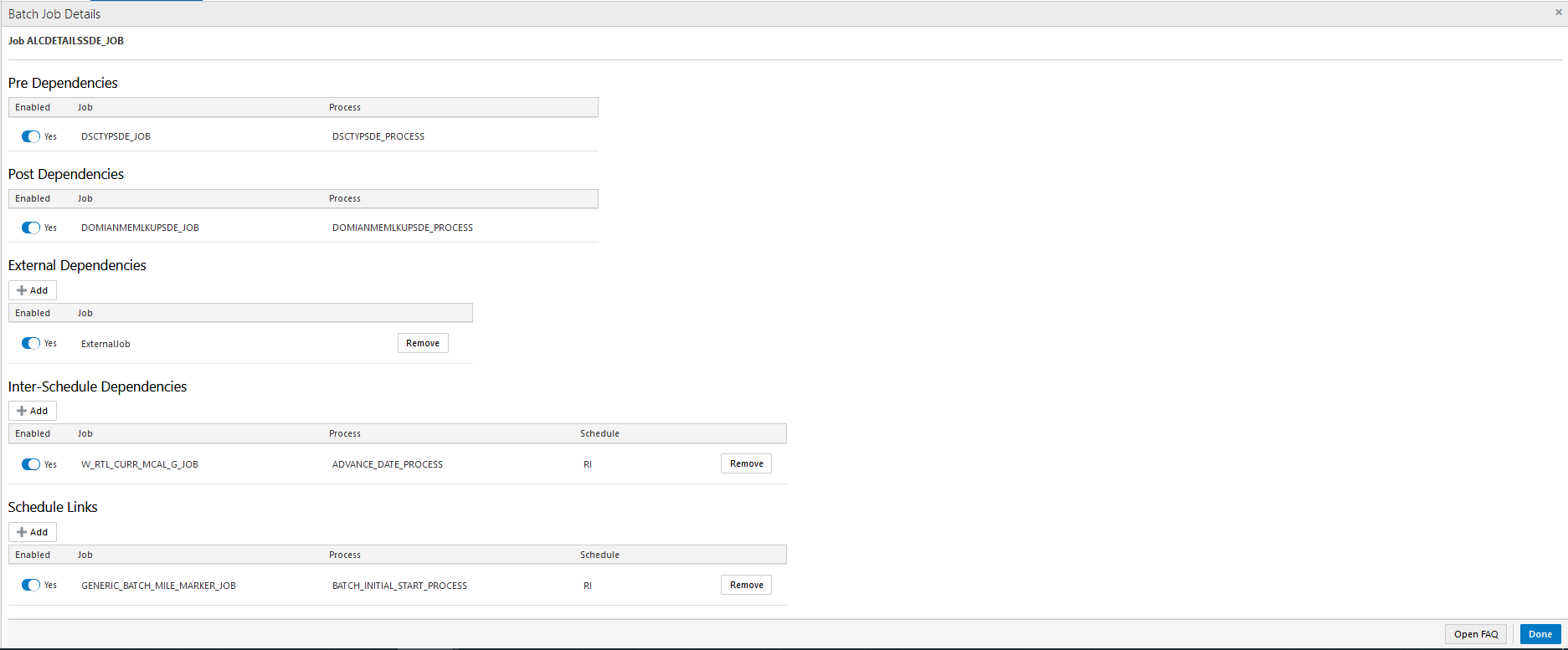

Navigate to the Batch Administration screen and select the schedule to which the external dependency will be added.
Figure 3-6 Batch Administration Screen
Select a Cycle - Nightly/Recurring/Standalone.
Find the Process/Job combination to which dependency needs to be added.
Click on the Job name to open the Batch Job Details panel.
Figure 3-7 Batch Job Details

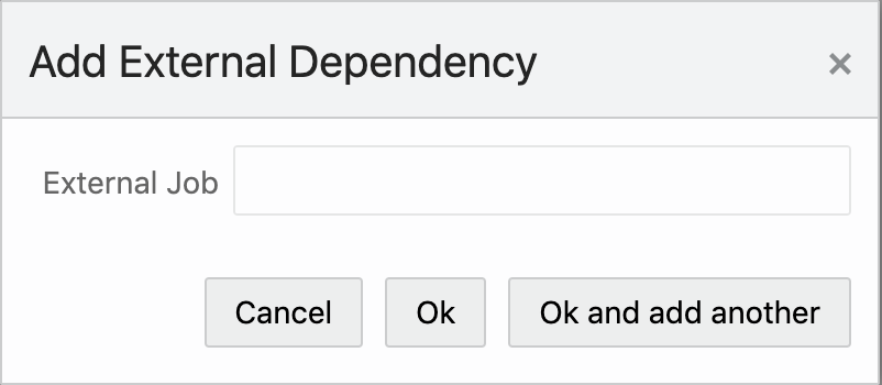

On the External Dependency section of the screen, click the Add button to create the external dependency.
Provide the external job name.
Figure 3-8 Add External Dependency
Click Ok to save and exit or Ok and add another to create another dependency.
