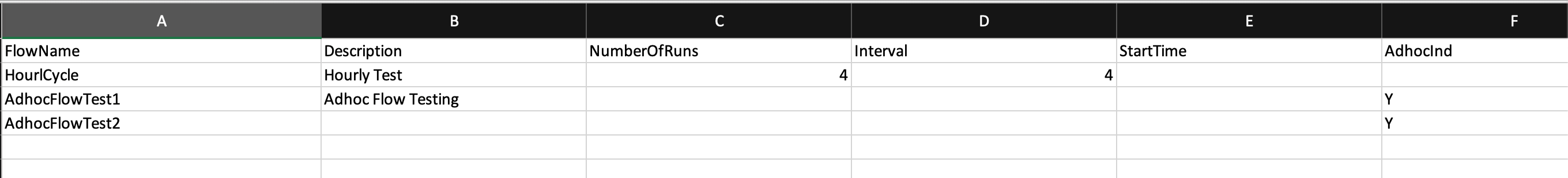

Flow |
Defines all the Flows in POM. Since the Nightly Flow is already in-built within POM, this refers to the Flows on the Adhoc and Hourly Cycles. |

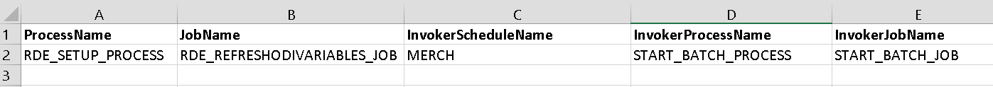

BatchLinks |
Also known as Schedule Links. If the Nightly Flow is going to be invoked via a different Job on a different Schedule, then a Schedule Link can be defined. |

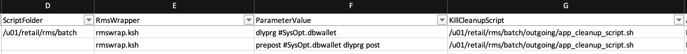

ScriptFolder
This holds the directory path where the Wrapper file resides in the system.
For service type jobs (non-shell script EXEC type jobs), this field should be left blank.
ParameterValue
This holds the entire parameter value to be passed in to a shell script type job. This field is case sensitive.

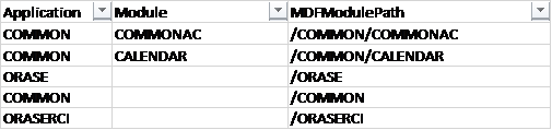

Module
This holds the name of the module under the application which the batch program belongs to. The Application / Module entered here should be a valid combination in the Application tab.
If there are no modules defined for the corresponding application in the Application tab or the Modules tab, then this column can be left blank. Otherwise it is required to enter the module(s) it belongs to.
A job can belong to multiple modules under the same application. In this case the list of those modules should be entered here with
as a delimiter.For example:
MODULE1||MODULE2||MODULE3
If the corresponding Application have some modules defined in Application Sheet then this column cannot be left blank.

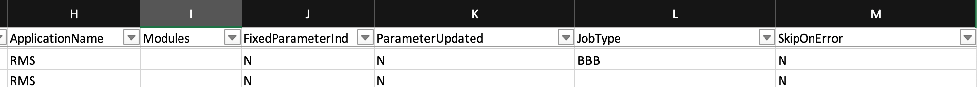

FixedParameterInd – VARCHAR(1)
Valid values are
Y
andN
This indicates whether the parameter value can be changed on the Batch Administration screen. If this is
Y
, the parameter will be changeable on the UI. This is applicable if the parameter cannot have a default value, or if the parameter can have different values. -
If this is
N
, the parameter value is fixed and will not be changeable on the UI.
ParameterUpdated – VARCHAR(1)
Valid values are
Y
andN
This indicates whether the parameter value column has changed from the previous value.
If
Y
, then the parameter value is passed and updates the existing job information with the newly passed parameter value. IfN
the parameter value won’t be updated for the existing job information.
SkipOnError – VARCHAR(1)
Valid values are
Y
andN
A value of
Y
indicates that the job should be skipped if an error occurs and the batch schedule continues to run. Otherwise the batch schedule is stopped.
JobType – VARCHAR (50)
The default value set is
EXEC
, which represents shell-script based Jobs. Other pre-defined service based job types areRI
,RASE
,BDI
,RPAS
,OMS
,OB
, andRDS
Custom Job types defined in the JobType tab can also be used in this field. In this case POM is directed to execute the job using the endpoint defined on the JobType tab.
KillCleanupScript – VARCHAR (1000)
Absolute path of the cleanup script to be run after killing a shell script (
EXEC
) type job from the POM UI. -
Can include arguments as well along with the script.
For example:

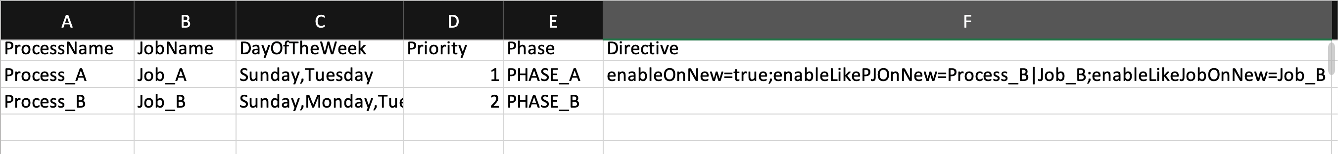

Directive – VARCHAR (200)
Contains the directive for Process / Job.
Enables/disables a new Job according to the directive provided.
Valid values: enableOnNew, enableLikePJOnNew, enableLikeJobOnNew. See the Schedule Upgrade Directives section above for more details on the use of these values.
This is an optional column. Leaving it blank will create the job as disabled.
The value of this column is a semi-colon separated string of directive key-value pairs. A process job can have one or more than one directive defined.
Example
If a process has 2 jobs in it, then there should be 2 entries in this tab for each job.

Flow Tab
The Flow tab allows you to define jobs that runs Adhoc flows and hourly or multiple times a day.
RecurringFlowName – VARCHAR(50)
Uniquely identifies the recurring flow / adhoc flow. The Recurring Flow Name should be in uppercase only with no spaces. Use an underscore if needed. It should end with
XXX_CYCLE
Description – VARCHAR(50)
Short description of the recurring / adhoc flow. There should be no special characters.
NumberOfRuns – NUMBER(2)
This contains the number of runs for this recurring flow in a day.
Valid values are
1
-24
. For hourly runs, maximum value is12
. For half hourly runs, the maximum value is24
Interval – NUMBER(2)
The interval between job runs. The Interval is specified in hours. Upper Limit is
12
StartTime – VARCHAR(50)
The time for the first batch run.
AdhocInd – VARCHAR (1)
Indicates if flow belongs to adhoc flow or not.
Valid values: Y/N
Example
AdhocFlowTest1 and AdhocFlowTest2 are the adhoc flows with AdhocInd set to Y. HourlCycle is the hourly cycle defined to run 4 times at an interval of 4.

Holds the name of the corresponding job (from the external schedule) that must complete before the job in the current schedule starts running.
Example
If there are no inter schedule dependencies for any jobs in the schedule, then leave this tab empty.
Modules Tab
The Modules tab allows you to define the mapping between the POM Modules and the Module Definition Framework (MDF) Modules. It also serves a second purpose by defining the modules for an application. If the module field on the Application tab is not blank, POM will use those modules. Otherwise, if blank, POM will use the modules from this tab.
MDF holds the applications and modules to which a customer has subscribed. POM can then optionally sync with MDF to activate or deactivate applications and/or modules.
Application – VARCHAR(50)
Holds the valid application name for which we need to set an MDF Module Path.
This can’t be blank and should be listed in Application tab.
Module – VARCHAR(50)
Holds the module name for cases when the MDF Module Path must be set at module level.
This can be blank when the MDF Module Path is only set at the application level.
This Application / Module combination should be valid per the Application tab.
MDFModulePath – VARCHAR(4000)
Holds the module path in the MDF application.
This can’t be blank. This should be a slash (
) separated path.For example:
/RMS
,/COMMON/COMMONAC
Example

BatchLinks Tab
This tab contains Batch Links. When you set up a batch link, you direct POM to start a job in schedule B upon completion of a job in schedule A. It’s a way of linking two schedules together and having one start the other. You want the job in schedule B to be the first job of the schedule.
If no such link is desired, leave this tab empty.
ProcessName – VARCHAR(50)
Holds the name of the process in the current schedule that needs to be invoked by a process / job from an External Schedule.
This process name should be listed in Process tab.
JobName – VARCHAR(50)
Holds the name of the corresponding job of the above process that needs to be invoked from the other external schedule.
This Process Job combination should be valid as per the Process Job Mapping tab.
InvokerScheduleName – VARCHAR(10)
Holds the name of the external schedule whose job is to invoke the current schedule’s job.
InvokerProcessName – VARCHAR(50)
Holds the name of the process in the invoking schedule.
InvokerJobName – VARCHAR(50)
Holds the name of the corresponding job from the invoking schedule.
Example
If there are no batch links needed then leave this tab empty.
