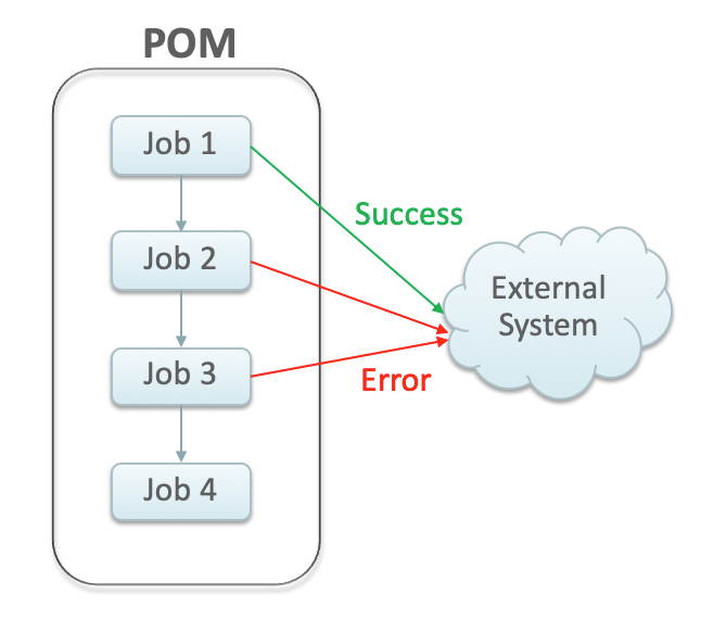

External Status Update (Callbacks)
The External Status Update feature provides the ability for external systems to optionally register with POM to receive the Job status notifications as a callback to their ReST interface.
While ReST service calls from external systems (customers) to POM are required to use the OAuth2 authentication standard, ReST service calls from POM to external systems such as the call for External Status Update are limited to Basic Auth at this time.
POM has a health check feature that calls this ReST service to verify that the external status update (Callback) is up and running. This call uses the HTTP method OPTIONS or the HEAD method on the provided external status update URL. Customers need to make sure that their external status update API URL implements / allows the OPTIONS or HEAD method for the POM Health Check to work correctly.
Retailers are responsible for using valid, certificate authority (CA) signed certificates for TLS for the APIs, such as the one associated with External Status Update. For more information, see My Oracle Support Doc ID 2710163.1.

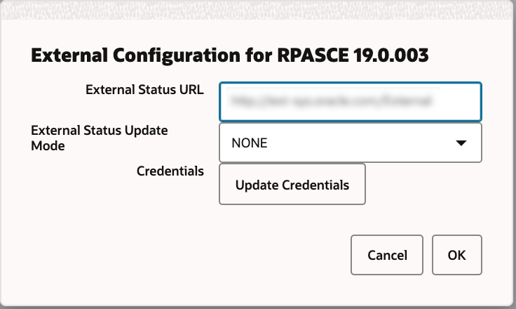

  2. Click the Edit icon on the External Configuration Panel to open the External Configuration window.
    Figure 3-2 External Configuration Window
  3. Enter the configuration values:
    •  External Status URL - External system's URL that needs to be called for status updates and also for health-check.
      In addition to this configuration, you must work with Oracle support to get the External Status URL added to the allowlist.
      The POM health check validates the external systems that must have the OPTIONS request method implemented. If the OPTIONS method is not implemented, POM will validate the external systems using the HEAD request method.
    • External Status Update Mode - Choose one of the options below:
      • ALL - POM will send a status update to the external system for each job's execution in the schedule regardless of success or failure. This option may be an overuse of this feature and may impact performance.
      • FAILED - POM will send a status update only for failed jobs.
      • NONE - No status updates will be sent by POM.
        The External Status Update Mode defined on this screen applies to all the jobs in a schedule. If status update is desired only for specific jobs then set the mode on the above screen to NONE and follow the steps defined in the Job Configuration section below.
    • Click Update Credentials and provide the credentials for the external system.

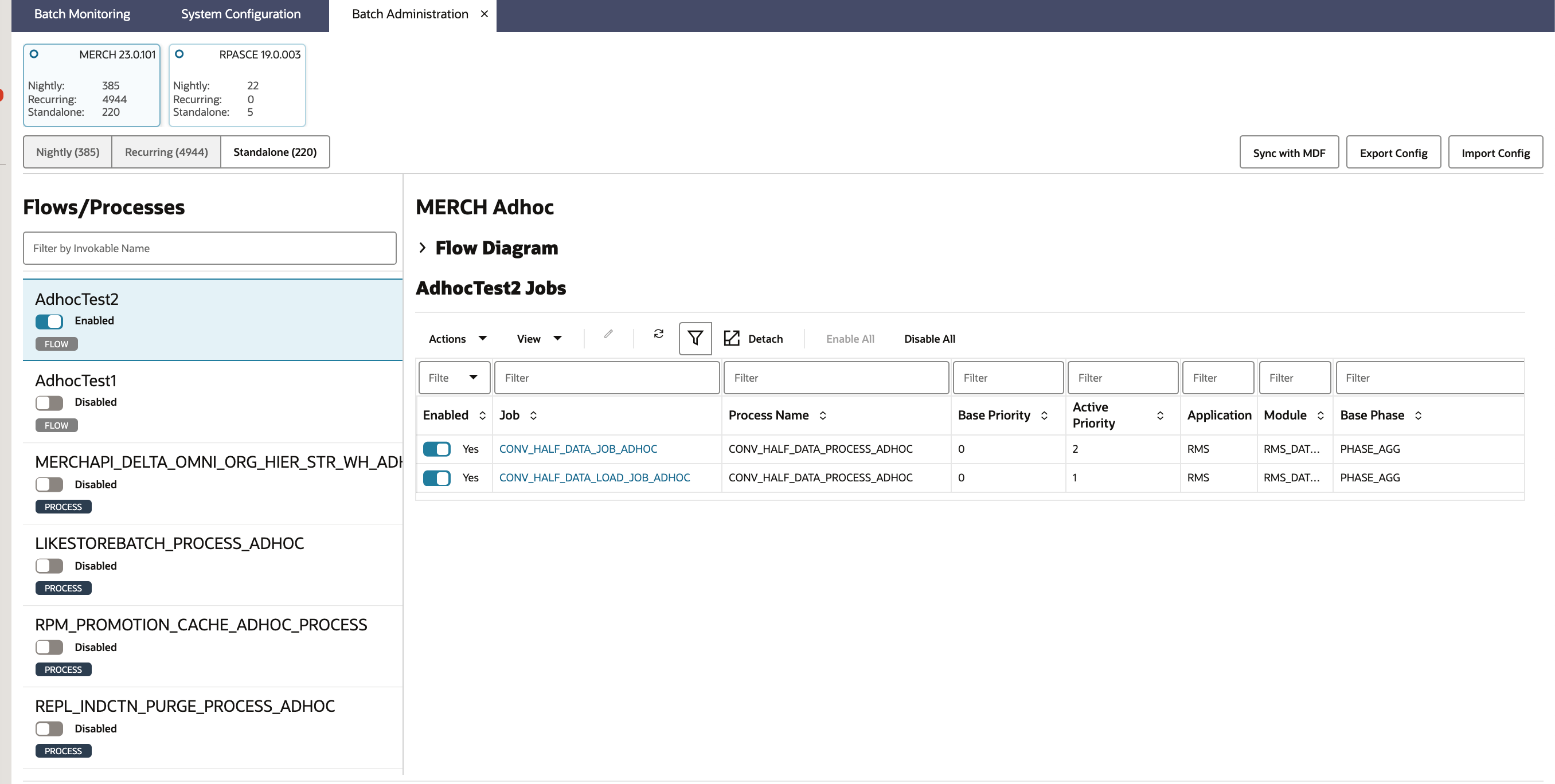

  1. Navigate to the Batch Administration screen and select the desired schedule.
    Figure 3-3 Batch Administration Screen
  2. Select a Cycle - Nightly/Recurring/Standalone
    • If Standalone is selected, select the Flow / Process from the left pane, then select the Process/Job combination and click Edit from table action menu to open the popup below.
    • If Nightly or Recurring is selected, then select the Process/Job combination row and click Edit from the table action menu to open the popup below.

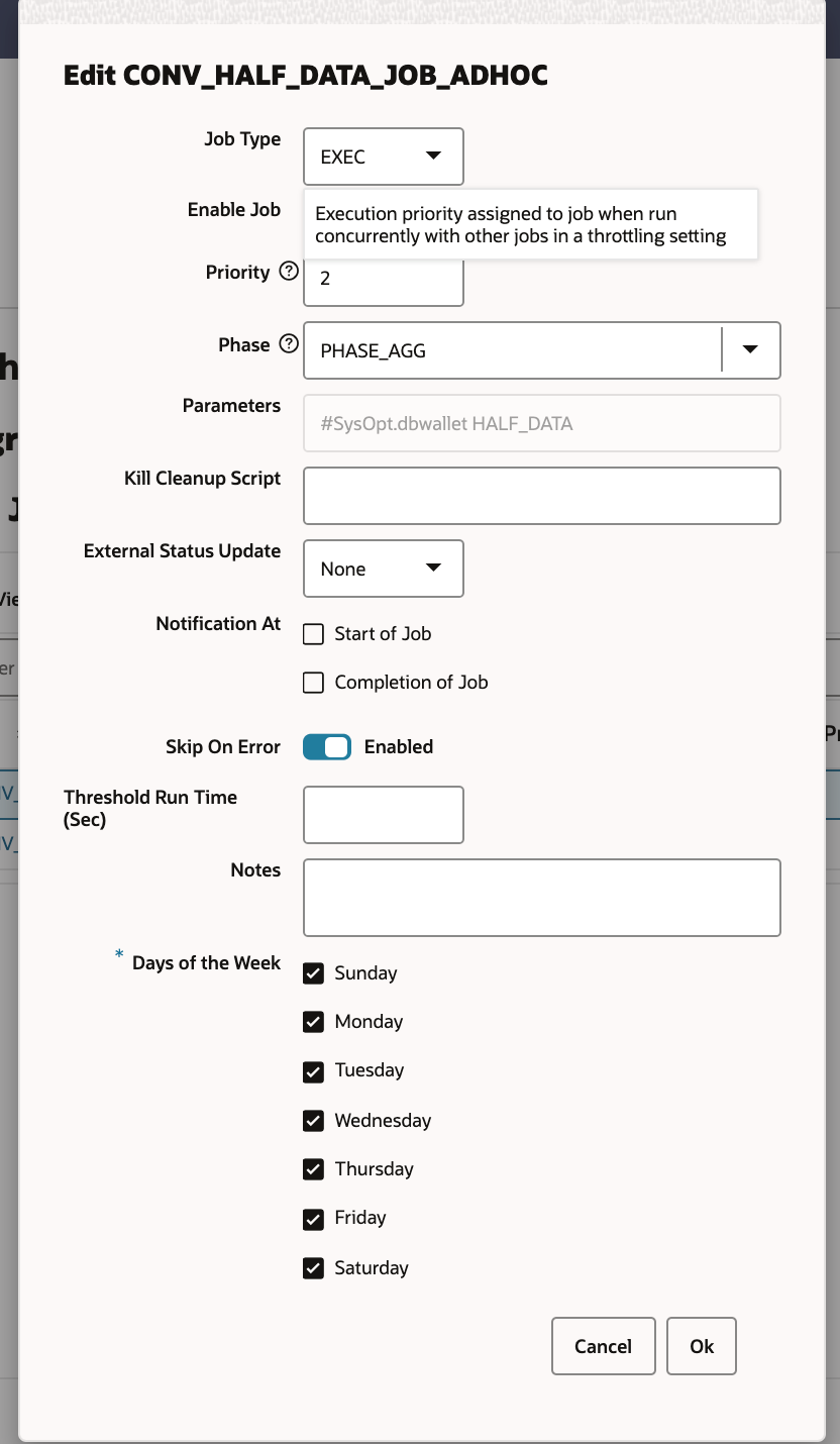

    Figure 3-4 Edit Job Dialog
    Edit Job Dialog
  3. Set the External Status Update Mode to one of the following values:
    •  ALL - POM will send a status update to the external system for this job's execution regardless of success or failure.
    •  FAILED - POM will send a notification only when this job fails.
    •  NONE - No status update will be sent by POM for this job.

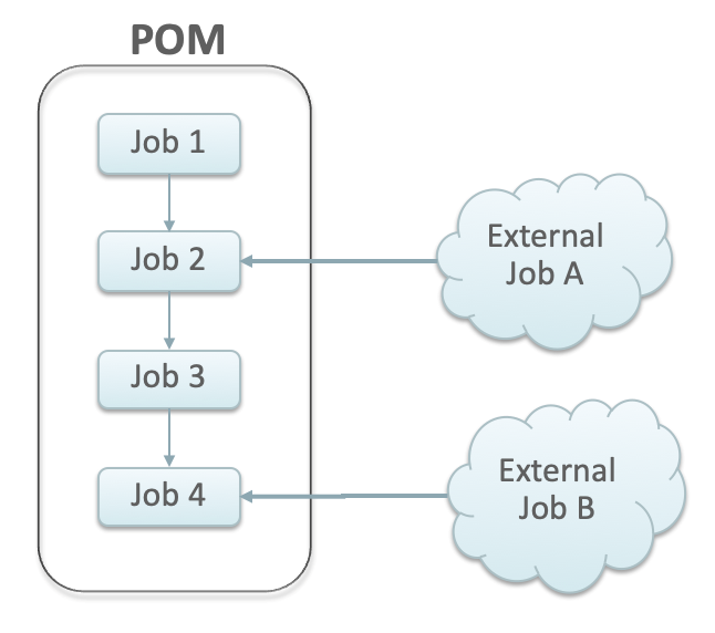

External Dependency
This feature allows customers to control the execution of a schedule running in POM by defining custom pre-dependencies on certain Jobs. POM pauses the schedule execution upon encountering these external pre-dependencies and resumes the execution once they are released by customer.
External Dependencies can only be created for Jobs on the Nightly Cycle. They cannot be created for Jobs that belong to the either the Hourly or Adhoc Cycles.

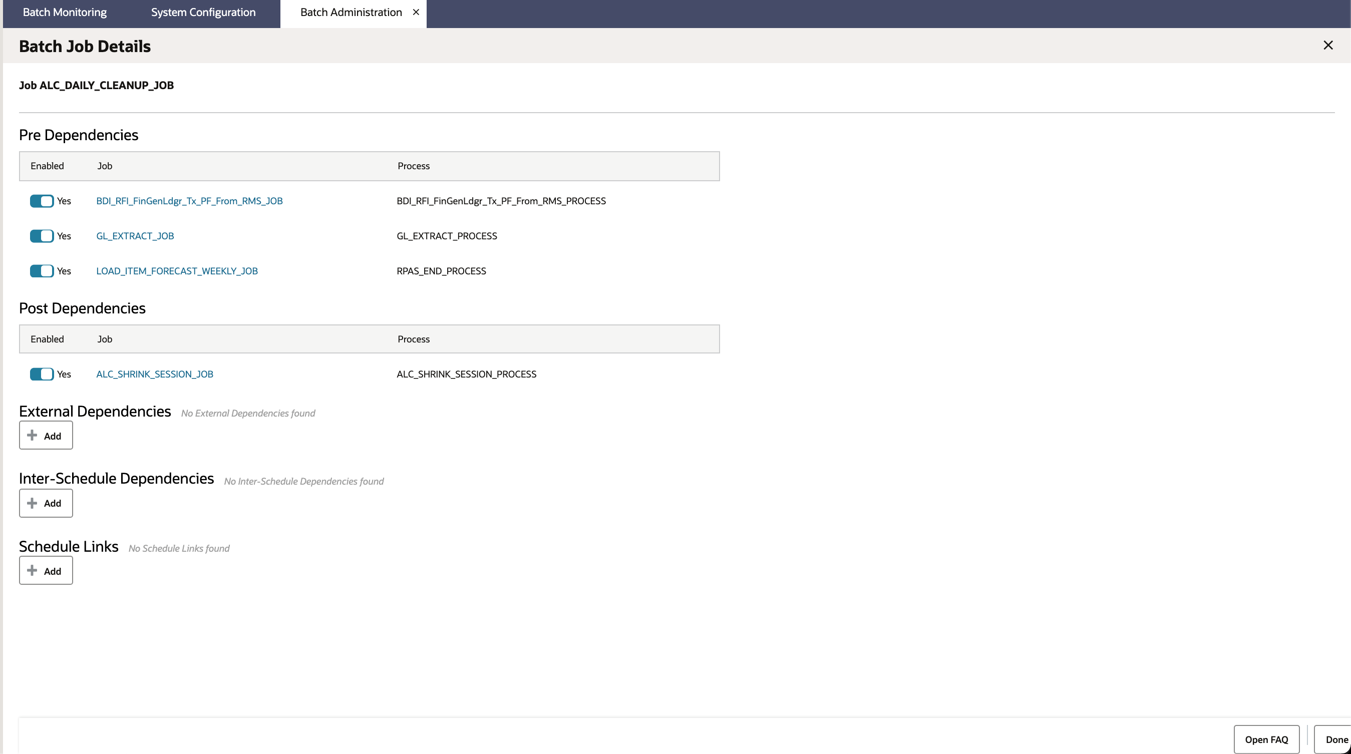

  3. Click on the Job name to open the Batch Job Details panel.
    Figure 3-7 Batch Job Details
    Batch Job Details

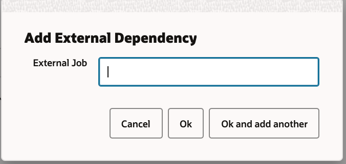

  4. In the External Dependency section of the screen, click the Add button to create the external dependency.
  5. Provide the external job name.
  6. Click Ok to save and exit or Ok and add another to create another dependency.
    Figure 3-8 Add External Dependency

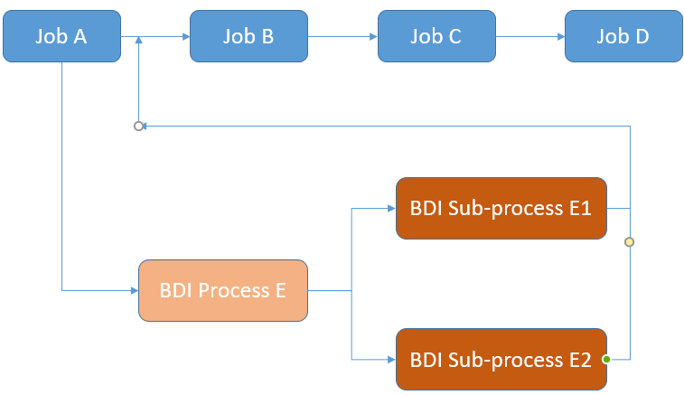

Mode 2 : Fire-And-Forget
In this mode, POM Job will trigger the BDI Flow and will only wait for the specified extractor activities of the main BDI Process to complete. If the extractor activities are completed, the Job is assumed to be completed in POM.
Fire and Forget Flow
Set Mode
This mode is set by ensuring that “extractor” names (second parameter) are passed as parameters to the POM Job that is triggering the BDI Flow.
Implications
The impact of running Jobs in this mode are
  • It is possible that the BDI Flow eventually fails (after the Extractors have completed), while the POM Job is marked Completed. This could possibly impact the integrity of the data.
  • It doesn’t cause the remaining batch schedule to wait for a BDI Flow to complete. Non-dependent Jobs can continue processing while the BDI Flow continues to run separately.

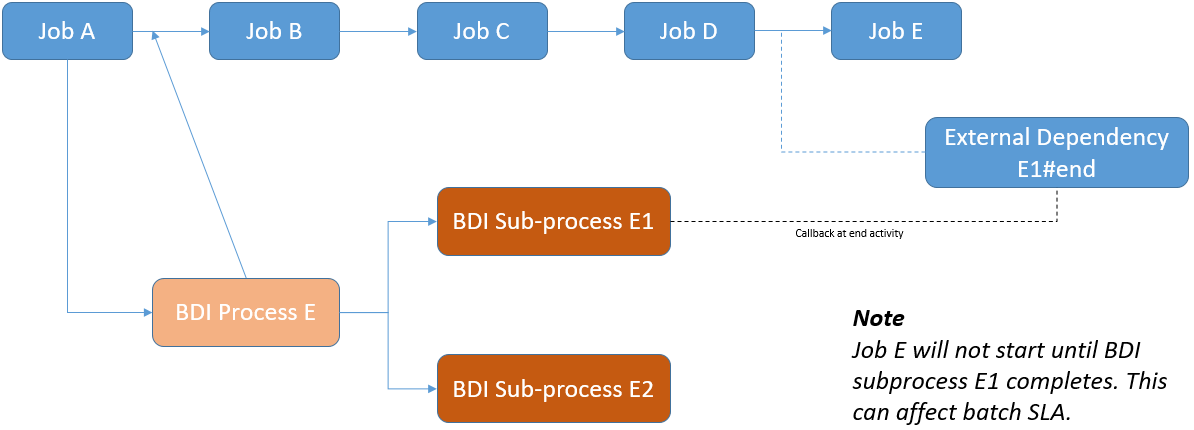

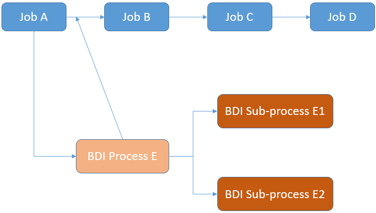

Mode 3 : Fire-And-Wait-Later
This is essentially an improved version of the previous mode. In this mode too, the POM BDI job waits only for the extractor activities to complete, to be marked Complete itself. However, a later Job can be configured to wait for the BDI subprocess to complete by configuring an external dependency and routing the callback from BDI to POM.
The external dependency must be configured as follows:
 {Name of Subprocess} # {end}
Fire and Wait Later Flow
Set Mode
To set this mode, the configuration needed is as follows:
  1. Configure the POM BDI Callback URL on the BDI Process Flow. This ensures that BDI will call POM on the completion of the specified activity.
  2. Configure an External Dependency in POM, based on the name of the BDI Subprocess. This external dependency doesn’t need to be manually released. On receiving a callback from the BDI Process Flow, POM will auto-release this external dependency. This ensures that the POM Flow is not moved to completion until the relevant BDI Flows have also been completed successfully.
