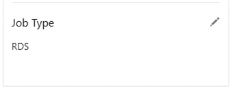

Job Type - See Create / Edit Job Type for details.
Job Type - For example, RDS.

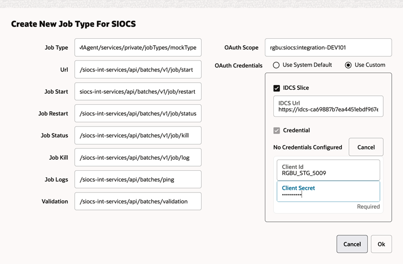

Job Types
Job Types window displays a table of configured job types. The user can edit or delete an existing row or create a new job type.
See the “Generic ReST Jobs” chapter of the POM Implementation Guide for additional details on setting up custom schedules with custom job types.
Figure 2-37 Job Types Table
Each row contains the fields:
Job Type - A short, alphanumeric identifier of the job type. This typically reflects the system or application where associated jobs are to be executed (for example, RDS).
URL - Base URL for endpoints at the destination system where batch is to be Invoked (for example, https://server/services/batch).
Job Start - Endpoint for invoking the execution of a job.
Job Restart - Endpoint for restarting the execution of a job after failure.
Job Status - Endpoint for POM to fetch the status of a started job.
Job Kill - Endpoint for terminating the execution of a running job.
Job Logs - Endpoint for fetching the log(s) for a job.
Validation - Endpoint for validating that the endpoints are reachable.
A new job type can be created by selecting the Create icon
in the Job Types section to open the Job Type Configuration
window. The system default OAuth Credentials can be used for authentication.
Alternatively, custom credentials with the IDCS URL and the Client ID and Client Secret can be used for authentication using an IDCS instance other than POM's.
Figure 2-38 Create Job Type – Using System Default OAuth Credentials
Figure 2-39 Create Job Type – Using Custom OAuth Credentials – IDCS URL
Figure 2-40 Create Job Type – Using Custom OAuth Credentials – Client ID and Secret
Additionally, an existing job type configuration can be changed by selecting the edit
icon
Figure 2-41 Edit Job Type
If the selected job type is using custom credentials, the popup will also show the corresponding client id.Select OK to save the changes or select Cancel to exit the window without saving changes.

Job Type
Can be one of the following values:
EXEC,RI,RASE,BDI,RPAS,OMS,OB, orRDS. -
