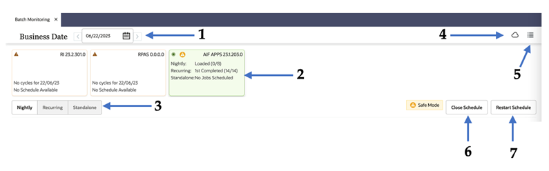

Select Batch Monitoring in the Navigation Area to open the Batch Monitoring tab.

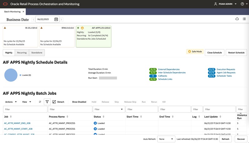

The application will by default open for a business date where at least one schedule is active. If none found, it will open for the most recent business date where at least one schedule is active.
Figure 2-1 Batch Monitoring
Batch Monitoring Screen
Header
The header displays information about the batches displayed in the Batch Monitoring tab. You can also use the header selection to choose which schedule batches to display.
Figure 2-2 Batch Monitoring Header
Batch Monitoring Header — Labeled
  1. Business Date - Displays the business date for the oldest schedules displayed in Batch Monitoring.
    Use this field to select the oldest schedule displayed in Batch Monitoring.
  2. Environments - Displays information about each environment integrated with Process Orchestration and Monitoring.
    Select one of these panels to display information about that environment’s batch processes.
  3. Monitoring Cycle - Displays the monitoring cycle of the batches displayed.
    Select a monitoring cycle to see the batches scheduled for that cycle. The following monitoring cycles are available:
    •  Nightly
    •  Recurring
    •  Standalone

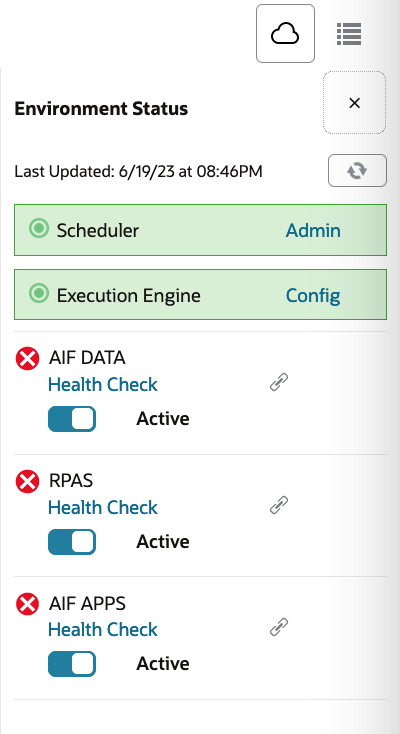

  4. Environment Status Icon - Click this icon to display a panel at the right side of the screen showing the status of the Scheduler, Execution Engine and the environments. The user can also manage the information displayed. See Status for more information.

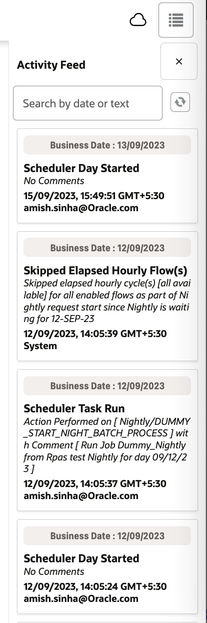

  5. Activity Feed - Click this icon to display a panel at the right side of the screen containing activities performed by the system and by the user.

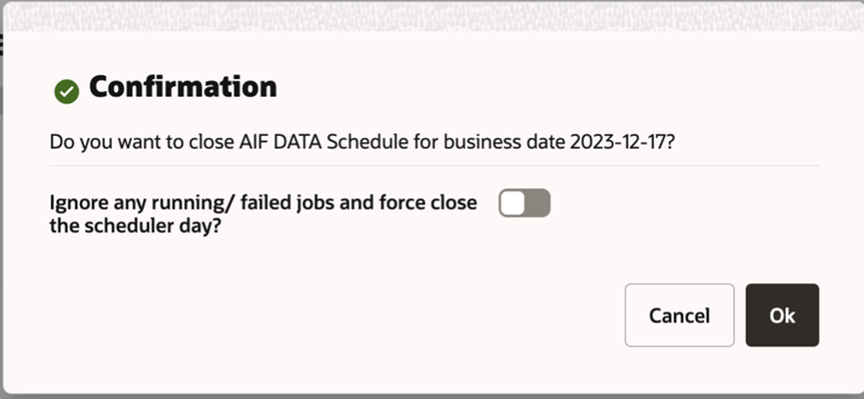

  6. Close Schedule - Use this button to close the schedule. This button only appears for Active schedules.
    Schedule will only close if the respective business date doesn’t have any Running/Error job(s).
    POM also provides the option to ignore this validation.
    Ignore Close Schedule Validation Window

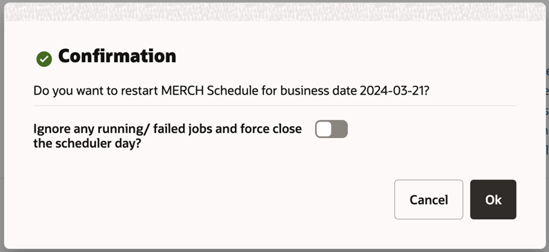

  7. Restart Schedule - Use this button to restart the schedule. This button only appears for Active schedules.
    Just like the Close Schedule, schedule will only restart if the respective business date doesn’t have any Running/Error job(s).
    Ignore Restart Schedule Validation Window

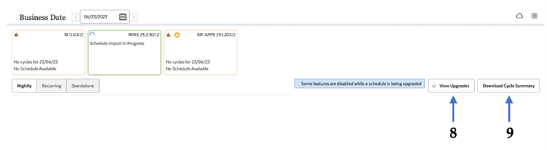

    View Upgrades and Download Cycle Summary Buttons
  8. View Upgrades - Use this button to navigate to the Schedule Maintenance screen to view more details on an upgrade when it is in progress or in error.

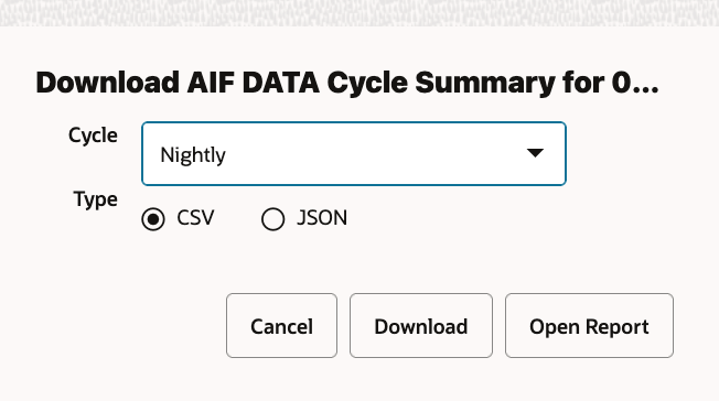

  9. Download Cycle Summary - Use this button to download a summary for the currently selected business day for the selected schedule. Once clicked, the Download Cycle Summary dialog provides the user options to select the cycle and format. This button only appears for Completed schedules.

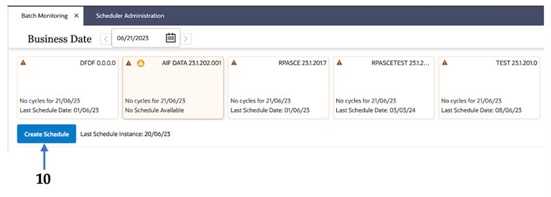

    Create Schedule Button
  10. Create Schedule - Use this button to create a new Scheduler Day. This button only appears when a schedule tile is selected for which there is no open Scheduler Day. Click this button to create a new Scheduler Day for the selected schedule for the business date following the last schedule instance.

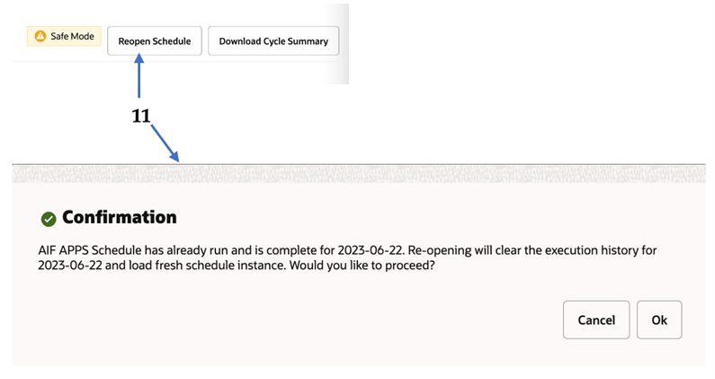

    Reopen Schedule
  11. Reopen Schedule - Use this button to reopen a closed schedule for the latest scheduler day. This button only displays for an already completed schedule for the business day shown. Reopening the schedule will clear the execution history for that day. A confirmation message is displayed; for example: AIF APPS Schedule has already run and is complete for 2023-06-22. Re-opening will clear the execution history for 2023-06-22 and load fresh schedule instance. Would you like to proceed?

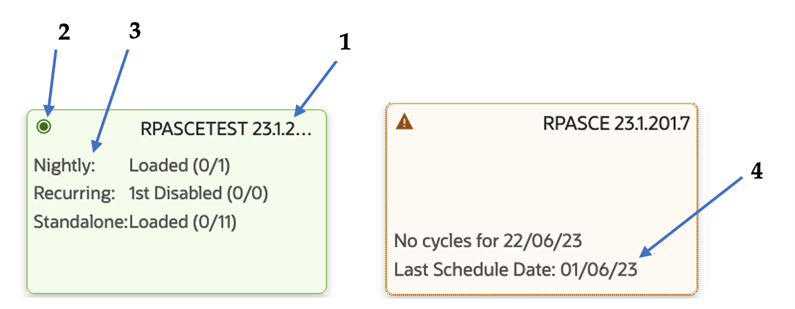

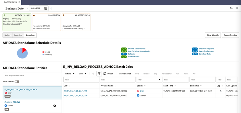

Schedule Tiles

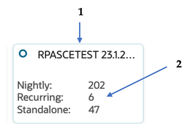

Each schedule tile displays information for a batch schedule that POM is responsible for running.
Select a tile to display the list of batch processes for that schedule.
Each panel displays the following information:
Figure 2-3 Schedule Tile
Schedule Tile

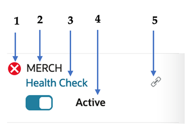

  1. Schedule name and Version - Displays the abbreviation of the application or application group and the software version. The display schedule name can alternatively be displayed here instead of the default schedule name. The display schedule name can be configured on the Schedule tab of the Batch Schedule spreadsheet.
  2. Run Status - Displays the status of the batch processes:
    •  Completed (green check mark icon)
    •  Active (green target icon)
    •  Error (red X icon)
    •  No activity (amber triangle icon)
    •  Suspended (pause icon)
    •  Safe mode (Amber circle icon with a warning icon inside of it)
    •  Patch Mode (Amber circle icon with a warning icon inside of it)
  3. Monitoring Cycles and Statuses - Displays the number of completed and total jobs for a nightly / recurring cycle and the number of completed and total ad hoc flows / processes for a standalone cycle.
  4. Last Schedule Date - Indicates the last date on which the batch processes were configured.
  • A green tile with a green target icon in the top left indicates that the schedule is in progress.
  • A green tile with a green checkmark icon in the top left indicates that the schedule has completed.
  • A red tile with a red cloud icon indicates that a new schedule version upgrade has failed. Navigate to the Schedule Maintenance screen by clicking on the View Upgrades button to address the failure.
  • A blue spinner icon in the top left of the tile (2) indicates that the schedule is in the process of being upgraded to a new version. The user can navigate to the Schedule Maintenance screen by clicking on the View Upgrades button to check the progress of the upgrade.
    When a schedule is being upgraded or when the schedule upgrade has failed, the user is prevented from most activities on the Batch Monitoring and on the Batch Administration screen.
    Some features and disabled while a schedule is being upgraded
    Some features are disabled while a schedule is being imported
    Some features are disabled while a schedule is in a failed state
  • An amber warning circle icon in the top left of the tile (2) indicates that the schedule is set to run in safe mode. This means that the batch schedule will simulate a complete run but without the jobs actually executing on the application server. Aside from the amber warning circle icon displayed in the top left of the tile, an amber ‘Safe Mode’ message is displayed in the area right below the tile area.
    Safe Mode is currently enabled
  • An amber warning circle icon in the top left of the tile also indicates that patching is currently in progress and run executions will be paused until the patching completes. Aside from the amber warning circle icon displayed in the top left of the tile, an amber ‘Patch Mode’ message is displayed in the area right below the tile area.
    Patch Mode Message
  • An amber tile indicates that there is no instance of the schedule for the selected business date.
Batch Jobs Header
The batch jobs header displays the following information:
Figure 2-4 Batch Jobs Header
Batch Jobs Header

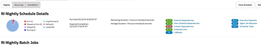

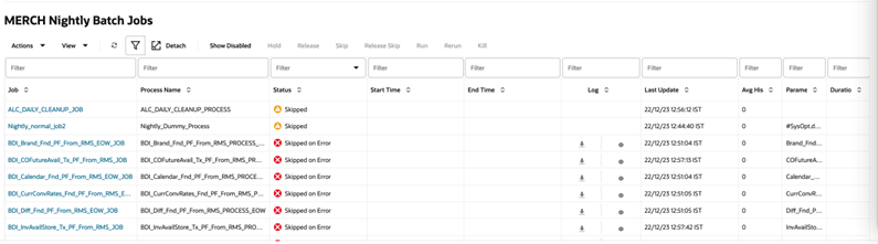

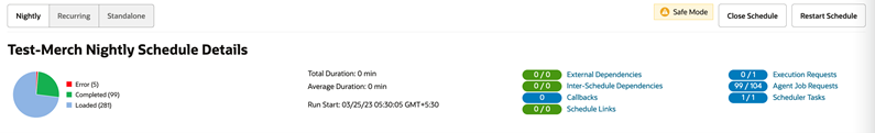

Run Status Chart
The run status chart shows a chart summary of the status of the different batches (including the number of batch jobs with that status) that are included in the selected cycle for the selected schedule. The possible statuses are:
  • Loaded - Jobs are in loaded state when the scheduler day is first created.
  • Pending - Job is waiting to run.
  • Completed - Job ran successfully on the system.
  • Error - A failure occurred due to an issue in the environment or the job's application.
  • Held - An administrator placed the job on hold.
  • Skipped - An administrator has skipped the running of the job so the remaining jobs in the cycle can proceed.
  • Running - Job is currently running on the system.
  • Long Running - The job's run time has exceeded a threshold. If a Threshold Run Time is specified for the job on the Edit Job popup of the Batch Administration screen, then a job is deemed long running if its current run time exceeds that value. Otherwise, if a Threshold Run Time is not specified, then the job is deemed long running when its current run time exceeds the Long Run Average Time Multiplier (specified on the Edit Settings popup of the System Configuration screen) times the average run time of that job + Long Running Tolerance Level. The value for the Long Running Tolerance Level can be overridden by changing the value of batch schedule variable defaultLongRunningToleranceLevel on the System Options screen accessed from the System Configuration screen. The value is in seconds.
    For example, if a job's average run time is 3 minutes, and the Long Run Average Time Multiplier is 3, and the Long Running Tolerance Level is 6 minutes, then the job is considered long running if it has been running for at least 15 minutes. A notification is sent when a job is deemed long running.
    If the Threshold Run Time field for a job is 0 or blank, and there is no history of job run, the job will be considered long-running when its run time exceeds the default long running threshold run time of 10 minutes. This default value can be overridden by changing the value of batch schedule variable defaultLongRunningThresholdRunTime on the System Options screen accessed from the System Configuration screen. The value is in seconds.
  • Disabled - Job was disabled by an administrator on the Batch Administration screen.
  • System Held - Job was placed on hold by the system due to a lack of resources to run it.
  • Skipped on Error - Job was preconfigured to be skipped on a failure.
  • Waiting - Job is waiting for completion of pre-dependencies (Hourly Cycle, Nightly Cycle, External Dependency and Inter-Schedule Predecessor Jobs).

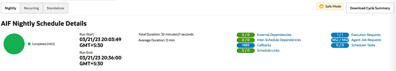

Completed Batch Job Statistics
Completed Batch Job Statistics Header
Completed Batch Job Statistics are displayed only for Nightly and Recurring cycles.
For completed batch jobs, the batch job header shows the following information:
  • Run Start
  • Run End
  • Total Duration
  • Average Duration
Active Batch Job Statistics
Active Batch Job Statistics Header
For active batch jobs, the batch job header shows the following information:
  • Run Start
  • Expected Completion - Only Nightly jobs are considered in the calculation of the Expected Completion time. Dependencies, such as external dependencies, inter-schedule dependencies, and custom dependencies of Nightly jobs on Adhoc Flows are not considered in the calculation and may impact Expected Completion time.
  • Remaining Duration
  • Average Duration
Batch Information
The batch information area displays the following information about the batch process results:
Execution Requests - Displays the number of completed executions and the total number of execution requests. Click to open the Execution Requests Window.
Agent Job Requests - Displays the number of completed and total number of Agent job requests. Click to open the Agent Job Requests Window for the schedule and cycle selected.
Scheduler Tasks - Displays all tasks scheduled to run during the current scheduler day. Click to open the Scheduler Tasks window.

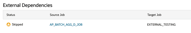

External Dependencies - Displays the number of successful and total number of external dependencies. Click to open the Batch Cycle Details Screen.

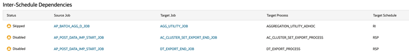

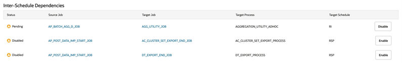

Inter-Schedule Dependencies - Displays the number of successful and total number of inter-schedule dependencies. Click to open the Batch Cycle Details Screen.

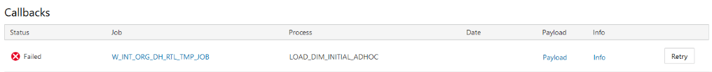

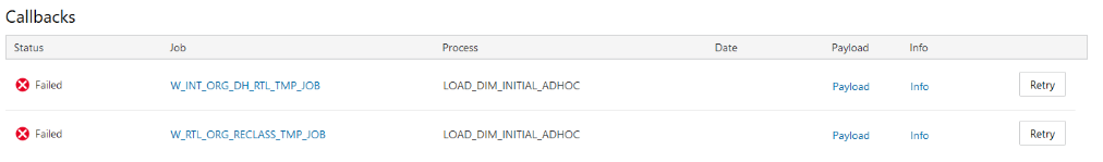

Callbacks - Displays the number of successful and total number of callbacks. Click to open the Batch Cycle Details Screen.

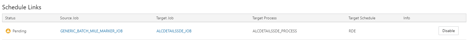

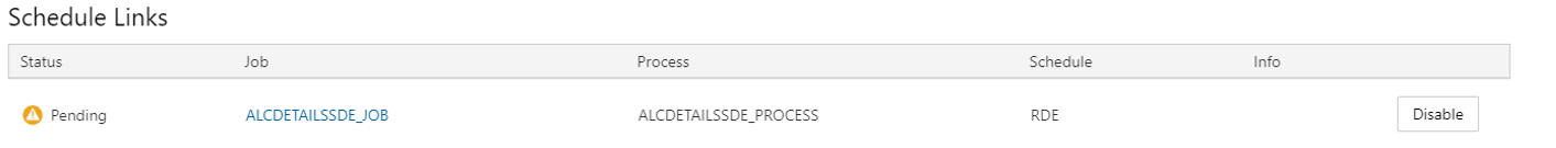

Schedule Links - Displays the number of successful and total number of schedule links. Click to open the Batch Cycle Details Screen.

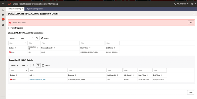

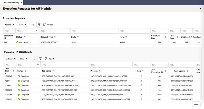

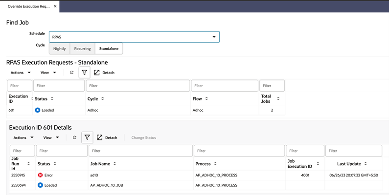

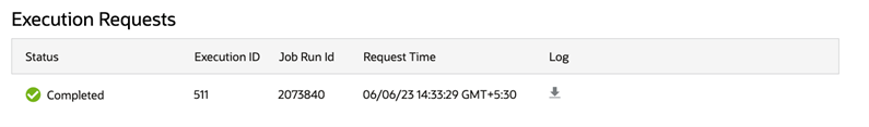

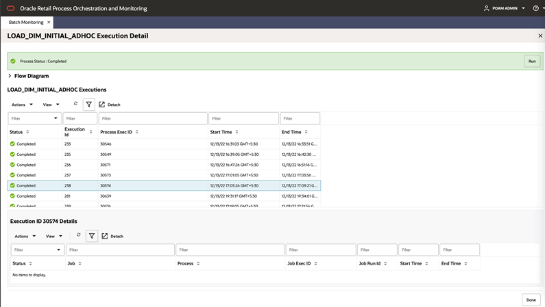

The Execution Requests window displays information about execution requests for a batch.
Click Done or the close window icon Close Window X Icon to close the window.
Figure 2-5 Execution Requests Window
Execution Requests
This section displays the following information about each execution request in the batch process:
  • Execution ID
  • Status
  • Request Type
  • Cycle
  • Flow
  • Scheduler Day
  • Total Jobs
  • Completed
  • Pending
  • Skipped
  • Failed
  • System Held
  • Submitting
  • Submitted
See Table Menu Options in the Common User Interface Controls for information about the options available for this section.
Execution Details
This section displays the following information about each job run by the execution request:
  • Job Run ID
  • Status
  • Job Name
  • Process Name
  • Log – Download log in text file format.
  • Job Execution ID
  • Last Update
  • First Job
  • Error Info
See Table Menu Options in the Common User Interface Controls for information about the options available in this section.

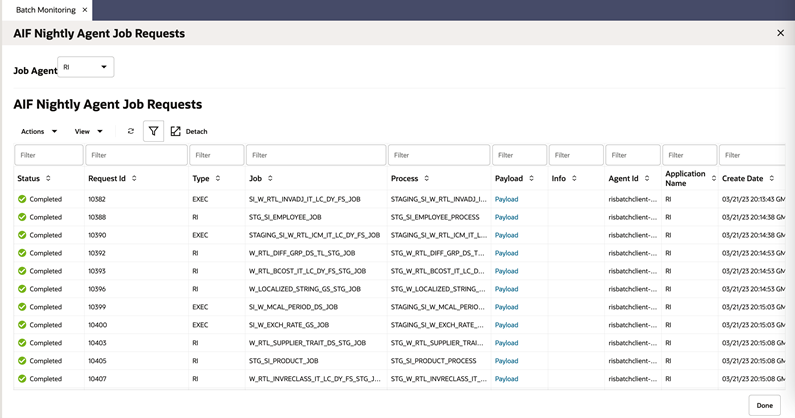

The Agent Job Requests window displays information about batch requests submitted to the POM Agent. The agent is the component of POM usually deployed on the application server where the batch jobs actually execute.
Click Done or the close window icon (Close Window X Icon) to close the window.
Figure 2-6 Agent Job Requests Window
Agent Job Requests
This section displays the following information about each Agent job request in the batch process:
  • Status - Possible values are Complete, Running, Error, and Loaded
  • Request ID - Agent request ID
  • Type - Possible values are EXEC (shell script based job) or RI/RASE/RDS/ RPAS/BDI/OB/OMS which are all values for service based jobs
  • Job - job name
  • Process - Process name
  • Payload - Service payload in case the type corresponds to a service based job
  • Info - Error Information in case the request is in Error status
  • Agent Id - The identifier of the Agent which Initiates the job execution request
  • Application Name
  • Create Date
  • Start Time
  • End Time
  • Last Update Time
  • Execution Request Id
  • Job Run Id

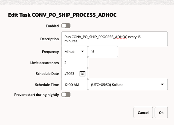

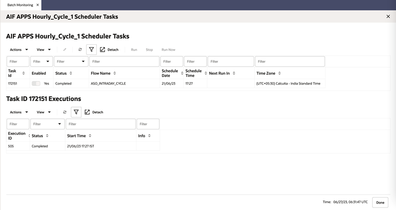

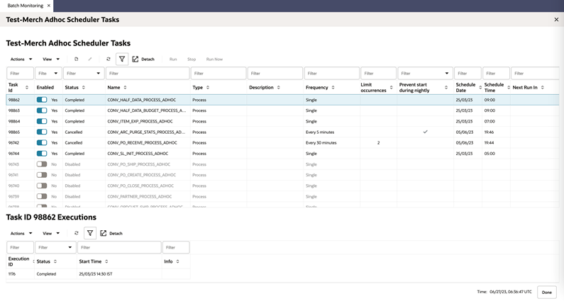

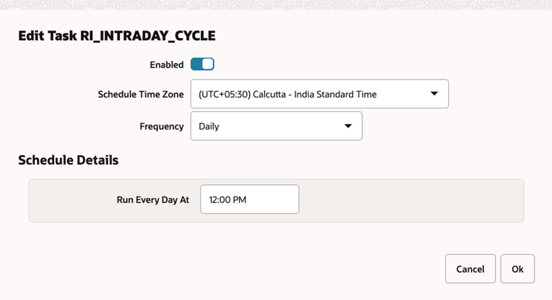

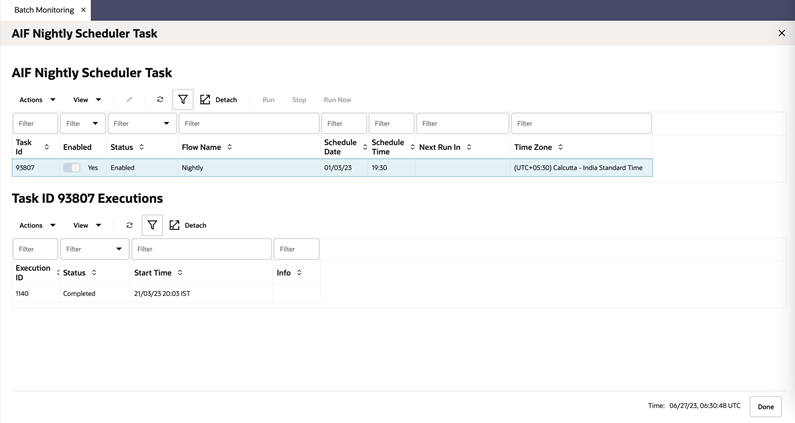

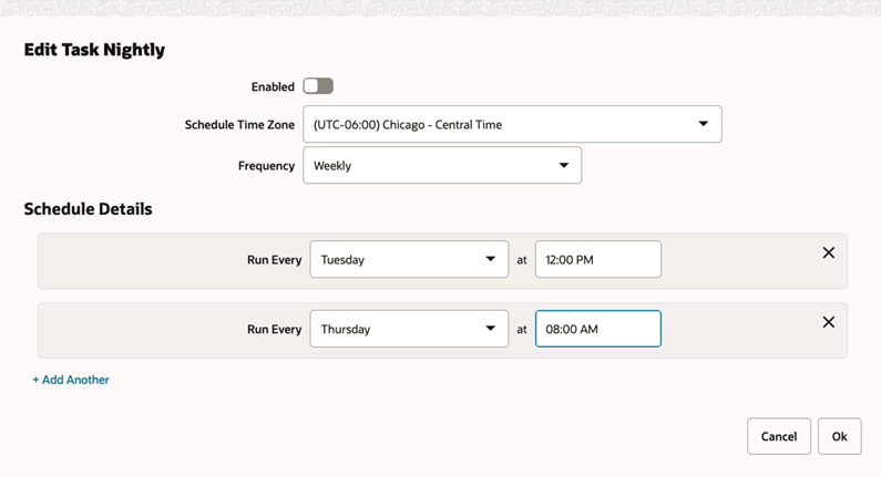

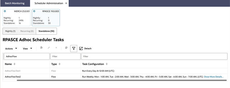

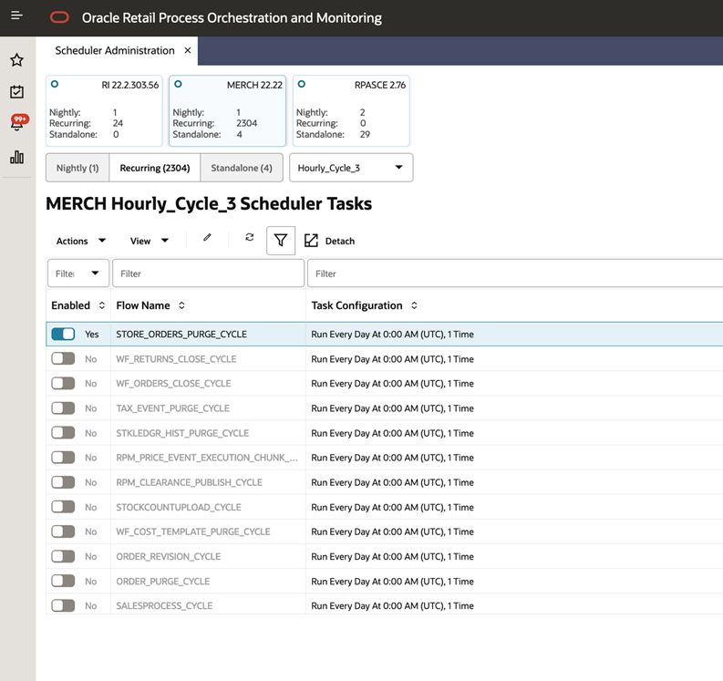

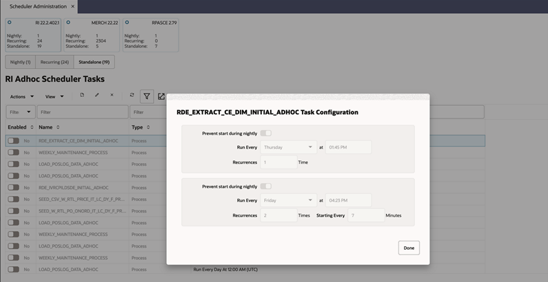

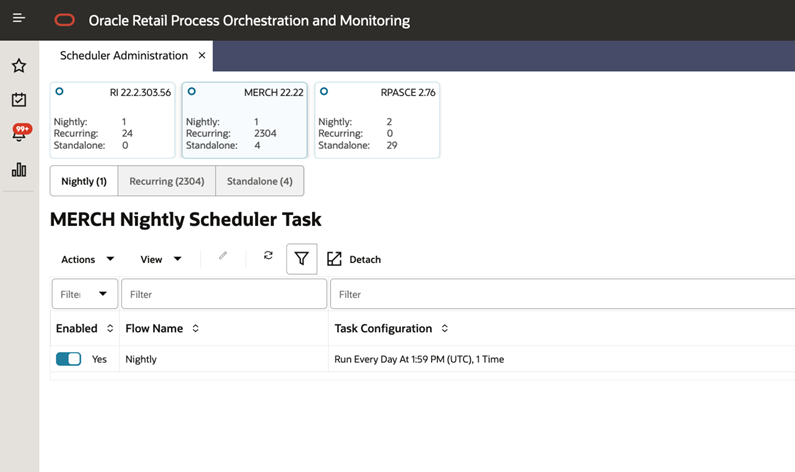

Scheduler Tasks
The Scheduler Tasks window displays information about tasks that are scheduled to run during the current scheduler day. See the Scheduler Administration section of this chapter.
When the new scheduler day is created every day (at the end of the Nightly batch run), it creates the scheduler tasks according to the way they are set up in the Scheduler Administration screen.
Figure 2-7 Nightly Scheduler Task Window
Figure 2-8 Recurring Scheduler Tasks Window
The Scheduler Tasks window for the Nightly and Recurring cycles display the same task attributes listed below. The difference is that there is only one Nightly task for a scheduler day whereas there could be multiple Recurring flows running throughout the day.
Nightly/Recurring Scheduler Tasks

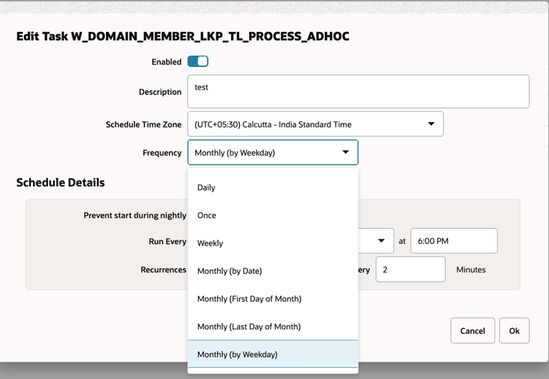

This section displays the following information about each Nightly/Recurring Scheduler task:
  • Task ID

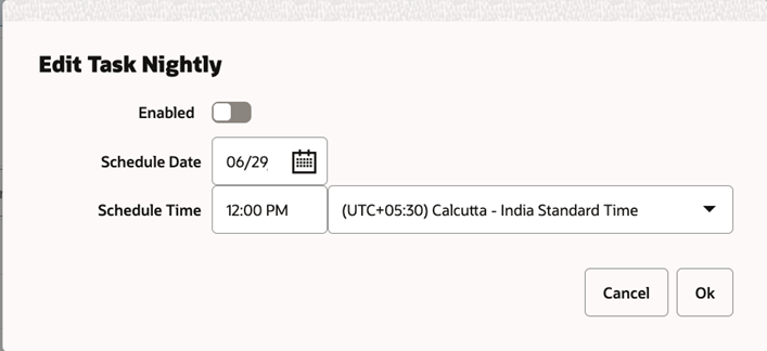

  • Enabled - Switch to enable or disable the execution of the task
  • Status - Possible values are: Enabled, Disabled, Completed, Skipped On Delay, Scheduled, Error, or Cancelled
  • Flow Name - Nightly or recurring flow name
  • Schedule Date
  • Schedule Time
  • Time Zone

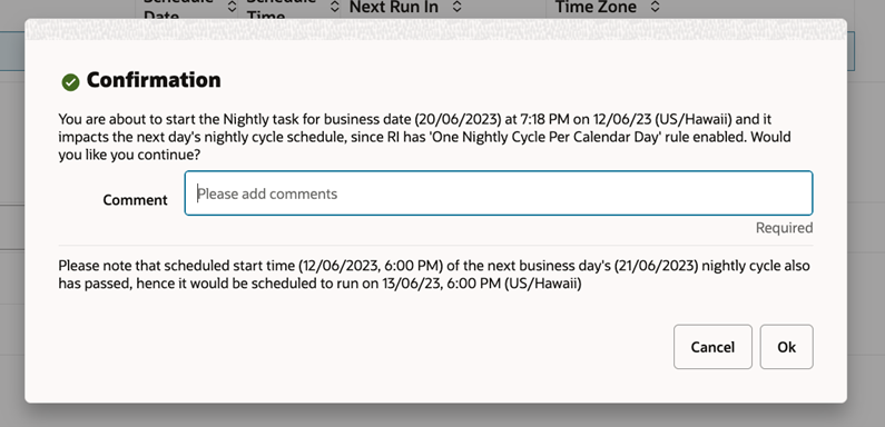

When the New Scheduler Day is created, if the start time for a certain task has elapsed, the task will be scheduled for the next day. The Next Schedule Run column will show the next time the task will execute.
See Table Menu Options in Common User Interface Controls for information about the options available for this section.
Task Executions
This section displays the following information about each task executions:
  • Status - Possible values are: Completed, Error
  • Start Time

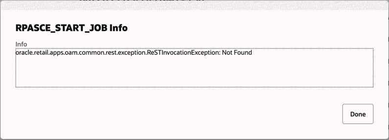

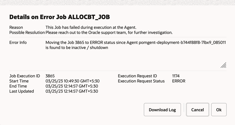

  • Info - If the Status is Error, this field changes to a link which, when clicked, will open a dialog showing error details.
See Table Menu Options in Common User Interface Controls for information about the options available in this section.

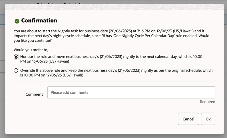

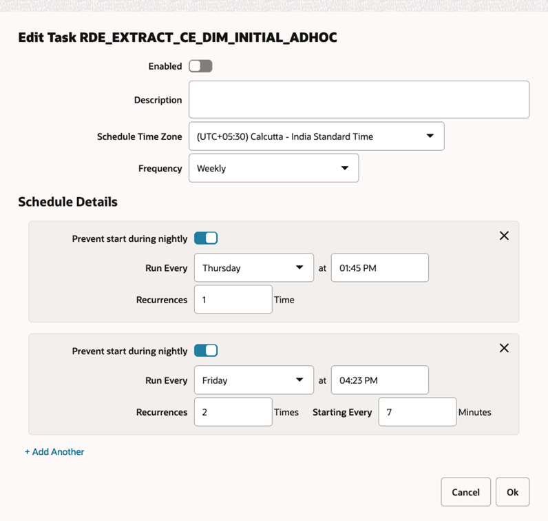

The user can edit the Nightly or Recurring tasks to change the time they run for the day. Permanent changes need to be entered in the Scheduler Administration screen.
If the user makes a change to the time, he or she needs to click the Run action to schedule the task.
It is alternatively possible for the user to circumvent the steps mentioned above and click on Run Now if they intend to schedule the task for immediate execution.
When Run or Run Now is clicked, confirmation windows are displayed based on the time zone and current business date.
Figure 2-9 The scheduled time in the given time zone is past the current date
Figure 2-10 The scheduled time in the given time zone has not passed the current date
Also, for the task to be editable, it must be in a state other than Scheduled. If it is in a Scheduled state, the user can click the stop action, which puts the task in a Cancelled state, and it will then be editable.
Edit Task Nightly

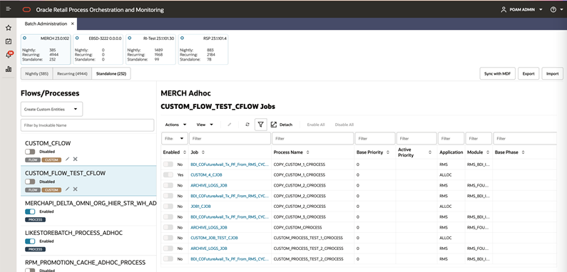

Standalone Scheduler Tasks
Figure 2-11 Standalone Scheduler Tasks Window
This section displays the following information about each Standalone Scheduler task:
Task ID
Enabled – Switch to enable or disable the execution of the task.
Status – Possible values are: Enabled, Disabled, Completed, Skipped On Delay, Scheduled, Error, Cancelled.
Name – Indicates Process / Flow name
Type – Indicates whether it is Process or Flow
Description – Provides a description of the task
Frequency – Single or Every x minutes.
Limit Occurrences –If this field has a value, the process will run every x minutes for y occurrences.
Prevent Start During Nightly – Indicates that the process should not start running when Nightly is in progress. If the process starts running before Nightly start, it will continue running even if the run extends into the Nightly run.
Schedule Date
Schedule Time
Next Run In – Displays the time remaining until the next run.
Time Zone
Click Done or the close window icon (Close Window) to close the window.

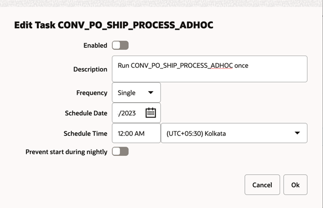

The user can edit a Standalone task to change any of the fields in the window below. Edits are effective just for the day's run. Permanent changes must be entered in the Scheduler Administration screen.
Edit Standalone Task Window
If the time is left blank for a standalone task, it will execute immediately upon clicking Ok.

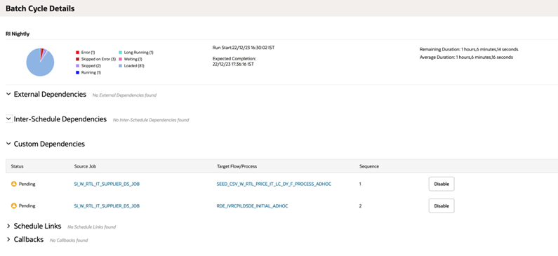

The Batch Cycle Details screen displays the following sections:
Header
The header displays the following information about the batch cycle:
  • Run Start
  • Run End
  • Total Duration
  • Average Duration
Active Batch Job Statistics are not yet implemented. They will be implemented in a future version of POM.
  • Run Start
  • Average Duration
External Dependencies Screen
The External Dependencies section lists all the external batch job dependencies for the entire current Schedule. These dependencies are only shown if the system level external dependencies indicator is turned on. An external dependency is usually a dependency on a customer's internal process. This dependency is released once the customer calls an endpoint into POM for a specific POM job.
The following information is displayed for each external dependency:
  • Status
  • Source Job - Click to open the job in the Batch Job Details screen. The source job is a job in the current schedule which is dependent on the external (target) job.
  • Target Job - The job that, when complete, will release the dependency which the source job is waiting on.
The Inter-Schedule Dependencies section lists all the inter-schedule batch job dependencies for the entire current Schedule. These dependencies are only show if the system level inter-schedule dependencies indicator is turned on. An inter-schedule dependency links the current schedule and a target schedule where a job in the target schedule is dependent on the completion of a job in the current schedule.
The following information is displayed for each inter-schedule dependency:
  • Status
  • Target Job - Click to open the job in the Batch Job Details screen. Target job is dependent on the source job.
  • Target Process - Process containing the target job.
  • Target Schedule - Schedule containing the target process/job.
  • A Disable/Enable button to disable or enable the dependency.

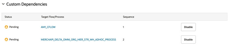

Custom Dependencies
Custom Dependencies Screen
A Custom Dependency includes entities (processes/flows) that execute prior to the current job in Nightly or Recurring cycles where the dependency is placed. Once the dependency completes successfully, the nightly or recurring job is triggered.
Custom Dependency is not applicable for Standalone/Adhoc jobs.
The following information is displayed for each custom dependency link:
  • Status – Pending or Complete
  • Target Flows/Process – List of Adhoc Flows or Processes based on the Target Entity selection.
  • Sequence - The sequence of execution of the target flow/process.
Schedule Links Section
A Schedule Link links the current schedule and a target schedule where the current schedule does not start until the completion of a job in the target schedule.
The following information is displayed for each schedule link:
  • Status
  • Source Job - Click to open the job in the Batch Job Details screen. The job in the current schedule which starts the current batch when the Target Job completes.
  • Target Job - Click to open the job in the Batch Job Details screen. The job in the Target Schedule which when completes fulfills the dependency for the Source Job in the current schedule.
  • Target Process - The process which the Target job belongs to. - The schedule whose job is a dependency for the job in the current schedule.
  • Info - Shows information regarding error if failed or skipped.
  • Target Schedule
  • If it was not successful, a Retry button to retry the schedule link.

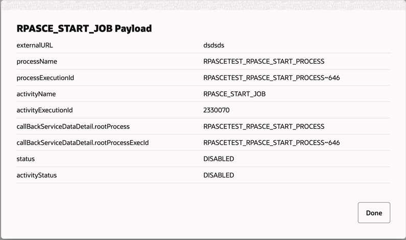

Callbacks
Callbacks Section
The Callbacks section lists all the external status update request and response callbacks based on the External Status Update mode set in the External System Configuration screen.
The following information is displayed for each callback:
  • Status
  • Job - Click to open the job in the Batch Job Details screen.
  • Process - Process containing the job.
  • Date of callback
  • A Payload link to display the Callback - Payload Window for the callback.
  • An Info link to display the Callback - Info Window describing the callback response.
  • If the callback was not successful, a Retry button to retry the callback.
Nightly and Recurring Batch Jobs
Batch Jobs Section
The Batch Jobs section lists all the batch jobs for the selected schedule and the selected cycle – Nightly or Recurring. The table displays the following information:
  • Status

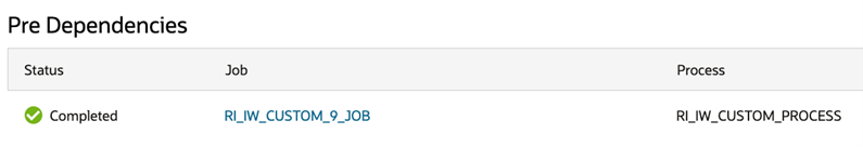

  • Application
  • Last Update
  • Parameter
  • Job Type - Depending on the value, determines if a job is service based or shell script based.
  • Process Name
  • Process Status
  • Log - When the job is in error, this field will display a down-arrow icon which when clicked will display the content of the log. There’s also a ‘View Live Log’ icon which when clicked will show the streaming log.
  • Job Description

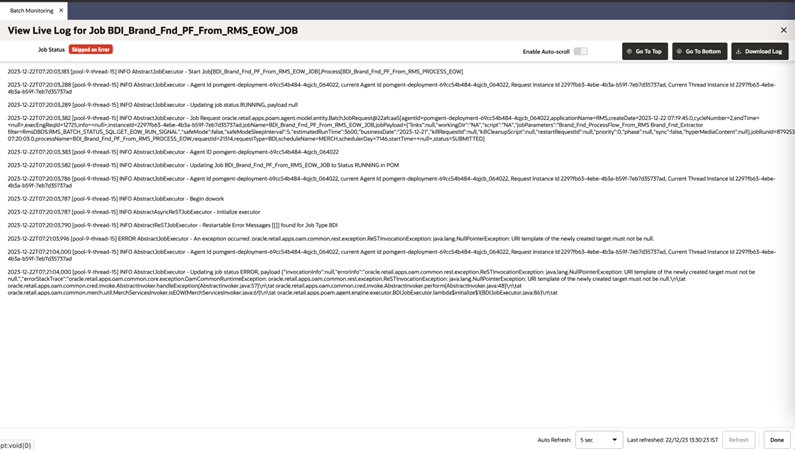

View Live Log
The View Live Log window displays the live log of the running jobs.
View Live Log Screen
The following options are seen in the window.
  • Enable Auto-scroll – When this switch is turned on, the log auto scrolls to view the next page.
  • Go to Top – Scroll to the top of the page.
  • Go to Bottom – Scroll to the bottom of the page.
  • Download Log – Downloads and displays the content of the log.
  • Auto Refresh (Footer) – Live log refresh interval.

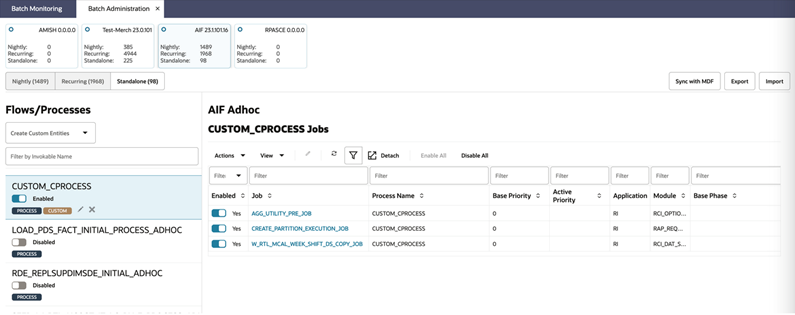

Show Disabled
Use the Actions > Show Disabled or Show Disabled. By Default, the table won’t show any jobs with Disabled Status. Use Show Disabled button or action to see the list of Disabled job.

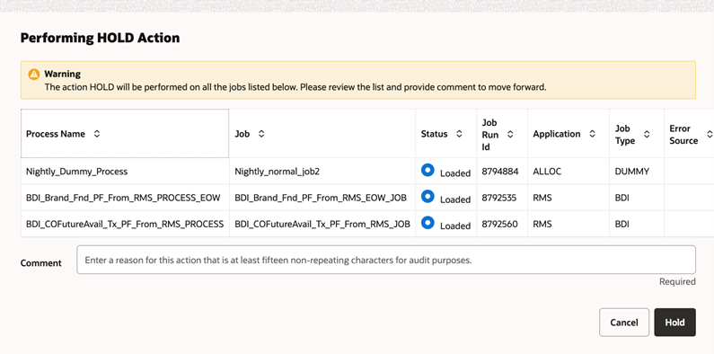

Hold
Use the Actions > Hold or the Hold button to put the process on hold.

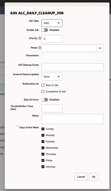

Edit Parameters
Use the Actions > Edit Parameters or the Edit Parameters button to edit the parameters for the job. The new parameters are only effective for the current day's batch run.

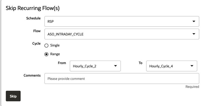

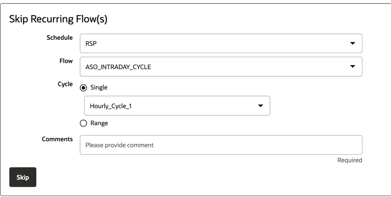

Skip Recurring Flow(s)
A job in a recurring flow can be skipped by selecting the job and clicking the Skip button in the table toolbar. The confirmation pop up (below) opens asking the user if the job should to be skipped for the currently selected recurring cycle or for this and all subsequent recurring cycles as well.
Skip Recurring Flow Window
Refer Skip Recurring Flow(s) under “AMS Utilities” to skip an entire flow in one or more hourly cycle(s).
Status Details for Job
Certain status values on the Batch Jobs section such as 'Error' or 'Long Running' act as a link. When clicked a popup is displayed containing more details about why the job is in the given status and helpful suggestions for resolving the issue. An example is shown below for a job in error.
Job Status Details Window

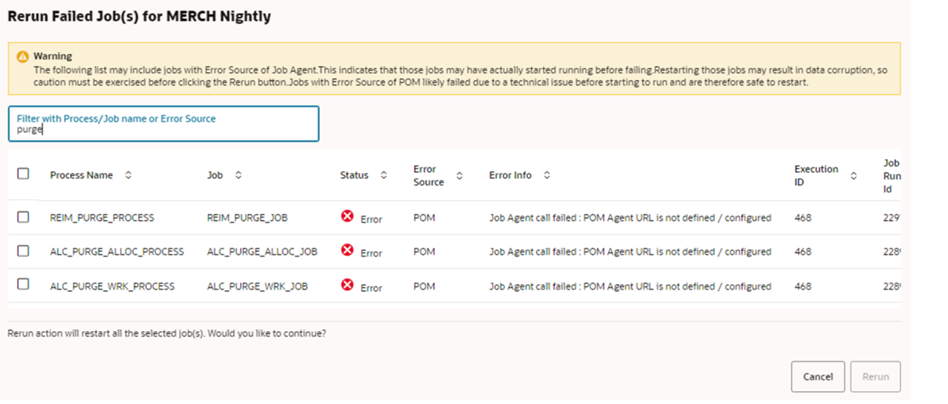

Rerun Multiple Jobs
Multiple failed jobs can be selected on the Batch Monitoring table and restarted by clicking the Rerun Failed Job(s) button from the table toolbar.
Rerun Multiple Jobs Screen
Multi-Select Jobs
Multiple jobs can be selected on the Batch Monitoring table and all actions like Run, Rerun, Hold, Skip, Kill, and so on can be performed on the selected jobs. The pop-up window below opens for every action performed, asking the user to enter a comment before performing the action.

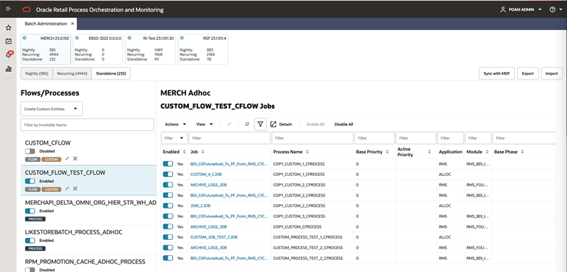

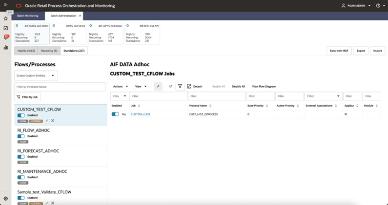

Standalone Batch Jobs
The standalone cycle includes the following information for each flow, process and job:
Figure 2-12 Standalone Batch Sections
Left Pane of the Screen
  • Search by Name or Status - Search for an invokable by entering a search term and clicking Enter. An invokable can be a flow or a process that does not belong to a flow.
  • Show Disabled - When this switch is enabled, disabled processes and flows are also listed on the left panel.
  • Flows/Processes - The following information is shown for each flow/process:
    • Flow/Process Name
    • Status
      • Loaded - A flow or process is in a Loaded state when the scheduler day is first created.
      • Completed - A flow or process that ran successfully on the system.
      • Error - A failure of a flow or process occurred due to an issue in the environment or the job's application.
      • Cancelled - A flow or process in a Loaded status is marked as Cancelled when the scheduler day is closed.
    • Flow/Process Label
    • Run Icon Run Icon - Click on the play button to run the adhoc flow/process. It is available only when the status of the flow/process is in a Loaded or Completed status.
Right Pane of the Screen
Click a row in the left panel of the Standalone Entities table to refresh the Batch Jobs table, list the jobs for the selected standalone flow/process, and display information similar to what is listed in the Nightly and Recurring Batch Jobs section above.
Action Menu and Icons
See Table Menu Options in Common User Interface Controls for information about the options available in this section. You can also perform the following actions:
Actions Menu/Icons Description
Show Disabled
Use the Actions > Show Disabled or Show Disabled. By Default, the table won’t show any jobs with Disabled Status. Use Show Disabled button or action to see the list of Disabled jobs.
Run
Use the Actions > Run or the Run button to immediately run the individual job of the process or flow.

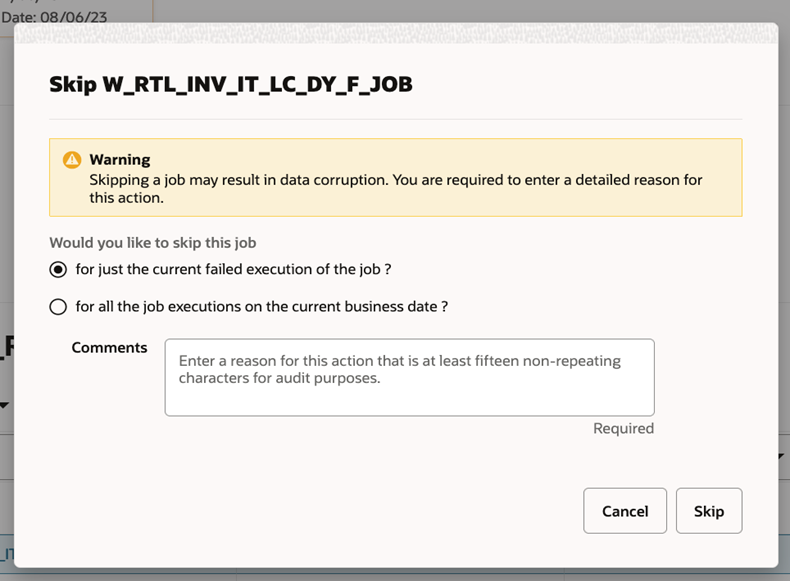

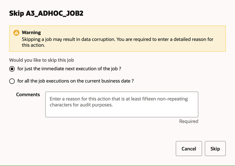

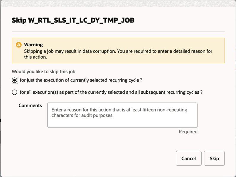

Skip
Use the Actions > Skip or the Skip button to skip the batch job immediately. Based on the status of the job (Loaded or Error), a warning pop up opens if the job needs to be skipped for the current failed execution or for the immediate next execution or for all job executions on the current business date.
Figure 2-13 Skip Warning – Job is in ‘Loaded’ or ‘Completed’ status
Figure 2-14 Skip Warning – Job is in ‘Error’ status
Standalone Execution Details
Figure 2-15 Standalone Executions
Clicking on a flow/process link from the left panel of the Standalone Entities table opens a new modal window displaying the Batch Execution details. The following information is displayed about each execution.
  • Status
    • Loaded – Jobs are in loaded state when the scheduler day is first created.
    • Completed – Job ran successfully on the system.
    • Error – A failure occurred due to an issue in the environment or the job’s application.
    • Cancelled – Flow which are in Loaded status, are marked cancelled when the scheduler day is closed.
  • Execution ID
  • Process Exec ID
  • Start Time
  • End Time
Figure 2-16 Standalone Execution Detail
The following information about the jobs executed for each Execution ID is displayed when an Execution row is selected.
  • Status
    • Disabled - Job is in disabled state.
    • Skipped - Job is in skipped.
    • Skipped_On_Error - Job is in skipped when it throws an error
    • Held – Job is in held state.
  • Job – Name of the job
  • Process – Name of the process
  • Job Exec ID
  • Job Run ID
  • Start Time
  • End Time
Clicking on the job link (for example, VARIABLE_REFRESH_JOB) from the Execution Details table opens the Batch Job details in a new modal window and provides detailed information about a batch job

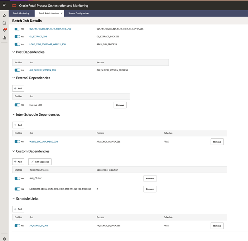

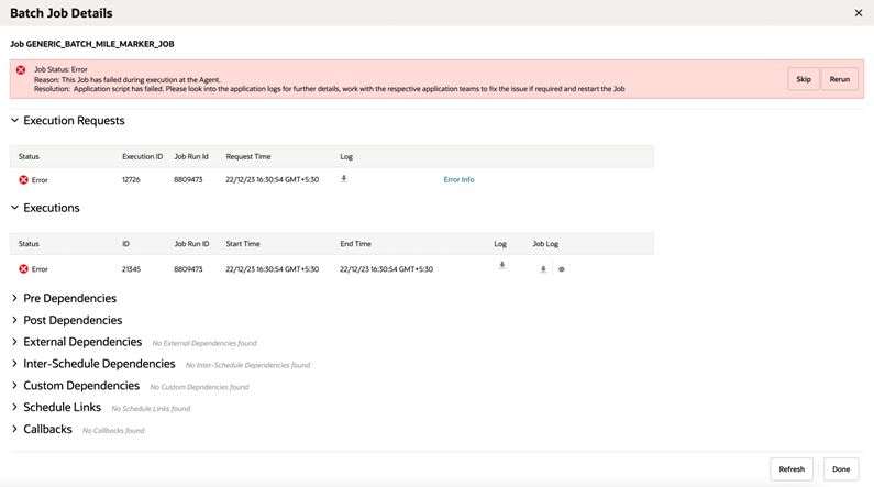

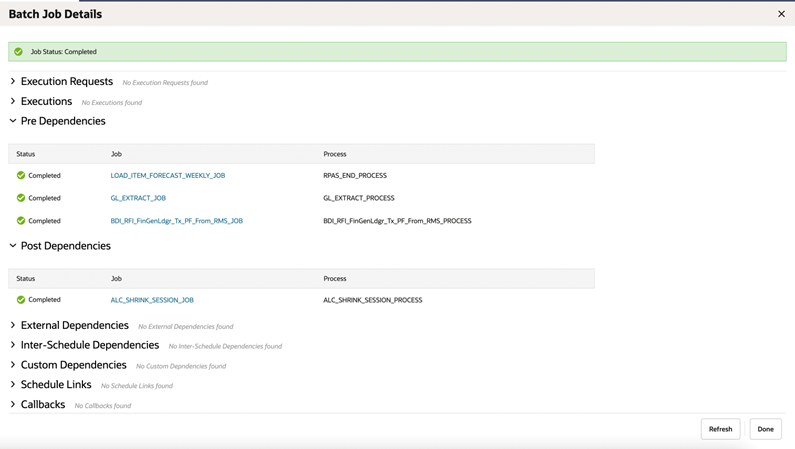

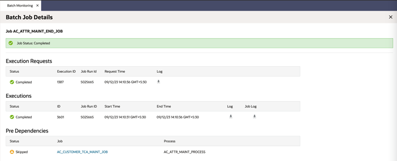

Batch Job Details
The Batch Job Details screen provides detailed information about a batch job.
Depending upon the status of the job, one or more of the following buttons will be available at the top of the screen:
  • Hold
  • Run - This is available only for Standalone jobs.
  • Release
  • Release Skip
  • Rerun
  • Skip
Figure 2-17 Batch Job Details
Batch Job Details Screen
Figure 2-18 Batch Job Details – Continued
Figure 2-19 Batch Job Details with Status Information
Execution Requests
Execution Request
Execution Request
If the job was executed, this section displays the following information about the job execution:
  • Status
  • Execution ID
  • Request Time
  • Log - Provides a link to download the execution log
  • Error Info - This will only show in case of an error status
Executions
Executions
  • Status
  • ID
  • Job Run ID
  • Start Time
  • End Time
  • Log -Provides a link to download the detailed execution log. This log, unlike the Job Log, contains more information related to POM application activities rather than just Job execution activities.
  • Job Log -Provides a link to download the job execution log.
Pre Dependencies
Pre Dependencies
This section displays the following information about job pre-dependencies:
  • Status
  • Process
  • A Disable/Enable button is available for jobs that have not yet completed.

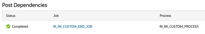

Post Dependencies
Post Dependencies
This section displays the following information about job post-dependencies:
  • Status
  • Process
External Dependencies Section
An external dependency is usually a dependency on a customer's internal process. This dependency is released once the customer calls an endpoint into POM for a specific POM job. This section displays the following information about job external dependencies:
  • Status
  • Job - Click to open the job in the Batch Job Details screen. The job that, when complete, will release the dependency which the currently displayed job is waiting on.
Inter-Schedule Dependencies Section
An inter-schedule dependency links the current schedule and a target schedule where a job in the target schedule is dependent on the completion of the currently displayed job in the current schedule. This section displays the following information about job inter-schedule dependencies:
  • Status
  • Job - Click to open the job in the Batch Job Details screen. Job which is dependent on the source job.
  • Schedule - Schedule containing the process/job.
This section displays the following information about schedule links for a job:
  • Status
  • Job - Click to open the job in the Batch Job Details screen. The job in the Target Schedule that., when completed, will fulfill the dependency for the currently displayed schedule.
  • Process - The process the job belongs to.
  • Schedule - The schedule whose job is a dependency for the job in the current schedule.
  • A Retry button is available for schedule links with a Skipped or Failed status.
Callbacks
Callbacks Section
This section displays the external status update request and response callbacks based on the External Status Update mode set in the External System Configuration screen. This section displays the following information about job callbacks:
The callback payload window shows the field name and value for each field in the payload.
Select Done to close the window.
Figure 2-20 Callback Payload Window
The callback info window shows information about a request and response.
Figure 2-21 Callback Info Window

Use the Rerun Failed Job(s) button to open a pop-up list of all failed jobs in the cycle regardless of the reason for failure. The user can then select the jobs they want bulk-restarted.

Status
Status
The Status sidebar displays information about the Scheduler, Execution Engine, and the environments that Process Orchestration and Monitoring communicates with to execute batches.
Figure 2-22 Status Sidebar
Status Sidebar
Scheduler
Displays the status of the Scheduler, and an Admin link to enable or disable the scheduler for a particular batch schedule in the Scheduler Administration window.
Execution Engine
Displays the status of the execution engine, and a Config show configuration of the execution engine in Execution Engine Configuration.
Environment Statuses
Displays the following for each environment:
Figure 2-23 Environment Status
Environment Status Display
  1. Status - Icon indicating the current status of the integration with the environment. This will be either success Success Icon or error Error Icon.
  2. Schedule - Display Name of the Schedule
  3. Health Check - Opens the Health Check for the schedule.
  4. Active/Suspended Switch - Toggle button to suspend or activate the schedule. Suspending the schedule prevents new job run requests from being processed by POM. Jobs that are already running will keep running and won’t be terminated. Activating the schedule causes POM to resume processing all job requests for the schedule.
  5. Link - An icon which indicates if Inter-Schedule Dependencies are enabled or disabled.

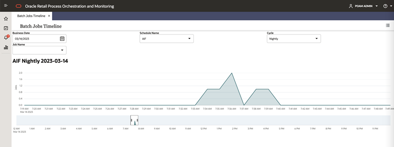

Use the Download Cycle Summary window to download information about a completed batch cycle:
  1. Click Download Cycle Summary in the Batch Jobs Header.
    The Batch Cycle Summary window opens.
    Figure 2-24 Download Cycle Summary Window
  2. Use the Cycle menu to select the cycle for which to download the summary.
  3. Select the Type of data to download: CSV (comma-separated values) or JSON.
  4. Click Download to download the summary file, or click Cancel to close the window without downloading.
  5. Click Open Report to open the Batch Jobs Timeline window.

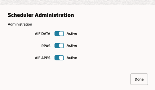

Scheduler Administration Window
The Scheduler Administration window allows you to enable or disable batch schedules.
When the Scheduler is disabled for a particular schedule, tasks will still be scheduled and will still trigger at the specified time but will immediately move to the Cancelled state.
Select the Done button to close the window.
Figure 2-25 Scheduler Administration Window

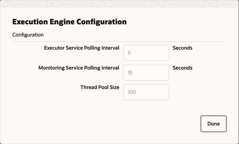

The Execution Engine Configuration window displays configuration of communication between the user interface and the execution engine.
This window displays the following configurations:
Figure 2-26 Execution Engine Configuration Window
  • Executor Service Polling Interval - Determines the number of seconds between each polling interval for the batch execution process on Process Orchestration and Monitoring.
  • Monitoring Service Polling Interval - Determines the number of seconds between each polling interval for the monitoring process on Process Orchestration and Monitoring.
  • Thread Pool Size - Maximum number of concurrent threads permitted for use by the Execution Engine.

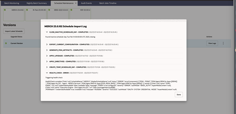

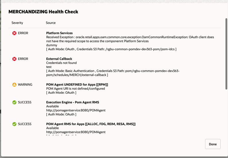

Health Check
The Health Check window displays the status of the processes communicating with the environment.
Figure 2-27 Health Check Window
Health Check Window
This window displays the following for each communication process:
  • Severity - The severity of any errors in communication:
    • Success Icon SUCCESS - The process communicates successfully.
    • Error Icon ERROR - The process is not communicating with the environment.
    • Warning Icon – WARNING – POM Agent is not configured / not mapped to any application.
  • Source
    • The name of the process
    • The response received by the process
    • POMAgent URL
    • Auth Mode and S3 path (if applicable)
Activity Feed
The Batch Monitoring screen includes an Activity Feed icon at the top right corner.
Activity Feed Icon
When the icon is clicked, the Activity Feed panel opens on the right side of the screen. The panel displays up to seven days’ worth of activities performed both by the system and by users through the user interface.
Click the close window icon (Close Window X Icon) to close the window.
Figure 2-28 Activity Feed
Activity Feed

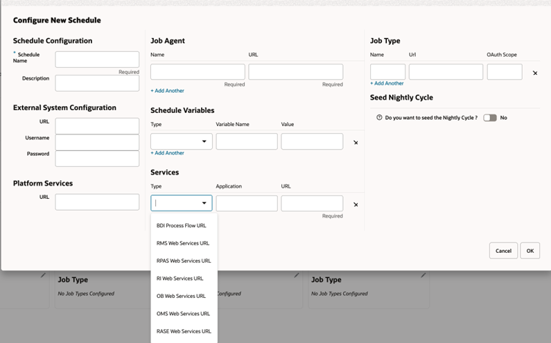

Configure New Schedule
When POM is first installed for a specific customer, it does not include any application batch schedules out of the box such as Merchandising, Retail Intelligence, and so on. An Oracle administrator or a system integrator needs to first configure those schedules before they can be loaded (from a batch schedule spreadsheet). Configuring a new schedule entails setting up schedule properties such as the schedule name and description, customer environment information for callbacks. It also entails setting up the location of different components and services with which different POM components need to interact to function properly.
Configuring a new schedule is typically done upon provisioning the environment by Oracle operations. If for any reason the configuration has not yet been done by Oracle, an administrator can alternatively accomplish that through the UI.
To configure a new schedule, click the Configure New Schedule button at the top right of the Schedules tab of the System Configuration screen. The Configure New Schedule window is displayed.
Figure 2-30 Configure New Schedule
Configure New Schedule Window
The following new schedule information can be set on this window:
  • Schedule Configuration - This is for identifying and describing the schedule. Attributes for this section are:
    • Schedule Name (Mandatory) - A short identifier of the new schedule. This usually matches the main application name such as Merchandising, RI, and so on. The Schedule Name must be 10 characters or less
    • Description (Mandatory) - A short description of the schedule.

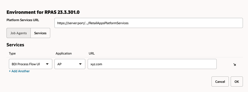

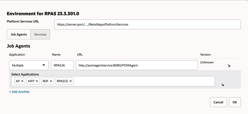

  • External System Configuration (Optional) - This identifies an external system, typically a customer's environment. This is needed for optionally notifying the customer's system of a job failure or success. This feature is also referred to as Callback. Attributes for this section are:
    • URL
    • Username
    • Password
  • Platform Services (Optional) - Internal Oracle services for retrieving information stored there by other applications or systems. Attribute for this section is:
    • URL
  • Job Agent (Mandatory) - The Job Agent is a component of POM responsible for submitting the request to execute a batch job. This is usually deployed in the same location as the application where the jobs actually run. The same agent can be used for multiple schedules. If the schedule being configured contains multiple applications, it is optional to add an agent for each application. This isn't a common practice however as an agent can handle running multiple applications. Attribute for this section is:
  • Schedule Variables (Optional) - These variables hold System (POM) level configurations such as IDCS or OCI IAM URL, or Job level configurations such as batch directory, DB_ALIAS, and so on. The job level configurations can also be defined on the batch schedule spreadsheet. Attributes for this section are:
    • Type - Job or System
    • Variable Name
    • Value
  • Services (Optional) - This section allows for entry of services POM integrates with. These include the BDI Process Services, IDCS or OCI IAM, and all services corresponding to the different applications with service-type batch jobs. Attributes for this section are:
    • Type - This is a drop down for all the possible service types; for example, the RI Web Services URL which POM would use to invoke RI service-based batch jobs.
    • Application - Application Name to which this service corresponds such as RI.
    • URL
  • Job Type (Optional) - This is an optional section for setting up one or more custom job types other than the standard, pre-defined job types provided by the retail applications, such as EXEC, RI, RASE, BDI, RDS, OB, OMS, and RPAS. The user then associates a custom job type with the base URL for endpoints at the destination system. These are endpoints for starting a job, restarting a job, killing a job, checking status of a job, fetching the log for a job, and validating the URL. By setting up a custom job type, the user must then create a custom schedule spreadsheet containing jobs with that job type. When this batch schedule runs, POM executes that job using the corresponding, defined Start endpoint. If the user misses the opportunity to configure the job type at this point, they do have the opportunity to add that using the Job Type Configuration screen (see Create / Edit Job Type for more information). Attributes for this section are:
    • Name – A short, alphanumeric identifier of the job type. This typically reflects the system or application where associated jobs are to be executed (for example, RDS).
    • URL – Base URL for endpoints at the destination system where batch is to be invoked (for example, https://server/services/batch).
    • OAuth Scope – Authentication scope for accessing the batch endpoints at the above URL.
  • Seed Nightly Cycle (Optional) - This is an optional section to auto-seed the nightly jobs in the new schedule. Entering a Schedule Name and turning on this switch creates a basic batch schedule by seeding the Nightly cycle with default start and end jobs.

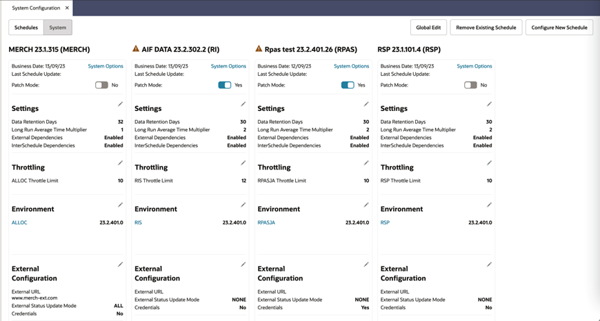

Select the Schedules tab on the System Configuration screen to configure the settings and connections for an environment.
The following information is shown for each environment:
Schedule Version Number
  • Display Schedule Name.
  • Schedule version number.
  • Schedule name abbreviation (in parenthesis).
    This is the name to be used when calling POM APIs.
Last Schedule Update Information
  • Business Date - Date for which the specific schedule's batches will run next.
  • The system options are a set of key-value pair of attributes and values specific to the given schedule such as location of directories or throttle enabling setting. System options can also be used to define shell script warning or error exit codes. If any such codes are specified, they will cause a shell-script-based job to fail or complete with warning.
    Examples of system options:
    • Last Schedule Update - Last date on which the schedule was updated.
    • Patch Mode - Enable/disable the patch mode to activate/cancel a patch respectively. This switch is turned on when the POM application or an individual schedule is in the process of being patched. In this case, POM will block any new execution requests for the affected schedule(s). The switch is then turned off when the patch is done. It is not recommended for users to alter this switch on this screen except to turn it off in some situations. The most common situation is when patching is held up or errors out and the patch is to be ignored so that users can resume using the application.
    • Patch Source - Multiple applications can now put a Batch Schedule in patch mode, when needing to pause batch to upgrade their schedule or for other reasons. Patch source will show all the source systems that have put the schedule in patch mode. put the schedule in patch mode.

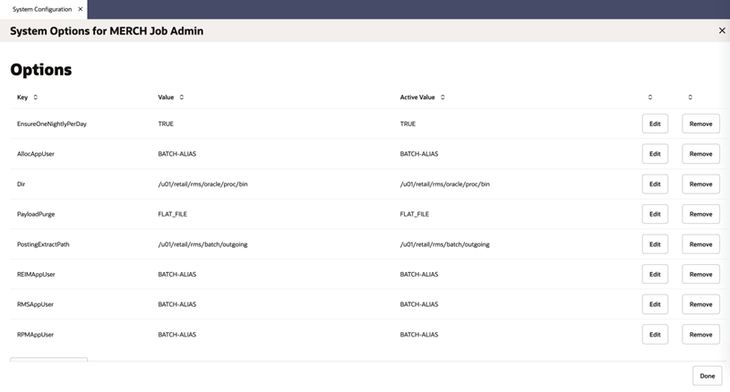

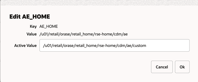

  • System Options link
    Each Schedule is associated with a number of system options specific to its environment and settings. Those can be edited by clicking the System Options link located next to the Business Date.
    Figure 2-31 Edit System Options
    Edit System Options
    Key Value
    enableThrottling
    FALSE
    WarningCode110
    Some input files were not processed
    ErrorCode40
    Input file corruption detected
    The user can alter the value of a system option by adding an Active Value in the Edit window.
    Alter System Option Value
    The user can also add and remove options.

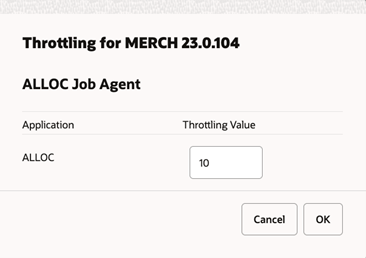

  • Throttling - See Edit Throttling for details.
    Throttling Information
    • Job Agent Throttle Limit

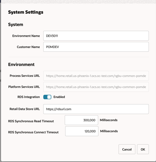

  • Environment - See Edit Environment for details.
    Environment Information

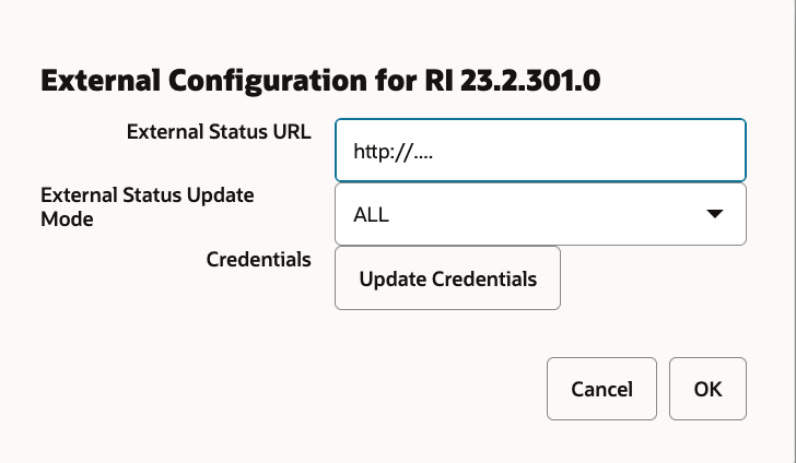

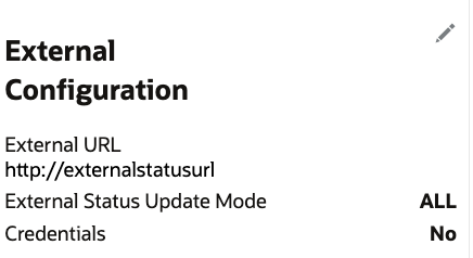

  • External Configuration - See Edit External Configuration for details.
    External Configuration Information
    • External URL
    • External Status Update Mode
    • Credentials

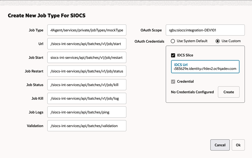

  • Job Type - See Create / Edit Job Type for details.
    Job Type Information
    • Job Type - For example, RDS.

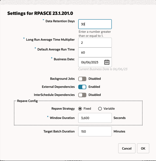

Edit Settings
To edit the settings for an environment, click the edit icon Edit Icon in the Settings section to open the Settings window.
Figure 2-32 Edit Settings Window
The following settings are available in this window:
  • Data Retention Days - Number of days for which data is to be retained
  • Long Run Average Time Multiplier - Used to calculate when a job is considered long running.
    If a Threshold Run Time is specified on the Edit Job popup of the Batch Administration screen, then a job is deemed long running if its current run time exceeds that value.
    Otherwise, if a Threshold Run Time is not specified, then the job is deemed long running when its current run time exceeds this Long Run Average Time Multiplier times the average run time of that job + Long Running Tolerance Level. The value for the Long Running Tolerance Level can be overridden by changing the value of batch schedule variable defaultLongRunningToleranceLevel on the System Options screen accessed from the System Configuration screen. The value is in seconds.
    If the Threshold Run Time field for a job is 0 or blank, and there is no history of job runs, a job will be considered long-running when its run time exceeds the default long running threshold run time of 10 minutes. This default value can be overridden by changing the value of batch schedule variable defaultLongRunningThresholdRunTime on the System Options screen accessed from the System Configuration screen. The value is in seconds.
  • Default Average Time - Used instead of multiplying a job’s average run time by the Multiplier (defined on this screen) when the job does not have run history. This is to determine whether a job can run on a certain node when the Node Repaving is upcoming. For example, say a node’s repaving is taking place in 30 minutes. If a job has a run history and its average runtime multiplied by the Multiplier is greater than 30 minutes, then the job will run on a different node. If however the job has no run history, then this Default Average Time is used instead.
  • Business Date - The earliest business date for which to run batch schedules. See Business Date Explained for an explanation of how POM uses this setting.
  • Background Jobs - Enable or disable background jobs.
  • External Dependencies - A switch for enabling or disabling external dependencies.
  • InterSchedule Dependencies - A switch for enabling or disabling InterSchedule dependencies.
  • Repave Strategy - This strategy together with the next field's value is used to determine if a job should be allowed to run on a particular server node. When a node is scheduled to be repaved (updated with the latest software patch), no batch job should be running on it when the repave starts. To prevent such a situation, a best guess is needed as to when a node should stop accepting jobs to be run. There are two strategies for determining when that time is:
    • Fixed: Uses the next field's value (Window Duration - in seconds) to determine the time at which the node will start rejecting requests for running jobs. For example, if this value is 3600 seconds, the node will stop accepting requests one hour before the repave starts.
    • Variable: Multiplies the next field's value (multiplier) with the job's average run time to determine if the node likely has enough time to run the job to completion. For example, if the multiplier is three and the job about to be submitted for running on this node has an average run time of five minutes and the repave is due to start at a time longer than the 15 minutes (the product of the two numbers), the job will be allowed to run. Otherwise, it won't be.
      If a job does not have a run history (therefore does not have an average runtime), then the Default Average Time (also defined on this screen) is used instead of multiplying a job’s average run time by the multiplier field defined next.
  • Window Duration / Multiplier - This field is dynamically altered on the screen depending on the previous field's value and is used in conjunction with the previous field. See the previous field's explanation for details.
  • Target Batch Duration - This is in minutes. This value is used as a target/baseline on the bar graph in the Batch Timings section of the Nightly Batch Summary report. See the Nightly Batch Summary report in the Reports section of this guide.
Select OK to save the changes or select Cancel to exit the window without saving changes.

Edit Environment
The environment settings can be changed by selecting the edit icon Edit Icon in the Environment section to open the Environment window.
One schedule can be supported by one or multiple Job Agents. Usually, the mapping is one Job Agent to an application.
Also, the Job Agent is a component of POM responsible for submitting the request to execute a batch job.
Figure 2-34 Edit Environment Window
At the top of the Environment window, the user can set the Platform Services URL.
The window then provides two tabs: the Job Agents tab and the Services tab.
On the Job Agents tab, the user can add or change the following Agent related information:
  • Application - application name
  • Name - Agent's name
  • Job Agent Version - Release version of the Agent
  • Job Agent URL
On the Service tab, the user can add or change services related information. These are services that POM integrates with, such as BDI Process Services, IDCS or OCI IAM, and all services corresponding to the different applications with service-type batch jobs.
The external configuration settings can be changed by selecting the edit icon Edit Icon in the External Configuration section to open the External Configuration window.
Figure 2-36 Edit External Configuration Window
  • External Status URL - Customer system's URL that is called when POM is to notify the customer's system. Note that this calling feature is also referred to as Callback.
  • External Status Update Mode - Job status for which POM is to call the customer's URL. This menu has the following options:
    • ALL - POM will make a call for each job's execution regardless of success or failure.
    • FAILED - POM will make a call only for failed jobs.
    • NONE - POM will never make a call.
  • Update Credentials - When clicked, Username and Password fields are shown. Setting these values will update the credentials POM uses to call the customer's URL.

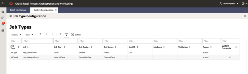

Job Types
Job Types window displays a table of configured job types. The user can edit or delete an existing row or create a new job type.
See the “Generic ReST Jobs” chapter of the POM Implementation Guide for additional details on setting up custom schedules with custom job types.
Figure 2-37 Job Types Table
Job Types Table
Each row contains the fields:
  • Job Type - A short, alphanumeric identifier of the job type. This typically reflects the system or application where associated jobs are to be executed (for example, RDS).
  • URL - Base URL for endpoints at the destination system where batch is to be Invoked (for example, https://server/services/batch).
  •  Job Start - Endpoint for invoking the execution of a job.
  •  Job Restart - Endpoint for restarting the execution of a job after failure.
  •  Job Status - Endpoint for POM to fetch the status of a started job.
  •  Job Kill - Endpoint for terminating the execution of a running job.
  •  Job Logs - Endpoint for fetching the log(s) for a job.
  •  Validation - Endpoint for validating that the endpoints are reachable.
  • Scope - Authentication scope for accessing the above endpoints.
  • Custom Credential - Displays a tick mark if the credential is custom created by the user for that job type. Else, blank.

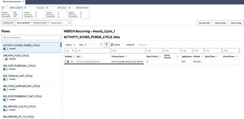

The batch administration screen provides the ability to maintain information specific to the batch schedule.

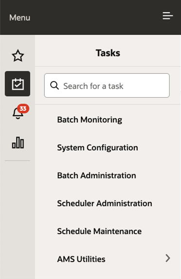

Select Batch Administration in the Navigation Area to open the Batch Administration tab.
Figure 2-46 Batch Administration
Batch Administration Header
The Batch Administration header includes the following options:
  1. Batch Tiles - There is a batch tile for each software environment Process Orchestration and Management connects to. Select a tile to show the batch processes for that environment. See Batch Tiles for more information about these tiles.
  2. Cycle Tabs - Displays the cycles for which batch information is to be maintained.
    Select a cycle tab to see the batch details for that cycle. The following cycles are available:
    • Nightly
    • Recurring
    • Standalone

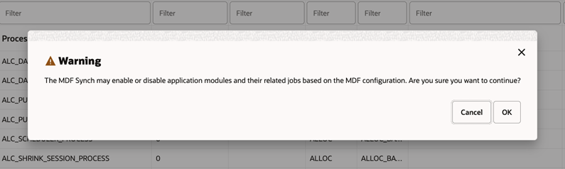

  3. Sync with MDF – MDF is the Module Definition Framework maintained in the Retail Home Customer Module Management module of Retail Home. Using the Sync with MDF button in POM will sync the modules defined in POM with those in Retail Home. Nightly jobs belonging to those modules are then enabled or disabled based on their state in Retail Home.
    When Sync with MDF is clicked for the selected application schedule, the user is presented with a warning message advising that jobs may be enabled or disabled as a result of the synch action.
    Figure 2-47 MDF Sync – Warning Message
    MDF Sync Warning Message
    After the sync is complete, a JSON file with the batch schedule summary is downloaded. This file contains the current and previous status of an application and module in MDF and POM after sync.

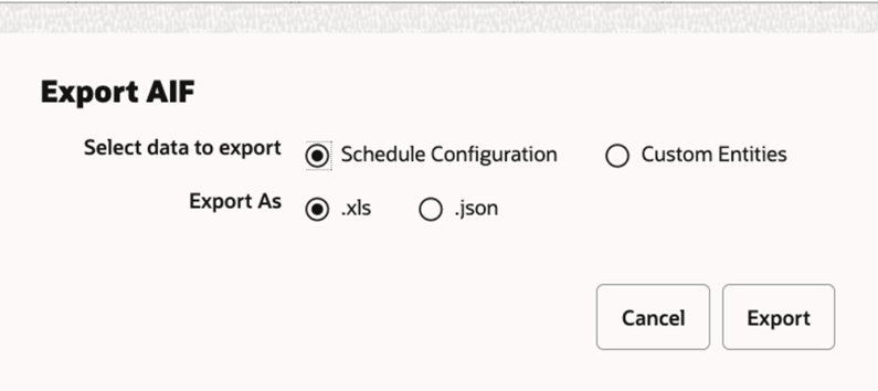

  4. Export - Use this button to export Schedule Configuration or Custom Entities for the selected schedule and cycle. Schedule configuration includes Scheduler tasks, throttle limit values, data retention values, notifications settings and (most importantly) which jobs are enabled or disabled. Custom Entities include schedule customizations that a user has performed on this Batch Administration screen such as addition of custom flows, processes and jobs.
    When clicked, the user is presented with a dialog for selecting the data to export – Schedule Configuration or Custom Entities.
    If 'Schedule Configuration' is selected, then the type of file to export (Excel or JSON) also has to be selected.
    Export Schedule Configuration
    Custom Entities can only be exported as JSON.
    Export Custom Entities
    Depending on the user's browser setting, the file is either saved in the default local file system directory or a file save/open dialog is presented first.
    Export Configuration Dialog
    If the export is done for the purpose of applying the same configurations on another environment (Lift & Shift), the user is recommended to export to a JSON file. This file is then used in the Import Config function (explained below) to import the configurations into another environment.
    The user has the option to manipulate the exported file before importing back into the same environment or a different one. In that case an export to an Excel file is more suitable for ease of manipulation. Caution needs to be taken when manipulating the content of the exported file, especially for maintaining proper data format.
    Refer to the “Export/Import Schedule Configuration” chapter of the Process Orchestration and Monitoring Implementation Guide for details on applying changes to the exported spreadsheet before importing it back in.

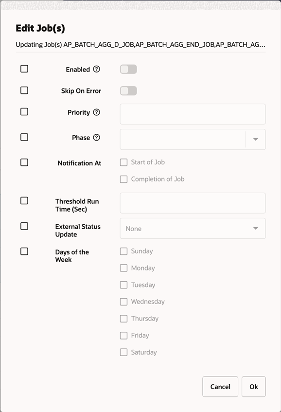

Edit and Edit icon Edit Icon
Select an item in the table, then select Actions > Edit or the edit icon Edit Icon to edit the item.

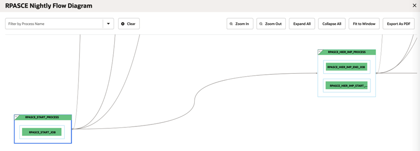

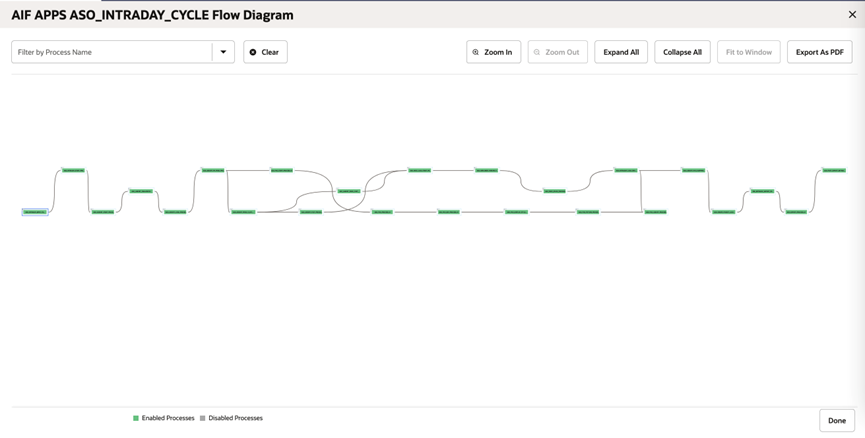

View Flow Diagram
When clicked, the View Flow Diagram button displays a visual representation of a flow. It shows a flow diagram of the processes in a flow and their dependencies as links. This is applicable for Nightly, Recurring and Standalone cycles. The user can then click on a particular Process in the diagram to see the list of its jobs in the sequential order of execution.
Figure 2-49 Flow Diagram
Flow Diagram
Filter by Process Name
When filtered by the Process Name, the flow Diagram displays and highlights the Process Name in blue.
Process Name Filter
Flow Filtered by Process Name
Zoom In
Zoom in the flow diagram to get a larger view of a section of the flow.
Flow Zoomed In
Zoom Out
Zoom out the flow diagram to view more processes.
Expand All
The Expand All button expands all the processes to get a view of their jobs. Individual processes also can be expanded by clicking on the + sign in the left top corner of each process block.
Expand All
Collapse All
The Collapse All button collapses all processes, hiding their jobs.
Fit to Window
Fit to Window fits the complete Flow Diagram in the browser window.
Fit to Window
Export as PDF
Export as PDF exports the visible section of the screen to PDF.
Export PDF Confirmation Prompt
Exported PDF Example
Enabled / Disabled Process
Enabled and disabled processes are shaded in green and grey respectively. The labels can also be seen in the footer.
Enabled and Disabled Processes
Linked Processes
When hovered over a link, the linked processes details are displayed.
Linked Processes
