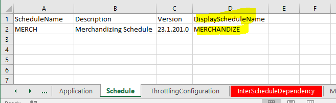

Schedule |
Defines the name, display schedule name and version of the Batch Schedule. |

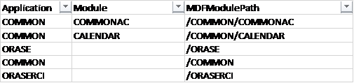

Application |
Defines the Applications to which the Jobs belong. It also defines a mapping between an Application and the name of the Job Agent that must run those Jobs. |
Modules |
Defines Modules within Applications. These are mainly used to synchronize with the Modules defined for the Application in Retail Home. See Sync with MDF in the POM User Guide for further details. |

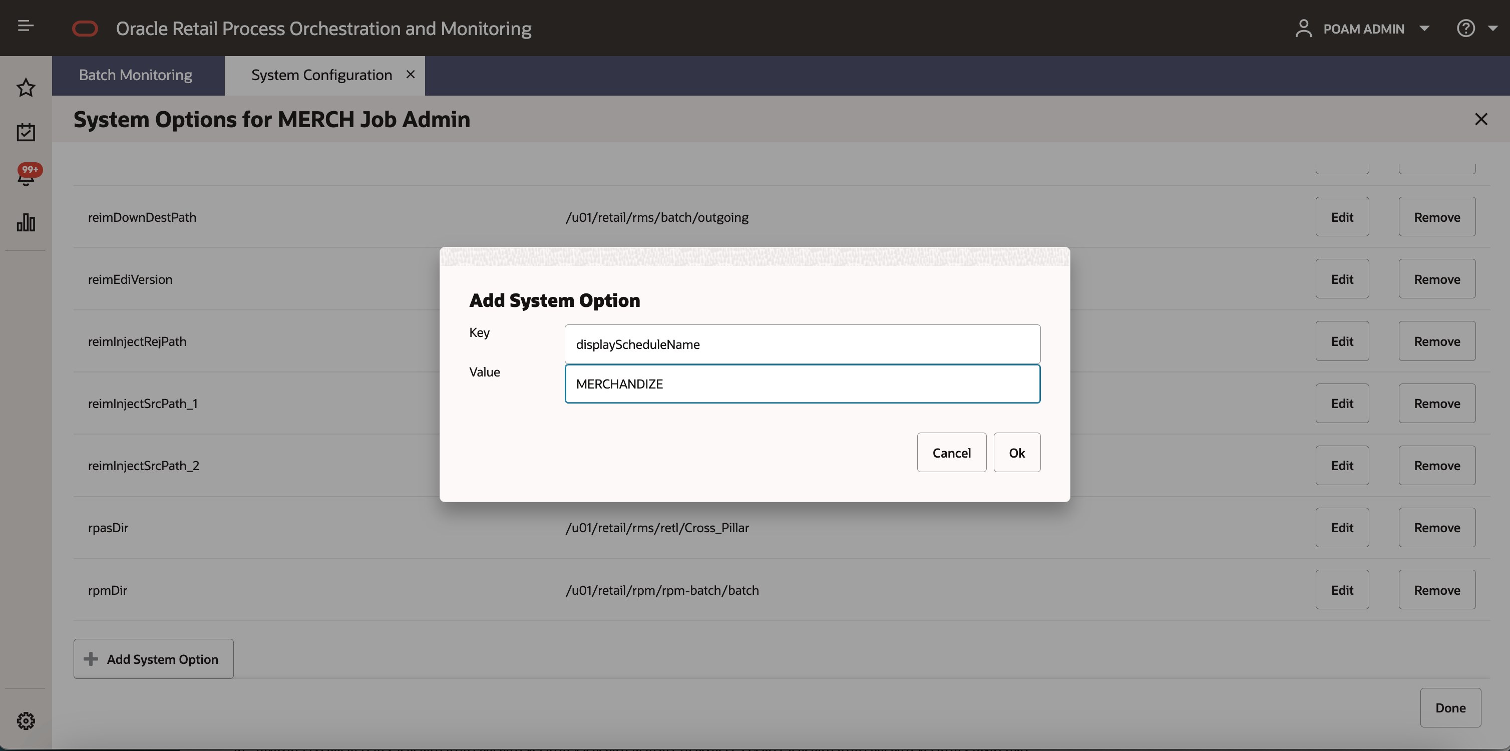

SystemOption |
Lists all the system options available to the Jobs at execution time. |

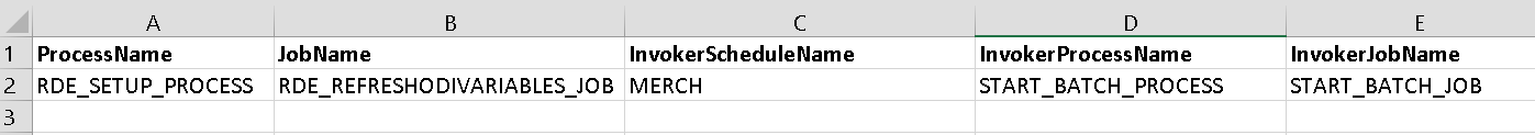

BatchLinks |
Also known as Schedule Links. If the Nightly Flow is going to be invoked via a different Job on a different Schedule, then a Schedule Link can be defined. |

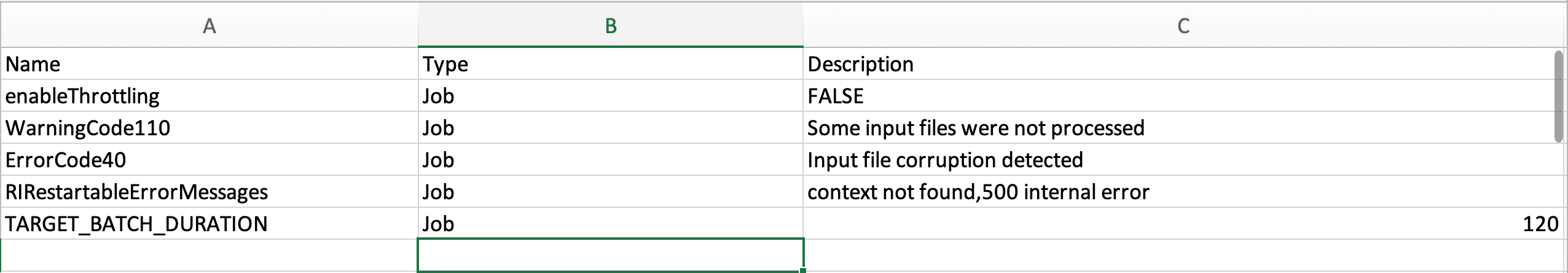

Schedule Errors |
Empty tab that is populated with the list of errors, either by the macro or when being transformed by the Batch Schedule Transformer. |

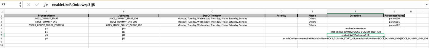

Schedule Upgrade Directives
These are directives solely to the Batch Schedule upgrade process, altering values as specified, when the default settings are not acceptable. For instance, all newly added Jobs are marked DISABLED by default. To enable a Job, the AMS team or the Customer is asked to do so through the POM UI. This is not ideal as it involves manual intervention. To overcome this, we use the “enableOnNew” directive on the Job tab, to ensure that the Job is marked ENABLED when its added for the first time.
The processing of these directives is designed as a stage in the Schedule Import process. The following directives are currently supported in POM.
| Template Tab | Directive Name | Description |
Job |
enableOnNew |
Only when being loaded for the very first time, the Job will be enabled. When this directive is not used, the job will be disabled by default when added for the first time. |
Job |
enableLikeJobOnNew |
Only when being loaded for the very first time, the status of the Job (for which the directive is specified) will match that of the “LikeJob”. |
Job |
enableLikePJOnNew |
Only when being loaded for the very first time, the status of the Job (for which the directive is specified) will match that of the “LikeProcessJob” defined. |
Batch Links |
enableLinkOnNew |
Only when being loaded for the very first time, the status of the Batch Link will be enabled. When this is not used, batch link will be disabled by default when added for the first time. |
Batch Links |
enableLikeLinkOnNew |
Only when being loaded for the very first time, the status of the Batch Link (for which the directive is specified) will match that of the “LikeLink” |
If any Process-Job combination has multiple directives that are semicolon delimited, they get executed in the following order:
enableOnNew
enableLikePJOnNew
enableLikeJobOnNew
enableLinkOnNew
enableLikeLinkOnNew

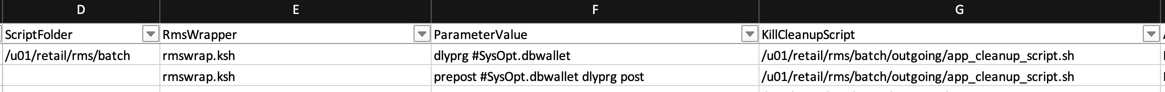

ScriptFolder
This holds the directory path where the Wrapper file resides in the system.
For service type jobs (non-shell script EXEC type jobs), this field should be left blank.
ParameterValue
This holds the entire parameter value to be passed in to a shell script type job. This field is case sensitive.
For parameters that can have multiple values (for example, purge days parameter), provide a default value so that the batch can still be executed.

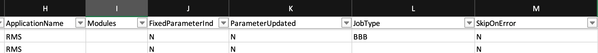

JobType – VARCHAR (50)
The default value set is
EXEC, which represents shell-script based Jobs. Other pre-defined service based job types areRI,RASE,BDI,RPAS,OMS,OB,RDS, andDUMMY. -
Custom Job types defined in the JobType tab can also be used in this field. In this case POM is directed to execute the job using the endpoint defined on the JobType tab.
KillCleanupScript – VARCHAR (1000)
Absolute path of the cleanup script to be run after killing a shell script (
EXEC) type job from the POM UI. Example:/u01/retail/rms/batch/outgoing/app_cleanup_script.sh -
Can include arguments as well along with the script.
The post-kill cleanup script is executed automatically by POM after a Kill is performed from the UI. It does not perform the kill itself. It is defined by the application teams such as Merch. Here's how it works: The user performs a Kill on a running job from the POM Batch Monitoring screen. If a
KillCleanupScriptis defined for that job on the Job worksheet of the batch schedule spreadsheet, POM will execute it after killing the job on the server. Application teams usually include database clean-up as part of the clean-up script.For example:

Directive – VARCHAR (200)
Contains the directive for Process / Job.
Enables/disables a new Job according to the directive provided.
Valid values: enableOnNew, enableLikePJOnNew, enableLikeJobOnNew. See the Schedule Upgrade Directives section above for more details on the use of these values.
This is an optional column. Leaving it blank will create the job as disabled.
The value of this column is a semi-colon separated string of directive key-value pairs. A process job can have one or more than one directive defined.
ParameterValue–VARCHAR(2000)
Parameter value for the process–job combination.
Value will be updated during schedule patching only if the value has never been updated using the UI.
This field should be part of either the Job sheet or the ProcessJobMapping sheet.

SystemOption Tab
The SystemOption tab contains the system level options used to control certain aspects of the POM application, such as whether to enable throttling. It can also be used to define shell script error or warning exit codes. If any such codes are specified, they will cause a shell script based job to fail or complete with warning.
This tab can be left blank for service (non-EXEC) type jobs.
Name – VARCHAR(255)
Holds the name of the System Option value needed in JOS; for example,
enableThrottling,WarningCode110,ErrorCode40,RIRestartableErrorMessages,TARGET_BATCH_DURATION.A value of
WarningCode110, for example, causes POM to mark the job status as completed with a warning if the job’s shell script exits with a code of 100. A value ofErrorCode40, for example, causes POM to mark the job status as error if the job’s shell script exits with a code of 40.For a value of
<<JOB_TYPE>>RestartableErrorMessages, the description field holds a list of comma-separated error messages that determine the auto-restart capability of the jobs. If the response contains one of those error messages, POM will retry the job for a maximum of 3 attempts.For example, to add this capability to the RI Job Type when encountering either of the messages "context not found" or "500 internal error".
Type – VARCHAR
Valid values are
ProcessandJob(for example,Jobfor system optionenableThrottlingor error/warning shell script exit codes or Restartable Error Messages). -
This defines the JOS admin component the System Option is for.
Jobis forJosJobAdminandProcessis forBdiProcessFlowAdmin.
Description – VARCHAR(255)
This holds the value for the System Option. For example,
TRUEfor system optionenableThrottling, or the error/warning message to be conveyed in the notification sent in the case of an error/warning shell script exit codes, or the error messages to determine whether to auto-restart rest-based jobs or not, or the number of minutes for theTARGET__BATCH_DURATION. The system options value changes are updated during schedule patching.Here's an example SystemOption tab with all the aforementioned system options:

Schedule Tab
The Schedule tab contains the name of the schedule along with version and description. Increasing the version is necessary to upload a spreadsheet with any changes to POM.
ScheduleName – VARCHAR(10)
Holds the name of the Schedule (for example,
MERCH,RDE, orRI).
Description – VARCHAR(100)
Description of the Schedule.
Version – VARCHAR(50)
Version of the Schedule.
DisplayScheduleName – VARCHAR(1000)
Holds the display name of the Schedule (for example,
MERCH,RDE, orRI). -
Optional field. If a value is not provided, value in the ScheduleName field will be used as the display schedule name.
Display schedule name will be used in the UI, reports and e-mails.
If a display schedule name value is not provided on the batch schedule spreadsheet, it can be provided at a later time through the UI. To accomplish that, an entry can be added in the SystemOptions panel from the System Configuration screen.
Example:
Key: displayScheduleName
Value: MERCHANDIZE
This tab cannot be empty for any given schedule.
ThrottlingConfiguration Tab
The ThrottlingConfiguration tab contains the Application / Module Level throttling values. Throttling determines how many
jobs can run concurrently for the given application, so a value of 10 means a maximum of ten jobs can run
concurrently. It is advisable to leave this tab empty unless you have good knowledge of the server memory and CPU capacity.
Application – VARCHAR(50)
Holds the valid application name for which we need to set a throttle value.
If an entry is made in this tab, the Application can’t be blank and should be the value listed in Application tab.
Module – VARCHAR(50)
Holds the module name in the case where we need to set a throttle value at module level.
It is possible to just set throttling at the application level. Modules would then inherit the application’s throttle value. In this case, leave module blank.
This Application / Module combination must be valid per the Application tab.
ThrottledValue – NUMBER
Holds the throttle value for this Application / Module.
This can’t be blank and should be a non-zero positive number.
Example
For an Application without any modules defined.
Application Module ThrottledValue RMS
2
ALLOC
5
REIM
3
RDE
2
For an Application with modules defined, define throttle values at either application or module level or both.
Application Module ThrottledValue COMMON
3
COMMON
COMMONMAINTAIN
1
ORASE
2
If you don’t want any jobs to be throttled at Application / Module level, then leave this tab empty.

This tab contains Batch Links. When you set up a batch link, you direct POM to start a job in schedule B upon completion of a job in schedule A. It’s a way of linking two schedules together and having one start the other. You want the job in schedule B to be the first job of the schedule.
If no such link is desired, leave this tab empty.
ProcessName – VARCHAR(50)
Holds the name of the process in the current schedule that needs to be invoked by a process / job from an External Schedule.
This process name should be listed in Process tab.
JobName – VARCHAR(50)
Holds the name of the corresponding job of the above process that needs to be invoked from the other external schedule.
This Process Job combination should be valid as per the Process Job Mapping tab.
InvokerScheduleName – VARCHAR(10)
Holds the name of the external schedule whose job is to invoke the current schedule’s job.
InvokerProcessName – VARCHAR(50)
Holds the name of the process in the invoking schedule.
InvokerJobName – VARCHAR(50)
Holds the name of the corresponding job from the invoking schedule.
Contains the directive for Batch Link
Enables/disables a new batch link according to the directive provided.
Valid values:
enableLinkOnNew,enableLikeLinkOnNew. See the Schedule Upgrade Directives section above for more details on the use of these values. -
This is an optional column. Leaving it blank will create the batch links as disabled.
The value of this column is a semicolon-separated string of directive key-value pairs. Batch link can have one or more than one directive defined.
Example
If there are no batch links needed then leave this tab empty.
