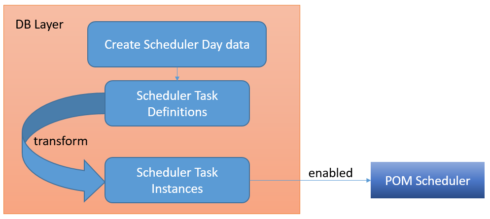

The scheduling of tasks takes place in two stages.
Stage 1 : Transform Task Definitions Into Task Instances
Each Scheduler Task definition has a status and a configuration associated with it. These task definitions are converted into task instances based on the following rules.
If the task is
DISABLED, mark the task instanceDISABLED. -
If task frequency is
ONCE, then enable the task instance only if the scheduled date matches the business date. -
WEEKLY, then enable the task instance only if the business date matches one of the week days selected. -
MONTHLY, then enable the task instance only if the business date matches the day of the month selected. -
MONTHLY_START, then enable the task instance only if the business date is at the start of a month. -
MONTHLY_END, then enable the task instance only if the business date is at the end of a month. -
DAILY, then enable the task instance.
