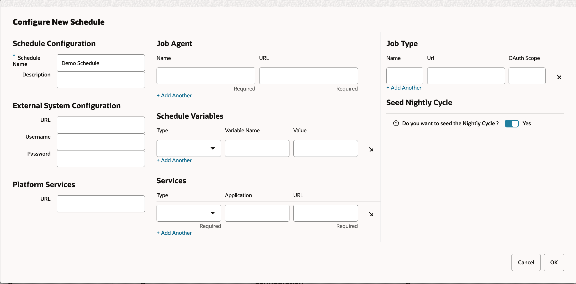

An administrator can create the configuration for the new schedule using the System Configuration screen as follows:
Navigate to Tasks > System Configuration.
Open the Schedules tab.
Click the Configure New Schedule button at the top right of the Schedules tab to open the “Configure New Schedule” window.
Refer the “Configure New Schedule” section in the POM User Guide for instructions on filling out the window above.
A Batch Schedule, at a minimum, must define the start and end jobs of the Nightly Cycle. An option is provided in the Configure New Schedule section to seed the Nightly cycle with some default Jobs, thereby making the Batch Schedule immediately ready to be used.

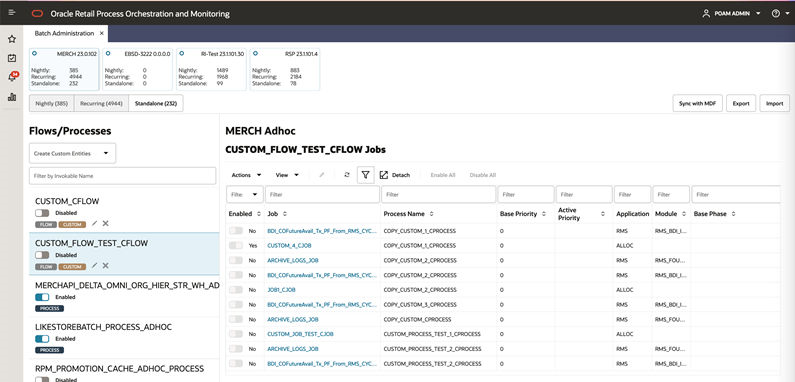

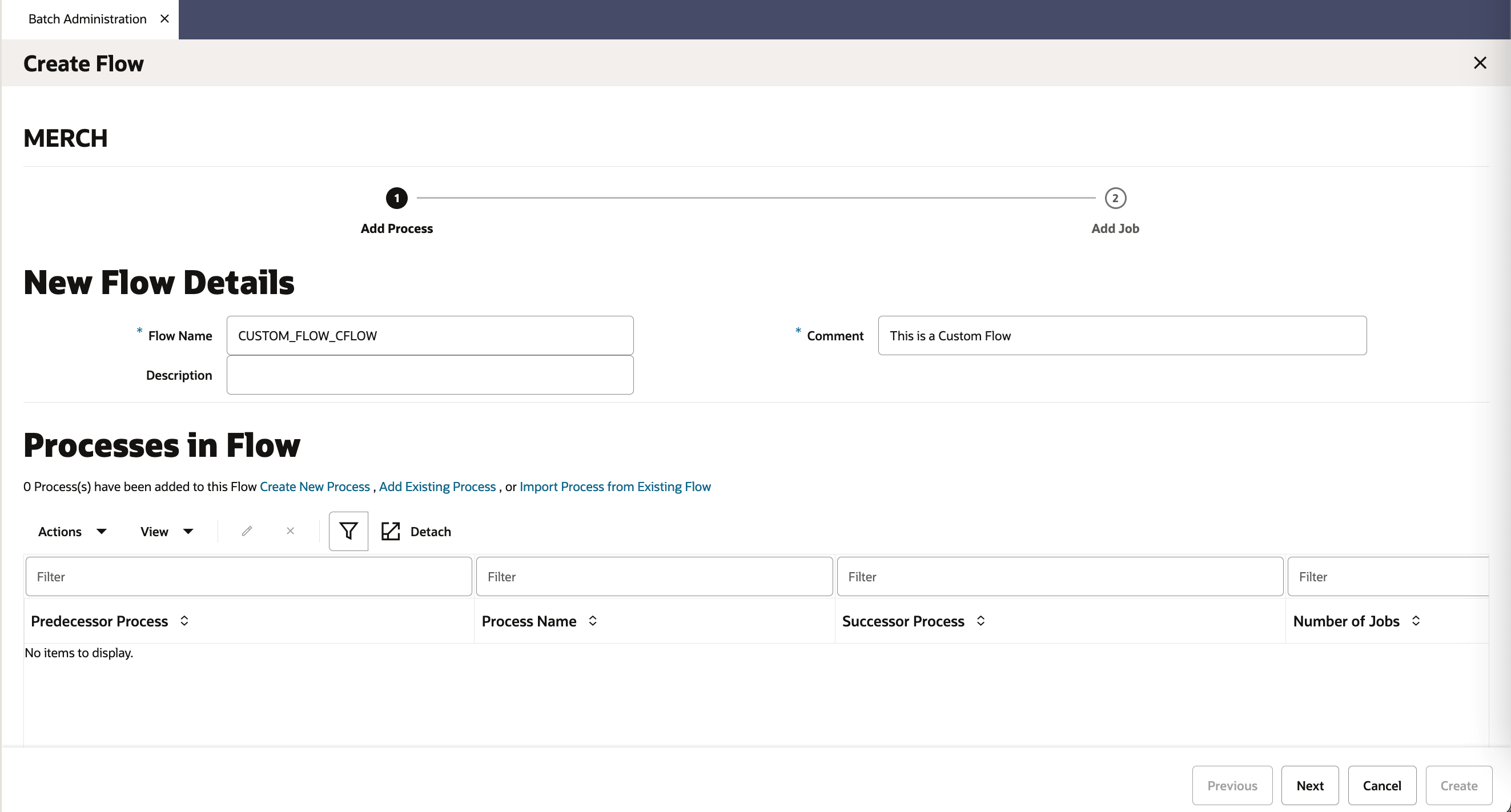

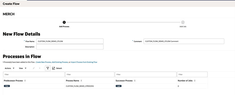

Create Custom Flow
Navigate to the Tasks -> Batch Administration screen.
Open the Standalone tab.
In the left panel, click Create Custom Entities -> Create Flow.

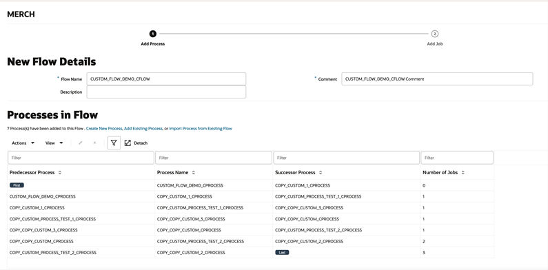

Enter the following information to create a flow:
Flow Name – Name of the flow ending with _CFLOW
Comment
Description (optional)
Processes in Flow

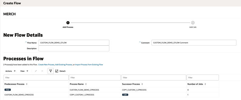

Processes can be added to the flow by either
Creating a new process or
Adding an existing process or
Importing processes from an existing flow.
After adding the desired processes, click the Next button to add job(s) to the processes. Every process in the custom flow should have at least one job.

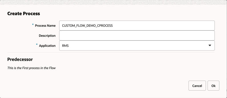

Create New Process
The Process Name needs to end with _CPROCESS.
Because this is the first process in the flow, the Processes in Flow section is populated with this process as shown below, marking it as the First and Last process.

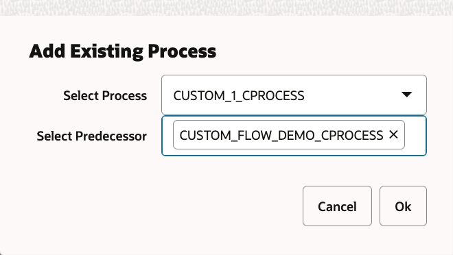

Add Existing Process
An existing process can be added to the flow using this option. Because we have already created the first process for the custom flow, the first process is the Predecessor for the next created process.

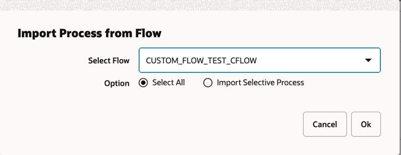

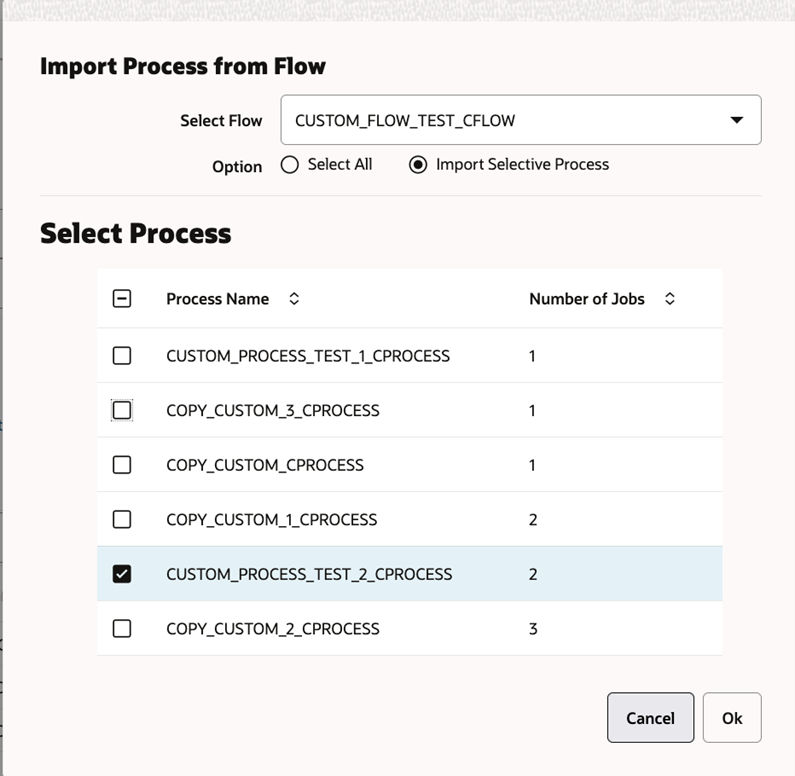

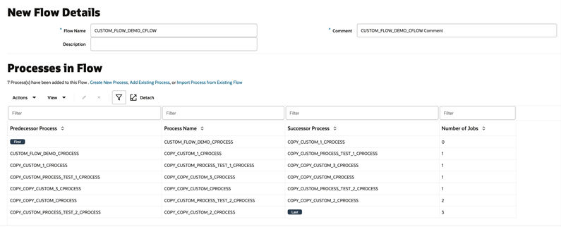

Import Process from Existing Flow
All processes from an existing flow can be imported using this option.
Import Process from Existing Flow – Select All
All processes from the selected flow are added.
Import Process from Existing Flow – Import Selective Process
Only the selected processes from the selected flow are added.

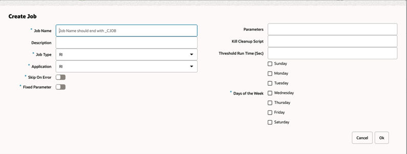

Create New Job
Job Name
Uniquely identifies a job and should end with _CJOB.
Description
Short description of the batch job. There should be no special characters.
Job Type
Can be one of the following values:
EXEC,RI,RASE,BDI,RPAS,OMS,OB, orRDSor a custom job type. -
Application
This holds the application that the batch job belongs to.
Skip On Error
If the switch is on, it indicates that the job should be skipped if it fails, and the batch schedule should continue to run. Otherwise, the batch schedule is stopped.
Fixed Parameter
If the switch is on, it indicates that the parameter value can be changed on the Batch Administration screen. The switch should be on if the parameter cannot have a default value, or if the parameter can have different values.
Parameters
This holds the entire parameter value to be passed into a shell-script type job. This field is case sensitive.
Kill Cleanup Script
Absolute path of the cleanup script to be run after killing a shell script (EXEC) type job from the POM UI. It can include arguments as well along with the script.
For example:
/u01/retail/app/batch/app_cleanup_script.sh -
Threshold Run Time (Sec)
Amount of time greater than which the job is deemed long running. For a complete explanation of how a job is deemed long-running, see the Long Running Jobs subsection of the Batch Job subsection of the Batch Schedule section of the Batch Concepts chapter of this document.
Days of the Week
Days of the week for which the job is to be run if scheduled.

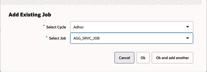

Add Existing Job
An existing job can be added to the process using this option.

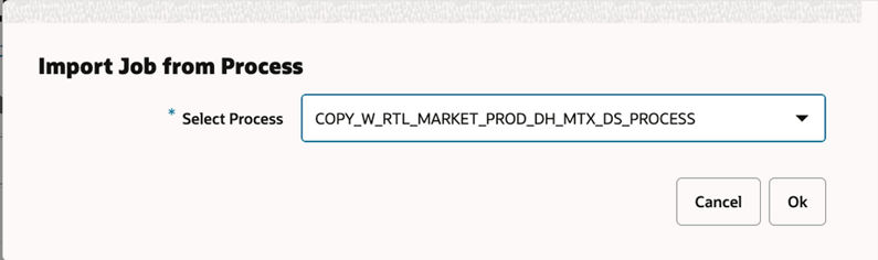

Import Job from Existing Process
All jobs from an existing process can be imported using this option.

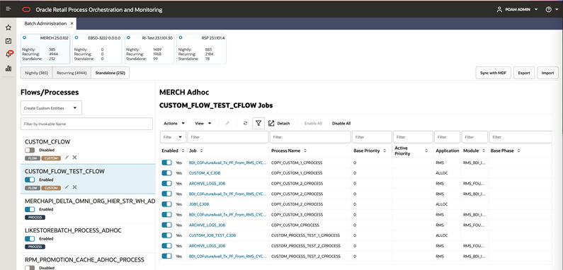

After adding the desired job(s), click the Create button in the footer to create the custom flow with its associated process and jobs.

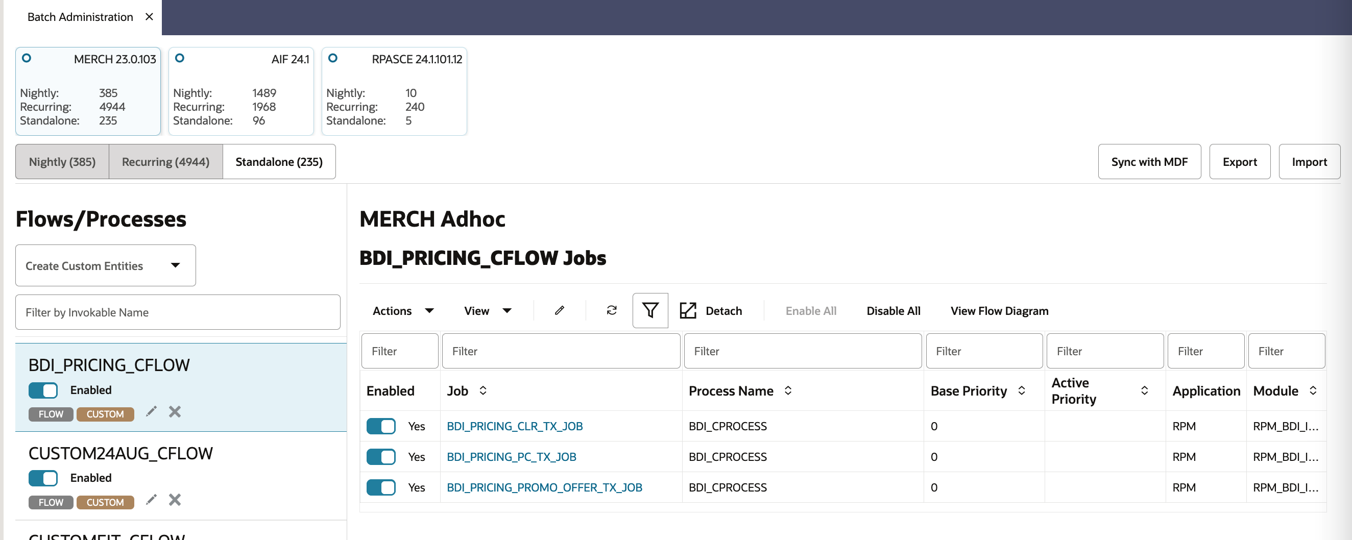

The custom flow and its jobs are created and displayed in the Standalone tab. A Custom tag is also seen along with the flow name in the left pane to indicate that it was a custom, user-created flow, as opposed to being seeded from the batch schedule spreadsheet.
Enable Custom Flow
The custom flow is disabled by default and can be enabled by clicking the enable/disable switch. Enabling the Custom Flow also enables its batch jobs.

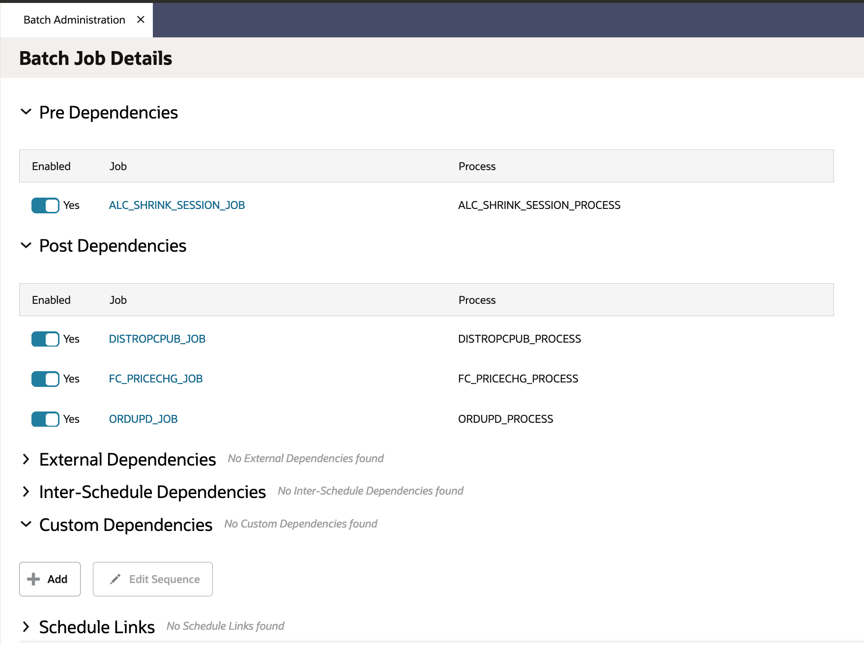

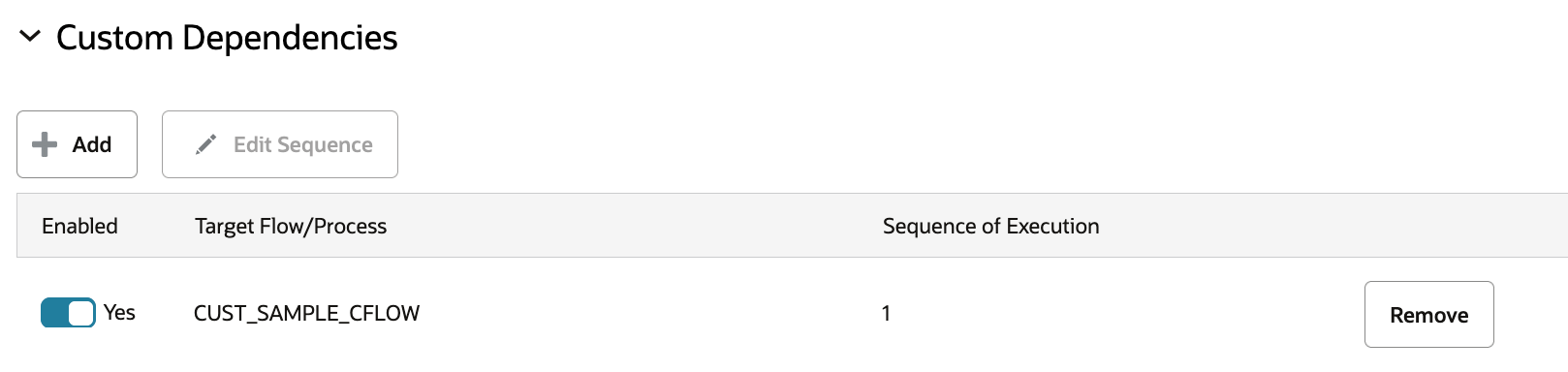

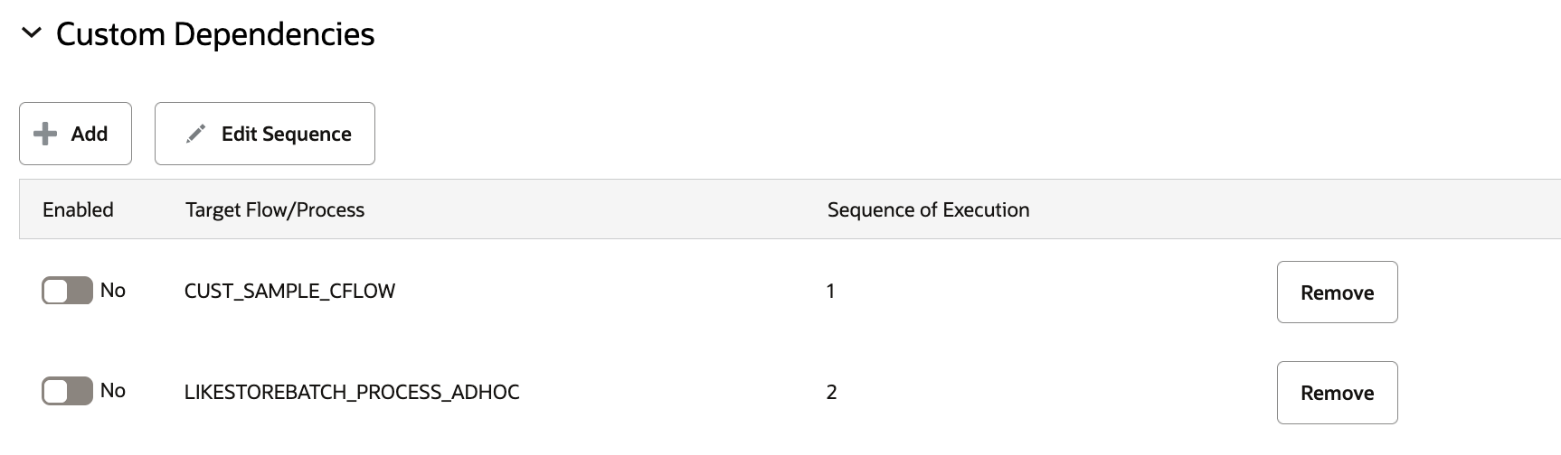

Custom Dependencies – Nightly Cycle
A Custom Dependency is a dependency between an Adhoc Process or Flow and a Nightly Job. This dependency ensures that the Adhoc Process or Flow executes prior to the nightly job on which it is defined. Only when the Adhoc Process or Flow completes successfully will the nightly job on which the Custom Dependency is defined be started.
Create Custom Dependencies
Open the Nightly tab and click on a Job Name link in the jobs table. This will open the Batch Job Details screen.

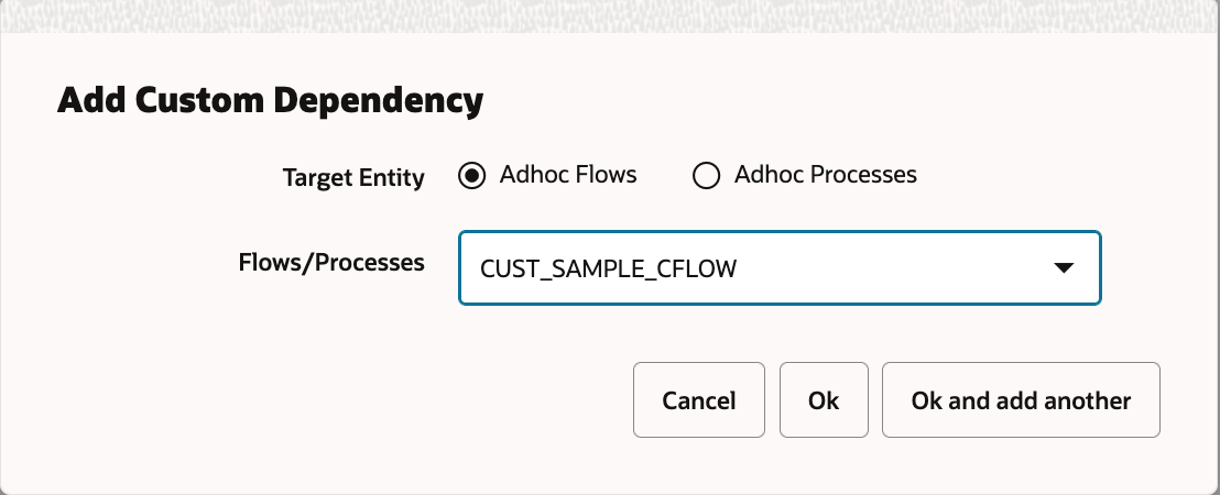

Click the Add button under the Custom Dependencies section and add an Adhoc Flow or Process as a Custom Dependency for the selected job.
Click Add button again to add more dependencies.

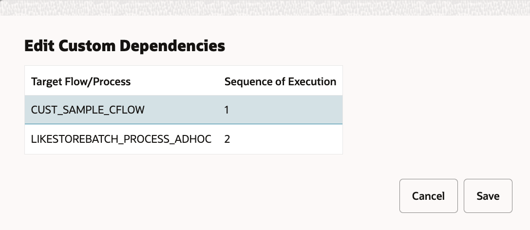

The sequence of the dependency can be set using the Edit Sequence button.
