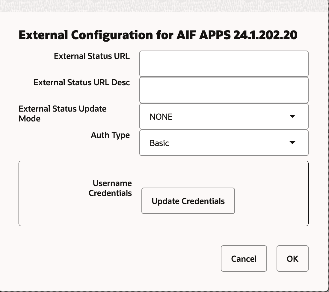

  1. Navigate to the System Configuration screen.
  2. Click the Edit icon on the External Configuration Panel to open the External Configuration window.
    Figure 3-2 External Configuration Window (OAuth)
    OAuth External Configuration Window
    Figure 3-3 External Configuration Window (Basic)
    Basic External Configuration Window
  3. Enter the configuration values:
    •  External Status URL - External system's URL that needs to be called for status updates and also for health-check.
      In addition to this configuration, you must work with Oracle support to get the External Status URL added to the allowlist.
      The POM health check validates the external systems that must have the OPTIONS request method implemented. If the OPTIONS method is not implemented, POM will validate the external systems using the HEAD request method.
    •  External Status URL Description - An optional description of the external system’s URL.
    • External Status Update Mode - Choose one of the options below:
      • ALL - POM will send a status update to the external system for each job's execution in the schedule regardless of success or failure. This option may be an overuse of this feature and may impact performance.
      • FAILED - POM will send a status update only for failed jobs.
      • NONE - No status updates will be sent by POM.
        The External Status Update Mode defined on this screen applies to all the jobs in a schedule. If status update is desired only for specific jobs then set the mode on the above screen to NONE and follow the steps defined in the Job Configuration section below.
    • Auth Type - The authentication type to use for the external callback URL. The value can be OAuth or Basic.
    • OAuth URL - The URL to obtain the token from the authentication provider. This is only required for Auth Type of OAuth.
    • OAuth URL Description - The description for the authentication provider. This is an optional field and only available for Auth Type of OAuth.
    • OAuth Scope - The scope to request for the token from the authentication provider. This is only required for Auth Type of OAuth.
    • Click Update Credentials and provide the credentials for the external system.

Retail Data Store Integration
For every environment such as Stage or Prod, there is a single instance of RDS that can be configured to work with an instance of POM. This information is configured in the System Settings panel of the System Configuration screen.
System Settings Window
The integration between POM and RDS can be done using either of the following two approaches.
