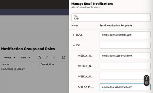

Emails
By default, all notifications are shown within the POM application. It is an option to configure notifications to also send e-mails.
Configuring Email Address
Email addresses are configured against Notification Types. In POM, email addresses can be configured at different levels
  1. System Level – Email addresses specified at this level, will apply equally to all Batch Schedules.
  2. Schedule Level – Email addresses specified here, will only apply to Notifications for a particular Batch Schedule.
  3. Job Level – These emails apply only to the Jobs against which they are specified.
Email addresses are configured through the Notifications Administration function of Retail Home. Refer to the Notifications Administration chapter in the Retail Home Administration Guide for more information.
Manage Email Notifications
