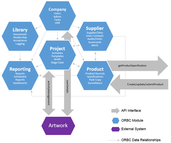

Project Activities: Project Activities
Figure 5-1 Overview of SOAP APIs

This section describes the API for Artwork integration. The following function is available:
Activity Management: updates existing Artwork activities
Activity Management
Description
Updates the sub status of existing Artwork Project Activities. This function is used for the integration of Supplier Evaluation with an external Artwork Management system, to update the status of an artwork activity from the external system.
This service has been superseded by the Artwork Restful Service.
Endpoint address: /services/activityManagement HTTP method: updateActivityStatus
