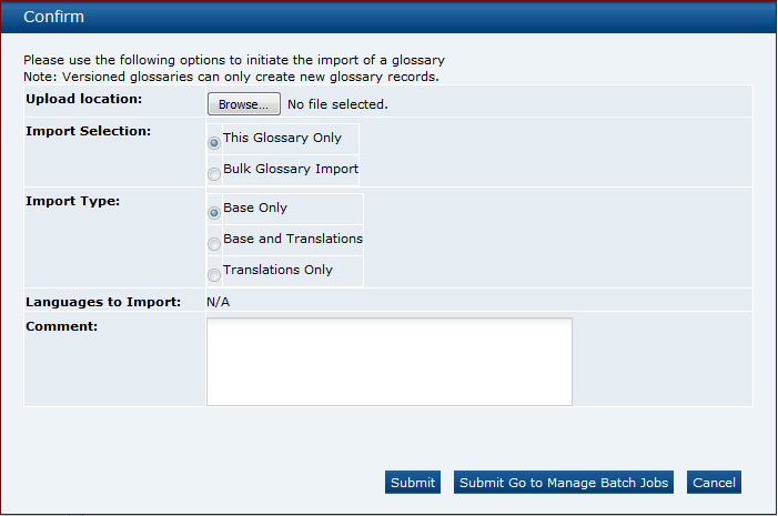

Bulk Glossary Import
Retailer users with the Glossary Administrator authority profile have access to the Import/Export option within the Admin menu.
To import glossaries:
  1. Select any glossary and then select the Import action from the actions menu. The Glossary Import dialog box opens.
    Figure 10-3 Glossary Import Dialog Box
    This figure shows the Glossary Import dialog box.
    As the upload of files is limited to 10 MB, this may not be sufficient if you are attempting to upload all the glossaries for the system. An Administrator may therefore need to temporarily increase the File attachment size limit parameter.
  2. Click Browse to locate and attached the file containing the glossary files.
    The file being imported may be a single base file or a ZIP file containing one or more base and translation files. The system accepts CSV, XLS, or XLXS file formats.
  3. Set the Import Selection option to Bulk Glossary Import.
  4. Set the following filters as required:
    • Using the Import Type filter:
      This defaults to Base Only which means that all base files will be imported, and the following filter will be set and locked to N/A:
      • Limit Languages to Import
      If set to Base and Translations, this will import all base and translation files for any of the selected languages.
      If set to Translations Only, this will import all translations files for any of the selected languages.
    • Using the Languages to Import filter:
      This always begins with no languages shown as it is assumed the import will be for all languages.
      Selecting one or more languages will limit the import to only those languages.
  5. Enter a suitable comment into the comment field.
  6. Click Submit or Submit Go to Manage Batch Jobs. A batch job is submitted to import glossaries using the filters set. All the relevant glossaries will be imported which will be stored within a ZIP file and as an attachment on the job.
Single Glossary Import
Retailer users with the Glossary Administrator authority profile have access to the Import option within the actions menu of any glossary list view.
To import a single glossary:
  1. Select the glossary in the Admin area and then select the Import action from the actions menu. The Glossary Import dialog box opens.
    Figure 10-4 Glossary Import Dialog Box
  3. Set the Import Selection option to This Glossary Only.
      This defaults to Base Only which means that only the base file will be imported, and the following filter will be set and locked to N/A:
      If set to Base and Translations, this will import a base file and translation files for any of the selected languages.
  6. Click Submit or Submit Go to Manage Batch Jobs. A batch job is submitted to import a glossary using the filters set. All the relevant files will be imported which will be stored within a ZIP file and as an attachment on the job.
