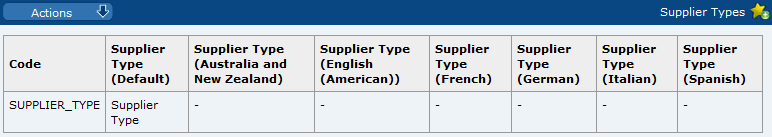

Supplier Types
This option is used to define the types of suppliers that can be created.
Figure 7-7 Supplier Types Page
To edit the list of supplier types, select the Edit action. The table opens in edit mode. For existing supplier types, only the translated descriptions that do not already exist can be edited. To add a supplier type, click Add. A new row is added to the table. Enter the new supplier type and description in the default language. Enter any translations. Select the Save action.

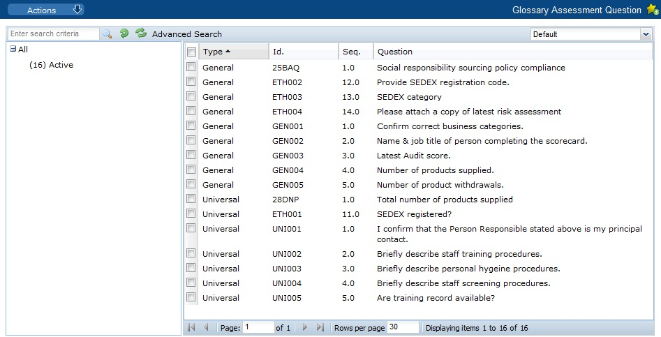

Assessment Questions
Each assessment template is comprised of a series of questions which may be selected from this glossary.
Figure 7-17 Glossary Assessment Question Page
To edit a question, select the question and then select the Edit action. A tab opens with the record in edit mode.

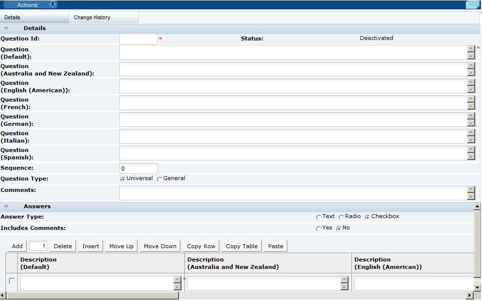

To create a new assessment question:
Select the New Question action. The Assessment Question tab opens.
Figure 7-18 New Assessment Question Page
In the Details section:
Question Id: Enter the ID for this question. The ID must be between 3 and 10 characters and unique. The value cannot be changed once the question has been created. This field is mandatory.
Status: The status is set to Deactivated.
Question: Enter the question in the default language. This field is mandatory.
Sequence: Enter the sequence number for this question. The sequence number is used to set the default order of questions within the assessment template.
Question Type: Select the type of question:
Universal questions are automatically added to a assessment template. These questions may be removed and individually re-added as required (if configured in System Parameters to allow removal).
General questions are manually added to a assessment template from the questions glossary.
Comments: Enter any comments. This field is not mandatory.
In the Answers section:
Answer Type: Select the type of answers allowed for this question.

Assessment Templates
Assessments provide a means for the retailer to assess their suppliers on an on-going (or ad hoc) basis against a set of predefined criteria. Assessments are made up of a series of questions which may be answered by the suppler as a self-assessment or completed by the retailer.
Any number of types of assessment can be configured, with the option to use weighted scoring for the overall grading of suppliers' responses. On completion of a assessment, the next one can be automatically scheduled based on a predefined periodic or quarterly frequency.
Assessment templates define the rules that control the behavior of the different types of assessments. Every assessment is created from a template which defines the rules for how it behaves within the system, that is, the set of questions and permitted answers, the setting of basic default values, and whether certain fields are used or hidden.
Figure 7-19 Glossary Assessment Templates Page
To edit a template, select the entry and then select the Edit action. A tab opens in edit mode to enable you to edit the template. For an example of the content, see Figure 7-20.

Set the questions for this type of assessment in the Questions tab using the tables of questions for Universal, General, and Ad Hoc Questions:
Universal questions are automatically added.
General Questions are selected from the glossary of Assessment Questions.
Ad Hoc questions can be entered specifically for this type of assessment.
Once the questions have been added, the Refresh Preview action can be used to show the assessment as it will be presented to the supplier.
Select any scoring rules for this type of assessment in the Scoring subtab.

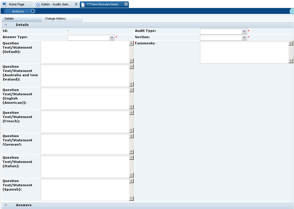

To add a checklist question:
Select the New Checklist Question action. The New Glossary/Question tab opens.
Figure 7-33 New Checklist Question Page
Id: This is a unique identifier of each question. It is automatically assigned as an incrementing sequence number.
Audit Type: Select the type of audit associated with this question from the drop-down list. This field is mandatory.
Answer Type: Select the type of answer associated with this question from the drop-down list. This field is mandatory.
Section: Select the section of the questionnaire from the drop-down list. This field is mandatory.
Question/Text Statement: Enter the question in the default language. This field is mandatory. Enter any translations.
Comments: Use this field to enter a comment regarding this checklist question glossary entry.
In the Answers section: The table of Answers is automatically built based on the selected answer type. The table is only applicable for Single Choice and Multi Choice answer types. For more information, see Checklist Answers

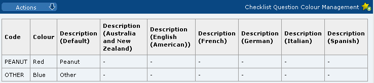

Checklist Question Colour Management
This option is used to define the rules for color-coding within checklists. The system uses this table to apply to present the text in the specific color if it encountered as part of a checklist question.
To edit the list of colors, select the Edit action. The table opens in edit mode. The color and descriptions can be edited.
To add a new color, click Add. A row is added to the table. Enter the code, color, and description in the default language. Enter any translations.
Figure 7-34 Checklist Question Colour Management
