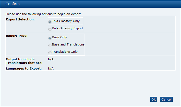

Single Glossary Export
To export a single glossary:
Select the required glossary and then select the Export action from the actions menu. The Glossary Export dialog box opens.
Figure 10-2 Glossary Export Dialog Box
Set the following filters as required:
Using the Export Type filter:
This defaults to Base Only which means that all base files will be exported, and the following filters are set and locked to N/A:
Output to include Translations that are
Limit Languages to Export
If set to Base and Translations, this will export all base and translations files for any of the selected languages.
If set to Translations Only, this will export all translations files for any of the selected languages.
Using the Output to include Translations that are filter:
This defaults to Populated and Blank, which exports all glossaries that have a value for any of the selected languages.
If set to Populated, the system will export all glossaries that have a value for any of the selected languages.
If set to Blank, the system will export all glossaries that have no value for any of the selected languages.
Using the Languages to Export filter:
This always begins with no languages shown as it is assumed the export will be for all languages.
Selecting one or more languages will limit the export to only those languages.
Selecting more than five languages will result in an error.
Click Ok. This will initiate the download of a ZIP file containing files according to the filters set.
