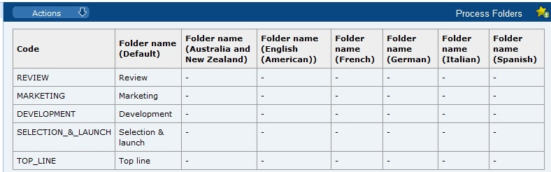

Process Folders
This list of folders is used in the Process and Activity templates to allow lists to be filtered when selecting templates to be used in Processes or templates. To edit the list of folders, select the Edit action. The page opens in edit mode. From this page, you can update the translations, add a folder, or delete an existing folder.
Figure 9-1 Process Folders Page
This figure shows the Process Folders page.

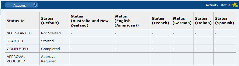

Activity Status
The list of activity statuses is defined by the system. The Status ID and default status description cannot be changed. To edit any of the translated descriptions, select the Edit action. The page opens in edit mode.
Figure 9-2 Activity Status Page
This figure shows the Activity Status page.

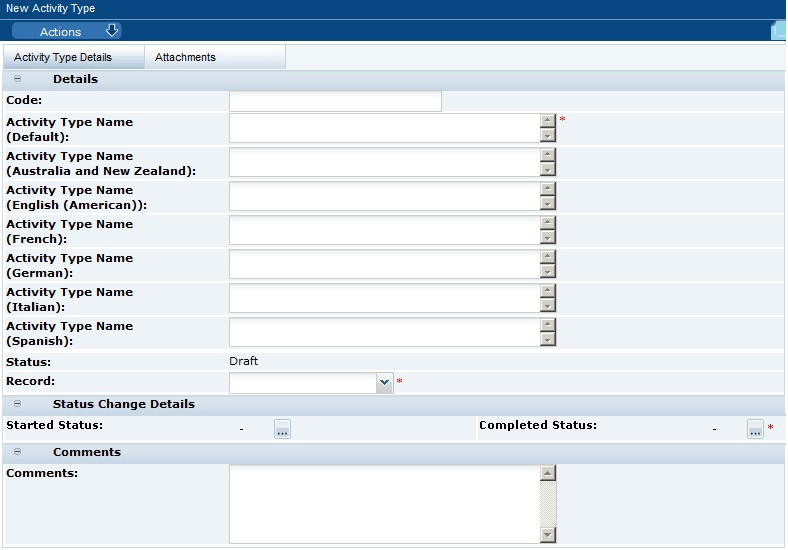

To create a new activity type:
  1. Select the New action. The New Activity Type tab opens.
    Figure 9-3 New Activity Type Page
    This figure shows the New Activity Type page.
  2. Enter the Activity Type name in the default language. This field is mandatory. Enter any translations.
  3. In the Status Change Details section, select the record type from the drop-down list.
  4. In the Status Change Details section, select the states that trigger the activity to be set to Started or Completed. Whenever the status of a record that has been linked to the activity changes, the system checks for the selected states. If there is a match, it changes the activity's status. Where the status selected in both fields matches the record's state, the system changes the Activities status to Completed. These fields are mandatory:
    • To select the triggers for Started status, click the icon. The Select Started Statuses dialog box appears. Select the statuses and then click Ok.
    • To select the triggers for Completed status, click the icon. The Select Completed Statuses dialog box appears. Select the statuses and then click Ok.
  5. Enter a code and comments. These fields are not mandatory.
  6. In the Attachments tab, add attachments to the activity type.
  7. Select the Save action.

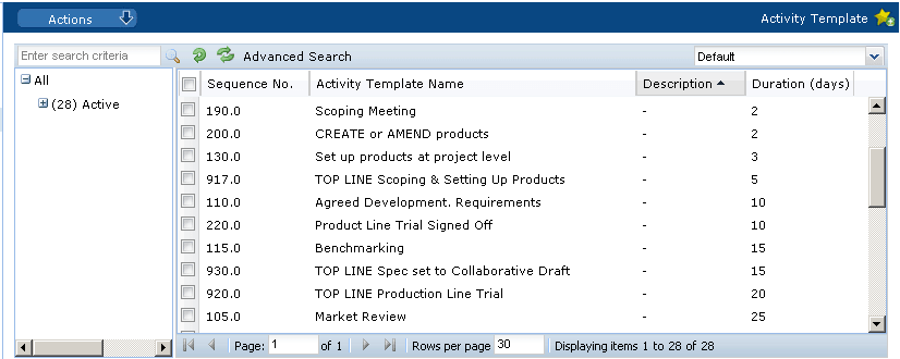

Activity Template
Templates for activities can be created and then assigned to Process Templates. These are single elements which can form part of the critical path or run in parallel to the main time-line. The Activity Template page shows the list of defined activity templates. For each activity, the sequence number, name, description, and duration in days are shown.
Figure 9-4 Activity Template Page
This figure shows the Activity Template page.
To edit an existing template, select the template and then select the Edit action. A tab opens in edit mode.

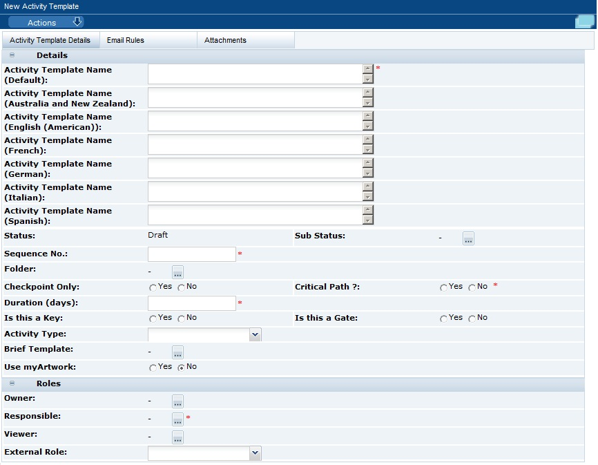

To create a new Activity Template:
  1. Select the New action. The New Activity Template page opens.
    Figure 9-5 New Activity Template Page
    This figure shows the New Activity Template page.
  2. In the Details section:
    • Activity Template Name: Enter the template name for the default language. This is a mandatory field. Enter any translations.
    • Status: The status is set to Draft.
    • Sub Status: Select the icon. Select the allowed sub-status in the Select Allowable Sub-Statuses dialog box and click Ok.
    • Sequence No: Enter a sequence number. This field is mandatory.
    • Folder: Select the icon. Select the folder in the Select Folder dialog box and click Ok. This field is mandatory.
    • Checkpoint Only: Check whether this template is only for checkpoint activities.
    • Critical Path: Check whether this template is for critical path activities. This field is mandatory.
    • Duration (days): Enter the duration in number of days. This field is mandatory.
    • Is this a Key: Check if this is a key activity.
    • Is this a Gate: Check if this is a gate activity. If Yes is selected, the Gate Type field appears. Select whether the gate type is Auto Complete or Approval Required.
    • Activity Type: Select the activity type associated with this template from the drop-down list.
    • Brief Template: Select the icon. Select the Brief Template that provides the questions for this activity in the Select Brief Template dialog box and click Ok.
    • Use Artwork: Select whether the Artwork module is used.
  3. In the Roles section, select the Owner, Responsible, and Viewer roles from the list of portal owner roles. Responsible is a mandatory field. The options for External Role are Supplier Responsible and Supplier Viewer.
  4. In the Email Rules subtab, the rules used to trigger email are listed.
  5. In the Attachments tab, add attachments to the template.
  6. Select the Save action.

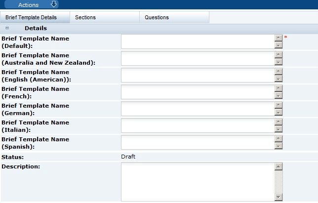

Brief Templates
A Brief is a questionnaire which is completed as part of an activity by either the portal owner or the supplier. A Brief Template pulls together the sections, questions, and answers and defines the order in which these appear on the screen. To edit an existing template, select the template and then select the Edit action. A tab opens in edit mode.
To create a new template:
  1. Select the New action. The New Brief Template tab opens.
    Figure 9-6 New Brief Template Page
    This figure shows the New Brief Template page.
  2. In the Brief Template Details subtab:
    • Enter the template name for the default language. This is a mandatory field. Enter any translations.
    • The status of the template is set to Draft.
    • Enter a description. This is not a mandatory field.

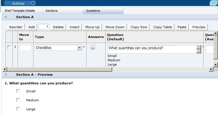

  3. In the Sections subtab, to add a section to the Brief, select Add and enter the description and any translations. You can define multiple sections.
  4. In the Questions subtab, you can define questions for each section:
    1. Select the type of answer from the drop-down list.
    2. To select the possible answers, click the icon in the Answers column. The Select Allowable Answers dialog box opens. Enter the answers and click Ok.
    3. Enter the question in the default language. This is a mandatory field. Enter any translations.
    4. To see what the questions will look like on a screen, select Preview. This displays a preview of the questions for that section.
    Figure 9-7 New Brief Template Questions Page
    This figure shows the New Brief Template Questions page.
  5. Select the Save action.

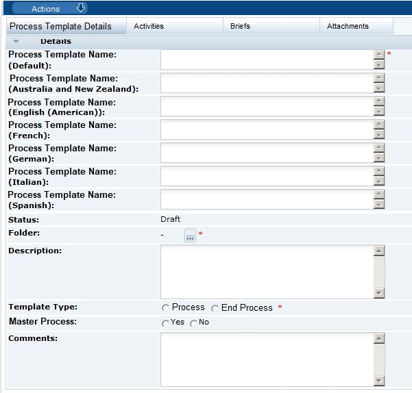

Process Template
A Process Template is used to define a set of activities and associated roles so that different processes and process schedules can be configured. It contains general process information, process details, key personnel involved, and activities. The Process Template page lists the available templates and the folder for each. To edit an existing template, select the template and then select the Edit action. A tab opens in edit mode.
To create a new process template:
  1. Select the New action. The New Process Template opens.
    Figure 9-8 New Process Template Page
    This figure shows the New Process Template page.
  2. In the Process Template Details subtab:
    • Process Template Name: Enter the name of the process template in the default language. This field is mandatory. Enter the translations for any supported languages.
    • Status: The status of the template is set to Draft.
    • Description: Enter a description. This field is not mandatory.
    • Template Type: Select the template type. This field is mandatory.
    • Master Process: Select whether this template is for a master process. If set to Yes, these template can be used to identify processes in the following records of the system:
      • The initial or the start process in a hierarchy.
      • As an indicator to export to third-party systems, for example, Artwork.
      • The initial process which can be the top level process for reports.
    • Comments: Enter any comments. This fields is not mandatory.
  3. In the Activities subtab, add the activities to the template. Select the Add action. The Select Activity dialog box opens. Choose the activities and click Ok.
  4. In the Briefs subtab, select the Brief templates to be added to this Process Template.

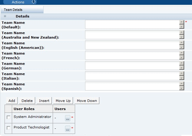

Team
Team administration can help a Process Manager by populating and adding users to roles which then populate the roles listed in an activity. On the Team page, the list of teams and roles associated with each team are shown. To edit an existing team, select the team and then select the Edit action. To create a new team:
  1. Select the New action. The New Team tab opens.
    Figure 9-9 New Team Page
    This figure shows the New Team page.
  2. Team Name: Enter the team name for the default language. This is a mandatory field. You can also define the translated team names.
  3. User Roles: This field is mandatory. To add a role to the team:
    1. Select Add. The Select User Role dialog box appears.
    2. Select the roles and click Ok.
    3. To add users for a role, select the icon. The Select Users dialog box. Select the specific users for the team and click Ok.
  4. Select the Save action.
