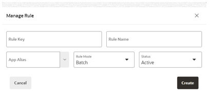

  2. Click the + icon. The Manage Rule dialog box is displayed. This image shows the Manage Rule dialog box.
  3. Add the following details:
    1. Rule Key (Mandatory) - Unique
    2. Rule Name (Mandatory)
    3. App Alias (Mandatory)
      • Select Quality Control
    4. Rule Mode (Mandatory)
      • Batch (only Batch is available at the moment)
    5. Status (Mandatory)
      • Active
      • Inactive
  4. To create the rule, click Create.
    To cancel creating the rule, click Cancel. The dialog box is closed and the new rule is not created.

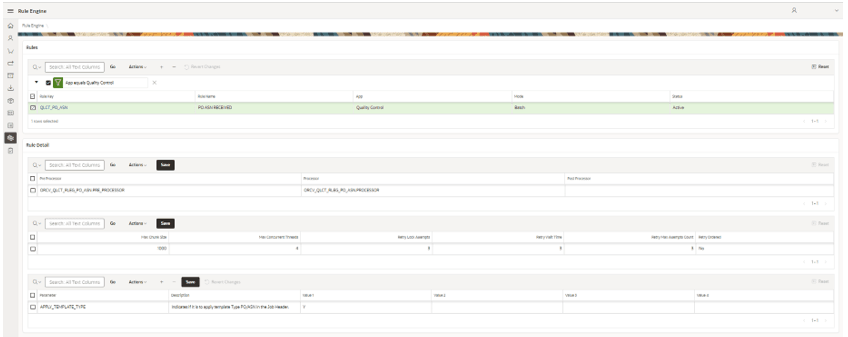

  5. Select the rule. This image shows the Rule Engine screen.
  6. Add the necessary details under Rule Detail:
    • Batch Database Functions
    • Threading Information
    • Rule Parameters
To save the data in the detail tables, Save needs to be selected in each table.
