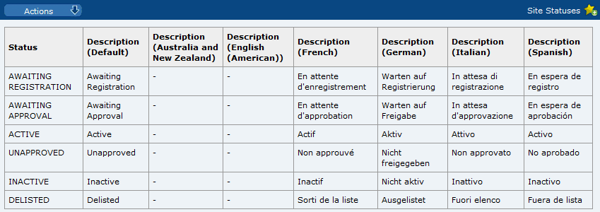

Site Statuses
This option is used to define the statuses that can be associated with a site. The statuses are defined by the system; new statuses cannot be added. To edit the existing statuses, select the Edit action. The table opens in edit mode. Any translations that do not already exist can be added. No other changes can be made.
Figure 7-4 Site Statuses Page
This figure shows the Site Statuses page.

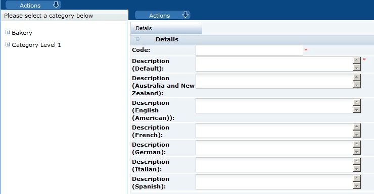

To create a new top-level category:
  1. Click Create new top-level category. The Business Category Details page opens.
    Figure 7-6 Add Business Category Details Page
    This figure shows the Add Business Category Details page.
  2. Enter the details for the new category:
    • Enter the code. This is a mandatory field.
    • Enter the description for the default language. This is a mandatory field. Enter any translations.
  3. Select the Save action. The business category is added to the list of categories.
  4. To add child categories, select the top-level category and then select the Add Child Category action.
  5. Enter the details for the child level and select the Save action.

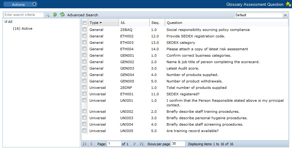

Assessment Questions
Each assessment template is comprised of a series of questions which may be selected from this glossary.
Figure 7-17 Glossary Assessment Question Page
This figure shows the Glossary Assessment Question page.
To edit a question, select the question and then select the Edit action. A tab opens with the record in edit mode.

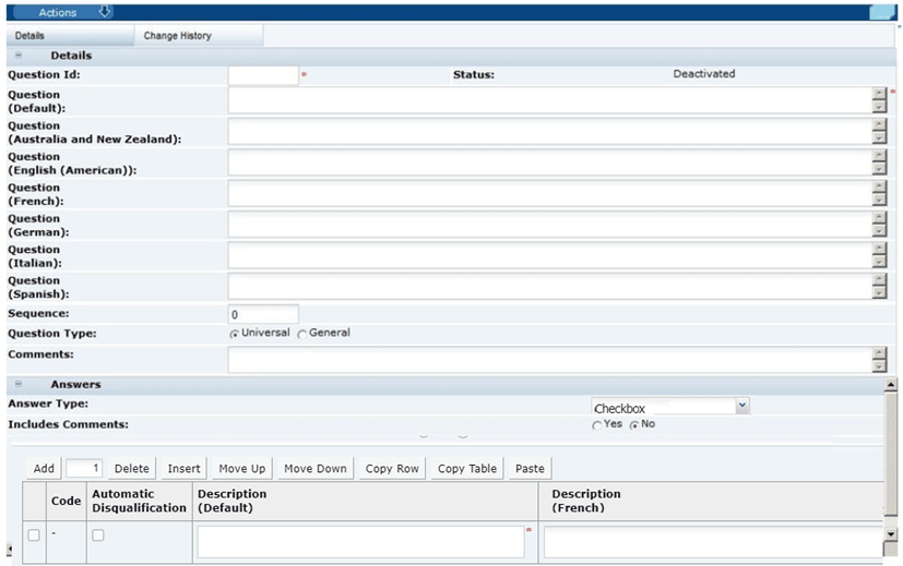

    Figure 7-18 New Assessment Question Page
    This figure shows the New Assessment Question page.
  2. In the Details section:
    • Question Id: Enter the ID for this question. The ID must be between 3 and 10 characters and unique. The value cannot be changed once the question has been created. This field is mandatory.
    • Status: The status is set to Deactivated.
    • Question: Enter the question in the default language. This field is mandatory.
    • Sequence: Enter the sequence number for this question. The sequence number is used to set the default order of questions within the assessment template.
    • Question Type: Select the type of question:
      • Universal questions are automatically added to a assessment template. These questions may be removed and individually re-added as required (if configured in System Parameters to allow removal).
      • General questions are manually added to a assessment template from the questions glossary. This is the default.
    • Comments: Enter any comments. This field is not mandatory.
  3. In the Answers section:
    • Answer Type: Select the type of answers allowed for this question.
      The available options are:
      • Text - for descriptive responses.
      • Radio - for a single response from multiple options.
      • Checkbox - for one or more responses from multiple options.
      • Single-select Picker - where the response is a single selection from a predefined list of options – see Assessment Picklists below.
      • Multi-select Picker - as Single-select Picker but multiple response options can be selected.
      • Tabular - for responses in the form of a table, where rows can be added to a table of predefined columns.
      • Date - the response is a selected from a date picker.
      • Numeric - requires the response to be a number.
      • URL - when the answer is viewed it is shown as a link to the location given as the response.
    • Includes Comments: If set to Yes, a text field is included in the questionnaire to enable the user to enter any comments.
    • For Radio and Checkbox answer types, to add an answer choice, click Add. Enter the answer in the default language. This is a mandatory field. Enter any translations.
      For Picklist answer types, select an option from the list of Assessment Picklists, click Ok. This is a mandatory field.
      For Tabular answer types, configure the table columns by populating the table (each row represents a table column):
      • Type is the type of data the column will accept – the options are Text, Numeric, URL or Single-select Picker.
      • Assessment Picker is used when Type is Single-select Picker, to set the picklist to be presented, in which case this is a mandatory field.
      • Description is the column heading. Enter the answer in the default language. This is a mandatory field. Enter any translations.
    • The answer types that offer a choice have a Code automatically assigned to give each answer a unique reference.
    • The answer types that offer a choice can have answers set to Automatic Disqualification; when completing the Assessment, if the user chooses the option as their response, the Assessment it is flagged as being disqualified.
      The disqualifications and a count of them are shown in the Assessment, to retailer users only.
  4. Select the Save action.

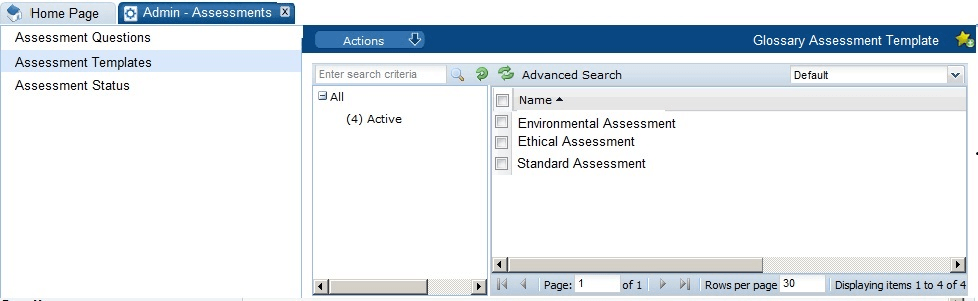

Figure 7-19 Glossary Assessment Templates Page
This figure shows the Glossary Assessment Templates page.
To edit a template, select the entry and then select the Edit action. A tab opens in edit mode to enable you to edit the template. For an example of the content, see Figure 7-20.

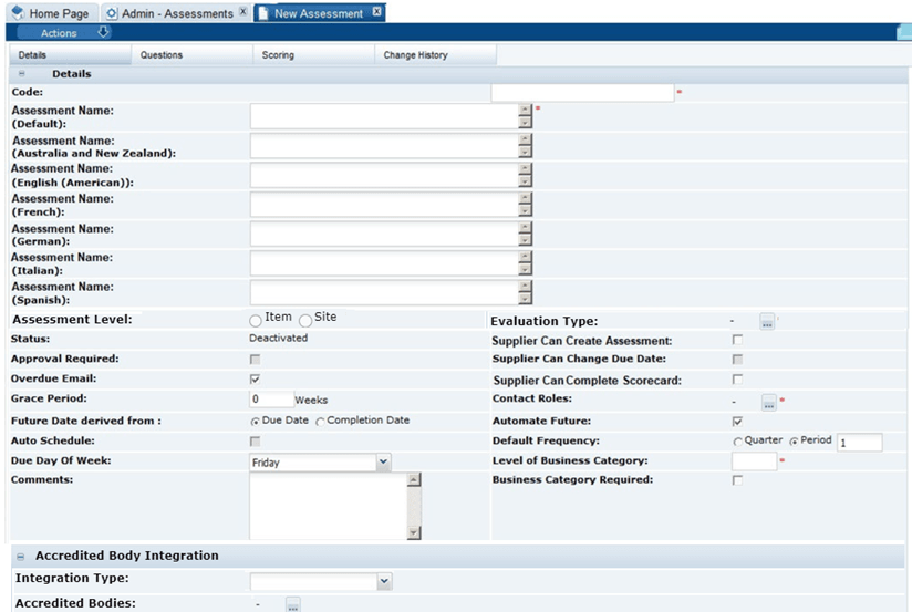

    Figure 7-20 New Assessment Template Page
    This figure shows the New Assessment Template page.
    Table 7-1 describes the fields in the Details section.
    Table 7-1 New Assessment Template Fields
    Field Description
    Code
    Enter a unique code for this template. This field is mandatory.
    Assessment Name
    Enter the name for the template in the default language. This field is mandatory. Enter the translations.
    Status
    Supplier Can Create Assessment
    If checked, the supplier user can choose to create this type of assessment. The default is unchecked.
    Supplier Can Change Due Date
    If the supplier can create this type of assessment and this field is checked, the supplier user may also change the due date of this type of assessment. The default is unchecked.
    Supplier Can Complete Assessment
    If checked, the supplier user may choose to complete this type of assessment. The default is unchecked.
    Approval Required
    If the supplier can complete this type of assessment and if this field is checked, the retailer user is required to approve this assessment before the supplier can complete it. The default is unchecked.
    Grace Period
    Enter the number of days or weeks after the assessment's due date when it becomes overdue.
    Overdue Email
    If checked, an email is automatically generated to the supplier if the supplier has not completed the assessment by the time it becomes overdue.
    Contact Roles
    Select the roles for which supplier users receive the notifications if the assessment becomes overdue. The field is mandatory.
    Future Date Derived From
    These fields are used to control the rules for automatically scheduling subsequent assessments of this type, and when a assessment becomes overdue.
    Automate Future versus Auto Schedule
    If a assessment’s template is set to Automate Future the system will automatically create the next future assessment of this type for active sites that have previously had this type of assessment and do not already have one currently scheduled, or do have one scheduled but its due date has been reached. This ensures all sites that have this type of assessment always have one scheduled.
    If a assessment’s template is set to Auto Schedule, the system prompts the user with the option to auto-schedule the next future assessment of this type for the site when the existing assessment is completed.
    Automate Future
    Auto Schedule
    Default Frequency
    Due Day Of Week
    Level of Business Category
    Enter the number of levels of business category to be recorded for this type of assessment. Set to zero if none are required. This is a mandatory field.
    Business Category Required
    If checked, the business category becomes mandatory when the assessment is completed.
    Comments
    Enter a comment regarding this template.
    Evaluation Type
    This is used to determine the type of assessment that is scored and potentially included in the integration with Merchandising.
    Once the template has been made active, the type cannot be changed.
    Integration Type If this type of assessment is to be integrated with a third party for sourcing of data, set the integration type to Supplier Owned if the supplier will manage its progress with the Accredited Body, or set to Retailer Owned if the retailer will manage its progress with the Accredited Body without necessarily involving the supplier.
    Accredited Bodies If this type of assessment is to be integrated with a third party for sourcing of data, set the Accredited Bodies who may be used for this type. One or many Accredited Bodies may be selected; when the assessment is created the user will confirm which of them is to be used.
  2. Set the questions for this type of assessment in the Questions tab using the tables of questions for Universal, General, and Ad Hoc Questions:
    • Universal questions are automatically added.
    • General Questions are selected from the glossary of Assessment Questions.
    • Ad Hoc questions can be entered specifically for this type of assessment.
      The Preview indicates any answers that have been set as being an Automatic Disqualification, for example:
      This image shows the automatic disqualification.
    Once the questions have been added, the Refresh Preview action can be used to show the assessment as it will be presented to the supplier.
    An assessment template can contain only one question with the Tabular answer type.
  3. Select any scoring rules for this type of assessment in the Scoring subtab.

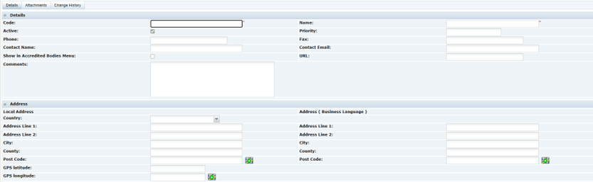

To add a new Accredited Body, select the New Accredited Body action. The New Accredited Body tab opens. The Name and Code fields are mandatory. The contact details and address may also be entered.
Figure 7-21 New Accredited Body Page
This image shows the New Accredited Body page.
If the URL is set, such as to the third party’s proprietary system, an option will appear in the Accredited Bodies navigation Tasks menu, providing a direct link to the third party system. The URL must be prefixed with http:// or https://.

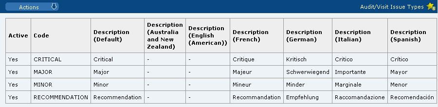

Audit/Visit Issue Types
Audit/visit issue types define the types or levels of non-conformance that can be raised against an audit. An audit/visit template may not be edited once it has been made active; to make any changes it must first be deactivated. The Audit/Visit Issue Types page has the following columns:
  • Set to Yes if the issue type is active.
  • Code for the issue type.
  • Description for the issue type in the default language.
  • Descriptions for each supported language.
Figure 7-26 Audit/Visit Issue Types Page
This figure shows the Audit/Visit Issue Types page.
To edit the list of issue types, select the Edit action. The table opens in edit mode. Only the translated descriptions can be edited.
To add a new issue type, click Add. If the issue type should be set active, check the box in the Active column. The code and description in the default language are mandatory fields.

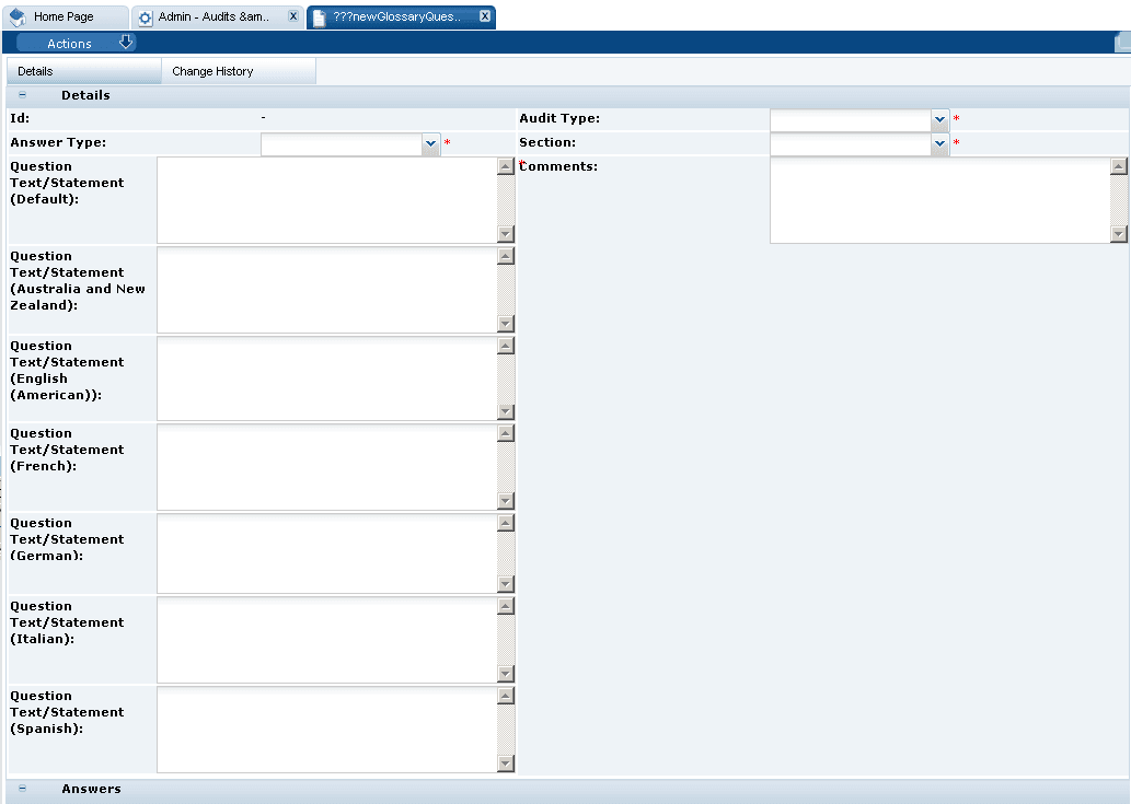

Checklist Questions
The sets of available checklist questions are managed using this option.
Figure 7-33 Checklist Questions
This figure shows Checklist questions.
To edit a checklist question, select the entry and then select the Edit action. The question record opens in edit mode.
To add a checklist question:
  1. Select the New Checklist Question action. The New Glossary/Question tab opens.
    Figure 7-34 New Checklist Question Page
    This figure shows the New Checklist Question page.
    • Id: This is a unique identifier of each question. It is automatically assigned as an incrementing sequence number.
    • Audit Type: Select the type of audit associated with this question from the drop-down list. This field is mandatory. A new Audit Type can be created by entering a value into the field rather than selecting from the drop-down list.
    • Answer Type: Select the type of answer associated with this question from the drop-down list. This field is mandatory.
    • Section: Select the section of the questionnaire from the drop-down list. This field is mandatory. A new Section can be created by entering a value into the field rather than selecting from the drop-down list.
    • Question/Text Statement: Enter the question in the default language. This field is mandatory. Enter any translations.
    • Comments: Use this field to enter a comment regarding this checklist question glossary entry.
  3. In the Answers section: The table of Answers is automatically built based on the selected answer type. The table is only applicable for Single Choice and Multi Choice answer types. For more information, see Checklist Answers
