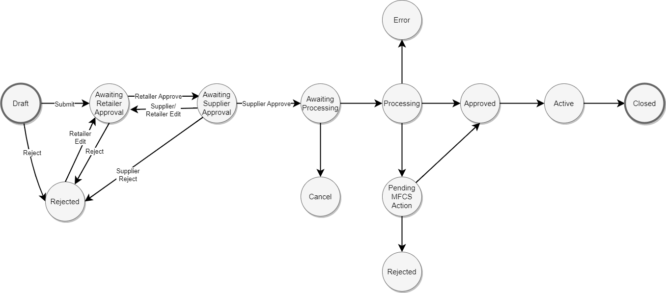

Status Workflow
Figure 20-1 Deals Management Status Workflow
Deals Management follows a workflow path, and the status can change depending on:
- The user permissions
- The current status of the Deal
Deal Status
- Draft – Draft status is the initial status of a Deal and the prior status to being submitted. When the deal is submitted, the status is automatically updated to New. If the user rejects a Deal in Draft status, then new status is Rejected.
- Awaiting Retailer Approval – Awaiting Retailer Approval status is the prior status to being approved. If a Retailer user has approval permission and approve a Deal in Draft status the new status is Awaiting Retailer Approval (after running validations). If any user rejects the Deal, the new status is Rejected.
- Awaiting Supplier Approval – Awaiting Approved status is the new Deal status after the Deal has been approved by a Retailer user. While a Deal is in Awaiting Approval status it can be edited by a Supplier and Retailer users and the status goes back to New status, can be approved by a Supplier user, with approval permission, and the new status is Awaiting Processing or rejected and the new status is Rejected.
- Rejected – The Rejected status is for Deals that were either created (Draft status), submitted (New status) or approved by a Retailer user (Awaiting Approval status) previously and a user rejected them. Deal in Reject status can be updated and submitted again by a Retailer user and changes to New status. If a Retailer user approves a rejected Deal the new status is Awaiting Approval.
- Awaiting Processing – Awaiting Processing status is the new Deal status after the Deal has been approved by a Supplier user when the Deal is in Awaiting Approval status. While a Deal is in Awaiting Processing status it can be processed by the Publish Batch Process or canceled.
- Canceled – Canceled status is the new Deal status after the Deal has been canceled when the Deal is in Awaiting Processing status. After the Deal is in Canceled status no more actions can be applied to the Deal.
- Processing – This status is used while the Deal is being interfaced with MFCS, once the Deal is successfully processed by MFCS the status will change to either Approved or Pending MFCS (if the deal in MFCS is in Worksheet or Submitted).
- Active – This status represents when the Deal is Active in MFCS. The deal will be displayed with Active Status for Approved Deals between the Start and End Date of the Deal.
- Closed – The deal will move to this status once it has reached the End Date and is Closed by MFCS.
- Pending MFCS – This status is used when a Deal was interfaced to MFCS but is not Approved. This could be due to validations failing in MFCS, but the Deal has still been created, or if the Supplier Configuration in MFCS is set to always interface the Deals to a non Approved Status. In this Status users are expected to go to MFCS to finish the approval workflow process.
- Error – This status is used to indicate if issues were found while interfacing the deal to MFCS and should contact support to check.

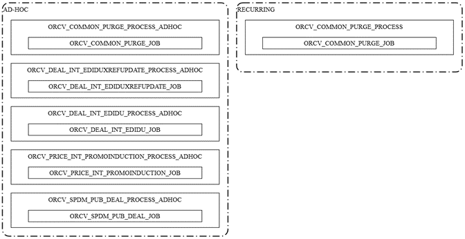

POM Configuration
Batch scheduler details with all batches, dependencies and frequencies can be downloaded following the steps in the Supply Chain Hub Frameworks section.

Specific Batch Configuration
This section describes specific batch configurations.
Publish Deal Batch
Publish Deals Batch publishes Deals in status “Awaiting Processing” to Integration API when the VDATE is between start date - INT_DAYS_BEFORE_START and start date.
If the Deal is of type VFP the batch will check if Promotions are required to be created before the deal and will publish to the Integration API the Promotions. Only after Promotions are successfully create in MFCS/RPCS it will publish the Deal.
The Bill Back Deals use BILL_BACK_PERIOD defined at Supplier configuration level when publishing the Deals to MFCS.
- Job: ORCV_SPDM_PUB_DEAL_JOB
- Frequency: Ad-hoc
- Dependency: None
- Inter Scheduler Dependency: None

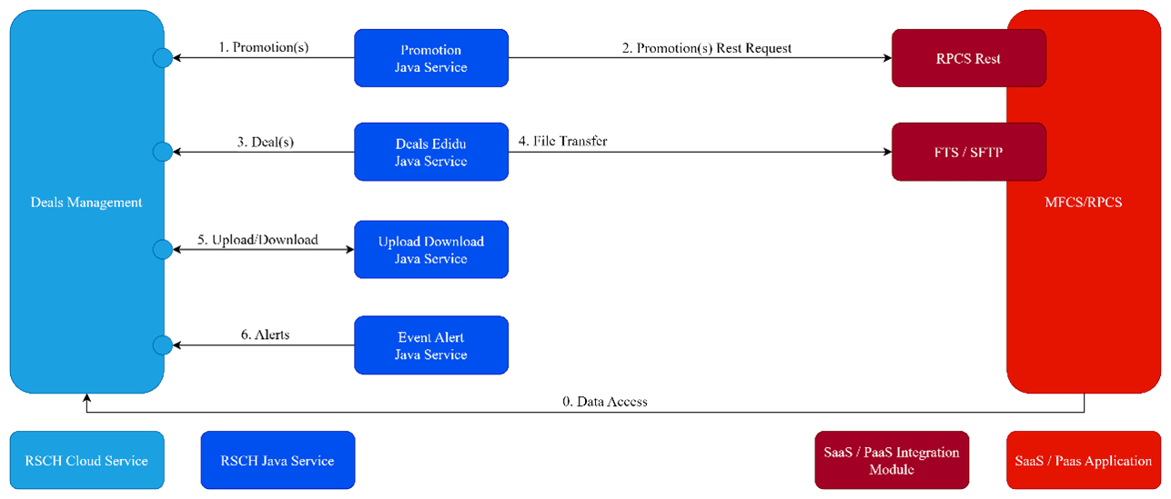

Integration by Module
Figure 20-4 Deals Management Integration by Module
| STEP | DESCRIPTION |
| 0 | RSCH Data Access of MFCS data |
| 1 | Promotion Java Service gets Promotions to be integrated to RPCS. |
| 2 | Promotion Java Service publishes Promotions to RPCS via Rest. |
| 3 | Deals Edidu Java Service gets Deals to be integrated to MFCS. |
| 4 | Deals Edidu Java Service sends produced files to Integration File Transfer. |
| 5 | Integration File Transfer publishes files to MFCS File Transfer Services (FTS) or MFCS shared folder (depending on configuration). |
| 6 | Deals Management calls Upload Download Java Service to transform files, depending on the request details, Upload Download Java Service might need to callback to Deals Management to get more details. |
| 7 | Event Alert Java Service checks if there are alerts to be triggered. |
Batch by Module
This section describes batches by module.
Publish Deal Batch
Authentication Method: OAuth2
BaseURL: https://<BASE_URL>/ords/rsch/orcv/merch/dealsmanagement/publish/deal/<URL_PATH>
| URL PATH | REQUEST METHOD | REQUEST BODY | AFFECTED TABLES |
| start | POST |
{ "cycleName": "", "flowName": "", "processName": "", "async": "", "executionId": "", "jobName": "ORCV_SPDM_PUB_DEAL_JOB", "agentExecutionId": "", "parameters": "" } |
ORCV_BATCH_STATUS_CONTROL ORCV_THREAD_CONTROL ORCV_BATCH_AUDIT_STATUS ORCV_SPDM_DEAL_HEAD ORCV_SPDM_DEAL_PROMO ORCV_DEAL_INT_ERR_SVC ORCV_DEAL_INT_HEAD_SVC ORCV_DEAL_INT_DETAIL_SVC ORCV_DEAL_IL_ITEM_SVC ORCV_DEAL_INT_COMP_PRM_SVC ORCV_DEAL_INT_THRESHOLD_SVC ORCV_PRICE_INT_ERR_SVC ORCV_PRICE_INT_PRM_HEAD_SVC ORCV_PRICE_INT_PRM_OF_SVC ORCV_PRICE_INT_PRM_OFR_SVC ORCV_PRICE_INT_PRM_OFR_ITM_SVC ORCV_PRICE_INT_PRM_OFLOC_SVC |
| restart | POST |
{ "cycleName": "", "flowName": "", "processName": "", "async": "", "executionId": <EXEC_ID>, "jobName": "ORCV_SPDM_PUB_DEAL_JOB", "agentExecutionId": "", "parameters": "" } |
| log | GET |
URL query parameters: /log?jobName=ORCV_SPDM_PUB_DEAL_JOB &executionId=<EXEC_ID>&logDate=YYYY-DD-MM |
N/A |
| kill | POST |
ORCV_BATCH_STATUS_CONTROL ORCV_THREAD_CONTROL ORCV_BATCH_AUDIT_STATUS |
| status | GET |
URL query parameters: /status?jobName=ORCV_SPDM_PUB_DEAL_JOB &executionId=<EXEC_ID>&logDate=YYYY-DD-MM |
N/A |
