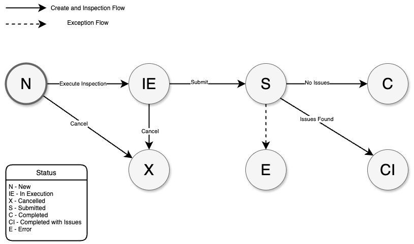

Status Workflow
Figure 19-1 Quality Control Status Workflow
Quality Control follows a workflow path, and the status can change depending on:
- The user permissions
- The current Status of the Job
Job Status:
- New (N) – New is the status of a Job when the user creates it. In this status a Job can be Cancelled or, when a user starts execution, can be set to In Execution.
- In Execution (IE) – In Execution status a Job can be updated and Submitted/Completed or can be Cancelled.
- Submitted (S) – Submitted is a status used when a user without approved permission tried to complete a Job. A Job can be set to this status when integration fails, to integrate RTV again.
- Completed (C) – A Completed Job is a Job completed without issues. The Job is not editable whilst on this status.
- Completed with Issues (CI) – A Completed with Issues Job is a Job with issues. The Job is not editable whilst on this status.
- Cancelled (X) – In Cancelled Status a Job cannot be updated.

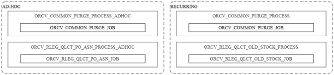

Configuration
This section describes Quality Control configurations.
POM Configuration
Batch scheduler details with all batches, dependencies and frequencies can be downloaded following the steps in the Supply Chain Hub Frameworks section.
Figure 19-3 Quality Control Batch Schedule Overview

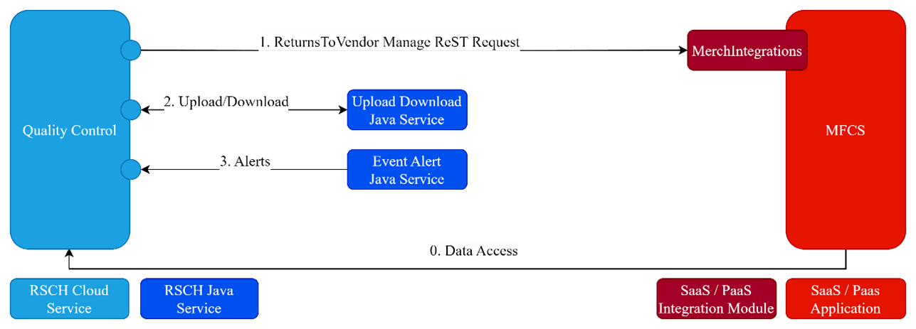

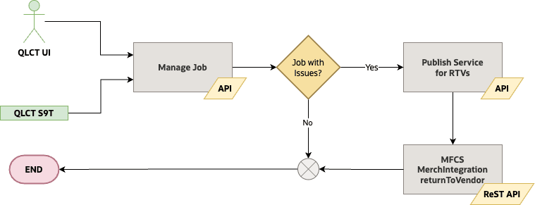

Integration by Module
Figure 19-4 Quality Control Integration by Module
| STEP | DESCRIPTION |
| 0 | RSCH Data Access of MFCS data |
| 1 | Quality Control calls MFCS Return To Vendor Rest endpoint in MerchIntegrations to publish new RTVs. |
| 2 | Quality Control calls Upload Download Java Service to transform files, depending on the request details, Upload Download Java Service might need to callback to Quality Control to get more details. |
| 3 | Event Alert Java Service checks if there are alerts to be triggered. |
Batch by Module
This section describes batches by module.
PO ASN Received Batch
The PO ASN Received batch uses the Rule Engine Framework described in the Supply Chain Hub Frameworks section. To execute this batch call Rule Engine Web Service with Rule Key QLCT_PO_ASN.
Old Stock Batch
The Old Stock batch uses the Rule Engine Framework described in the Supply Chain Hub Frameworks section. To execute this batch call Rule Engine Web Service with Rule Key QLCT_OLD_STOCK.
