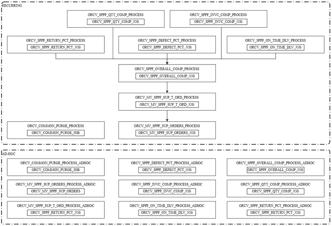

POM Configuration
Batch scheduler details with all batches, dependencies and frequencies can be downloaded following the steps in the Supply Chain Hub Frameworks section.

Overall Compliance
This batch will calculate the score for each Supplier of each metric along with an overall score of the last days based on SCORE_AVG_DAYS System Parameter.
- Job: ORCV_SPPF_OVERALL_COMP_JOB
- Frequency: Nightly
- Dependency: ORCV_SPPF_ON_TIME_DLV_JOB, ORCV_SPPF_QTY_COMP_JOB, ORCV_SPPF_INVC_COMP_JOB, ORCV_SPPF_RETURN_PCT_JOB, ORCV_SPPF_DEFECT_PCT_JOB
- Inter Scheduler Dependency: None
Batch configuration table: ORCV_BATCH_CONFIG
| COLUMN NAME | DEFAULT VALUES |
| PROGRAM_NAME | ORCV_SPPF_OVERALL_COMP_JOB |
| MAX_CHUNK_SIZE | 1000 |
| MAX_CONCURRENT_THREADS | 4 |
| RETRY_LOCK_ATTEMPTS | 3 |
| RETRY_WAIT_TIME | 3 |
| RETRY_MAX_ATTEMPTS_COUNT | 3 |
| RETRY_ORDERED | N |
| RETRY_IND | N |
Materialized Views
This application requires some results to be materialized in tables using the Materialized View Framework described in the Supply Chain Hub Frameworks section, below is the list for this application. Materialized views used in Supplier Performance are listed in this section.
ORCV_MV_SPPF_SUP_T_ORD
Returns all Total count, value and last creation date of completed Orders with status C and Total count, value and last creation date of open Orders status A, by supplier. Value currency is on MFCS system configuration options reference currency. Used by the Supplier Performance homepage.
Pre-Dependencies: ORCV_SPPF_OVERALL_COMP_JOB
Post-Dependencies: ORCV_MV_SPPF_SUP_ORDERS_JOB
Frequency: Ad-hoc, Nightly
Returns the order number, status, supplier, currency code, received and not after date, total value, quantity ordered and received for all supplier orders. Used on Supplier Performance page.
Pre-Dependencies: ORCV_MV_SPPF_SUP_T_ORD_JOB
Post-Dependencies: None
Frequency: Ad-hod, Nightly
