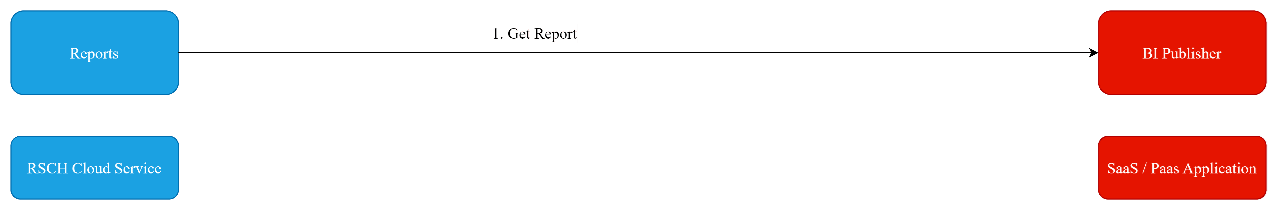

Integration High Level
Figure 26-1 Reports Integration High Level

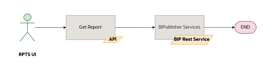

Integration by Module
Figure 26-2 Reports Integration by Module
STEP DESCRIPTION
1 Get Report from BI Publisher Rest Service.
