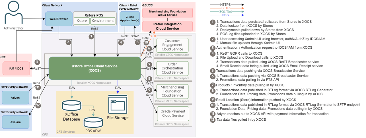

Environments
A fully provisioned account has both a production environment and a staging environment. No one other than Oracle Cloud Operations (CloudOps) personnel can have direct access to any of the cloud environments.
Implementation teams access Xstore Office Cloud Service through the Xadmin UI or through REST web service APIs. See the Oracle Retail Xstore Suite Services Guide and the Oracle Retail Xstore Office Cloud Service User Guide for detailed information on features available in Xstore Office Cloud Service.
The figure below shows the integration data flows and the corresponding webservices APIs that are available in Xstore Office Cloud Service.
Figure 3-1 Xstore Office Cloud Service Integration Data Flow
As you can see from the diagram in above Xstore Office Cloud Service does not have its own SFTP server.
Xstore Office Cloud Service does not use a WebDAV server for file deployments and pospoll uploads.
To get data from/upload data to XOCS the retailer will need to use the REST APIs documented in the Oracle Retail Xstore Suite Services Guide (My Oracle Support Doc ID: 1994467.1). The guide has details on invoking the File Rest API to PUT/GET/DELETE and view listing of the files in containers.
Another thing worth mentioning is that XOCS environments are provisioned with empty Xcenter and Replication databases and minimum required data in Xadmin database.
It will be responsibility of the retail/SI partner teams to load data in XOCS. Refer to Data Seeding on how to load data in XOCS.
