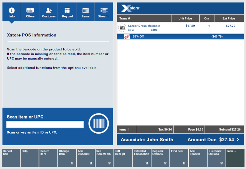

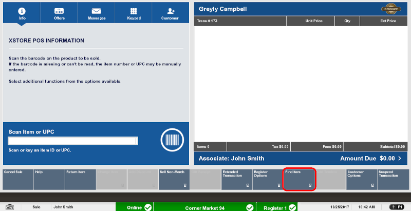

Click Find Item in the Register Sale screen.
Figure 6-1 Register Sale Screen

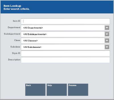

Figure 6-2 Item Lookup Form
The Item Lookup window opens.
Enter the search criteria for the item:
Item ID - ID of the item.
Department - Department to which the item belongs.
Subdepartment - Subdepartment to which the item belongs.
Class - Class to which the item belongs.
Subclass - Subclass to which the item belongs.
Style ID - ID of the style assigned to the item.
Description - Content in the description of the item.
If advanced search options are configured on your systems, use the advanced options to further refine the search:
Select the value for any search criteria you are using.
Click Exclude for any unused search criteria.
Click Process.

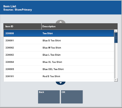

If necessary, select an item in the Item List window:
Figure 6-3 Item Selection
Click the item.
Use the up and down arrows to highlight the correct item, then press the Spacebar.
Click OK.
The item opens in the Item Viewer.

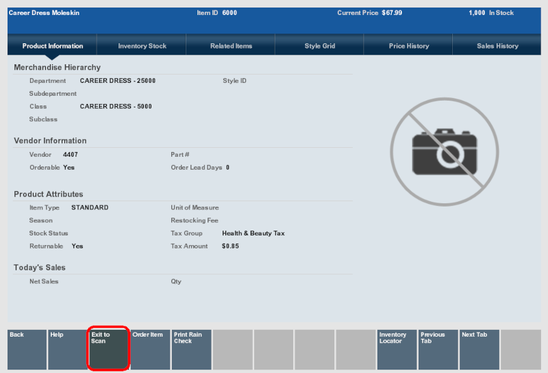

Figure 6-4 Item Viewer
If your system has the Scan Items Prior to Adding to Transaction setting configured, you need to scan the item to confirm it is the correct item.
Figure 6-5 Item Viewer with Exit to Scan Button Highlighted

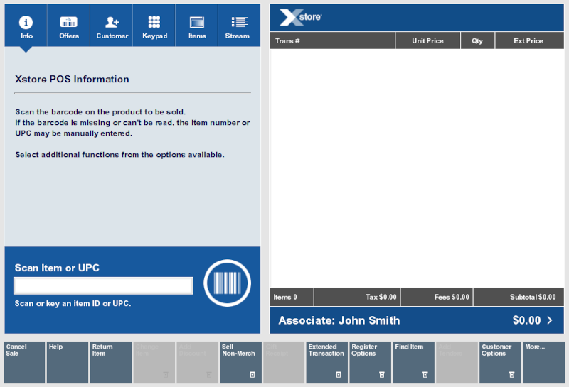

Select Exit to Scan. You are returned to the Sales screen and must scan the item in order to add it to the transaction.
Figure 6-6 Sales Screen Awaiting Item Scan
Once an item is scanned it is added to the transaction:
Figure 6-7 Sales Screen After Item Scan

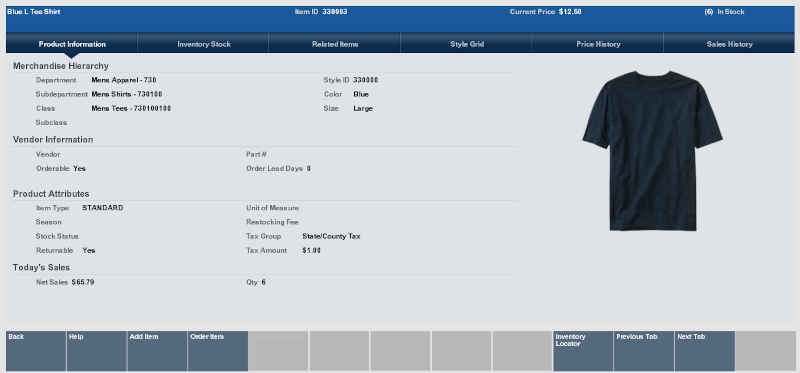

Item Viewer
The Item Viewer provides information about an item. The Item Viewer displays the following information along the top of the screen:
Name of the item.
Current Price - Current price of the item.
Quantity of the item currently in stock.
The Item Viewer has the following tabs:
Product Information - Information about the item.
Inventory Stock - Current inventory information for the item.
Related Items - Information about items related to the selected item.
Style Grid - Grid showing on-hand quantities of the item with on dimension cross-referenced with another dimension.
Price History - Past prices for the item.
Sales History - Past sales data for the item.
You can also print a rain check from the Item Viewer. See Print a Rain Check.
Product Information
The Product Information tab, (see Figure 6-4), displays the sections that display information about an item:
A picture of the item (if available).
Merchandise Hierarchy - Merchandise hierarchy to which the item is assigned.
Vendor Information - Vendor that provides the item.
Product Attributes - Attributes of the item.
Today's Sales - Sales information for the item on the current day.
The Merchandise Hierarchy section displays the following information:
Department - Item department.
Subdepartment - Item subdepartment.
Class - Item class.
Subclass - Item subclass.
Style ID - ID of the style for the item (if available).
Dimension information for the item.
Vendor Information
The Vendor Information section displays the following information about the item's vendor:
Vendor - Name of the vendor.
Orderable - Indicates whether the item can be ordered.
Part # - Part number used by the vendor.
Order Lead Days - Number of lead days required when ordering the item.
Product Attributes
The Product Attributes section displays the following information:
Item Type - Type of item.
Season - Season for the item.
Stock Status - Current stock status.
Returnable - Indicates whether the item can be returned.
Unit of Measure - Unit used to measure the item (if applicable).
Restocking Fee - Restocking fee applied to the item when it is returned (if applicable).
Tax Group - Tax group for the item.
Tax Amount - Amount of tax applied to the item.

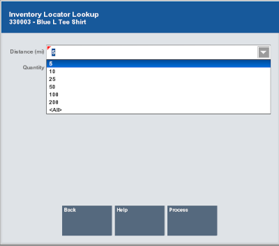

Inventory Lookup
Occasionally an item may not be available in your store inventory, but the customer would like to see which stores in your chain have the item in stock. You can use the inventory lookup process to search a centralized database to locate these items within a set parameter range. For example, you could locate a specified item at a store within 25 miles of your location that has at least three of the specified items on hand.
To perform an inventory lookup:
Click Find Item in the Register Sale screen (Figure 6-1).
Click Inventory Lookup.
The Inventory Locator Lookup window opens.
Figure 6-13 Inventory Locator Lookup
Enter the lookup information for the item:
Style ID - ID of a style assigned to the item.
Either the Item ID or Style ID field must be populated. Information in the Style ID field is ignored if the Item ID field is also populated.
Distance - Distance from the local store.
Quantity - Minimum quantity of the item that the store must have on hand. For example, if the customer needs three of the items, enter “3".
Click Process.

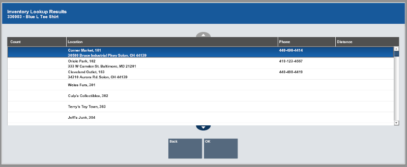

Figure 6-14 Inventory Locator Results
Xstore Point of Service returns a list of stores with the item. The following information will be displayed for each location:
Count - On-hand quantity of the item at the store.
Location - Address for the store.
Phone - Phone number for the store.
Distance - Distance of the store from the local store.
Click OK to close the window.
