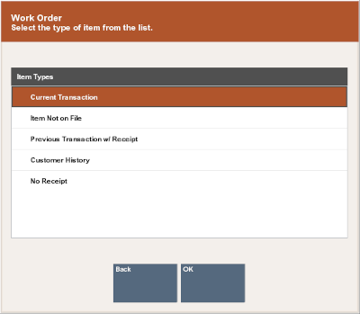

Figure 13-1 Work Order Item Type

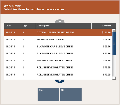

Click the method to use to find the item on which the work order will be performed, then click OK:
Current Transaction - The item is in the current sale transaction. This option is only available if there is at least one item in the current sale transaction.
Xstore Point of Service displays a list of items in the current transaction that are eligible for a work order. Continue with Current Transaction.
Item Not on File - The item requiring work is not in the system.
Xstore Point of Service prompts for a description of the item. Continue with Item Not on File.
Previous Transaction w/ Receipt - The item is identified on the receipt from a previous transaction.
Xstore Point of Service prompts you to enter information from the original transaction receipt. Continue with Previous Transaction with Receipt.
Customer History - Find the item by searching the customer's previous purchase transaction history.
Xstore Point of Service displays a list of items previously purchased by the customer that are eligible for a work order. Continue with Customer History.
No Receipt - The item has no receipt available or is not referenced on a receipt.
Xstore Point of Service prompts for an item ID. Continue with No Receipt.
Current Transaction
After selecting Current Transaction in Step 5, do the following:
Select the items in the Message Window.
Click the items.
Use the up and down arrows to highlight the correct items and press the Spacebar.
Click OK.

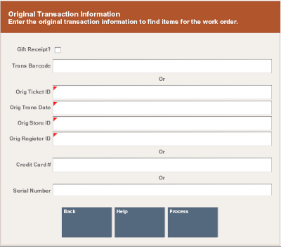

After selecting Previous Transaction w/ Receipt in Step 5, do the following:
Figure 13-5 Work Order Original Transaction Search Form
Enter information about the original transaction:
Gift Receipt - Indicates whether the receipt is a gift receipt.
Trans Barcode - Barcode for the transaction.
Orig Ticket ID - ID of the original ticket.
Orig Trans Date - Date of the transaction.
Orig Store ID - ID of the store where the transaction was performed.
Orig Register ID - ID of the register that performed the original transaction.
Credit Card # - Number of the credit card used in the original transaction.
Serial Number - Serial number of the item.
Click Process.
Xstore Point of Service displays a list of items from the original transaction that are eligible for a work order.
Select the items to add to the work order.
Click the items.
Click OK.

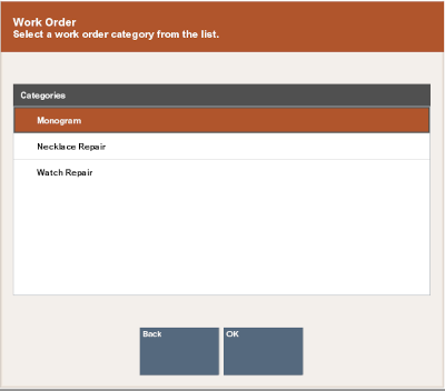

Work Order Categories
Once you have identified the item(s) for the work order, you are prompted to select a work order category. Categories may include repairs, alterations, or any other categories that are determined by your store operations.
For example, repairs may include work order categories such as jewelry and watch repairs. Work order alterations may include categories such as men's clothing and children's clothing.
Select the work order category.
Figure 13-8 Work Order Categories
The work order categories available depend upon the configuration of your system.

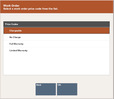

If necessary, select or enter additional information about the work order in the prompts. For example, you may need to enter warranty information or select a work order price code.
Figure 13-9 Work Order Warranty Plan
Figure 13-10 Work Order Price Code List

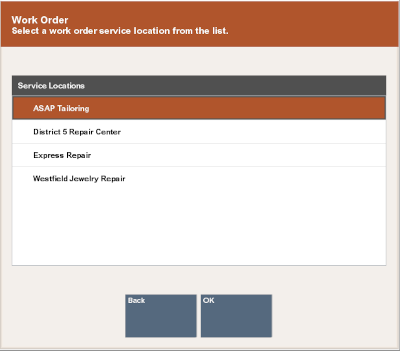

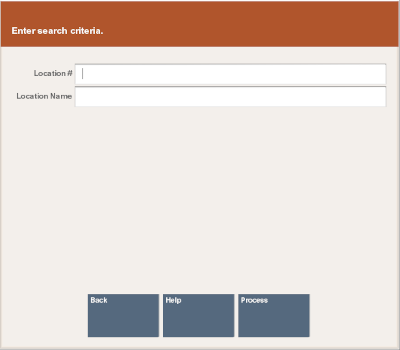

If necessary, enter the information about where the work will be performed:
Figure 13-11 Work Order Location Search Form
If necessary, select the location where the work will be performed, then click OK:
Click the location.
Use the up and down arrows to highlight the correct location and press the Spacebar.

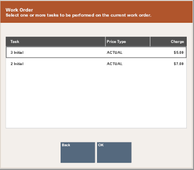

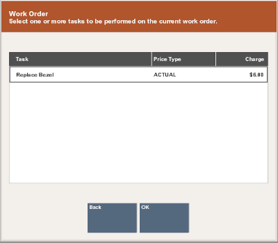

Figure 13-13 Work Order Tasks List
Select the tasks to be performed on the item:
Click the task.
Use the up and down arrows to highlight the correct task and press the Spacebar.
A task may not have a cost associated with it. If it does not have a cost, it may be an estimate. Estimates must be converted to actual amounts before the customer can pick up the item. Price categories such as No Charge and Warranty have zero amounts in the Charge column on the Task List form.
Click OK.

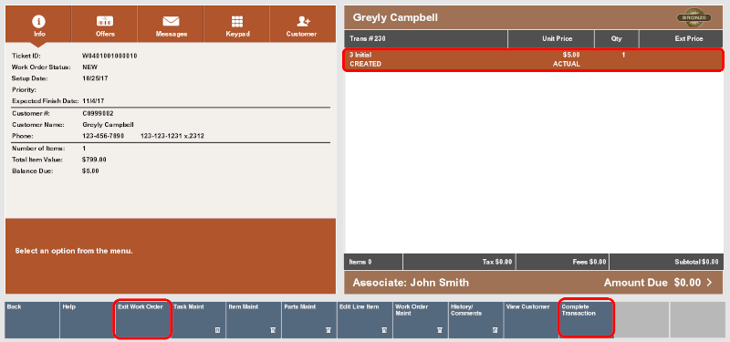

The work order appears in the View Port.
Figure 13-14 Work Order Summary Information
Click the appropriate option:
Click Exit Work Order to exit work order mode and perform additional transaction processing.
Click Complete Transaction to proceed to tendering.
After performing the appropriate procedure, continue the transaction.

Click Add Task.
Xstore Point of Service displays a list of tasks that are available for the work order service location.
Figure 13-22 Work Order Task List
Select the task to add:
Click the task.
Click OK.
The task is added to the transaction.
Delete a Task
To add a task:
Click Delete Task.
Xstore Point of Service displays a list of tasks that are currently on the work order.
Select the task to delete:
Click the task.
Click OK.
The task is deleted from the transaction.

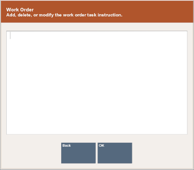

Add an Instruction
Instructions can be added to a work order to provide additional information about the work. To add an instruction:
Click Add Instruction.
Select the task for which to add an instruction:
Click the task.
Click OK.
Xstore Point of Service displays a text entry prompt.
Figure 13-23 Work Order Task Instruction Prompt
Press Enter when you are done entering the instruction.
The instruction is added to the task.

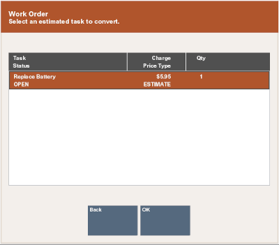

Convert an Estimate
Converting a estimate changes an estimated cost amount to an actual cost amount. An estimated cost is a best guess for the final cost of performing the task, and it is assigned when the work order is created. After the task is completed, the actual cost is known, and the estimate can be converted so that the final price can be calculated. To convert an estimate:
Click Convert Estimate.
Xstore Point of Service displays a list of the tasks in the work order that have estimated costs.
Figure 13-24 Work Order Estimate Task List
Select the task for which to convert an estimate:
Click the task.
Click OK.
Xstore Point of Service displays a list of the tasks with actual costs that are applicable to the work order category (for example, a repair or alteration).
Figure 13-25 Work Order Actual Price Type
Select the appropriate task type to use to set the amount:
Click the task type.
Use the up and down arrows to highlight the correct task type and press the Spacebar.
Click OK.
The selected work order cost is applied to the task that previously had an estimated cost.

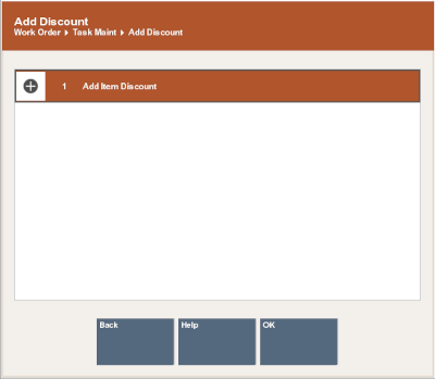

Discount a Task
The procedure for applying a discount to a task is the same as the procedure for applying a discount to any other item. See Item Discount for more information.
Figure 13-26 Work Order Task Discount Option

Change the Price Type
Changing a price type can change the price from Actual to Estimated, Estimated to Actual, or to change from Chargeable to Warranty. You may also select No Charge. For example, a customer may not have the warranty information in-hand when the work order is set up. If the customer returns later with proof of a valid warranty, you can use this option to change the work order price from Chargeable to Full Warranty or Limited Warranty.
To change the price type for the work order:
Click Change Price Type.
Xstore Point of Service prompts for the new price code.
Figure 13-29 Work Order Price Code List
Select the price type:
Click the price type.
Use the up and down arrows to highlight the correct price type and press the Spacebar.
Click OK.
The price type is applied to the work order and the price is changed for the new price type.

Edit the Service Location
To change the location where the work will be performed:
Click Edit Service Location.
Xstore Point of Service prompts for the location information.
Enter the information about where the work will be performed:
Enter the location information, then click Process:
Location # - ID for the location.
Location Name - Name of the location.
The service location is updated to the entered location. Continue the transaction.
Leave the fields blank and click Process to view a list of available service locations.
Continue with Step 3.
If necessary, select the location where the work will be performed:
Click the location.
Click OK.
