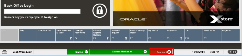

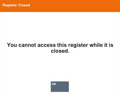

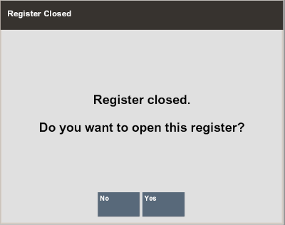

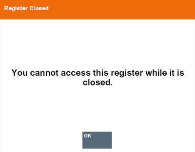

When you attempt to log in to the system, Xstore Classic determines the status of the register and store. If the register status is closed, a Register Closed message displays if configured to do so. Press OK to close the message.
Figure 10-1 No Access - Register Closed
The red register indicator on the status bar also shows that the register is closed.
Figure 10-2 Status Bar - Register Closed
If you are using a touchscreen, tap the red register status bar to open the register. The focus bar prompts for your employee ID and password. Enter the information when prompted. Proceed to step 7.

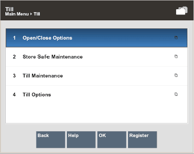

At the Back Office Main Menu, select Till and then the Open/Close Options option and press Enter, or press the number associated with the menu option on the keyboard to display the Open/Close Options menu.
Figure 10-4 Till Menu - Open/Close Options

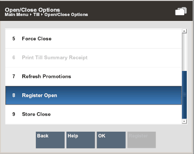

At the Open/Close Options menu, select the Register Open option and press Enter, or press the number associated with the menu option on the keyboard.
Figure 10-5 Open/Close Options - Register Open

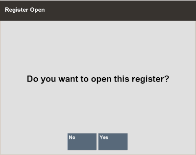

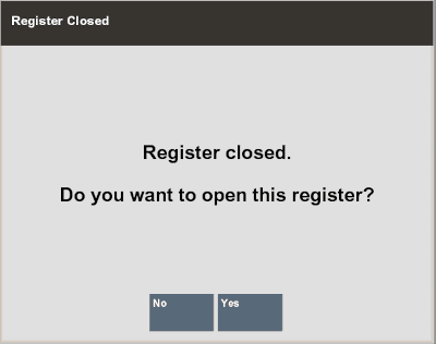

The Register menu option toggles between Open and Close. If the available menu option is Register Close, the register is currently open. If the available menu option is Register Open, the register is currently closed.

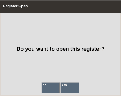

Xstore Classic prompts: Do you want to open this register? Press Yes to confirm that you want to open this register.
Figure 10-6 Register Open Prompt

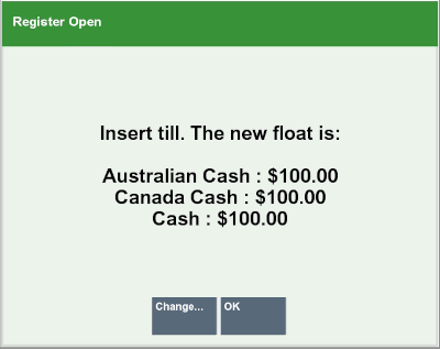

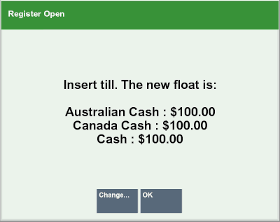

Depending upon your system configuration, there are different float options when opening the till:
For example, if Prompt for Float is configured, all money is removed during close. A new till is inserted and counted during open. You are required to enter the float value.
If Pre-defined Float is configured, all money is removed during close. A new till is inserted during open but not counted. You are prompted to insert the till. The float amount of the till is displayed.
Figure 10-7 Pre-defined Float Amount
Press OK to confirm the float amount.

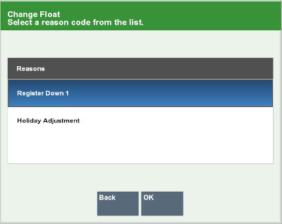

You are prompted for a reason.
Figure 10-8 Change Float
Select the reason and press OK.

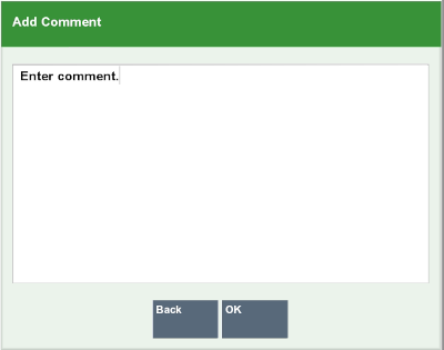

You are prompted to enter a comment.
Figure 10-9 Add Comment
If necessary, enter additional comments and press OK.

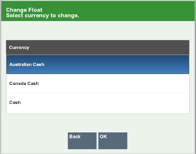

Select a currency to change.
Figure 10-10 Change Float Select Currency

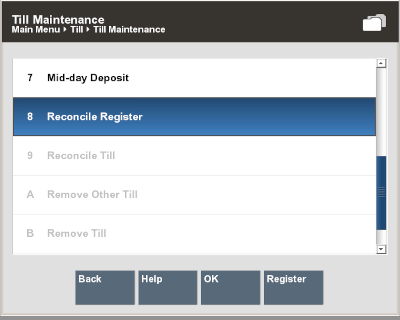

At the Back Office Main Menu, select Till Maintenance and press Reconcile Register/Till.
Figure 10-12 Till Maintenance Options

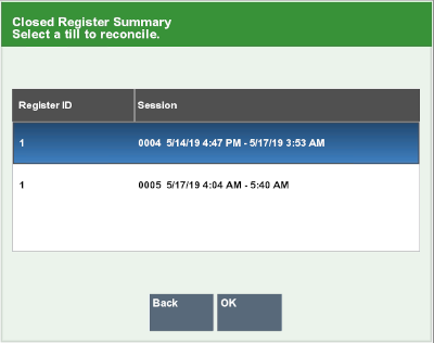

The Closed Register Summary list displays.
Figure 10-13 Closed Register Summary

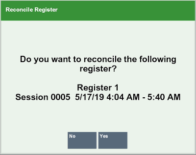

Select a till to reconcile. Each one is counted individually.
Figure 10-14 Reconcile Register
Select Yes to confirm the correct register is selected.

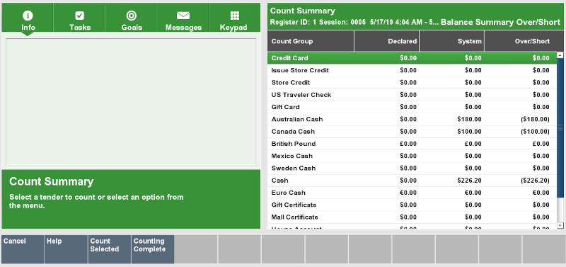

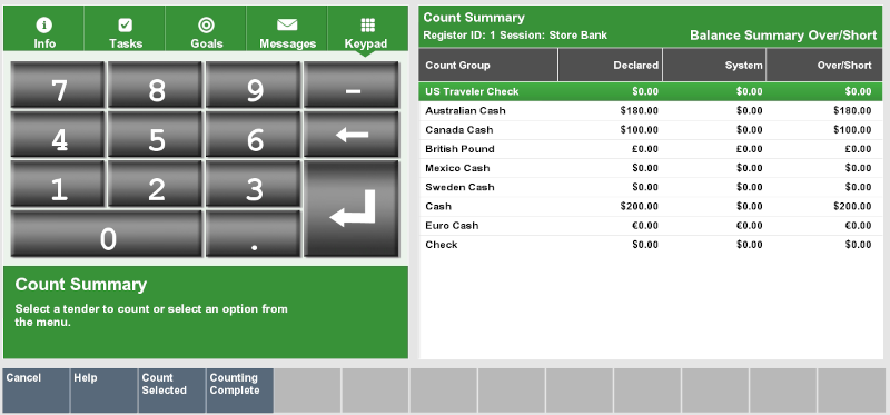

All available tender types are displayed in the Count Summary screen, with the following amounts.
Declared Amount: The declared amount is the amount you enter in the Denomination Count screen.
System Amount: The system amount is the expected amount from the system.
Over/Short Amount: The over/short amount shows the difference between system and declared amount.
Figure 10-15 Count Summary
You are prompted to select a tender type for the till reconcile.
Select a tender type and press Select Count.

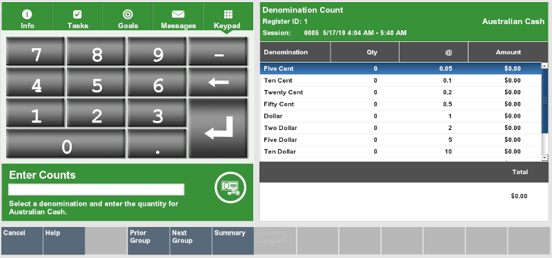

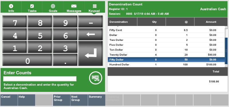

The Denomination Count screen appears.
Figure 10-16 Denomination Count
You are prompted to select a denomination and enter the quantity.
Select a denomination. Enter the quantity and press Confirm Entry. The amount for the denomination and the total amount is displayed on the Sales Display Panel.
Figure 10-17 Denomination Count After Entry
Repeat this process for all available denominations.

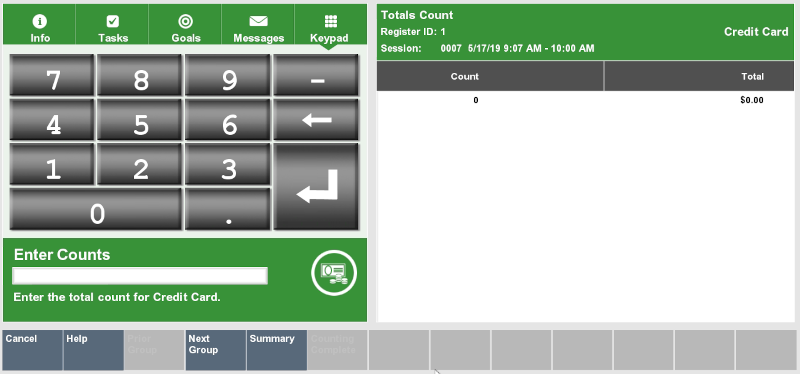

If no denominations are configured, the Total Count screen appears.
Figure 10-18 Totals Count Screen
You are prompted to enter the total count for the selected tender type.
Enter the total count and press Confirm Entry. The count is displayed on the Sales Display Panel.
You are prompted for the total amount of the selected tender type.
Enter the total amount and press Confirm Amount. The total amount is displayed on the Sales Display Panel.
Then select Complete. The system returns to the Count Summary.

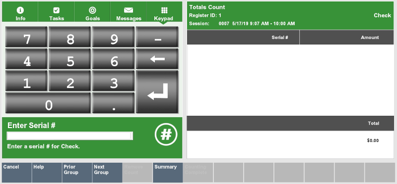

If the Check tender type is selected to count, the Totals Count screen is displayed.
Figure 10-19 Check Tender Type
You are prompted to enter the serial number for the tender type.
Enter the serial number and press Confirm Entry.
You are prompted for the amount of the selected tender type.
Enter the amount and press Confirm Amount. The serial number and the entered amount are displayed on the Sales Display Panel.
Then press Complete. The system returns to the Count Summary.

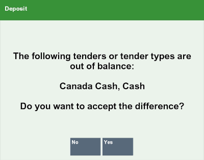

Depending on whether or not your till is out of balance the displayed message varies.
Out of balance: If tender types are out of balance, you are prompted to accept the difference.
Figure 10-20 Out of Balance Example
Yes - accept the difference and close register.
You are prompted for the reason. Select the reason and press OK.
You can also add additional comments. Enter a comment and press OK.
No - repeat till count again.

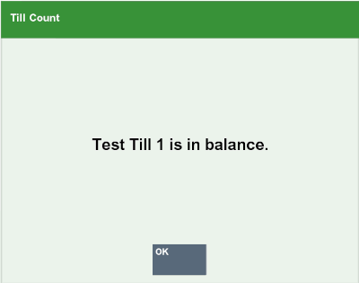

In balance: If all entered tender types are in balance, an Information prompt "Till is in balance" is shown.
Figure 10-21 Till in Balance
Press OK to close the Information prompt.
The register/till is reconciled.

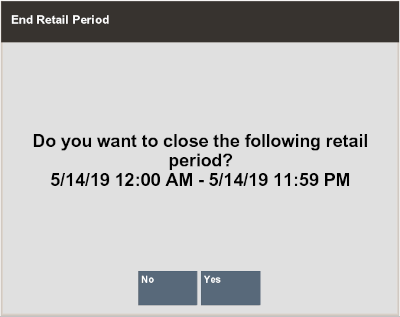

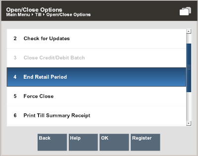

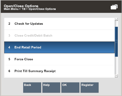

Once all the registers are reconciled within a retail period, you can perform End Retail Period.

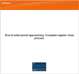

Warning Messages
Warning messages inform you that the end of retail period is approaching, and you should start the Register/Till Close process. The default time frame for the 24/7 rolling close functionality is 24 hours (but this can be configured). A grace period allows you to close the register within a configurable gap. Once the grace period has ended, you must close the register and move to the next retail period. The following messages are displayed.
By default, a warning message is displayed one hour before the end of the retail period. This message appears at the beginning of a transaction, every 10 minutes until the register close process has been started.
The time frame for the warning messages is configurable.
Figure 10-22 End of Retail Period Approaching Warning

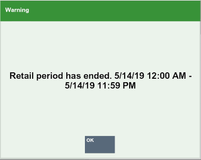

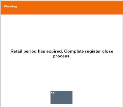

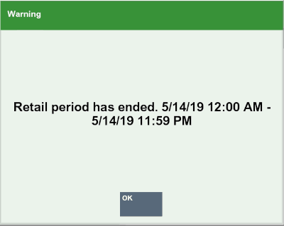

When the configured end of retail period time has passed, another message is displayed on each register. The message informs you that the retail period has expired and that you must close the register.
Figure 10-23 Retail Period Expired
If you try to open a register within the warning or grace period (two hours by default), you are prompted if you want to change to the next retail period, or if you want to open the register within the current retail period.

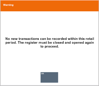

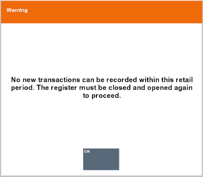

You receive a warning message that you cannot start new transactions within the current retail period. You must close and open the register again to start a new transaction.
Figure 10-24 No New Transactions

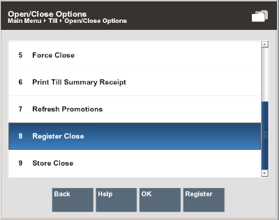

Oracle Point of Service displays the Open/Close Options menu. Select the Register Close option and press Enter, or press the number associated with the menu option on the keyboard.
Figure 10-26 Open/Close Options - Register Close
Note that the Register option toggles between Open and Close. If the option is Register Close, the register is currently open. If the option is Register Open, the register is currently closed.

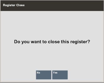

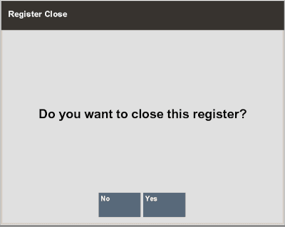

Xstore Classic displays a confirmation prompt: Do you want to close this register? Press Yes to close the register. If the message is not configured, continue with step 5.
Figure 10-27 Close Register
You will need sufficient security privileges to close the register.
Pressing No at the Register Close confirmation prompt cancels the register close process and returns you to the Open/Close Options menu.

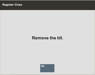

The cash drawer opens.
Depending upon the configuration of your system, you may be prompted to either remove all non-cash tenders from the till or remove all the till contents. Follow the instructions on the screen, then click OK to continue.
For example, if Prompt for Float or Pre-defined Float is configured, all money is removed during close.
Figure 10-28 Remove Till Prompt

Remove the corresponding tenders. Press OK to close the message.
If Float Balance is configured, during the register close process, you are prompted to perform a cash pickup to bring the float down to match the approximate default float amount.
You are prompted to remove all non-cash tenders from the cash drawer (that is, checks, traveler's checks, and so on), and the excess amount above the configured threshold float. You are informed that the remaining tenders are adjusted to the approximate default float amount.
Remove all necessary tenders. Press OK to close the message.
Change the suggested amount or confirm the suggested amount with Enter.

The system may be configured to print a Closed Count receipt and a Register Closed receipt.
Close the cash drawer and the system closes the register.
After the register close is complete, you may be prompted whether to re-open the register.
Figure 10-29 Register Open Prompt
Click No to keep the register closed.
Click Yes to re-open the register.

Pre-defined Float
All money is removed during close, but you are not prompted to count the drawer. A new till is inserted during open, but not counted.
During the register open process, you are prompted to insert a new till into the drawer which includes a pre-configured till amount. There is the option to Change Float if required.

End Retail Period is a Back Office menu option that is required for 24–hour trading. It is initiated after all the tills have been counted using the Reconcile Register or Reconcile Till menu options. See Reconcile Register/Till. The store safe is counted during this process and the deposits confirmed. The End of Retail Period can be deferred to a later date.
The end of retail period process is needed to close a business date after the business period has closed and till reconciliation has completed. The End Retail Period process closes the books on the business date.
To end a retail period:
Select End Retail Period from the Open/Close Options Back Office screen.
Figure 10-30 End Retail Period
The business periods are listed in chronological order by date.
Select the business period from a list of reconciled business periods and click OK.
The prompt "Do you want to close the following retail period? is displayed.
Figure 10-31 Close Retail Period
Select Yes.

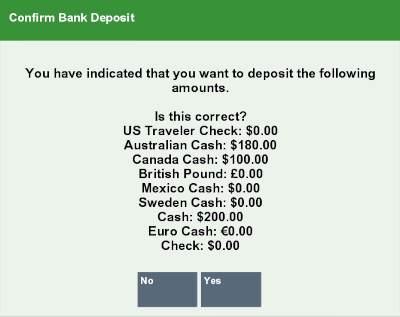

The Store Safe Deposit Count Summary and Count Denomination screens follow. Select a tender and enter the amount by denomination.
Figure 10-32 Safe Deposit Summary
When all amounts have been entered for the required tenders, select Counting Complete. The Confirm Safe Deposit screen confirms the bank deposit amounts.
Figure 10-33 Confirm Safe Deposit
Figure 10-34 Retail Period Ended Prompt
An End Retail Period message is displayed: "Retail period has ended. <date/time> - <date/time>". Select OK to continue.
Once the business period is closed, the user is returned to the Xstore Home screen.
Once the end of retail period has been processed, the period cannot be re-opened, and no further action can be performed.

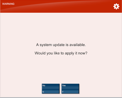

System Updates
Data updates are run automatically in the background while the system is running. When system updates require the application to be temporarily shut down, you are prompted when entering the Back Office at the end of a transaction.
Figure 10-35 System Update Warning
You can delay the system updates for a configurable grace period, so you are not forced to perform the updates immediately if you need time to prepare for them.
At the end of the grace period, there is a configurable time frame in which no new transactions can be started, but existing transactions will be completed. Then, the system updates are applied automatically.
