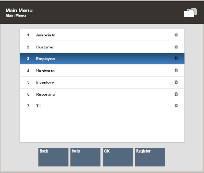

Select the Back Office option.
After logging in to the Back Office (see Accessing the Back Office), select the Employee option from the Main Menu.
Figure 7-1 Employee Option

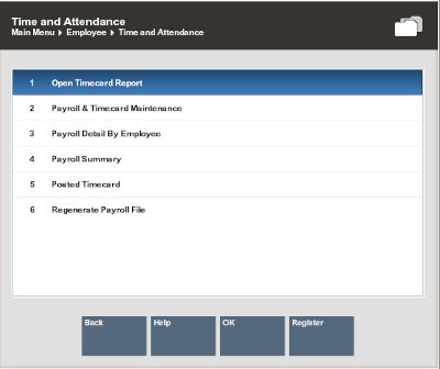

Select one of the options from the Time and Attendance menu.
Figure 7-3 Time and Attendance Menu Options
The following options are available:
Payroll & Timecard Maintenance - Select this option to maintain employee payroll records. Refer to Payroll and Timecard Maintenance.

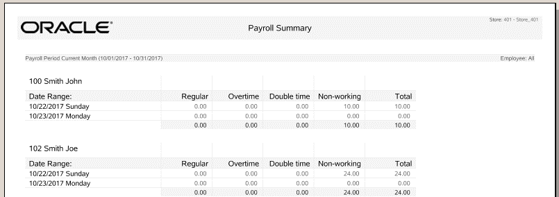

Payroll Summary - Select this option to run the Payroll Report. Refer to Payroll Summary Report.

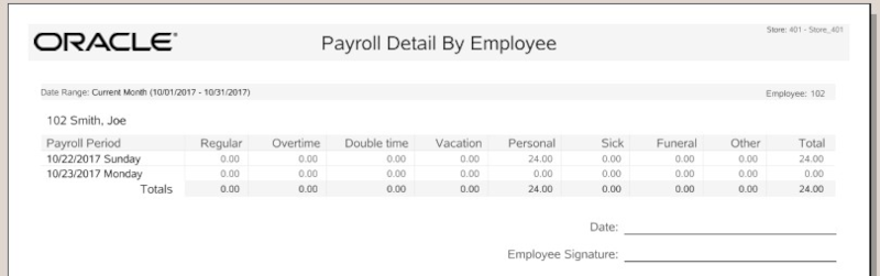

Payroll Detail By Employee - Select this option to run the Payroll Detail By Employee Report. Refer to Payroll Detail By Employee Report.
Posted Timecard - Select this option to run the Posted Timecard Report. Refer to Posted Timecard Report.
Open Timecard Report - Select this option to run the Open Timecard Report. Refer to Open Timecard Report.
Regenerate Payroll File - Select this option to recreate the payroll file.

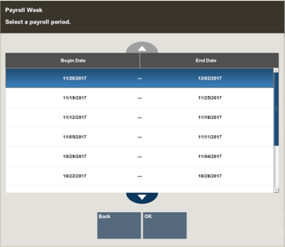

At the Time and Attendance Menu, select the Payroll and Timecard Maintenance option. Oracle Retail Xstore Point of Service prompts for the payroll week you want to manage. Select a payroll date from the list and select OK to continue.
Figure 7-4 Payroll Week List

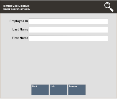

Oracle Retail Xstore Point of Service displays the Employee Lookup form, prompting for employee information. Enter the criteria you want to use for finding the employee payroll record you want to review and select Process.
Figure 7-5 Employee Lookup Form
If you enter an employee ID and Oracle Retail Xstore Point of Service finds it, the name is displayed in a list. Press Enter to continue.
If your search criteria produce more than one record, you must select the record you want from the list and press Enter.

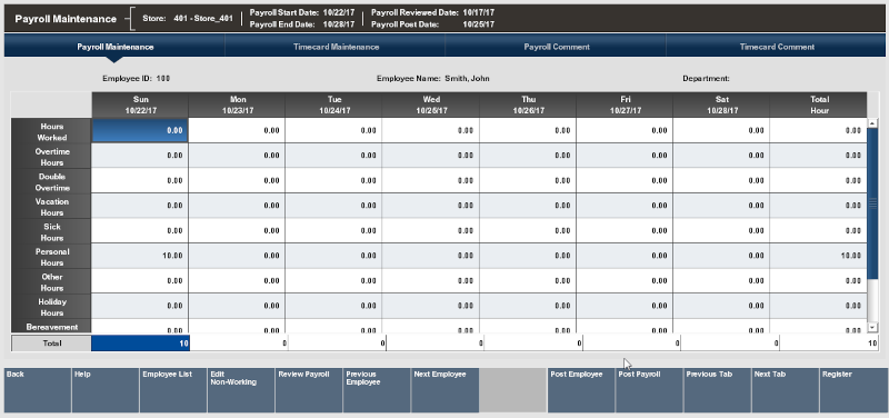

Use the Payroll Maintenance tab to verify and enter payroll hours for a selected payroll period. All payroll records should be reviewed manually and saved before the payroll finish date. This includes hours automatically fed to payroll from the timecard clock in/ clock out records. Posted payroll information is uploaded to the home office at closing.
You must find and display an employee payroll record for a specific payroll week so that you may view it or change it.
Figure 7-7 Payroll Maintenance Screen
The Payroll Maintenance tab shows the following information:
Employee information: Employee ID, name, and department.
The days of the week and the date for each day; for example, Sunday through Saturday.
Regular Hours Worked - These hours are determined from the timecard records and cannot be changed here. Refer to Editing a Timecard Record for more information on changing timecard records.
Overtime Hours - These hours are calculated automatically by the system, based on the overtime rules established by the home office. These hours cannot be changed here. Refer to Editing a Timecard Record for more information on changing timecard records.
Double Overtime Hours - These hours are calculated automatically by the system based on the overtime rules established by the home office. These hours cannot be changed here. Refer to Editing a Timecard Record for more information on changing timecard records.
Non-Working Hours Categories - These types of payroll hours can be edited in Payroll Maintenance using the Edit Non-Working Hours option. Examples of non-working hours include:
Vacation Hours
Sick Hours
Personal Hours
Other Hours
Holiday Hours
Bereavement Hours
Jury Hours
Funeral Hours
Total Hours - The total working hours for each category by day and by week.
Totals - The total hours by day and by week.
Refer to Editing a Payroll Record or information about editing non- working hours.
The following options are available from the Payroll Maintenance screen:

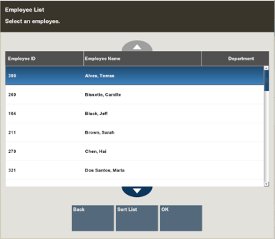

Select Employee List to see a list of active employees for the payroll week you are viewing.
Select Edit Non-Working to edit the hours for the non-working categories. Non- working categories include Vacation Hours, Sick Hours, Personal Hours, and Other Hours as determined by your store policy. Hours that are calculated from the timecard records cannot be edited through Payroll Maintenance. See Editing a Payroll Record.
Select Review Payroll after you have reviewed the employee's payroll record. This function adds a timestamp to the record along with your ID and the payroll record is now ready for posting to the home office.
Select Post Employee to post the employee's record to the home office.
Select Post Payroll to post all employees' records to the home office.
Select Previous Employee to move backward or Next Employee to move forward and view additional employee payroll records for the payroll week.

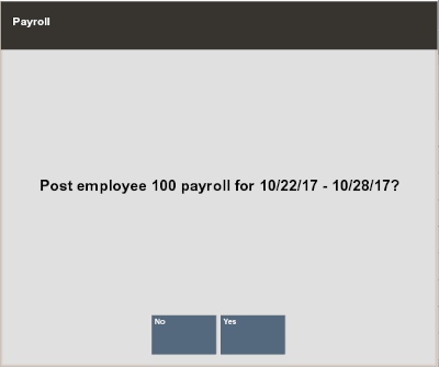

Posting the Employee's Payroll Record
After you have verified the information for an employee's payroll record and marked the record as reviewed, you can post the record to the home office.
You also have the option to post all employee payroll records at once. Refer to Posting all Employee Payroll Records at One Time for procedural information.
To post the employee's payroll record to the home office, select the Post Employee option.
Xstore Classic prompts to confirm the selection. Select Yes to post the employee's payroll record and Xstore Classic displays a message notifying you that the employee's payroll record has been posted.
If you have not marked this employee payroll record as reviewed before choosing to post the record, Xstore Classic displays a message asking if you want to post the record anyway.
Select Yes to post the record or select No to return to the Payroll Maintenance screen where you can review the payroll record.
Figure 7-10 Post Employee Payroll Record Confirmation Prompt

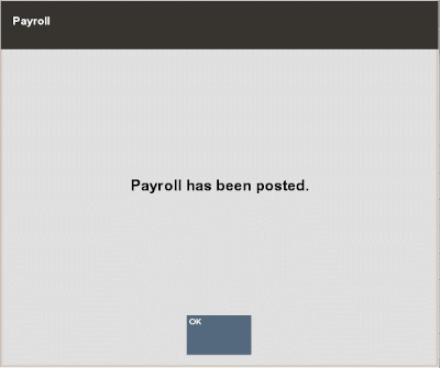

Press Enter to close the prompt: payroll has been posted. The Payroll Maintenance screen displays.
Xstore Classic marks the employee's payroll record as posted. This information is displayed in the information panel at the top of the Payroll Maintenance screen as shown below.
Figure 7-11 Payroll Posted Timestamp
Continue reviewing and posting additional employee records as needed by selecting the Previous Employee and Next Employee options.

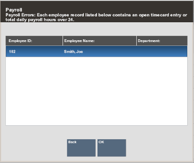

If the system identifies a payroll exception error (as determined by your store's policy) when you post an employee's payroll record, you are notified that a payroll exception exists.
If any payroll errors are found, select an employee from the list and press Enter to return to the employee's payroll record where you can review the record and make changes as required.
Figure 7-12 Payroll Errors at Posting

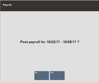

To post the entire payroll to the home office, select the Post Payroll option.
If the system identifies a payroll exception error (as determined by your store policy) when you post payroll records, you are notified that a payroll exception exists. See Figure 7-12
Figure 7-13 Post Payroll Confirmation Prompt
Select Yes to post the payroll to the home office.

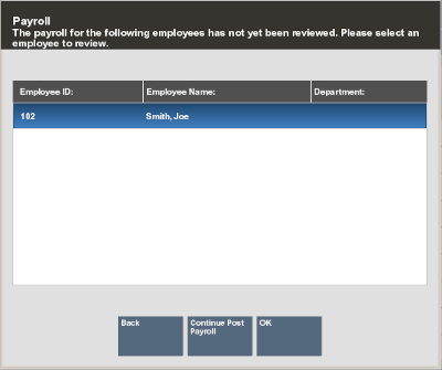

If any records have not been marked as reviewed, Xstore Classic displays a list of employee payroll records that require review.
To review a record, select the name on the list and then select OK to display the Payroll Maintenance screen where you can review the record.
<OR>
To post payroll to the home office without reviewing the records, select the Continue Post Payroll option.
Figure 7-14 List of Non-reviewed Employee Payroll Records

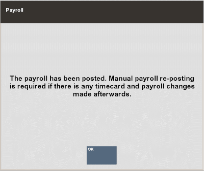

When payroll has been posted, Xstore Classic displays a message indicating that the records have been posted and marks all records with a timestamp for the posted date.
Figure 7-15 Payroll Posted Message

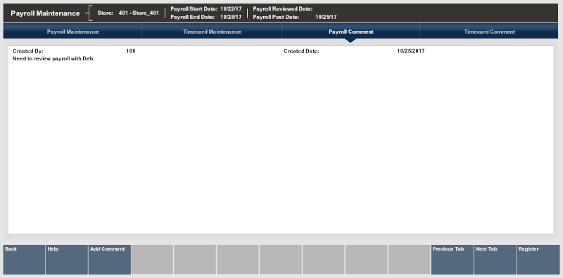

To view payroll record comments, use the Previous Tab and Next Tab options to navigate between the tabs on this screen and select the Payroll Comment tab.
Xstore Classic displays any comments associated with this payroll record. In addition to the text, the date the comment was added and the ID of the person who created the comment are also included.
Figure 7-18 Payroll Comments

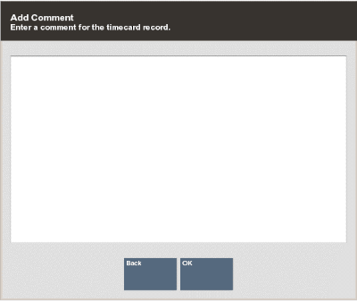

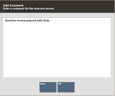

Adding Comments

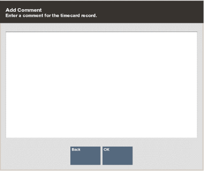

An option to add a new comment to this payroll record is also available. You can add additional comments to a record or add comments to a record that has no current comments associated with it.
To add a comment to the payroll record, select the Add Comment option (Figure 7-18 above). Xstore Classic displays the Add Comment form.
Type a comment and select OK to add the comment to the employee's payroll record.
Figure 7-19 Add Comment Prompt

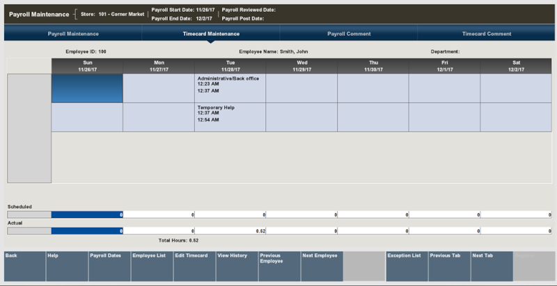

Timecard Maintenance Tab

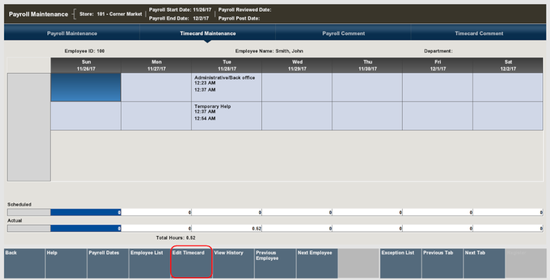

The Timecard Maintenance tab shows the following information:
Figure 7-20 Timecard Maintenance Tab
The week day order is configurable, so your beginning day of the week may differ from the first day shown here.
The work code and the times the employee clocked in and out for each work code.
If the employee uses multiple work codes while clocking in during the day, multiple entries display. For example, in Figure 7-20, on Monday, the employee worked on the selling floor (Cashier) and then worked in the Back Office (Admin).

The following menu options are available from the Timecard Maintenance screen:
Payroll Dates - Select this option to view the list of payroll dates. Select a new date from the list to view the selected employee's timecard record for the new payroll week.
Employee List - Select this option to view a list of active employees for the payroll week you are viewing.
Edit Timecard - Select this option to edit the timecard record.

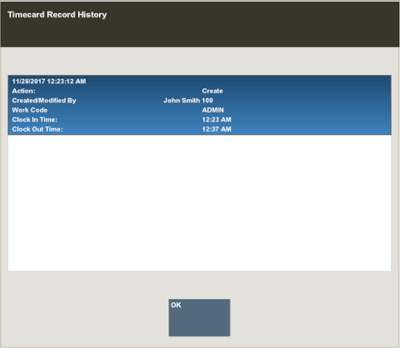

View History - Select this option to view the details about a specific timeclock record.
Previous Employee/Next Employee - Select these options to move backward/ forward to view additional employee timecard records for the payroll week.
Exception List - Select this option to view a list of employee records that have exceptions for this payroll week. Exception rules are set up by the home office.
Use the Previous Tab and the Next Tab menu options to navigate between the Timecard Maint tab and the Timecard Comment tab.

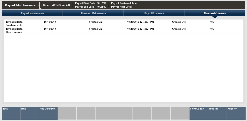

Timecard Comment Tab- Select this tab to view and/or add a comment.

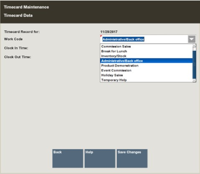

To change a timecard record, select the record that you want to change on the Timecard Maintenance screen and select the Edit Timecard option.
Figure 7-21 Timecard Maintenance Screen

Adding a Timecard Record
Select Edit Timecard.
Select the day to be edited and select Add Timecard.
Xstore Classic displays the Timecard Maintenance form. You must select a work code and enter the start time and end time for the timecard record.
Figure 7-22 Timecard Maintenance Form
Select the Save Changes option to create the new timecard record.
Depending upon your store policy, you may be prompted to enter a comment about the change to the timecard record. Type a comment and press Enter to continue.
Figure 7-23 Timecard Comment Form
The system prints receipts for your records and the record is added to the selected day.
Figure 7-24 Edit Timecard Record Receipt - Forgot to Clock In and Out
On the Timecard Maintenance screen, this record is preceded by an icon indicating that it has been modified and is not an original clock in/clock out record.
The system recalculates the actual hours worked for the day, the total hours worked for the week, and updates the timecard record accordingly.
Changing a Timecard Record
Select the day to be edited and select Change Timecard.
If no timecard exists for the day you are editing, select Add Timecard.
Xstore Classic displays the Timecard Maintenance form where you can change the work code and start time and end times for the timecard record. The data on the form defaults to the current record information for the selected day.
Figure 7-25 Timecard Maintenance Form - Timecard Record Insert
Make the changes as needed and then select the Save Changes option to replace the current timecard record with the edited timecard record.
Figure 7-26 Timecard Comment Form
The system prints receipts for your records and the edited record is updated for the selected day.
Figure 7-27 Edit Timecard Record Receipt - Forgot to Clock Out
This record is preceded by an icon indicating that it has been modified and is not an original clock in/clock out record. The system recalculates the actual hours worked for the day and the total hours worked for the week and updates the timecard record accordingly.

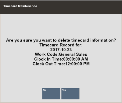

Deleting a Timecard Record
Select the day to be edited and select Delete Timecard.
Xstore Classic prompts to confirm that you want to delete the selected record. Select Yes to delete the record.
Figure 7-28 Delete Timecard Record Confirmation Prompt
Depending upon your store policy, you may be prompted to enter a comment for this change to the timecard record. If prompted, type a comment and select OK to continue.
The system prints receipts for your records.
Figure 7-29 Delete Timecard Record Receipt
The record for the selected date is deleted as indicated on the Timecard Maintenance screen.

Viewing Timecard Exception Records
Exception criteria are set up by the home office. For example, an exception may include employees who worked more than 14 hours per day or employees who worked less than 1 hour per day. Other exceptions include mismatched clock in/clock out records.
At the Timecard Maintenance screen, select the Exception List option.
Xstore Classic displays a list of employees with exceptions for the current payroll date. Select a name from the list and select OK to view the timecard record with the exception.
Figure 7-30 List of Employees with Timecard Exceptions
Xstore Classic displays the Timecard Maintenance tab for the selected employee:
To view the details about the exception, select the record and then select the View History option. Refer to Posted Timecard Report for more information.
To edit the exception record, select the record and then select the Edit Timecard option. Refer to Editing a Timecard Record for more information.
Viewing Timecard Record History
The timecard record history shows a list of all the activities for a specific record. This information includes the clock in and clock out times, the work codes, and any edits that pertain to the record.
To view the timecard record history, select the timecard record and then select the View History option at the Timecard Maintenance screen.
Xstore Classic displays the history for the selected timecard record.
Figure 7-31 Timecard Record History
Press Esc to return to the Timecard Maintenance screen.
To view timecard record comments, use the Previous Tab and Next Tab options to navigate to the Timecard Comment tab at the Timecard Maintenance screen.
Xstore Classic displays the comments associated with the current timecard record. In addition to the text of the comment, the comment's date and time of entry, and the ID of the person who created the comment are also shown.
Figure 7-32 Timecard Record Comments
Adding Comments
An option to add a new comment to this timecard record is also available at the Timecard Comment tab. You can add additional comments to a record or add comments to a record that has no current comments associated with it.
To add a comment to the timecard record, use the Previous Tab and Next Tab options to navigate to the Timecard Comment tab.
Select the Add Comment option (Figure 7-32 above).
Xstore Classic displays the Add Comment form. Type a comment and press Enter to add the comment to the timecard record.
Figure 7-33 Add Comment Form
The Payroll Summary Report shows all the hours displayed on the Payroll Maintenance screen for all active employees for a pay period.
This report includes the following information:
Employee Name/ID
Date/Weekday
Reg Hours - The regular hours worked, excluding overtime hours.
Over Time Hours - The overtime hours worked.
Double Time Hours - Overtime hours worked at a double pay rate.
Non-Working Hours - Non-working categories include Vacation Hours, Sick Hours, Personal Hours, and Other Hours as determined by your store policy.
Total Hours - The total hours worked for each employee and category.
Report Total Hours - The sum of all hours for all employees on the report.
Refer to the Oracle Retail Xstore Point of Service Reports Guide for details about this report.
Figure 7-34 Payroll Summary Report
The Payroll Detail By Employee Report shows a detailed breakdown for each employee's payroll record by day and payroll category. This report includes the following information:
Payroll Period
Regular Hours
Overtime Hours
Double-time Hours
Vacation Hours
Personal Hours
Sick Hours
Funeral Hours
Other Hours
Total Hours
The report also includes lines where employees may sign and date the printed report to indicate they reviewed the payroll information.
Figure 7-35 Payroll Detail By Employee Report
