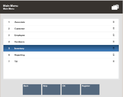

After logging in to the Back Office (see Accessing the Back Office), select the Inventory option from the Main Menu and press Enter.
Figure 23-1 Back Office Main Menu - Inventory Option
Instead of scrolling up or down the menu list to select an option, you can immediately access any option on the menu by pressing the number or letter associated with it on the keyboard (3=Employee, 5=Inventory, C= Customer, and so on).

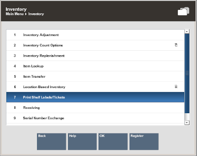

At the Inventory menu, select the Print Shelf Labels/Tickets option and press Enter.
Figure 23-2 Inventory Menu

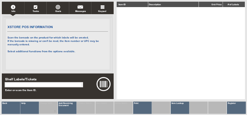

When prompted scan the barcode or manually enter the item Id and press Enter.
Figure 23-3 Item ID Prompt

Oracle Retail Xstore Point of Service adds each Item Id and number of labels to the View Port area of the screen. The item description and unit price are also shown.
Figure 23-5 View Port Displays Items Added for Labels

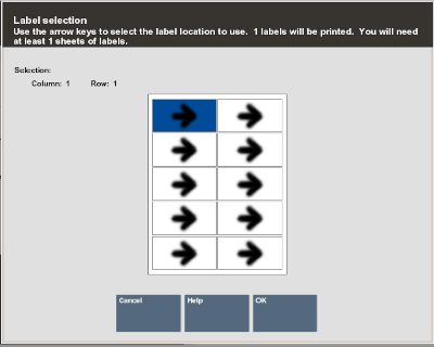

Oracle Retail Xstore Point of Service shows the number of label sheets you need and prompts you to select the location for the first printed label. Select the location for the first label and press Enter.
The column/row you selected is shown in the Selection area on the form. In Figure 23-7, Column: 1, Row: 1:
Figure 23-7 Label Location Prompt
Label location selection allows you to use partial sheets of labels to ensure that expensive labels are not wasted.

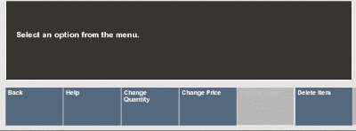

To Change an Item
Select Change Item to edit an item. The following options are available from the Change Item menu before you print labels for the items.
Figure 23-10 Change Item Options
Change Quantity: Select Change Quantity to change the number of labels to be printed.
Use the arrow keys to select the item and press Enter.
At the Enter Quantity prompt (see Figure 23-4), enter the number of labels you want to print for the item and press Enter.
Oracle Retail Xstore Point of Service updates the label quantity on the View Port for the item.
Change Price: Select Change Price to change the price that is printed on the label.
At the Enter Price prompt, enter the price of the item to be printed on the label and press Enter.
Figure 23-11 Enter Price Prompt
Oracle Retail Xstore Point of Service updates the label unit price on the View Port for the item.
Change Label - ZPL II ONLY Select Change Label to specify a different stock label type for the item.
Select the stock label type.
Select a processing option:
Select Process to associate the Stock Label type to the item.
<OR>
Select Assign To All to assign the selected Stock Label type to all items in the current list.
All items in the list print on the same label stock type. This selection does not update the pre-defined stock type of the items and does not apply to items that are added after the Assign To All option is selected.
Delete Item: Select Delete Item to remove an item from the list of item labels to be printed.
There is no confirmation prompt before deleting the item. Be sure you are highlighting the correct item in the View Port display area.
Oracle Retail Xstore Point of Service removes the item from the list of item labels to be printed.

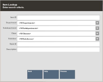

To Look Up an Item

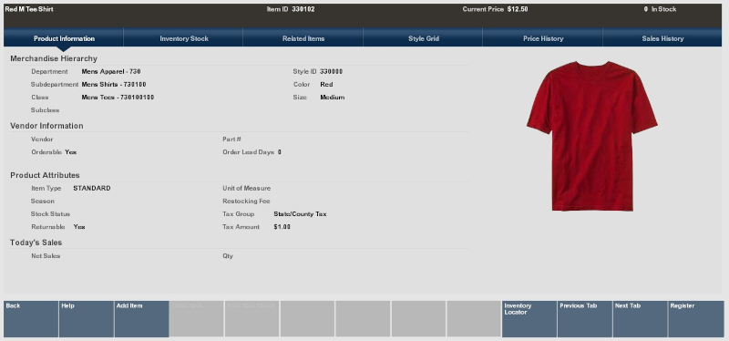

Item Lookup: Select Item Lookup to find an item using the item lookup search criteria form. The item can be added to the list of item labels to be printed.
At the Item Lookup form, enter the search criteria and select Process.
Figure 23-12 Item Lookup Form

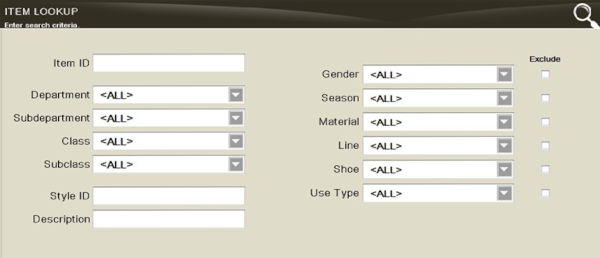

Your store may be configured with advanced lookup options, which provide the ability to add Custom Groups and Details to further define your search criteria. Select the exclude box to not include an item in your search.
If more than one item matched the search criteria you entered, select the item from the list and OK. Oracle Retail Xstore Point of Service displays the item information.
Select the Add Item option to include the item on the list of item labels to be printed.
Figure 23-13 Item Lookup Results - Add Item Option
Enter the number of labels to be printed for the item and press Enter to add the item to the list of item labels to be printed. By default, the on hand quantity for the item is shown in the Label Quantity focus bar prompt (Figure 23-4).

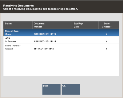

To Add a Receiving Document
Add Receiving Document: Select this option to print labels for all the items on a receiving document.

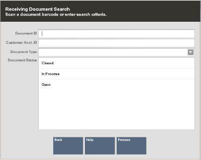

At the Document Search form, scan the barcode for the Receiving Document or enter search criteria to locate the Receiving Document.
Figure 23-14 Document Search Form
Oracle Retail Xstore Point of Service displays a list of receiving documents that match the criteria you entered. You may need to scroll through the list if multiple documents are displayed.
Figure 23-15 List of Receiving Documents
Select the receiving document that has the items that need labels and choose OK. Oracle Retail Xstore Point of Service adds all of the items on the Receiving Document to the list of item labels to be printed and displays them in the View Port area of the screen.
By default, a label will be printed for each item/quantity in the shipment. Use the Change Quantity option to edit the number of labels to be printed.
