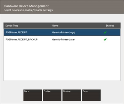

This option provides a way to temporarily disable and then enable hardware devices. This process writes out a hardwareconfig.xml file to a patch directory for the devices that have been disabled, reloads the hardware configurations, and then re-initializes the hardware.
To begin, select the /Disable/Enable Hardware option from the System Admin menu.
Figure 25-1 Hardware Device Management
The green check mark next to the device name indicates the device is currently enabled. The red cross next to the device name indicates the device is currently disabled.
To disable a device or devices, select a hardware device or devices to be disabled, then select Disable
Select Save. The hardware devices are disabled.
To enable a device or devices, select a hardware device or devices to be enabled, then select Enable.
Select Save. The hardware devices are enabled.
If there are any device errors detected when enabling a device, the system displays a warning message about the non- functional devices.Reinitialize Hardware

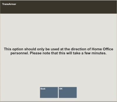

Update PINpad Key (TransArmor)
If your store is using TransArmor for credit card authorizations, use the Update PINpad Key option to advance the Device Derivation Key (DDK) when needed.
Figure 25-2 System Admin Menu
Select the Update PINpad Key option from the System Admin menu.
Figure 25-3 Warning Prompt
A warning prompt displays indicating that this option should only be used at the direction of the Home Office. Select OK to proceed or press Enter to return to the main menu.
If the update is successful, Xstore Classic prompts: PINpad device key is successfully updated.
If the update is not successful, Xstore Classic prompts: PINpad is no longer usable because the device key update was not successful. Call the Help Desk.

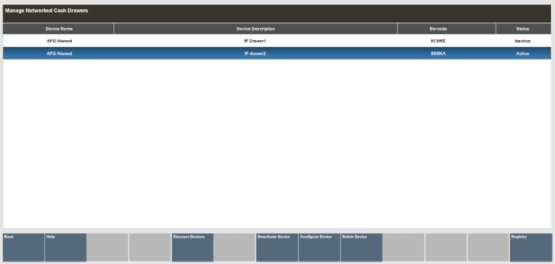

Networked Cash Drawers
This section describes the networked cash drawers:
Managing Networked Cash Drawers
When working with Xstore Mobile devices, networked cash drawers allow monies to be collected.

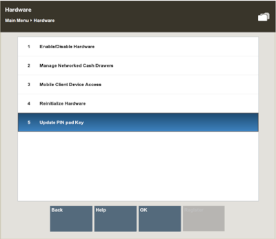

Select the Manage Hardware option from the Back Office Main Menu.
Select the Managed Networked Cash Drawers option from the list.
Figure 25-4 Manage Hardware Screen - Manage Networked Cash Drawers
Upon navigating to the screen, a discovery is performed to identify all networked cash drawers on the network.
A list of all discovered networked cash drawers is displayed.
Figure 25-5 Example List of Discovered Networked Cash Drawers
The status of the cash drawer may be:
New - Configuration has not been entered.
Active - The cash drawer is available to use.
Inactive - The cash drawer is not available to use.
Reset - Restored to factory settings and configuration needs to be entered.
Select a cash drawer from the list.
You can Activate and Deactivate cash drawers by selecting the correlating button. The Activate button changes the status to ACTIVE. The Deactivate changes the status to INACTIVE.
You can delete the cash drawer from the Database by selecting the Delete Device button. Use the Discover Devices button to find new networked cash drawers on the network.
The Activate, Deactivate, Delete and Configure activities are controlled by user security. An employee must have the proper security privileges to use these buttons.

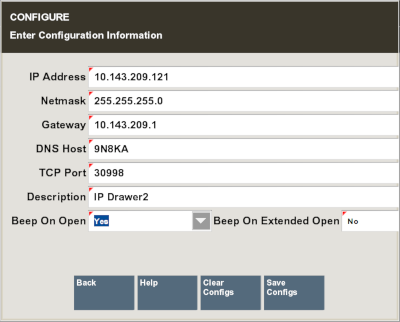

Configuring Networked Cash Drawers
Select the Configure Button on the Manage Networked Cash Drawers screen.
Figure 25-6 Configure Screen
Enter the required data to configure the screen. If the drawer is an existing drawer, the configurable values will be shown with the option to change the values.
Select the Save Configs button to apply the changes to the Configure screen. You are returned to the Manage Networked Cash Drawers screen.
You can clear all configurations by selecting the Clear Configs button.

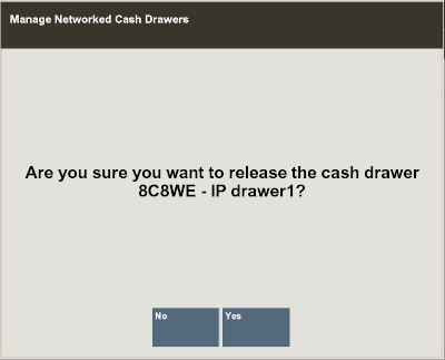

Releasing a Cash Drawer
On occasions when the cash drawer cannot be opened (maybe due to a network loss), it is possible to manually release the cash drawer in-use and allow other users to use them.
Ensure there is no current transaction taking place prior to using this process.
Navigate to the Manage Networked Cash Drawers screen.
Figure 25-7 Manage Network Cash Drawers Screen
Select the in-use cash drawer from the list of cash drawers.
Select the Release Device button.
The Release Device button is controlled by user security. An employee must have the proper security privileges to release the cash drawer.
Confirm you want to release the cash drawer: "Are you sure you want to release the cash drawer <cash drawer id and name>?"
Figure 25-8 Release Device Confirmation
Select Yes on this prompt, to continue.
The cash drawer is manually released from being in-use and is available to use again.

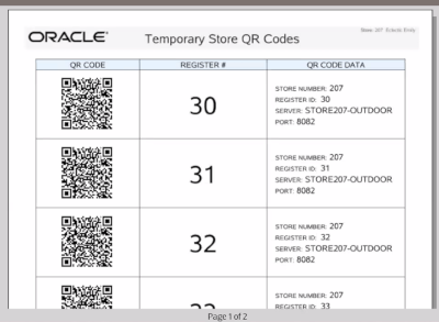

Once approved, you can generate a report to show QR codes. The QR code can be scanned to quickly set up mobile devices that will be used at the temporary store.
View/Print QR Codes
When a temporary store request has been approved by the home office, you can access the QR codes for setting up mobile devices to be used at the temporary store.
To view/print QR codes:
Select System Admin from the Main Menu.
Click Temporary Store in the System Admin menu. A list of requests for that store within the last year is displayed.
Select an Approved request.
Select View/Print QR Codes.
Figure 25-10 Temporary Store QR Codes
A Register Range screen appears. Enter the register range to print the QR Codes
