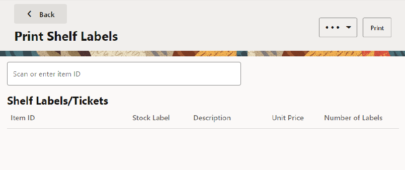

  2. At the Inventory menu, select the Print Shelf Labels option.
  3. When prompted scan the barcode or manually enter the item ID.

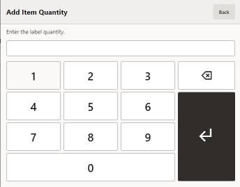

    When prompted for the number of labels you want to print for this item, type the quantity and select OK.
    Figure 49-3 Label Quantity Prompt
    By default, the system displays the number of items in your on hand inventory.

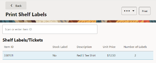

  5. Xstore POS adds each Item ID and number of labels, the item description and unit price are also shown.
    Figure 49-4 View Port Displays Items Added for Labels
    Select a row to bring up options available To Change an Item.

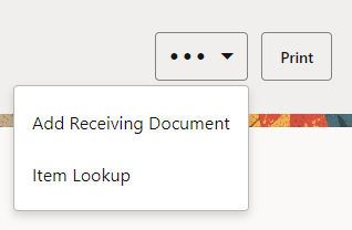

    Figure 49-6 Print Shelf Label Overflow Menu
    Print Shelf Label Context Menu
    Select the Context Menu to:

To Change an Item
Select the item to edit it. The following options are available from the Change Item menu before you print labels for the items.
Figure 49-10 Item Modifiers
Item Modifiers
Change Quantity
Select Change Quantity to change the number of labels to be printed.
  1. Select the item.
  2. At the Enter Quantity prompt (see Figure 49-3), enter the number of labels you want to print for the item.
Xstore POS updates the label quantity on the View Port for the item.

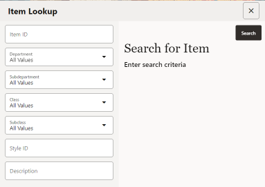

To Look Up an Item
  1. Select Item Lookup from the Overflow Menu to find an item using the item lookup search criteria form. The item can be added to the list of item labels to be printed.
    • At the Item Lookup form, enter the search criteria and select Search.
      Figure 49-12 Item Lookup Form
      Item Lookup Form
    • If more than one item matched the search criteria you entered, select an item. Xstore POS displays the item information.
    • Select Add Item to include the item on the list of item labels to be printed. If configured, select Exit to Scan to scan the item to add it.
  2. Enter the number of labels to be printed for the item and select Return to add the item to the list of item labels to be printed. By default, the on-hand quantity for the item is shown in the Label Quantity focus bar prompt.

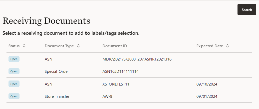

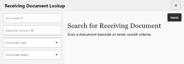

To Add a Receiving Document
  1. Select Add Receiving Document from the Context Menu to print labels for all the items on a receiving document.
    • At the Document Search form, scan the barcode for the Receiving Document or enter search criteria to locate the Receiving Document.
      Figure 49-13 Document Search Form
      Xstore POS displays a list of receiving documents that match the criteria you entered. You may need to scroll through the list if multiple documents are displayed.
      Figure 49-14 List of Receiving Documents
  2. Select the receiving document that has the items that need labels. Xstore POS adds all of the items on the Receiving Document to the list of item labels to be printed and displays them in the View Port area of the screen.
    By default, a label will be printed for each item/quantity in the shipment. Use the Change Quantity option to edit the number of labels to be printed.
