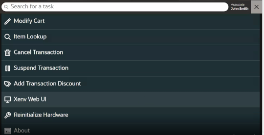

3 Associate Functions
Occasionally a customer issue needs resolving at the register during a sale. This may be to verify the sale of age restricted items, change price to match a competitor, to cancel an item or sale, or to suspend a transaction.
The associate function is also required when reprinting a receipt, opening/closing and activating/deactivating the Self Checkout register.
The options displayed on the Associate menu, when logging on, depends on whether the Self Checkout is already in the middle of a transaction.
Scanning of items to add to cart are not supported from this menu - only upon performing an item lookup can an item be added by an associate.
Figure 3-1 Associate Menu During Transaction
Selecting the X in the top right corner, exits the associate menu and returns the Self Checkout to the customer view.
The following section describes the functions and options available with associate access:

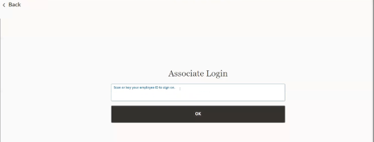

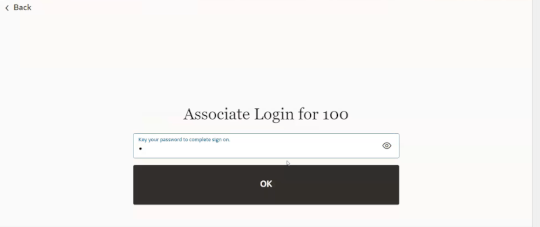

Associate Login
To gain access to the associate functions, login is required.
Select Associate Login.
Figure 3-2 Associate Login
Scan your badge or enter your employee ID and select OK.
Figure 3-3 Associate Login Password
Enter your Password.
Select Process.

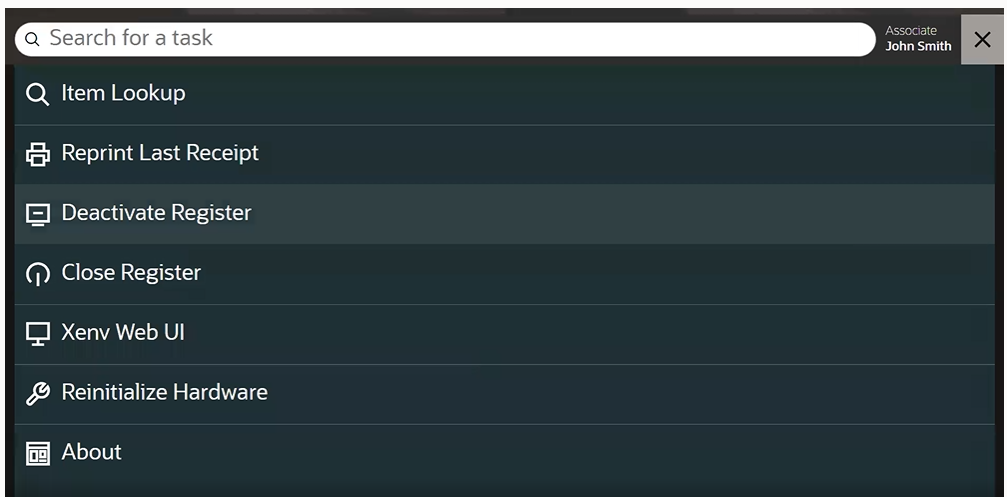

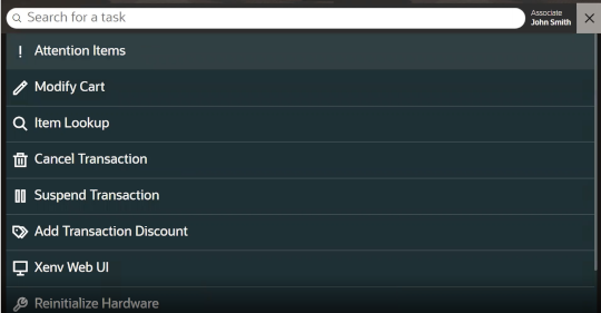

The Associate menu is displayed and the logged in associate's name displays in the upper right corner.
Figure 3-4 Associate Menu
Selecting the X in the upper right hand corner exits this menu to return to the customer shopping cart.
The menu options displayed depend on if you accessed these functions during a transaction and permissions of the logged in associate. Select an option from the menu or type in the search field to search for a task.

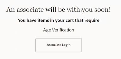

Age Restricted Items
Certain items, such as alcohol, medicines, glues and solvents, and so on, that are age restricted cannot be purchased until the age of the customer is verified by an associate. When an age restricted item is scanned, a warning message is displayed, and the associate alerted.
Figure 3-5 Age Verification Prompt
The associate must log in to verify the date of birth of the customer. The customer can keep scanning items but they will not be allowed to checkout until their age is verified.
If the Finish and Pay button is pressed, the following message is shown:
Figure 3-6 Age Verification Prompt at Checkout
Log in as an associate. See Associate Login.

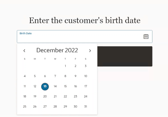

Figure 3-7 Customer Age Verification
Enter the customer’s birth date using the date picker and select OK.

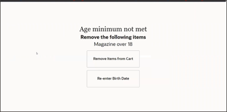

If the age requirement is not met, a prompt appears with two choices:Figure 3-8 Age Minimum Not Met
Re-Enter Birth Date - Click to re-enter the birth date if an incorrect date is entered on the first attempt.
Remove Items from Cart - Click Remove Items from Cart if the minimum age is not met, the items must be removed from the cart.
If the age requirement is met further age restricted items that require same age or less, are automatically added to the basket.
A warning message is displayed if the items are removed from the cart.
Figure 3-9 Items Removed Prompt

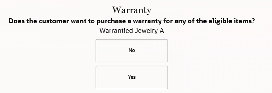

Warrantied Items
A warranty (also known as a service plan) is a promise made by a manufacturer or seller to support a product after its purchase. Typically, this involves the purchase of a contract that covers the costs of parts and service on an item beyond the manufacturer's original warranty period.
When you sell an item that is eligible for a warranty or service plan, the system requires an associate to intervene.
Warranties are available from a traditional register. The self checkout system will require an associate to confirm with the customer if they would like to purchase a warranty from a traditional register or continue on the Self Checkout without a warranty.
Figure 3-10 Warranty Item

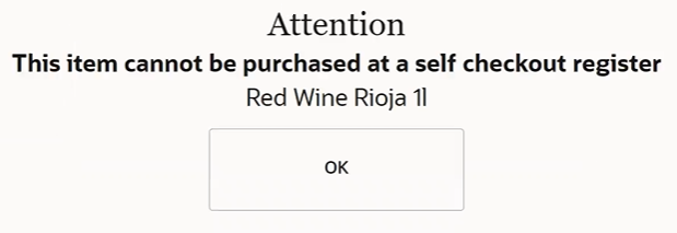

Non Purchaseable Items
A retailer may configure items that cannot be sold at a Self Checkout for example lottery tickets.
Figure 3-11 Non Purchaseable Item
Explain the reason why the item cannot be sold and remove the item from the shopping cart.

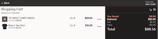

Modify Cart
Associates can change certain elements about the items in a cart such as quantity or price or add a discount or void an item.
The associate view of the customer shopping cart allows an associate to modify the items in the cart. To scan more items into the customer cart or to tender the transaction the associate must return to the menu and exit the menu to return customer's view of the shopping cart where additional items can be scanned and tendering can take place.
To access the associate view of the shopping cart, from the Associate Menu select Modify Cart.
Figure 3-13 Associate Menu During Transaction
Figure 3-14 Associate View of Cart
Figure 3-15 Modify Item Menu

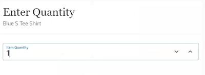

Change Quantity
From the Line Item menu, select Change Quantity.
Figure 3-16 Enter Item Quantity
Use the arrows to enter a new quantity and click OK.
The quantity and price fields are updated.

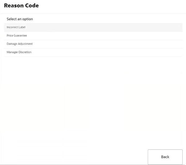

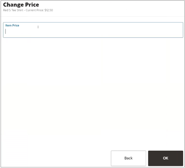

Change Price
From the Modify Item menu, select Change Price.
Figure 3-17 Change Item Price
Enter a new price and click OK.

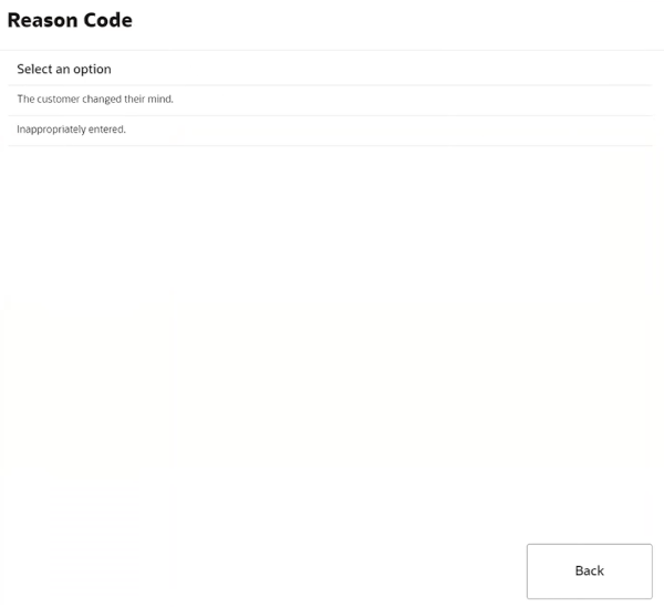

Figure 3-18 Change Price Reason Code
Select a reason code for the price change.

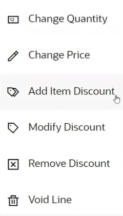

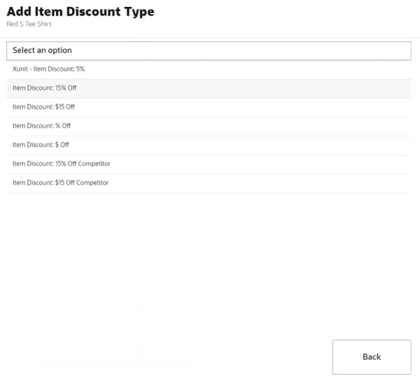

Add Item Discount
An associate can apply a discount to a single line item or multiple line items. Discounts may be specified as either an amount (for example, $5.00 off) or a percentage (for example, 10% off) for item discounts. If an associate wants to perform a transaction discount (on all items in the cart) they would need to go to the menu and select Add Transaction Discount.
An item discount will need to be done one item at a time not multiple lines at one time.
From the Modify Item menu for the desired item, select Add Item Discount.
Figure 3-19 Discount Type Options
A list of discount types is shown.
The discounts available depend upon the configuration of your system.
If necessary, enter the discount information:
Percent Discount - Enter the percentage of the discount.
Amount Discount - Enter the amount of the discount.

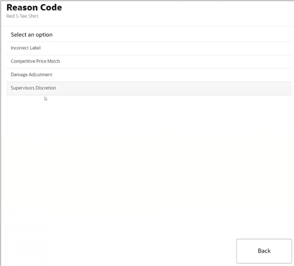

Figure 3-20 Discount Reason Code
Select a reason.
The discount is applied to the item and badge showing the discount is shown underneath the unit price for the line item.

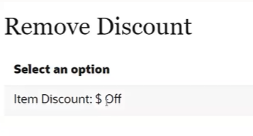

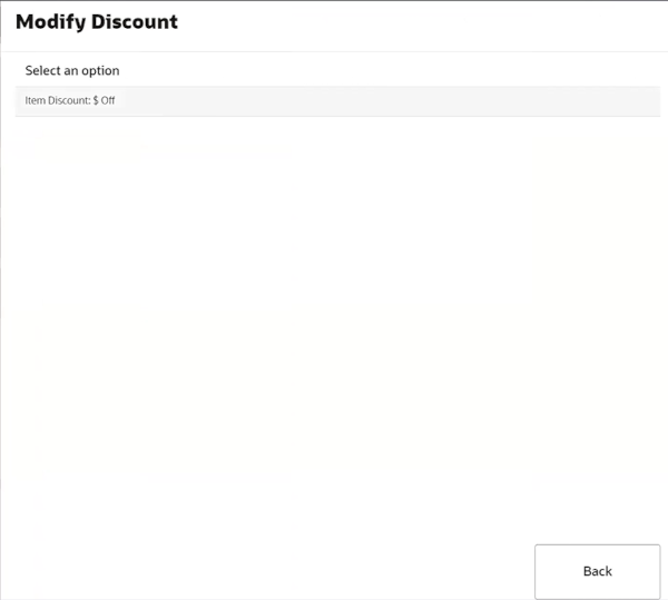

Modify Discount
From the Line Item menu, select Modify Discount.
Figure 3-21 Modify Discount
Select the discount to modify.
Select an alternative discount type.
Select a reason code.
Back will take the associate to the associate view of the shopping cart.

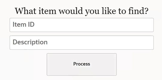

Item Lookup
Item Lookup is available for logged in associates to quickly find an item that may be failing to scan, or the barcode is missing. Although the customer can perform an item lookup by an item ID, the associate has an additional description field to find the item.
From the associate menu, select Item Lookup.
Figure 3-24 Associate Item Lookup
Enter search criteria (item ID or description) and select Process to search for items.
Select item from the results list and the item is added to the basket. Items that are not available for Self Checkout cannot be added to the basket.

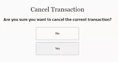

Cancel Transaction
The Self Checkout sale may need to be cancelled if the customer changes their mind about their purchase.
To cancel a sale:
From the Associate menu, select Cancel Transaction.
Figure 3-26 Cancel Transaction
Select Yes.
Self Checkout cancels the transaction and returns to the main Self Checkout start screen.

Figure 3-28 Transaction Discount Reason Code
Select the reason for applying the discount.

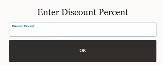

Figure 3-29 Transaction Discount Percent
If the discount is not fixed, enter the amount or percentage of the discount.
Select OK. The discount is applied to the transaction. Return to the sale screen.

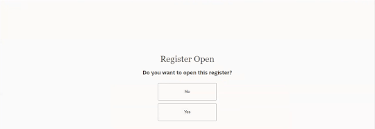

Open Register
Figure 3-31 Activate Register
To open a Self Checkout register for customer use:
An associate needs to press Activate Register button.
Scan your badge or enter your employee ID and selectOK.
The Register Open prompt is displayed.
Figure 3-32 Open Register Prompt
There is no cash taken on the Self Checkout so no need for a count process for opening a Self Checkout register.
- Select Yes to open the register.
The Self Checkout opens to the Home screen ready for use.

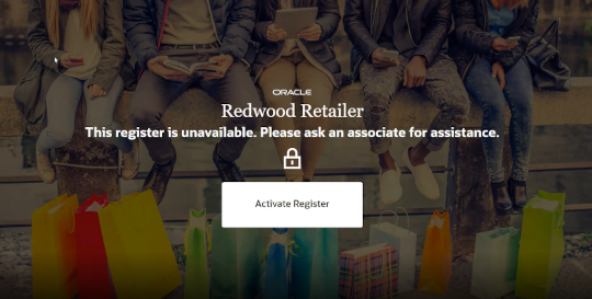

Deactivate Register
A Self Checkout register can be deactivated (locked) so that it is not available for customers to use. This may be due to the self checkout lane not being ready for customers due to requiring cleaning or no bags available, issues with the Self Checkout printer or payment terminal, quiet times, or the store just wants customers to use manned Self Checkout registers for a period. The register cannot be locked when in a Self Checkout sale.
This process can only be done by an associate, and not a customer.
To deactivate a register from customer use:
Figure 3-36 Deactivate Register
Select Deactivate Register from the associate menu. The Self Checkout closes and returns to the Activate Register screen
Figure 3-37 Activate Register
A message regarding the register is unavailable is shown to the customer.

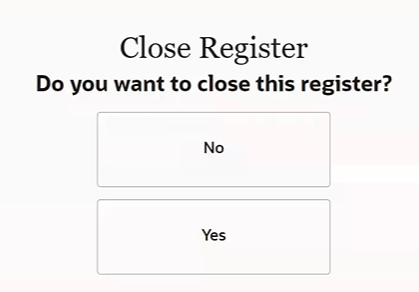

Close Register
Figure 3-38 Close Register
To close a register:
Select Close Register from the associate menu.
Figure 3-39 Close Register
Select Yes. The Self Checkout closes and returns to the Activate Register screen. The Self Checkout register is closed for use until the register is opened again.

Xenv Web UI
Figure 3-41 Associate Menu

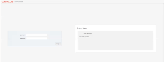

Select Xenv Web UI from the associate menu to launch the Xenvironment web User Interface (UI).
Figure 3-42 Xenv Web UI

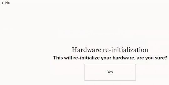

Reintialize Hardware
Occasionally, the peripheral hardware devices must be reset.
Select Reintialize Hardware from the associate menu.
Figure 3-43 Reinitialize Hardware
Select Yes. When complete, the associate menu is shown.

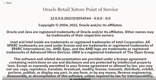

About
The About screen displays the copyright, the version, and legal disclaimer of Self Checkout being used.
To view this information:
Select About from the associate menu.
Figure 3-44 About Page
Select Back to return to the associate menu.
