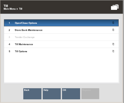

Select Till.
Figure 25-4 Till Menu Options
Select Open/Close Options.

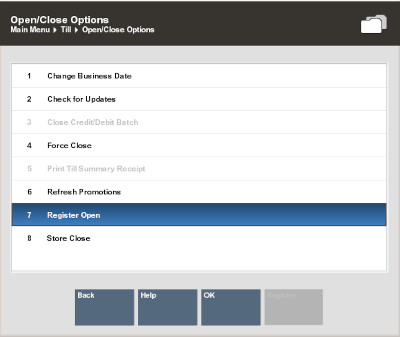

The Open/Close Options menu opens.
Figure 25-5 Open/Close Options Menu

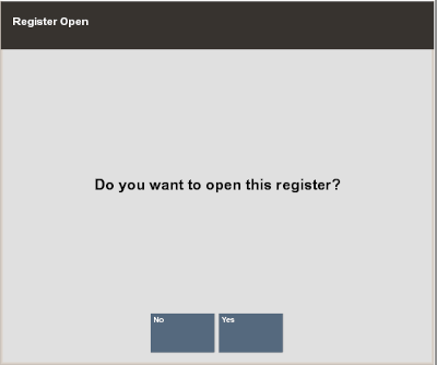

Select Register Open.
Select OK.
A confirmation prompt opens.
Figure 25-6 Open Register Prompt
Select Yes.

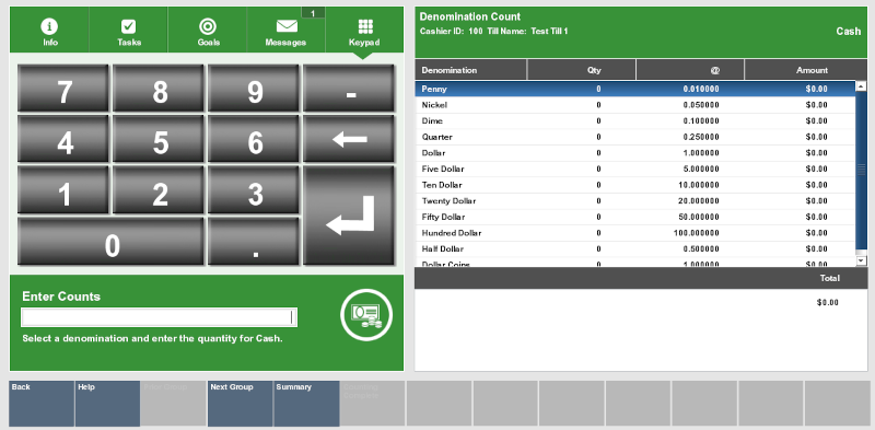

A list of currency denominations opens.
Figure 25-8 Denomination Count - Cash
Count a denomination currency.
Select the denomination in the View Port.
Enter the count of the currency denomination in the Focus Bar and press Enter.
Select Summary.

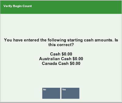

Check the Over/Short column to see if your till is balanced with the system values for each tender type.
Figure 25-9 Verify Begin Count Prompt

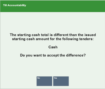

If the starting cash amount matches, the system prompts to confirm the amount for all cash currencies you entered and opens the register after you acknowledge the system amount. Continue with Step 13.
Figure 25-10 Starting Cash Difference Prompt
If the currency amounts do not match, the system displays a prompt to either recount the till or to accept the difference. Continue with Step 14.
Click Yes.
The register opens. Receipts for the register open may print.
Do one of the following:
Click Yes to continue opening.
Click No to return to the count screen. Return to Step 11.

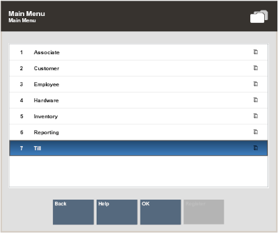

Figure 25-19 Back Office Main Menu
Select Till.

Figure 25-23 Back Office Main Menu
Select Till.
Figure 25-24 Till Menu Options

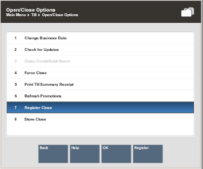

Figure 25-25 Open/Close Options
Select Register Close.
Select OK.

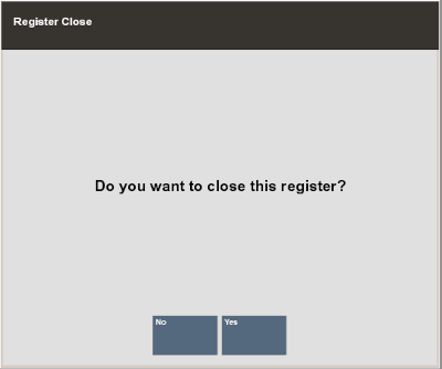

Figure 25-26 Close Register Prompt
Select Yes.

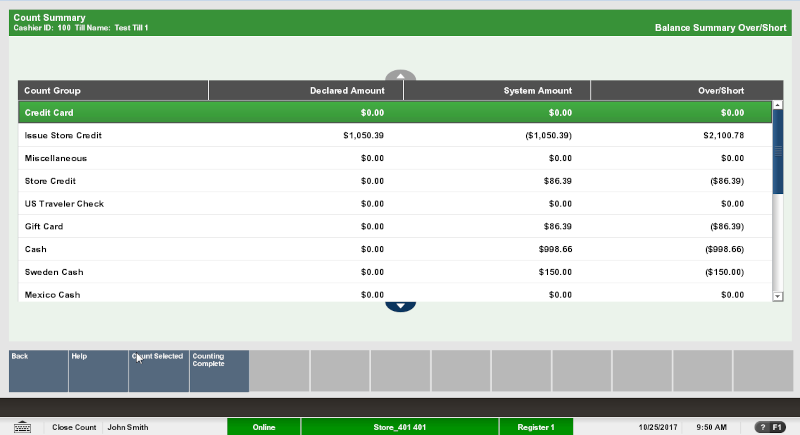

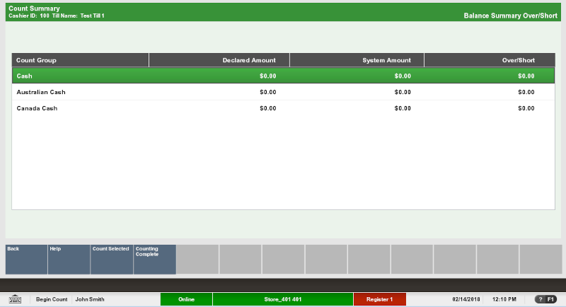

The cash drawer opens, and Xstore Point of Service displays the Close Count Summary screen. Each count group (tender type) is counted individually.
Figure 25-27 Close Count Summary Screen
Count the cash tenders:
Click the tender to count.
Click Count Selected.
Count a currency denomination.
Click the denomination in the View Port.
Click Summary.
Xstore Point of Service returns to the tender list.

Click Counting Complete when all counts are completed.

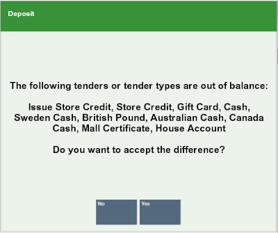

If the cash amount matches, the system prompts to confirm the amount for all cash currencies you entered and closes the register after you acknowledge the system amount. Continue with Step 15.
Figure 25-28 Tenders Out of Balance Prompt
If the currency amounts do not match, the system displays a prompt to either recount the till or to accept the difference. Continue with Step 16.
Click Yes.

The Back Office Main Menu opens.
Figure 25-31 Back Office Main Menu
Select Till.
Figure 25-32 Till Menu Options
Select OK.
Figure 25-33 Open/Close Options
Select OK.
Figure 25-34 Close Register Prompt
Select Yes.

You may be prompted whether to open the register.
If necessary, indicate whether to open the register:
Click Yes to open the register. See 24/7 Open for the open procedure.
Click No to keep the register closed.

The physical cash drawer opens, and Xstore Point of Service displays the Close Count Summary screen. Each count group (tender type) is counted individually.
Click the cash tender to count.
Click Summary.
If the starting cash amount matches, the system prompts to confirm the amount for all cash currencies you entered and closes the register after you acknowledge the system amount. Continue with Step 17.
If the currency amounts do not match, the system displays a prompt to either recount the till or to accept the difference Continue with Step 18.
Click Yes.
The register closes. Receipts for the register close may print.
