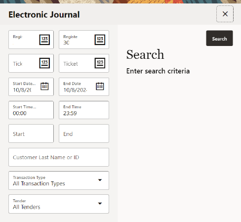

  1. At the Reporting menu, select Electronic Journal.
    Figure 40-2 Electronic Journal Transaction Search
  2. The system displays the Transaction Search form. Enter your search criteria and select Process.
    Depending on your store's configuration, a Check Account Number search field displays as well as a Read Check from MICR button.
    The following search parameters are available:
    • Register Number: Enter the identifier for a specific register, a range of registers, or leave these fields blank to view information for all registers.
    • Ticket Number: Enter a transaction identifier for a specific transaction, a range of transactions, or leave these fields blank to view information for all transactions.
    • Date/Time: Enter a start date and time, an end date and time, or accept the default for today.
    • Cashier ID: Enter the identifier for a specific associate, a range of associates, or leave these fields blank to view information for all associates.
    • Customer: Enter a customer name or number to view information about a specific customer.
    • Transaction Type: Select a transaction type from the list or select ALL to view all transaction types. Transaction types include options such as TIME CLOCK, NO SALE, RETAIL SALE, POST VOID, and so on.
    • Tender: Select a tender type from the list or select ALL to view all tender types. Tender types include options such as Store Credit, Cash, Check, and so on.
    • Credit Card Number: Enter the credit card number used for a transaction.

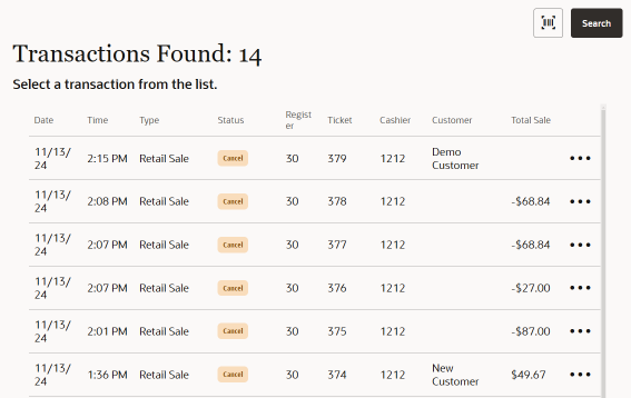

      Oracle Retail Xstore POS displays the Electronic Journal screen.

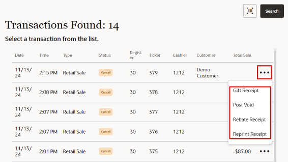

      Selecting a row from the electronic journal report presents you with a popup menu of options (gift receipt, post void, rebate receipt, reprint receipt, view detail).
      Figure 40-4 Electronic Journal Options Menu
      The following options are available at this screen:
      • Gift Receipt: Select this option to print a gift receipt for the selected transaction. Refer to Printing a Gift Receipt for more information.
      • Invoice Functions: Select this option to issue or reprint a tax-free invoice.
      • Post Void: Select this option to post void the selected transaction. Refer to Post Voiding a Transaction for more information.
      • Rebate Receipt: Select this option to print a Rebate Authorization receipt. Refer to Printing a Rebate Receipt for more information.
      • Reprint Receipt: Select this option to reprint a receipt for the selected transaction. The receipt is clearly labeled as a reprint. Refer to Reprinting a Receipt for more information.

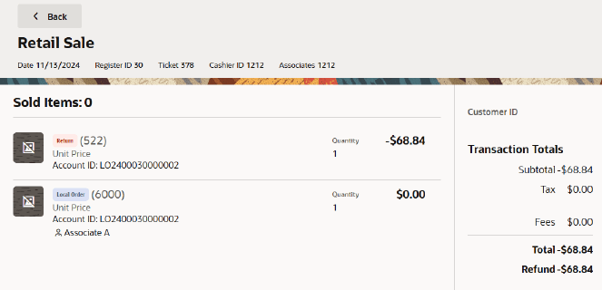

Viewing Transaction Detail
The detail information shown is specific to each transaction type. For example, a Time Clock journal includes the Associate number and name, Clock In or Clock Out, and the time. A Post Void journal includes the Original Transaction Location ID, Register ID, and Business Date.
Select a Transaction record .
Oracle Retail Xstore POS displays the Electronic Journal transaction detail screen for the selected record.
Figure 40-6 Electronic Journal View Detail
The detail information for a RETAIL SALE transaction, (sale, return, send sale, special order, layaway, order, and so on) includes the following data:
  • Item Detail: Quantity, item ID, description, discounts, price, and the extended price for each item
  • Tender Detail: Tender types and amount of each type
  • Totals: Subtotal, fees, tax, and totals as shown on the original receipt

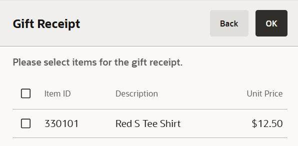

  1. With the transaction record selected, select Gift Receipt from the Electronic Journal Options menu. See Figure 40-4.
    Oracle Retail Xstore POS displays a list of items in the transaction that are eligible for a gift receipt. Select an item to mark it for a gift receipt. You may use the Select All option to print gift receipts for all the listed items.
    Figure 40-7 Electronic Journal Gift Receipt Items
    If there are multiple items that have been labeled as requiring a gift receipt, you may be prompted whether the items should be grouped on separate gift receipts. For example, 2 items on one receipt, and 3 items on another receipt.
    See Multiple Gift Items - Grouping Items for Gift Receipts.
  2. Select OK to continue.
  3. Oracle Retail Xstore POS prints the gift receipt(s) for the selected item(s).
    The items that you issued a gift receipt for are now labeled with the Gift icon.

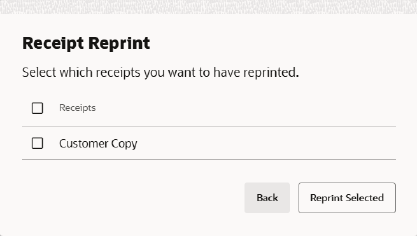

If you need to print the last receipt you can select Reprint Last Receipt from the Home Screen menu. See Reprint Last Receipt.
  1. Select the Row Overflow Menu for any transaction record, then select Reprint Receipt.
    Figure 40-8 Receipt Reprint
    Receipt Reprint
  2. Select which receipts you want printed.
  3. Select Reprint Selected or Back.
    Xstore POS reprints the document on the report printer.

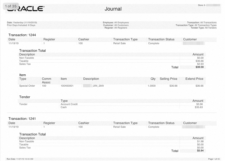

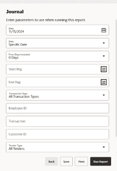

Journal Report
To run the Journal report:
  1. After logging in, select Reporting from Global Navigation.
  2. Select Sales Reports from the reporting menu.
  3. Select Journal from the Sales Reports menu.
    Figure 40-9 Journal Report Parameters
  4. Enter parameters required and select one of the options:
    • Save
    • Print
    • Run Report

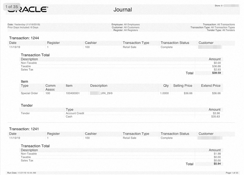

The Journal Report shows detailed transaction information exactly as it was rung. Data can be displayed for an individual associate or for all employees, or for transaction codes, transaction line codes, and tender codes. Transactions are sorted by date, register number, and transaction number.
Figure 40-10 Journal Report
Journal Report
This report includes the following information:
  • Transaction Type
  • Register ID
  • Business Date
  • Total
  • Cashier
  • Transaction ID
  • Customer Name
  • Status
Item section: Commissioned Employee ID, Item ID, Description, Quantity, Unit Price, and Extended Price
Tender section: Taxable Amount, Non Taxable Amount, Sales Tax, Total, and Tender Type
Refer to the Oracle Retail Xstore Point of Service Reports Guide for details about this report.
