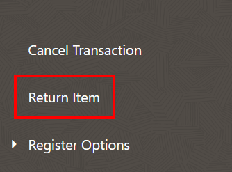

If you select the Return Item menu option from the Sales screen. See Figure 1-3, perform the following steps to create a verified return.
Figure 5-1 Return Item

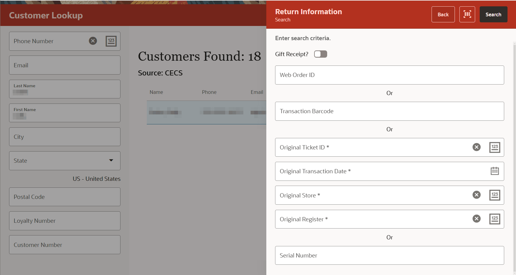

  3. The system displays a prompt asking for the original transaction information for the return item. Scan the transaction barcode on the receipt, or manually enter the required receipt information and select Search to continue.
    Figure 5-4 Original Transaction Return Information - HandheldOriginal Transaction Return Information - Handheld
    Figure 5-5 Original Transaction Return Information
