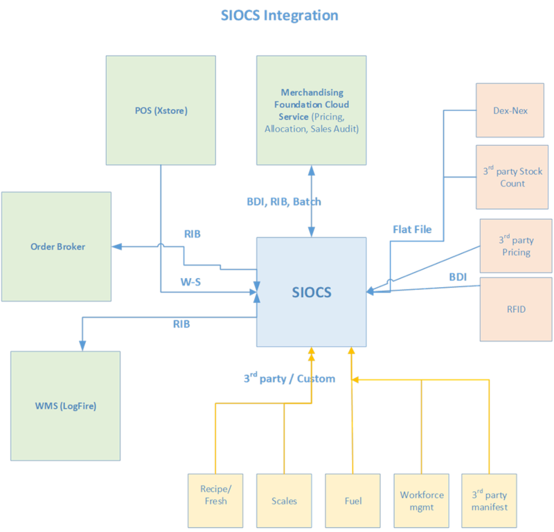

Overall Integration Touchpoints
Figure 8-1 Overall Integration Touchpoints
Overall Integration touchpoints
Retail Integration Cloud Service (RICS) - based Integration
RICS is a platform containing RIB and BDI.

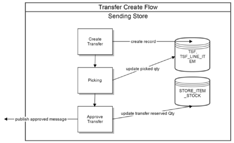

Transfer Creation
Transfer documents can be created in the following ways:
  • Requesting store can create a transfer request.
  • Sending store can initiate a transfer by creating a transfer.
  • Merchandising can create a transfer request.
Each transfer document will have one or more items.
Transfer Messages
EICS will publish messages to Merchandising when the following happen:
  • Transfer is rejected.
  • Transfer is approved.
  • Transfer quantity is updated from the shipment.

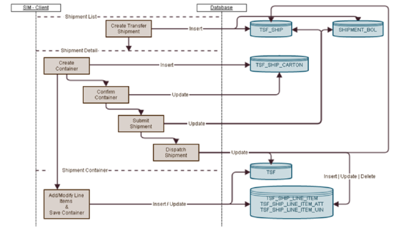

Transfer Shipment Creation
Transfer Shipment describes the containers and the items for the shipment taking place. The shipment may be for one or more transfer documents if the transfer is going to the same destination. Dispatching a shipment will update the transfer document.
The user can create a shipment without referencing existing transfers or can create a new transfer on fly (Ad hoc transfer) based on the shipment information.

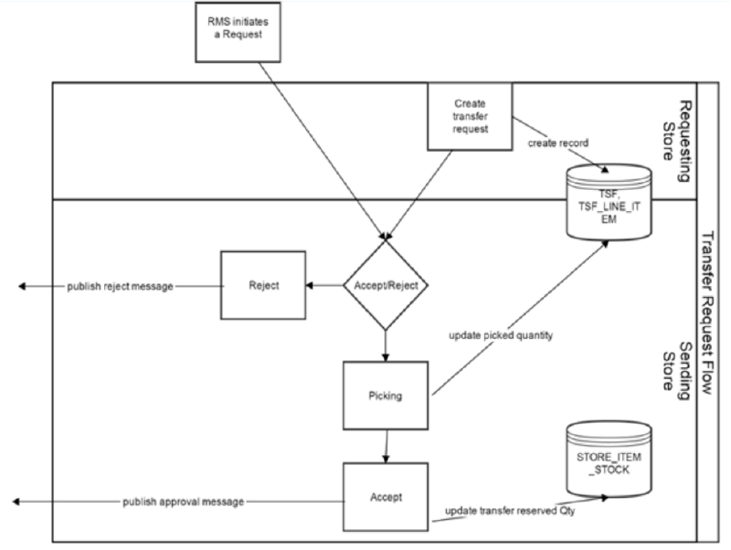

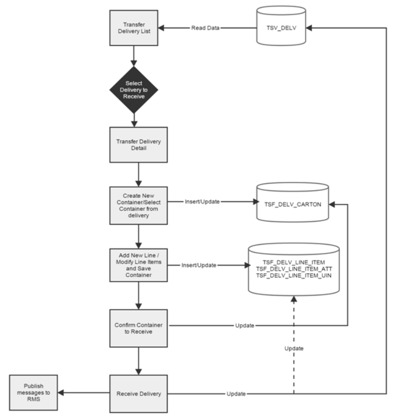

Transfer Receiving
This transaction captures a delivery that took place from a warehouse, store, or finisher to the store receiving the delivery. It describes the containers and the items of the delivery that should be received by the store. Receiving a container of the delivery will update the transfer document.
Figure 8-2 Transfer Request Flow
Figure 8-3 Transfer Create Flow
Figure 8-4 Transfer Shipment Creation Flow
Figure 8-5 Transfer Receiving Process Flow

Transfer Receiving
RIB Payload Description
ASNInDesc
Sent from external system to indicate a delivery is tracking place. It creates a transfer delivery record within EICS when a store location is involved.
ReceiptDesc
Sent to external system when a transfer delivery is confirmed.
Sent from external warehouse system when a transfer delivery is received at the warehouse.

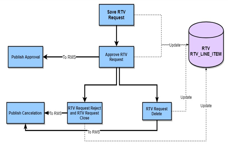

Vendor Return
RTV Creation
RTVs can only be created by a request from MERCHANDISING:
Each vendor return will have one or more items.

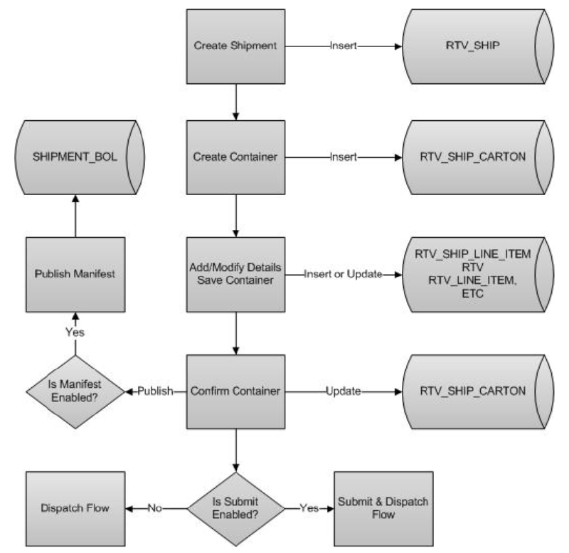

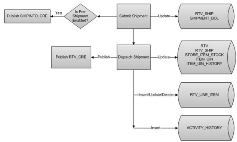

RTV Shipment
Each RTV shipment will tie back to a single vendor return document.
RTV shipment can be created in two ways:
  • From an externally initiated approved vendor return document.
  • Creation of ad hoc vendor return shipment which will create an approved vendor return on the fly.
Each vendor return shipment will have one or more containers; each container in turn will have one or more items.

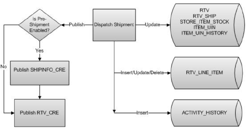

EICS may publish messages when the following happens:
  • RTV shipment container is updated, and saved (Return To Vendor Publish)
  • RTV shipment is cancelled or rejected (Return To Vendor Publish)
  • RTV shipment is dispatched (Return to Vendor Publish and Ship Info Desc Publish, if dispatched without submitting)
  • RTV shipment is submitted (Ship Info Desc Publish)
  • RTV shipment container is confirmed (RTV manifesting, if configured)
  • RTV shipment is submitted (Pre-shipment notification, if configured)
Figure 8-6 RTV Creation Flow
RTV Creation Flow
Figure 8-7 RTV Shipment Flow
RTV Shipment Flow
Figure 8-8 RTV Shipment Submit and Dispatch Flow
Figure 8-9 RTV Shipment Dispatch Flow

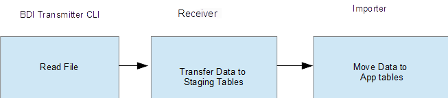

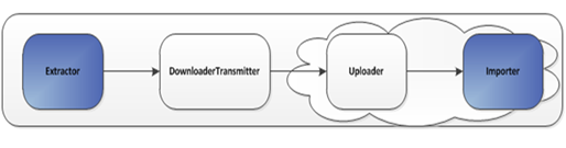

Batch Integration
This section contains the following:
Overview
Batch bulk data is still a predominant integration style within Oracle Retail and its customers. Currently SIOCS bulk data integrations are implemented as BDI-Based batch integration or SFTP-Based batch integration.
BDI-Based Batch Integration
Oracle BDI (Bulk Data Integration) is the latest Oracle Retail Integration tool for bulk data movement. The BDI infrastructure applications move data from one application to another. So, there is data producing applications and data consuming applications.
Figure 8-10 BDI-Based Batch Integration Process
The BDI process:
  • An Extractor extracts data from a data producing system into an outgoing intermediate integration interface table.
  • A Downloader and transporter services data to receiver service.
  • An Uploader uploads the data to an incoming intermediate integration interface table.
  • An Importer imports the data from the interface stage tables into SIOCS application tables.
For more information about data seeding, see the Oracle® Retail Enterprise Inventory Cloud Service Administration Guide.

BDI Transmitter CLI - Client Batch File Loader
The BDI CLI Transmitter is a standalone command line tool to transmit batch interface data files to a destination BDI receiver system.
It is particularly used where the source system is non-BDI (that is, the source system does not have or use BDI Batch Job Admin application) but needs to send interface data files to a receiver system running the BDI Job Admin application.
The tool uses the BDI Job Admin Receiver REST service URL to transmit the data to the destination system. So, it is necessary that the destination system runs the BDI Job Admin application to use the tool.
When use BDI Transmitter CLI tool to integrate with EICS, the app name for EICS in BDI is called SIM (Store Inventory Management).
The following figure illustrates the basic process for importing data using the BDI Transmitter CLI and EICS importer.
Figure 8-11 BDI Transmitter CLI
BDI Transmitter CLI
The BDI Transmitter CLI client tool process the data files from client machine, and load data into receiver application's staging inbound tables. The transmitter tool only load data into the Receiver's staging tables. To move data from receiver's staging tables into application's tables, you can use schedule EICS importer job to import the data from staging tables into EICS application tables.
Following is a list of batch file import implementations using BDI Transmitter CLI tool, alternatively the BDI External Process Flow can be chosen by integration implementation consultant, please see Oracle Retail Bulk Data Integration Implementation Guide.

Web Services
EICS provides a large range of web services to manage the processing of information that is controlled within EICS. Each web service covers a topical area of functionality within EICS and contains numerous operations within to accomplish this functionality. This document is only meant as an outline or summary into using EICS web services and assumes the user has access to the fully documented APIs through the publishing of the web services themselves.
The WSDL files are available to download from My Oracle Support (MOS) Document 2614551.1.

TransferDelivery
The following operations are available within the TransferDelivery web service.
Operation Description
lookupTransferDeliveryHeaders
Retrieves basic information about one or more transfer deliveries that match the criteria specified. This operation is used to find a delivery arriving at the store.
readTransferDeliveryDetail
Retrieves the entire set of information about a transfer delivery header based on the identifier you pass to it.
updateTransferDelivery
Updates the header information on a transfer delivery. This operation requires an activity lock.
receiveTransferDelivery
Receives all the currently open and active containers on a transfer delivery by defaulting quantities into all the unreceived items. This does not move inventory, only defaults quantities. This operation requires an activity lock.
confirmTransferDelivery
Confirms a transfer delivery receiving the goods into inventory and updating all the inventory positions. This moves the transfer delivery to a completed status. This operation requires an activity lock.
lookupTransferDeliveryContainerHeaders
Retrieves summary information about every container on a transfer delivery based on the unique delivery reference.
readTransferDeliveryContainerDetail
Reads the entire details of a container including items and quantities based on a unique container reference.
createTransferDeliveryContainer
Generates a new container on the transfer delivery and returns a reference to use so that items and quantity can be added later.

TransferShipment
The following operations are available within the TransferShipment web service.
lookupTransferShipmentHeader
Retrieves basic information about one or more transfer shipments that match the criteria specified. This operation is used to find a shipment.
readTransferShipmentDetail
Retrieves the entire set of information about a transfer shipment header based on a unique reference.
createTransferShipment
Creates a new and empty transfer shipment and returns a reference to the shipment.
saveTransferShipment
Updates the information on a transfer shipment header.
submitTransferShipment
Submits the transfer shipment for review before final dispatch.
cancelSubmittedTransferShipment
Cancels the submission of the transfer shipment for review.
dispatchTransferShipment
Dispatches a transfer shipment. This moves the shipment to dispatched state and updates the inventory. A transfer shipment cannot be modified after dispatch. Dispatch should occur only after all containers are confirmed.
cancelTransferShipment
Cancels a transfer shipment.
lookupTransferShipmentContainer
Finds all the containers on a specific shipment and retrieves basic identification information about each container.
readTransferShipmentContainer
Reads the specific and complete contents of a container.
createTransferShipmentContainer
Creates a new transfer shipment container on the shipment and returns a reference to it.
saveTransferShipmentContainer
Updates the information about a transfer shipment container including adding and removing items and quantities.
confirmTransferShipmentContainer
Confirms that a transfer shipment container is ready for shipment and marks the container as no longer editable.
cancelTransferShipmentContainer
Cancels a transfer shipment container on the shipment.
openTransferShipmentContainer
Re-opens a confirmed container on a shipment prior to the shipment being dispatched so that changes can be made to the container.
lookupCustomAttributeAdmins
Retrieves the custom attribute administration information that describes what customized attributes are available on the transfer shipment.
Standard Usage
To create a shipment for a transfer document, you look up the transfer shipment using lookupTransferShipmentHeader. If it does not exist, you could create one for the document using createTransferShipment. You then create a container on the shipment using createTransferShipmentContainer. You can update the container with items and quantities using saveTransferShipmentContainer. You then confirm the container using confirmTransferShipmentContainer. Repeat the process for each container as needed. Once all containers are confirmed, you submit if configured using submitTransferShipment and finally dispatch the shipment using dispatchTransferShipment. Dispatching the shipment finalizes the shipment and relieves the inventory.

VendorShipment
The following operations are available within the VendorShipment web service.
lookupVendorShipmentHeaders
Retrieves basic information about one or more vendor shipment headers that match the criteria specified.
lookupReturnContext
Retrieves all the context options that are available to assign to a vendor return shipment.
readVendorShipmentDetail
Retrieves the detailed information about a vendor return header based on a unique reference. It does not include information about containers or items.
saveVendorShipment
Creates a new vendor shipment header if not identifying reference is set or updates the vendor shipment header information if a unique reference is sent as part of the date. When used as an update, an activity lock is needed.
submitVendorShipment
Submits the vendor shipment for review before final dispatch.
cancelVendorShipmentSubmission
Cancels the submission of the vendor shipment for review.
Cancels a vendor shipment. This moves the shipment to canceled status. Changes cannot be made to a canceled shipment.
dispatchVendorShipment
Dispatches a vendor shipment. This moves the shipment to dispatched state and updates the inventory. A vendor shipment cannot be modified after dispatch. Dispatch should occur only after all containers are confirmed. This operation requires an activity lock.
closeVendorShipment
Closes a vendor shipment using business logic to determine its final state. It cancels the shipment of remaining quantities. Changes cannot be made after a shipment is closed.
lookupVendorShipmentContainerHeaders
Retrieves summary information about all containers within a vendor shipment based on the unique reference of the shipment.
readVendorShipment
ContainerDetail
Reads the specific details, including items and quantities, about a container specified by its unique reference.
saveVendorShipmentContainer
Update the details of a container, including items and quantities. This operation requires an activity lock.
confirmVendorShipmentContainer
Confirms that the container is ready for shipment. A confirmed container cannot be modified. This operation requires an activity lock.
cancelVendorShipmentContainer
Cancels a container on the shipment removing it from the shipment.
openVendorShipmentContainer
Opens a confirmed container placing it back into in-progress status so that items can be added or removed from the container.
Retrieves the custom attribute administration information that describes what customized attributes are available on the vendor shipment.
Standard Usage
To create a shipment for a vendor return document, you look up the vendor shipment using lookupVendorShipmentHeader. If it does not exist, you could create one using createVendorShipment. You then create a container on the shipment using createVendorShipmentContainer. You can update the container with items and quantities using saveVendorShipmentContainer. You then confirm the container using confirmVendorShipmentContainer. Repeat the process for each container as needed. Once all containers are confirmed, you submit if configured using submitVendorShipment and finally dispatch the shipment using dispatchVendorShipment. Dispatching the shipment finalizes the shipment and relieves the inventory.

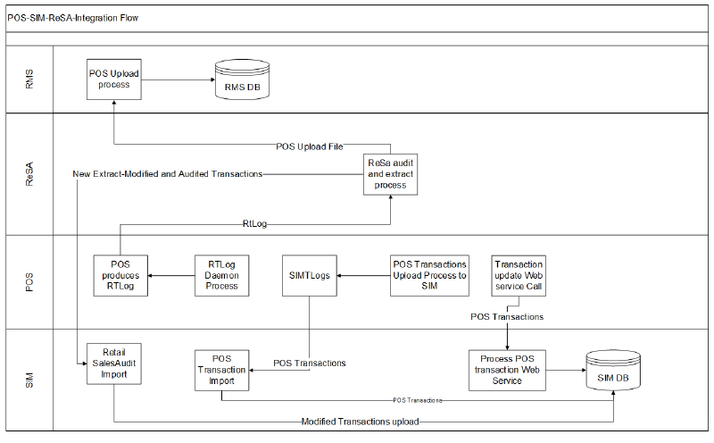

Sales Integration
EICS integrates with POS systems and Sales Audit systems to ensure that the inventory positions are accurate. This is especially important where accurate up-to-date inventory positions are required to reduce customer disappointment when trying to locate items that appear in inventory or delays in filling customer orders.
POS is the primary source of sales, returns, void, and some customer order transaction information to EICS.
ReSA sends only modified or new POS transaction records to EICS.
POS systems integrated with EICS can do the transaction notifications using a web service.
Sales Audit systems can only communicate through a file import process.
Figure 8-12 POS and Sales Audit Integration
The following features are part of this integration:
  • Real-time web service integration
  • Batch integration
  • Audited sales data integration
  • Automatic disposition processing for returns
Batch processing and ReSA processing are discussed elsewhere as are the store and system configurations that might determine how the sale is processes.

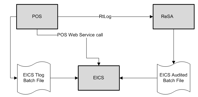

POS and Sales Audit Process Flow
The following figure shows how a POS, Retail Sales Audit, and EICS are integrated. A POS generates an RTLog containing all the POS transactions and sends it to the Oracle Retail Sales Audit system (ReSA). ReSA sends the audited modified or new transactions to EICS. ReSA also sends the POS transaction upload file to merchandising to update inventory.
Please note that Oracle Retail Xstore is interfaced with EICS to update the inventory transactions near real time only through web service. It does not use batch.
Non-Oracle POS systems can use a batch to import transactions directly into EICS. EICS also processes the POS transactions that have been changed or entered the sales audit system and updates the inventory based on the delta.
Figure 8-13 POS and Sales Audit Process Flow
There are two reasons for POS to send sales data directly to EICS and not to the auditing system:
  • Real-time inventory updates to support Commerce Anywhere are critical. A possible round trip from POS to ReSA to EICS takes too long in the dynamic inventory environment of today.
  • POS is the application that owns sales data and ReSA owns audited data. Architecturally, it makes more sense to have data supplied by the owner of that data. POS sends sales data and ReSA sends audit changes to EICS.
Sales and Return Processing

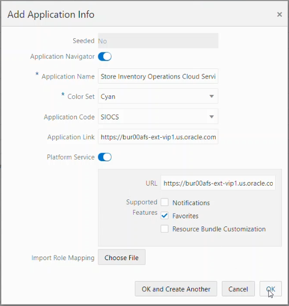

Retail Home Integration
EICS now supports following integration scenarios with Retail Home:
  • Launch SIOCS web client from Retail Home
  • Launch SIOCS favorites from Retail Home
  • Display a tile report for items that are out of stock on shop floor
  • Display a tile report for stock counts that are pending authorization
  • Launch detailed operational views in SIOCS web client from related tile reports in Retail Home
Launch SIOCS from Retail Home
Launching SIOCS client requires an entry to be made under the application navigator section of Retail Home. It enables the user to launch SIOCS web client in a new browser tab from within Retail Home. Please refer to Oracle Retail Home Administration Guide for information on how to work with application navigator in Retail Home.
The SIOCS application configuration should look like this:
Figure 8-14 Add Application Info
Add Application Info Screen
  • Seeded: Disabled and set to No.
  • Application Navigator: Enable it to launch SIOCS client from Retail Home.
  • Application Name: The name of the application that is, Store Inventory Operations Cloud.
  • Color Set: Any color that you want to allocate to SIOCS.
  • Application Code: Select SIOCS from the drop down.
  • Application Link: The URL of SIOCS web client.
  • Platform Service: Enable it to use Favorites feature.
    • URL: The base URL of the platform services. The URL would be of the form
      https://<SIOCS-HOST>/RetailAppsPlatformServices
      <SIOCS-HOST> is the same host in Application Link.
    • Supported Features: Check only the favorites feature.
The user needs to be part of RETAIL_HOME_ADMIN security group in order to access Application Navigator in Retail Home.
