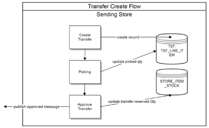

This section covers creating transfer documents which are then included in a transfer shipment and dispatched to another store, warehouse, or finisher.

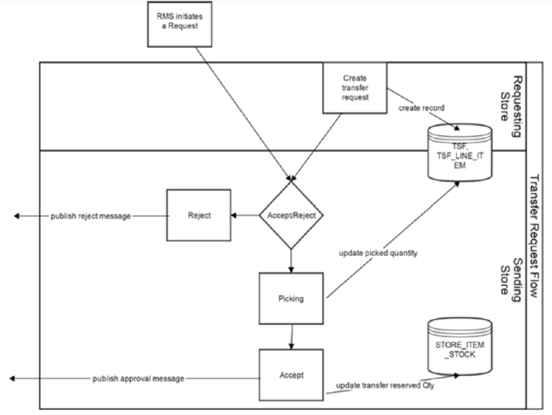

Transfer Creation
Transfer documents can be created in the following ways:
Requesting store can create a transfer request.
Sending store can initiate a transfer by creating a transfer.
Merchandising can create a transfer request.
Each transfer document will have one or more items.

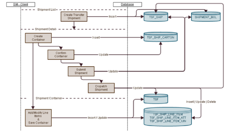

Transfer Shipment Creation
Transfer Shipment describes the containers and the items for the shipment taking place. The shipment may be for one or more transfer documents if the transfer is going to the same destination. Dispatching a shipment will update the transfer document.
The user can create a shipment without referencing existing transfers or can create a new transfer on fly (Ad hoc transfer) based on the shipment information.

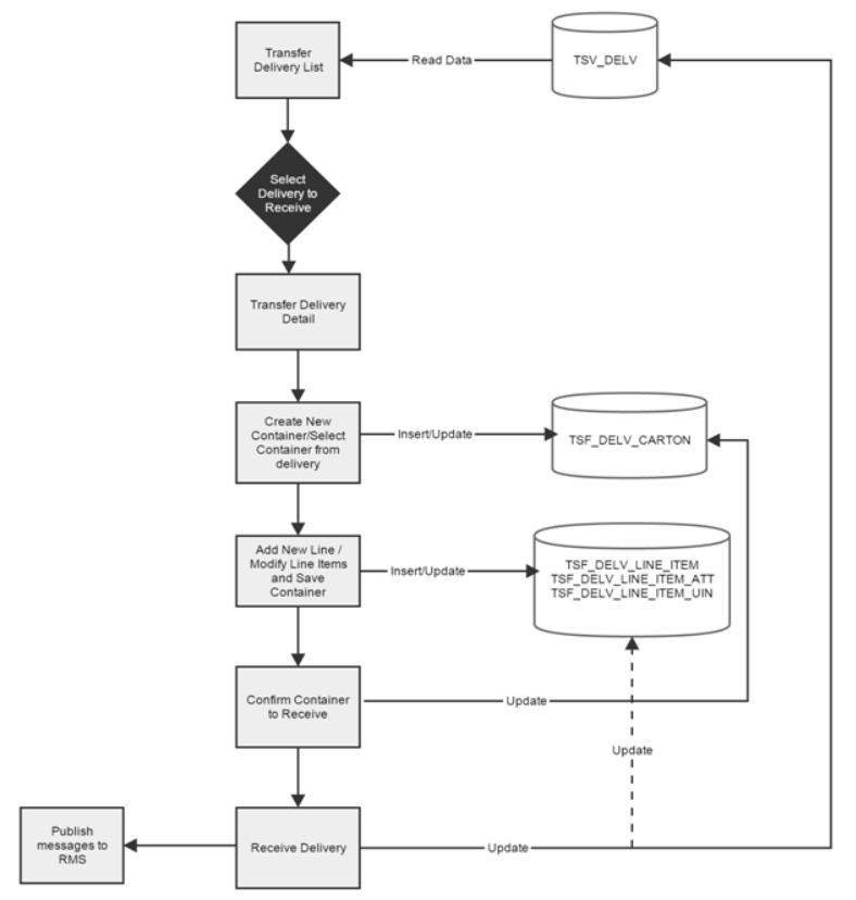

Transfer Receiving
This transaction captures a delivery that took place from a warehouse, store, or finisher to the store receiving the delivery. It describes the containers and the items of the delivery that should be received by the store. Receiving a container of the delivery will update the transfer document.
Figure 7-1 Transfer Request Flow
Figure 7-2 Transfer Create Flow
Figure 7-3 Transfer Shipment Creation Flow
Figure 7-4 Transfer Receiving Process Flow

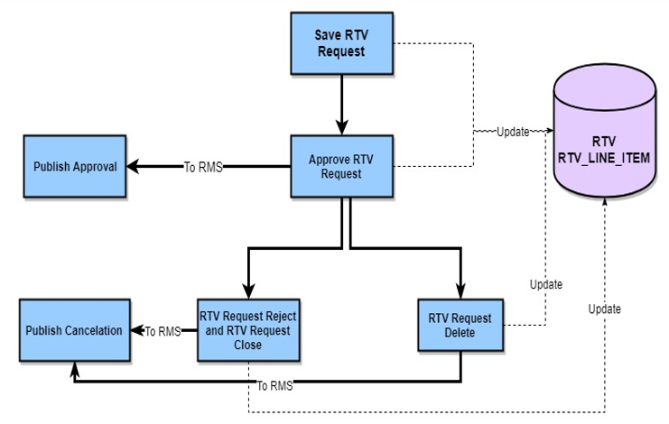

RTV Creation
RTVs can only be created by a request from MERCHANDISING:
Each vendor return will have one or more items.

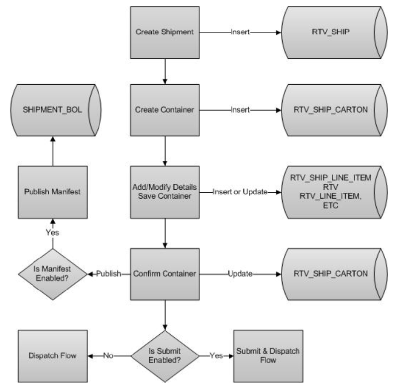

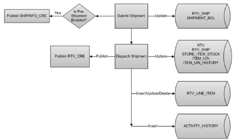

RTV Shipment
Each RTV shipment will tie back to a single vendor return document.
RTV shipment can be created in two ways:
From an externally initiated approved vendor return document.
Creation of ad hoc vendor return shipment which will create an approved vendor return on the fly.
Each vendor return shipment will have one or more containers; each container in turn will have one or more items.

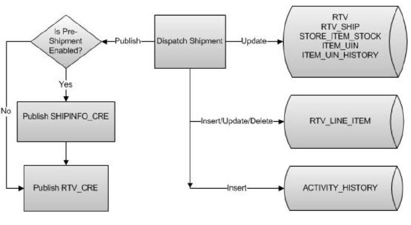

EICS may publish messages when the following happens:
RTV shipment container is updated, and saved (Return To Vendor Publish)
RTV shipment is cancelled or rejected (Return To Vendor Publish)
RTV shipment is dispatched (Return to Vendor Publish and Ship Info Desc Publish, if dispatched without submitting)
RTV shipment is submitted (Ship Info Desc Publish)
RTV shipment container is confirmed (RTV manifesting, if configured)
RTV shipment is submitted (Pre-shipment notification, if configured)
Figure 7-5 RTV Creation Flow
Figure 7-6 RTV Shipment Flow
Figure 7-7 RTV Shipment Submit and Dispatch Flow
Figure 7-8 RTV Shipment Dispatch Flow

StoreTransfer
The following operations are available within the StoreTransfer web service.
| Operation | Description |
lookupTransferHeader |
Retrieve a summary list of transfers that matches the input criteria. |
lookupTransferContext |
Retrieves all the transfer context options available to assign to a transfer. |
readTransfer |
Retrieves the detailed information about transfer, including its items and quantities, based on a unique reference. |
createTransferRequest |
Creates a brand new transfer request (Location 1 requesting a transfer from Location 2). |
saveTransferRequest |
Updates a transfer request allowing user to change items and quantities. This must be done prior to requesting it, which finalizes the transfer request. This requires an activity lock. |
createTransfer |
Generates a new transfer that you can add details to. The saveTransfer method must be used to update details such as items and quantities of the transfer. |
saveTransfer |
Updates a previously approved transfer item and quantity details. This operation requires an activity lock. |
saveTransferApproval |
Updates items and quantities on a transfer in requested status that is currently in the process of being approved but has not yet been approved. This operation requires an activity lock. |
requestTransfer |
Updates the status to Requested, finally the transfer request. This allows the opposite location to view the new request for transfer of goods. This operation requires an activity lock. |
approveTransfer |
Approves a transfer request converted the transfer request into an approved transfer. This operation requires having an activity lock. |
rejectTransfer |
Rejects a transfer in request status which prevents the transfer request from becoming a transfer. This operation requires having an activity lock. |
cancelTransfer |
Cancels an approved transfer. This operation requires having an activity lock. |
closeTransfer |
Closes a processed or partially processed transfer finalizing the state of the transfer. This operation requires having an activity lock. |
lookupCustomAttributeAdmins |
Retrieves the custom attribute administration information that describes what customized attributes are available on the transfer. |
Standard Usage
The process is started by one store creating a transfer request from a shipping store using createTransferRequest. The requesting store can continue modifying the transfer request using saveTransferRequest until it is ready to notify the shipping store, when it then uses the requestTransfer to send the request to the shipping store. The shipping store can then begin picking items for the transfer and updating the transfer using the saveTransferApproval operation. When all the quantities the shipping store are willing to ship are determined, the shipping store uses approveTransfer to finalize the approval of the transfer. Alternatively, they can choose to reject the transfer using rejectTransfer. It is possible for a shipping store to create a transfer document without going through the request and approval process by using createTransfer and saveTransfer.
TransferDelivery
The following operations are available within the TransferDelivery web service.
lookupTransferDeliveryHeaders |
Retrieves basic information about one or more transfer deliveries that match the criteria specified. This operation is used to find a delivery arriving at the store. |
readTransferDeliveryDetail |
Retrieves the entire set of information about a transfer delivery header based on the identifier you pass to it. |
updateTransferDelivery |
Updates the header information on a transfer delivery. This operation requires an activity lock. |
receiveTransferDelivery |
Receives all the currently open and active containers on a transfer delivery by defaulting quantities into all the unreceived items. This does not move inventory, only defaults quantities. This operation requires an activity lock. |
confirmTransferDelivery |
Confirms a transfer delivery receiving the goods into inventory and updating all the inventory positions. This moves the transfer delivery to a completed status. This operation requires an activity lock. |
lookupTransferDeliveryContainerHeaders |
Retrieves summary information about every container on a transfer delivery based on the unique delivery reference. |
readTransferDeliveryContainerDetail |
Reads the entire details of a container including items and quantities based on a unique container reference. |
createTransferDeliveryContainer |
Generates a new container on the transfer delivery and returns a reference to use so that items and quantity can be added later. |
updateTransferDeliveryContainer |
Updates the items and quantities on a transfer delivery container. This operation requires an activity lock. |
receiveandConfirmTransferDeliveryContainer |
It first defaults receiving quantity on the items within the container and then executes the same locking as the confirmTransferDeliveryContainer. This operation requires an activity lock. |
confirmTransferDeliveryContainer |
Confirms a transfer delivery container as received and updates all the inventory positions. This operation requires an activity lock. |
cancelTranferDeliveryContainer |
Cancels a transfer delivery container moving it to missing status. Changes cannot be made to a canceled container. |
openTransferDeliveryContainer |
Re-opens an already confirmed container moving it back into in-progress status. |
lookupTransferDeliveryOrders |
Retrieves any customer orders associated with the transfer delivery based on the delivery's unique reference. |
lookupMisdirected TransferDeliveryContainers |
Retrieves summary information about containers that may have been misdirected based on a set of search criteria as input into the operation. |
Retrieves the custom attribute administration information that describes what customized attributes are available on the transfer delivery. |
Standard Usage
After reading a transfer delivery using lookupTransferDeliveryHeader, you can read the header detail with readTransferDelivery or container list with lookupTransferDeliveryContainers. You can then use updateTransferDelivery to update header attributes and updateTransferDeliveryContainer to update items and quantities in the container. To quickly receive the quantities, receiveTransferDeliveryContainer automatically fills in quantities, and when quantities are entered confirmTransferDeliveryContainer finalizes the container (and if appropriate configurations and business rules apply) immediately updates the inventory. If receiveTransferDelivery or confirmTransferDelivery is used, then all containers will either be received or confirmed respectively.

createTransferShipment |
Creates a new and empty transfer shipment and returns a reference to the shipment. |
saveTransferShipment |
Updates the information on a transfer shipment header. |
submitTransferShipment |
Submits the transfer shipment for review before final dispatch. |
cancelSubmittedTransferShipment |
Cancels the submission of the transfer shipment for review. |
dispatchTransferShipment |
Dispatches a transfer shipment. This moves the shipment to dispatched state and updates the inventory. A transfer shipment cannot be modified after dispatch. Dispatch should occur only after all containers are confirmed. |
cancelTransferShipment |
Cancels a transfer shipment. |
lookupTransferShipmentContainer |
Finds all the containers on a specific shipment and retrieves basic identification information about each container. |
readTransferShipmentContainer |
Reads the specific and complete contents of a container. |
createTransferShipmentContainer |
Creates a new transfer shipment container on the shipment and returns a reference to it. |
saveTransferShipmentContainer |
Updates the information about a transfer shipment container including adding and removing items and quantities. |
confirmTransferShipmentContainer |
Confirms that a transfer shipment container is ready for shipment and marks the container as no longer editable. |
cancelTransferShipmentContainer |
Cancels a transfer shipment container on the shipment. |
openTransferShipmentContainer |
Re-opens a confirmed container on a shipment prior to the shipment being dispatched so that changes can be made to the container. |
Retrieves the custom attribute administration information that describes what customized attributes are available on the transfer shipment. |
Standard Usage
To create a shipment for a transfer document, lookup the transfer shipment using lookupTransferShipmentHeader. If it does not exist, you may create one for the document using createTransferShipment. Create a container on the shipment using createTransferShipmentContainer and update the container with items and quantities using saveTransferShipmentContainer. Confirm the container using confirmTransferShipmentContainer. Repeat the process for each container as needed. Once all containers are confirmed, if configured to require submittal, submit the shipment using submitTransferShipment and finally, dispatch the shipment using dispatchTransferShipment. Dispatching the shipment finalizes the shipment and relieves the inventory.

VendorReturn
The following operations are available within the VendorReturn web service.
lookupVendorReturnHeader |
Retrieves basic information about one or more vendors return documents that match the criteria specified. |
readVendorReturnDetail |
Retrieves the entire set of information about a vendor return, including items and quantities, based on a unique reference. |
saveVendorReturn |
Updates the entire set of information about a vendor return, including items and quantities. This operation requires an activity lock. |
approveVendorReturn |
This marks an in-progress vendor return as approve for shipment. This operation requires an activity lock. |
cancelVendorReturn |
Cancels a vendor return indicating no further items and quantities should be shipped for the return. |
closeVendorReturn |
Closes a vendor return document moving it from in-progress to canceled, rejected, or complete status depending on the state of shipped quantities. |
Retrieves the custom attribute administration information that describes what customized attributes are available on the vendor return. |
Standard Usage
The user may access lookupVendorReturnHeader to find vendor returns to deal with. Once the proper vendor return is found, readVendorReturnDetail will retrieve all the details of the vendor return including items and quantities. The saveVendorReturn operation is then used to update quantities that are expected to ship. Once the vendor return reaches its final state, the operation approveVendorReturn will approve the return and get it ready for shipment.
VendorShipment
The following operations are available within the VendorShipment web service.
lookupVendorShipmentHeaders |
Retrieves basic information about one or more vendor shipment headers that match the criteria specified. |
lookupReturnContext |
Retrieves all the context options that are available to assign to a vendor return shipment. |
readVendorShipmentDetail |
Retrieves the detailed information about a vendor return header based on a unique reference. It does not include information about containers or items. |
saveVendorShipment |
Creates a new vendor shipment header if not identifying reference is set or updates the vendor shipment header information if a unique reference is sent as part of the date. When used as an update, an activity lock is needed. |
submitVendorShipment |
Submits the vendor shipment for review before final dispatch. |
cancelVendorShipmentSubmission |
Cancels the submission of the vendor shipment for review. |
cancelVendorShipment |
Cancels a vendor shipment. This moves the shipment to canceled status. Changes cannot be made to a canceled shipment. |
dispatchVendorShipment |
Dispatches a vendor shipment. This moves the shipment to dispatched state and updates the inventory. A vendor shipment cannot be modified after dispatch. Dispatch should occur only after all containers are confirmed. This operation requires an activity lock. |
closeVendorShipment |
Closes a vendor shipment using business logic to determine its final state. It cancels the shipment of remaining quantities. Changes cannot be made after a shipment is closed. |
lookupVendorShipmentContainerHeaders |
Retrieves summary information about all containers within a vendor shipment based on the unique reference of the shipment. |
readVendorShipment ContainerDetail |
Reads the specific details, including items and quantities, about a container specified by its unique reference. |
saveVendorShipmentContainer |
Update the details of a container, including items and quantities. This operation requires an activity lock. |
confirmVendorShipmentContainer |
Confirms that the container is ready for shipment. A confirmed container cannot be modified. This operation requires an activity lock. |
cancelVendorShipmentContainer |
Cancels a container on the shipment removing it from the shipment. |
openVendorShipmentContainer |
Opens a confirmed container placing it back into in-progress status so that items can be added or removed from the container. |
Retrieves the custom attribute administration information that describes what customized attributes are available on the vendor shipment. |
Standard Usage
To create a shipment for a vendor return document, lookup the vendor shipment using lookupVendorShipmentHeader. If it does not exist, create one using createVendorShipment. Next, create a container on the shipment using createVendorShipmentContainer. Update the container with items and quantities using saveVendorShipmentContainer. Confirm the container using confirmVendorShipmentContainer. Repeat the process for each container as needed. Once all containers are confirmed, if configured to require submit, then submit using submitVendorShipment or dispatch the shipment using dispatchVendorShipment. Dispatching the shipment finalizes the shipment and relieves the inventory.

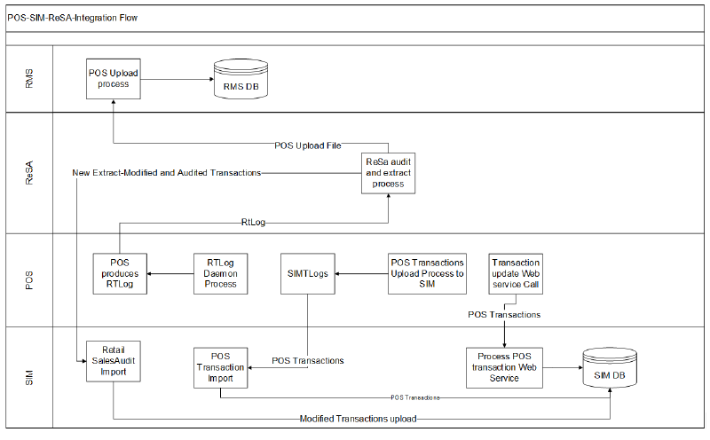

Sales Integration
EICS integrates with POS systems and Sales Audit systems to ensure that the inventory positions are accurate. This is especially important where accurate up-to-date inventory positions are required to reduce customer disappointment when trying to locate items that appear in inventory or delays in filling customer orders.
POS is the primary source of sales, returns, void, and some customer order transaction information to EICS.
ReSA sends only modified or new POS transaction records to EICS.
POS systems integrated with EICS can do the transaction notifications using a web service.
Sales Audit systems can only communicate through a file import process.
Figure 7-9 POS and Sales Audit Integration
The following features are part of this integration:
Real-time web service integration

POS and Sales Audit Process Flow
The following figure shows how a POS, Retail Sales Audit, and EICS are integrated. A POS generates an RTLog containing all the POS transactions and sends it to the Oracle Retail Sales Audit system (ReSA). ReSA sends the audited modified or new transactions to EICS. ReSA also sends the POS transaction upload file to merchandising to update inventory.
Please note that Oracle Retail Xstore is interfaced with EICS to update the inventory transactions near real time only through web service. It does not use batch.
Non-Oracle POS systems can use a batch to import transactions directly into EICS. EICS also processes the POS transactions that have been changed or entered into the sales audit system and updates the inventory based on the delta.
Figure 7-10 POS and Sales Audit Process Flow
There are two reasons for POS to send sales data directly to EICS and not to the auditing system:
Real-time inventory updates to support Commerce Anywhere are critical. A possible round trip from POS to ReSA to EICS takes too long in the dynamic inventory environment of today.
POS is the application that owns sales data and ReSA owns audited data. Architecturally, it makes more sense to have data supplied by the owner of that data. POS sends sales data and ReSA sends audit changes to EICS.

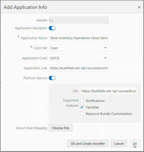

Launch SIOCS from Retail Home
Launching SIOCS client requires an entry to be made under the application navigator section of Retail Home. It enables the user to launch SIOCS web client in a new browser tab from within Retail Home. Please refer to Oracle Retail Home Administration Guide for information on how to work with application navigator in Retail Home.
The SIOCS application configuration should look like this:
Figure 7-11 Add Application Info
Seeded: Disabled and set to No.
Application Navigator: Enable it to launch SIOCS client from Retail Home.
Application Name: The name of the application that is, Store Inventory Operations Cloud.
Color Set: Any color that you want to allocate to SIOCS.
Application Code: Select SIOCS from the drop down.
Application Link: The URL of SIOCS web client.
Platform Service: Enable it to use Favorites feature.
URL: The base URL of the platform services. The URL would be of the form
https://<SIOCS-HOST>/RetailAppsPlatformServices
<SIOCS-HOST> is the same host in Application Link.
Supported Features: Check only the favorites feature.

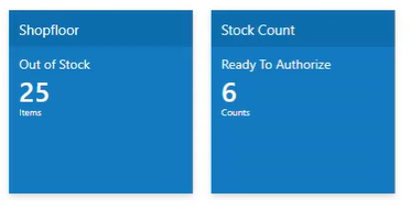

Tile Reports
EICS supports following two types of two metric reports:
Shop Floor Out of Stock Items
Stock Counts - Ready to Authorize
Adding an application navigator entry for SIOCS will automatically configure EICS tiles on Retail Home.
The data seed features do the following:
Creates a custom report for EICS tiles on Retail Home.
Creates two tiles from the custom report and maps them to retail_home_users IDCS or OCI IAM application role.
The data seed features will also configure tile states for the two tiles and hook them up with EICS end points.
After all the configuration, you should be able to see EICS tiles on the dashboard. They should look like the ones below:
Figure 7-12 Example EICS Tiles
