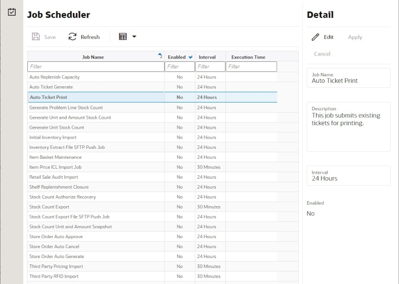

Auto Ticket Generate
This job automatically generates the item tickets and labels depending on the store parameters for events which are subscribed. The events are price changes, clearance event, promotions, and item description changes.
The batch also generates tickets for future price change events based on Auto Ticket Generate Future Days store parameter value that indicates how many days of future price events are considered to generate the tickets when the price events are coming to SIOCS.

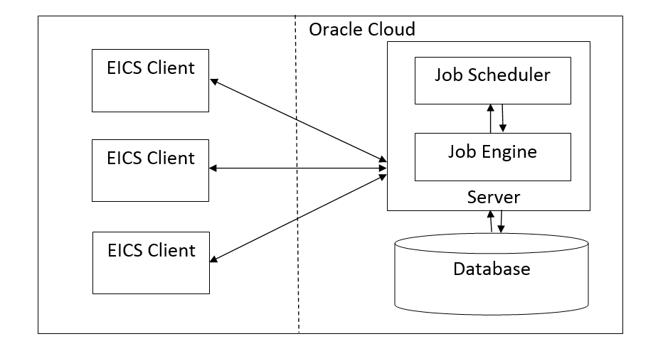

The following diagram illustrates the high-level architecture of the current batch processing implemented for the EICS Application Server.
Figure 5-1 EICS Application Server Batch Processing Architecture
EICS Client - Server Communication
EICS client provides an option to the retailer to run the batch jobs on demand. This call to the server is made via HTTP REST service call. The batch job selected, and the parameter selected by the user are set on the request and sent to the server on this call. The server handles this request and invokes a start job on the batch engine for the respective job.
Job Engine
The job engine manages the state of a running job and guarantees the execution of each step defined for the job. The call made from the client or job scheduler is passed onto the job engine to start a new instance of the batch job. Users also have an option to stop the running job or to restart any particular job which failed during the processing.
Job Scheduler
This feature of EICS allows a retailer to schedule the batch jobs to run at a specific time interval. Each batch job will initially execute at a pre-configured schedule interval. Retailers will have an option to enable or disable specific batch job schedules as well. For more information, please refer to Job Scheduler Section below.
A few of the jobs which are system required will not be available for the retailer to change the schedule interval or disable them. These jobs will always be enabled and can be managed only by cloud admin.

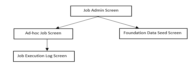

The following diagrams show the Batch Admin and relevant GUI components:
Figure 5-2 Batch Admin and GUI Components

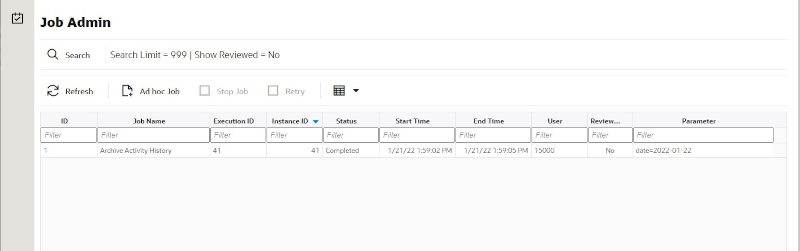

Job Admin Screen
This screen views the list of the job that have been instantiated on the server. User can filter the list of the job loaded on screen on Job Status, Reviewed and Search Limit. The default filter will load the list of the failed job when the screen is initially loaded.
User requires appropriate permission to access this screen on SIOCS. Navigation path for the Job Admin screen is:
Admin/Technical Maintenance/Job Admin
Figure 5-3 Job Admin Screen
Screen Options
Search
Allows user to filter the list of the batch jobs instantiated by user and the scheduler.
Refresh
This option refreshes the list loaded on the screen; call is made to server to load the list of batch jobs with current state.

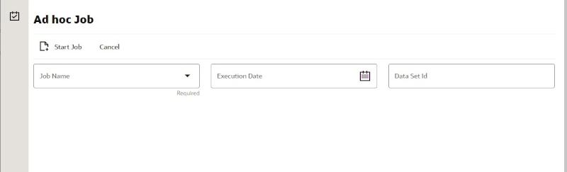

Ad hoc Job
Data Seed
This option navigates user to Data Seed Job Launcher screen. User can start a new data seed job from this screen by setting the required parameters and data seeding options on the job. User will require appropriate access permission to view this option on the screen.
Stop Job
This option allows user to stop a running job. This option is available only when selected job is in running state that is, STARTED and STARTING.
Table Information
Execution ID
This column displays the job execution identifier generated by the job engine.
Job Name
This column displays the name of the batch job.
Instance ID
This column displays the job instance identifier generated by the job engine.
Status
This column displays the current status of the batch job.
Start Time
This column displays the time when job was started.
End Time
This column displays the time when job was completed. If the job is currently in running state, the end time will not be available.
User
This column displays the user name of the user who started the job. The job started by the scheduler will have server user name in this column.
Reviewed
This column denotes if user has reviewed this job.
Parameter
This column displays the parameter if entered while starting the batch job.

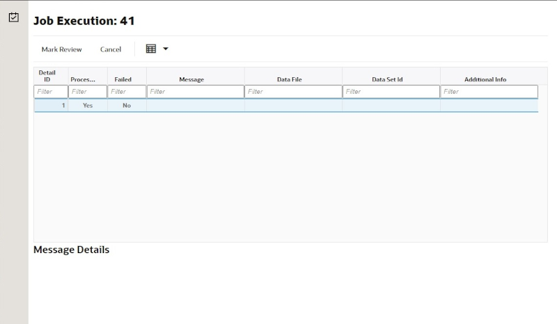

Job Execution Log Screen
This screen displays the execution details for the batch job. Users can navigate to this screen by clicking Job Execution ID on the Job Admin screen. This screen is designed to view the error logs for the batch jobs and to mark the job as reviewed.
Review flag denotes the selected job has been reviewed by the user. By using this, the user can keep a track of which of the failed jobs have already been reviewed and take necessary actions as required.
The execution detail table load the entries of the execution record if exist for the select batch job.
Figure 5-4 Job Execution Screen
Screen Options
Mark Review
This option allows user to mark the batch job as review. Once the job is marked as review user is navigated back to the Job Admin screen.
Cancel
This option allows user to navigate back to the Job Admin screen.
Table Information
Detail ID
This column displays the execution identifier generated by the job engine.
Processed
This column denotes if the execution record for the job was successfully processed.
Failed
This column denotes if the execution records was failed during the processing.
Message
This column displays the message from the server to viewing the further details on the job status. This column will be empty for the execution records which are been successfully processed.
Data File
This column displays the file name for which the execution record was created. This column holds data only if the job details with file import processing for example, Retail Sales Audit Import Job.
Additional Info
This column holds the addition info if any for the execution record.
Message Details
This section in non-editable and displays the detailed explanation for the job failure. This section will display respective data on selection job execution record. The log traces of the exact point of failure shall be printed on this section of the screen.
Job Launch Screen
This screen allow user to start a new instance for a job. Select the batch job and enter the parameter, if required, to start job.
The job launcher screen has the following categories:
Ad hoc Job
This screen allows user to run an ad hoc job. All the job which are either operational or purge job can be started from this screen. All the batch job will not support the execution date and store identifier parameters. The job for which store level processing can be performed will consider these parameters. User will not receive an error or confirmation if the parameters are not valid for the selected job.
User will require appropriate data permissions to select and run a particular job. Navigation to this screen is as follows:
Admin/Technical Maintenance/Job Admin /Ad hoc Job
Figure 5-5 Ad hoc Job Screen
Screen Options
Start Job
This option allows user to start a new instance of the selected job. When the user selects this option, a call is made to server to start a selected batch job. Server internally makes a call to Batch Operator specifying the Job Name and the parameter if any.
Cancel
This option navigates user back to Job Admin Screen.
Menu Options
Job Name
Allows user to select the job to be started. This is a required field on this screen. The user will be able to view only those jobs in the drop-down list which are permitted to the user via data permissions.
Store ID
Allow user to enter the store identifier if the job is expected to be executed for specific store. Not all job accepts store identifier as parameter. For the jobs which doesn't take store identifier as parameter for execution shall ignore this parameter.
Execution Date
Allows user to enter the execution date for the job, if not entered the job will consider the current date for the execution. Not all job accepts execution date as parameter. For the jobs which doesn't take execution date as parameter for execution shall ignore this parameter.
Data Set Id
The Data Set Id is optional parameter for batch job to process the specified data set id.
Start an Ad hoc Job
Login to SIOCS and navigate to Job Admin screen.
Click on Ad hoc Job Menu to navigate to Ad hoc Job screen
Select the required Job from the drop-down menu.
Set the required job parameter for the job, that is, Store ID and/or Execution Date.
Job Parameter doesn't apply to all available batch jobs, for the job which do not take any parameter input will simply ignore the value in case entered.
Click on Start Job to start the new instance of job.
The new execution record will be populated on the Job Admin Screen List.
View Details for Job
Click the Job Execution Id to navigate to details.
To navigate back to Job Admin screen, click Cancel.
To mark job execution reviewed, click Mark Reviewed.
Stop a Running Job
Select the job which is currently in running state that is, STARTED or STARTING.
Click on Stop Job to stop the execution of the running job.
Prompted to confirm if the job needs to be stopped. Click Yes to continue.
Request is sent to job engine to stop the instance of the job. In case the job is already completed or stopped appropriate message shall be displayed to user.
Refresh the list on the screen to view the changes.

Job Scheduler Screen
This screen allows user to manage the schedules for the batch jobs. The list of job available to be scheduled will be sort by the enabled flag followed by Job Name alphabetically that is, the jobs for which the scheduling is enable will be on the top of the list sorted by the Job Names in alphabetical order.
User can edit the batch job and perform following operations:
Enable / Disable a schedule.
Setting the execution interval for a batch job.
User will require appropriate authorization to access this screen. Retailer will not be able to view or disable the batch jobs which are system required. This batch jobs will be accessible to Cloud Admin user will have a predefined schedule. Navigation to this screen is as follows: Admin/Technical Maintenance/Job Scheduler
Figure 5-6 Job Scheduler Screen
Screen Options
Save
This option allows user to save the changes made to the job schedules. User can make changes to multiple schedules in edit mode and apply the changes, however the changes will take affect only when the save operation is performed.
Refresh
This option refreshes the list of values on the screen.
Edit
This option will be enabled only when a schedule is selected to be edited and user have privileges to edit the job schedule. This option takes user to the edit mode in which user can change the execution interval for the job and enable or disable the schedule.
Apply
This option will only apply the changes which are been made during edit mode. This option does not save the changes, it only applies the changes for the job and exit the edit mode. Click the Save option to save the changes.
Cancel
This option is enabled only when user is in edit mode. This option allows user to discard any changes made to the schedule on edit mode or to exit the edit mode.
Menu Options
Interval
Users have the option to select the appropriate interval for the batch job execution. Depending on the selected interval, server calculates the execution time for the batch job and runs it according. The base time for calculating the execution time on basis of the interval is 01:00 AM. For the store based job this is as per the store time zone and for system jobs this is as per the server time zone.
Option for selecting the execution interval are as follows:
30 Minutes - Runs every 30 minutes.
1 Hour - Runs every hour.
2 Hours - Runs every second hour of the day.
3 Hours - Runs every third hour of the day.
4 Hours - Runs every fourth hour of the day.
6 Hours - Runs every sixth hour of the day.
8 Hours - Runs every eighth hour of the day.
12 Hours - Expected to be executed twice a day.
24 Hours - Expected to be executed only once a day.
Enabled
Table Information
Job Name
This column displays the name of the job.
Enabled
This column denotes whether a job is current scheduled.
Interval
This column denotes the interval of the job execution.
Execution Time
This column denotes the next execution time for the batch job. This column will not contain data for the jobs which are been disabled.
Configuring a Job Schedule
Login in SIOCS and navigate to the Job Scheduler screen.
Select the desired job from the list.
If the Edit option is not available in the menu section, the user is not authorized to edit the batch job. Kindly assign appropriate user group or contact system admin for desired changes.
Edit the Job details on right panel.
Set required interval for execution and Enabled to Yes.
Click Apply to exit the edit mode.
For configuring multiple jobs on a go, repeat Step 2 for each job.
Click Save to save the current changes made on the screen.
Disabling a Job Schedule
Login in SIOCS and navigate to Job Scheduler screen.
Select the job from the list which needs to be disabled.
Set Enabled as No.
For disabling multiple jobs on a go, repeat Step 2 for each job.
