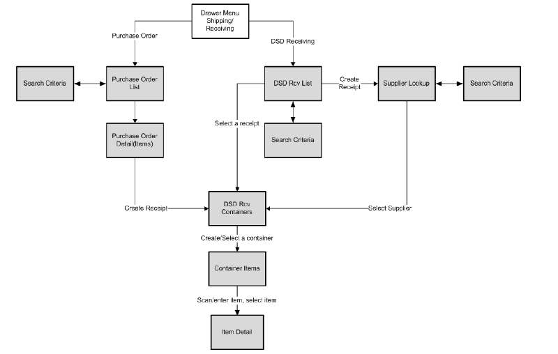

Screen Flow
Figure 6-1 Direct Store Delivery Mobile Screen Flow
You can access DSD Receiving and Purchase Order options from the Shipping and Receiving menu. The DSD Receiving List screen that appears after selecting DSD Receiving, lists all the active deliveries that are available and allows you to create or modify a receipt. You can also create a new receipt on the fly without any purchase order by selecting Create Receipt.
After selecting the ASN, active delivery, or supplier for creating an on the fly delivery, the DSD Receiving Containers screen appears and allows you to proceed with detailed receiving using the Container Items screen.
You can access various footer menu options such as Info, Edit Receipt, Edit CFAs, Customer Orders, External Receiver Adjustments, Notes, and so on from the DSD Receiving Containers screen to perform various individual functions.
Similarly, you can access various footer menu options such as Default Qty, Edit CFAs, Document option to select the PO for the PO based deliveries, Notes, and so on from the Container Items screen to perform various individual functions.

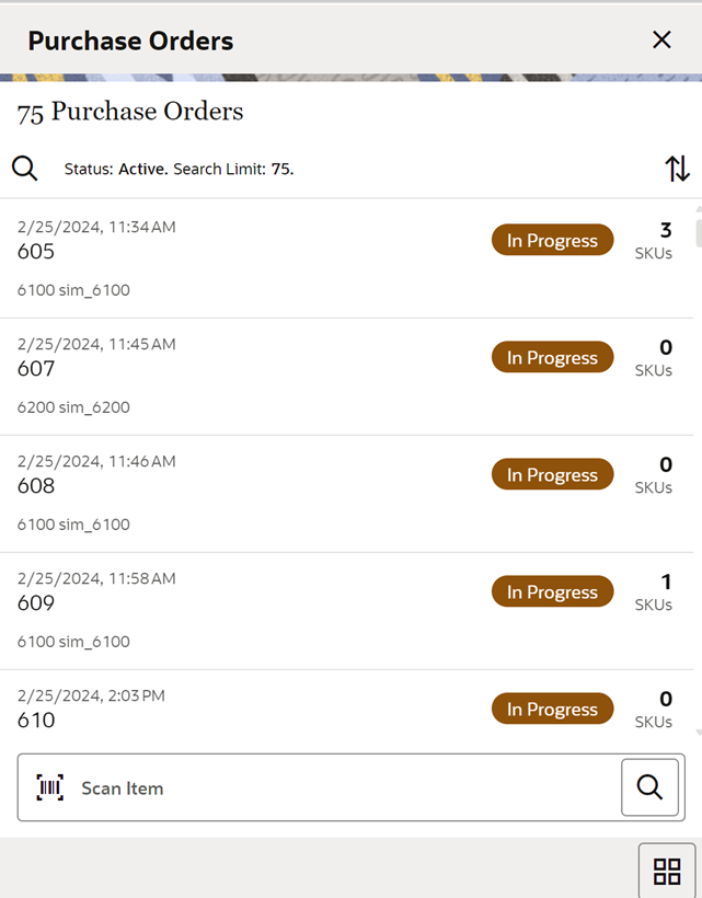

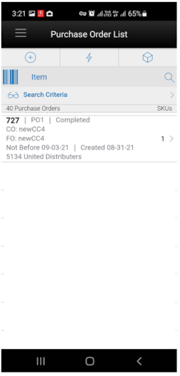

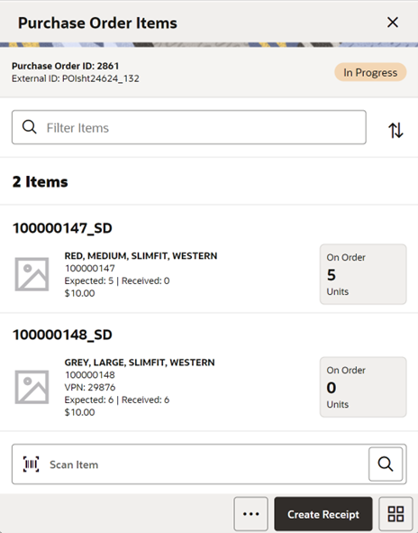

The Purchase Order List screen that appears after selecting Purchase Order allows you to view the purchase order detail and create a receipt against a PO.

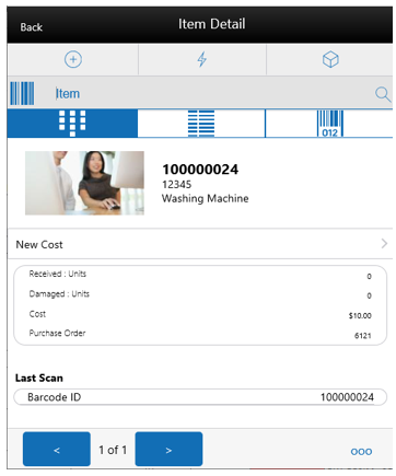

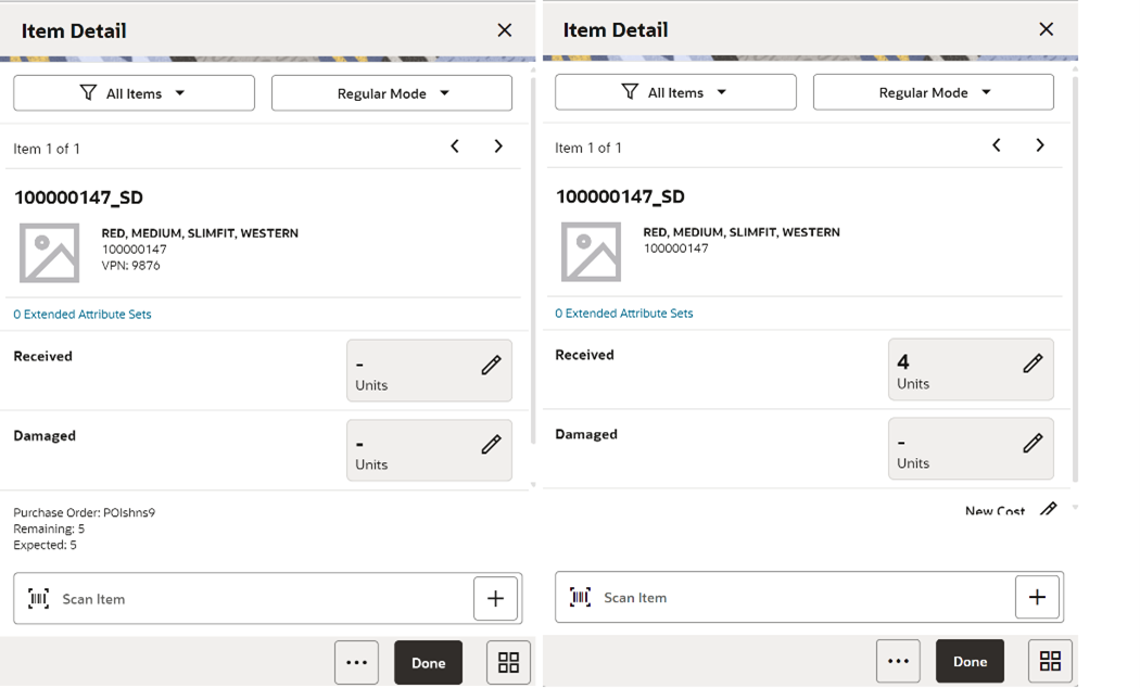

When creating a receipt, the system takes you to the Receiving Item Detail screen and follows the same flow as described above.

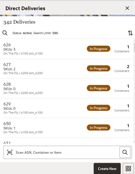

DSD Receiving List
Figure 6-2 DSD RCV List
The DSD Receiving List screen is accessed when you click on DSD Receiving from the Shipping and Receiving menu.
The DSD Receiving List by default shows all the active deliveries that are In-Progress and New for you to do the detailed receiving. It includes all types of deliveries. If the supplier has sent an ASN, it is uploaded and listed here with New status. You can select a delivery and do the detailed receiving. If the store has received a delivery via DEX/Nex service, it will be listed here and you can select to do the detailed receiving. If you have started the delivery process, it shows the delivery with the In-Progress status. You can select the In-Progress deliveries to continue the receiving. You can also select the completed deliveries to do the adjustment.
The deliveries created in the mobile application are shown with the type On the Fly.
The deliveries that have ASN from the source are shown with the type ASN.
The deliveries that are PO based and no ASN are shown with the type PO.
The deliveries that are of DEX/Nex based are shown with the type DEX/Nex.
DSD Receipts that are affiliated with a customer order will be indicated with the text 'CO' at the receipt level on this screen.
From the DSD Receiving List window, you can do the following:
Select the search criteria option which is shown with the pair of eye glasses to filter the list based on the given criteria. Selecting the search criteria option takes you to the Search Criteria screen which is described below.
Select Create Receipt from the footer menu to create a delivery without any PO (on the fly). Upon selecting this option, you go to the DSD Receiving Containers screen.
Select the delivery from the list and perform detailed receiving or edit the delivery. Upon selecting the delivery record from the list, takes you to the DSD Receiving Containers screen to access the existing delivery.

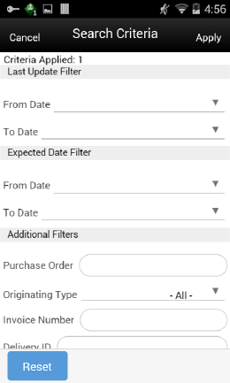

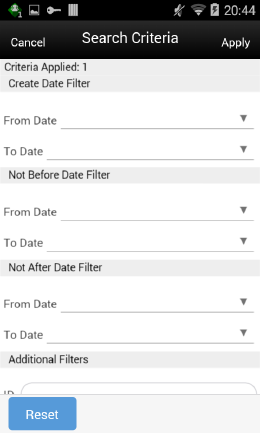

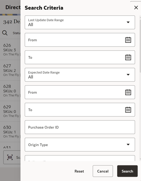

DSD Receiving List Search Criteria
Figure 6-3 DSD Receiving List Search Criteria Screen

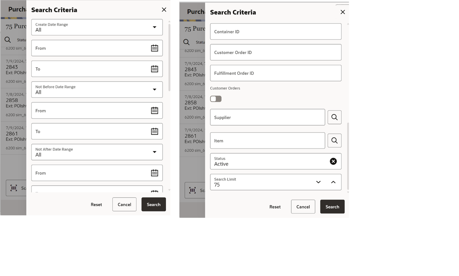

The DSD Receiving List Search Criteria screen is accessed by selecting the search criteria option with the pair of eye glasses from the DSD Receiving List screen (DSD Rcv List). By default, the DSD Receiving List screen lists the active deliveries; you can use this screen to search for deliveries on various other criteria. After applying the filter, you are returned to the DSD Receiving List screen with the deliveries displayed based on the entered criteria. You are able to filter on DSD Receipts that are for customer orders as well as search for receipts that are for a specific customer order or fulfillment orders. DSDs can also be searched based on Fiscal Doc ID/E-way Bill ID.
The originating type includes ASN, On the Fly, DEX/Nex and PO.
Select the Include Item Packs check box which is enabled only if the item is entered, to search for deliveries that include the pack item of the entered item.
Use the Reset button on this screen to reset all the filtering criteria to default values.

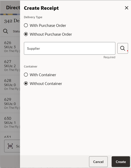

Creating a New DSD Receipt

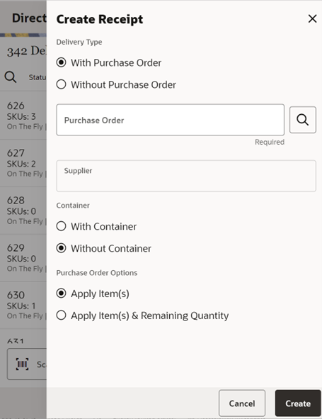

You can create a new direct delivery on the fly without any ASN or PO by selecting Create Receipt from the DSD Receiving List screen. The system displays the Supplier Lookup screen to search the supplier. Select to create the delivery.

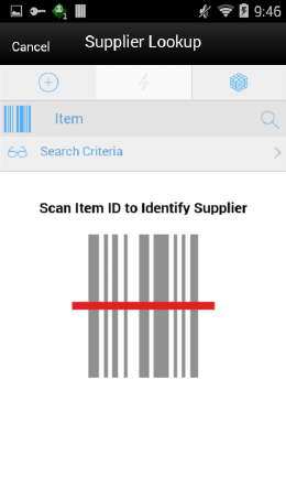

Figure 6-4 Supplier Lookup
This Supplier Lookup screen appears when Create Receipt is selected on the DSD Receiving List screen to create an on the fly receipt that does not have a PO in the system.
You can identify the supplier by entering or scanning the item id or select the search criteria option to filter the supplier based on the entered criteria.
Based on the item id or on the values entered in the search criteria, the supplier(s) are listed and allowed to select a supplier who delivered.
After selecting the supplier, the system takes you to the DSD Receiving Containers screen to create new containers and to perform detailed item level receiving.
The selected supplier must be allowed to Create New Purchase Orders or the Ignore the Supplier DSD indicator to create a PO on the fly parameter has to be set to Yes to receive a delivery without a PO from that supplier.

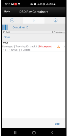

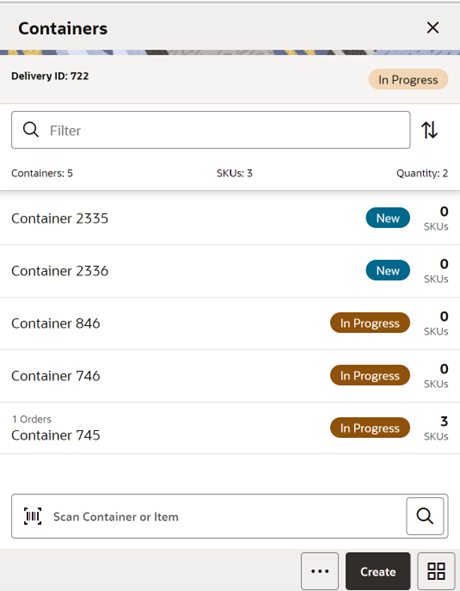

Figure 6-5 DSD Receiving Containers
You can see the DSD Receiving Containers (DSD Rcv Containers) screen for all type of deliveries. It appears under the following conditions:
When you select the delivery from the DSD Receiving List screen

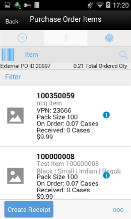

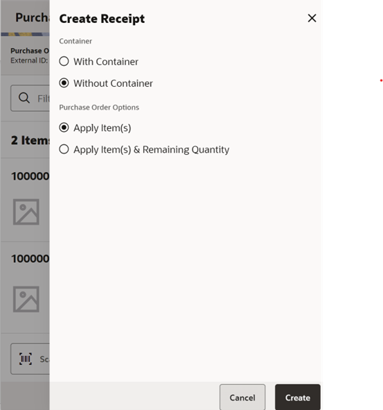

When you select Create Receipt from the Purchase Order Items screen
After selecting the supplier, when you select Create Receipt from the DSD Receiving List to create an on the fly delivery
If you are receiving a delivery with an ASN type of delivery, it shows the containers. Select the container to go to the Container Items screen to do the detailed item level receiving. You can also create a new container using Create Container which takes you to the Container Items screen to receive unexpected containers or when adding a container for a delivery without ASN.
The Create option is only available if you have permission for the New and In-progress deliveries.
You can also optionally scan or enter the container id to do the detailed item level receiving for that container.
Tap on the filter field and perform text based searches on the containers to refine the search on what is listed.
The list will be empty with zero containers initially, in case you are creating a new receipt without a PO or with a PO and no ASN. Select Create Container in that case to start the receiving process.
On this screen, you can also perform other operations by selecting the respective option from the footer menu which can be accessed by selecting the ellipsis (…) from the lower right hand corner of the screen.

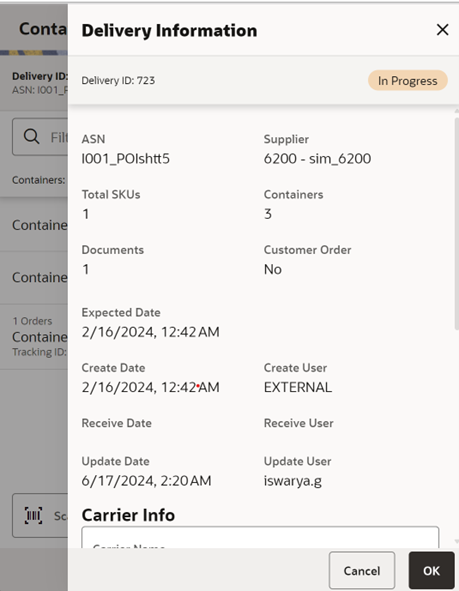

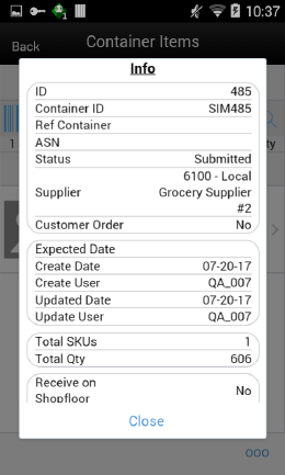

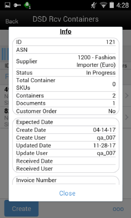

Info: Select the info option to view the invoice particulars and delivery related information. See DSD Receiving Container Info.

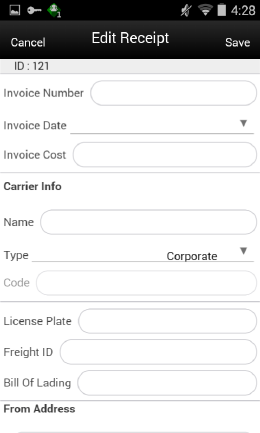

Edit Receipt: This menu option allows you to enter the receipt information such as carrier and invoice details. When selected navigates to the Edit Receipt screen. This menu option is available only for the deliveries in New or In-Progress status.

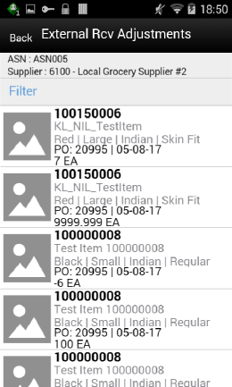

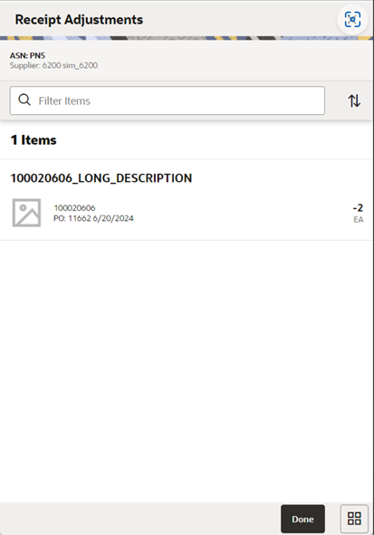

Ext. Adjustments: Select this menu to view any adjustments done by the external system for the delivery. See External Receiver Adjustments.

List header fields on this screen are as follows:
| Field | Description |
Receipt ID |
Unique ID generated internally by the system. |
X Containers |
X is the number of active containers currently shown on the list. |
Detail fields on this screen are as follows:
ID |
Unique container ID created by the system internally. |
Status |
Current status of the container.
Discrepant |
For containers in statuses 'Received' or 'Damaged', if they are 'discrepant', a label called 'Discrepant' will be displayed in red color if the received quantity does not match the expected. |
Customer Order |
The DSD Receiving Containers has a customer order field at the container line level to indicate if the container is for a customer order. If all items in the container are for a customer order, it will be displayed as 'CO'. If no items in the container are for a customer order, it will be blank. Lastly, if some items are for a customer order and some are not, it will be shown as 'CO Mix.' |
Container ID |
Container ID that came in ASN from the external vendor system. |
Number(X) of SKUs |
Number of SKUs present in the container. |
Number(X) of Orders |
Total number of purchase orders the container is associated to. |
Tracking ID |
Tracking Id displayed if available. |

DSD Receiving Info
Figure 6-6 Receiving Info Screen
This screen is accessed from the DSD Receiving Containers screen when you select the Info option from the footer menu.
This screen provides the read only information such as ID which is internally created in the system, ASN, supplier, number of containers, status, create date, expected date, invoice particulars, carrier particulars, user details, custom flexible attributes if any, and so on. It may also include a field called 'Fiscal Doc ID'. This field would be a placeholder for the government reference ID/E-way Bill ID for the delivery, if available.

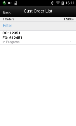

Customer Orders
Figure 6-7 Customer Orders Screen
This screen appears when you select the Customer Orders footer menu option from the DSD Receiving Containers screen. It will display the customer order and fulfillment order IDs, along with the container ID, status, total number of orders and total SKUs. If there are no customer orders associated, it will display an error upon selecting the option. This menu option is available only for ASN and PO based deliveries regardless of delivery status and not for on the fly deliveries.
Edit Receipt
Figure 6-8 Edit Receipt
This screen is used to capture the invoice and carrier particulars of the delivery.
This screen is accessed by selecting Edit Receipt from the footer menu on DSD Receiving Containers screen by selecting the ellipsis (…) on the right hand side lower corner.
Invoice Number |
This field is to capture the supplier invoice number of the delivery received. This field will display depending on the configuration. |
Invoice Date |
To capture the invoice date. This field will display depending on the configuration. |
Invoice Cost |
This field is used to enter the invoice cost. This field will display depending on the configuration. |
Carrier Info |
Name |
This field holds the name of the carrier that delivers the products. This is a text entry field. |
Type |
This field holds the type of carrier, whether it is Corporate or Third Party. This is a drop-down list. |
Code |
This field holds the Standard Carrier Alpha Code if the carrier type is Third Party. This field is only available when Third Party is selected. This is a text field. |
License Plate |
This field holds the license plate from the Carrier's delivery vehicle. This is a text field. |
From Address |
This field holds the address where the delivery came from. This field is only available when Third Party is selected. This is a text field. |
Freight ID |
This field holds the industry standard freight codes. This is a text field. |
Bill of Lading |
This field holds the bill of lading identification number and will default if included on the ASN. This is a text field. |
Figure 6-10 External Rcv Adjustments Screen
You can access this screen from the DSD Receiving Containers screen by selecting the Ext. Adjustments footer menu option. This read-only screen displays the ASN and supplier information at the header level and at detail level it displays Purchase Order Number, Date, Item, Description, adjusted quantity and its UOM for the external receiver adjustments that exists for the delivery. You can only access this screen when there are any adjustments created for the delivery from the external system. Store users internally adjusted deliveries in the system are not shown here.

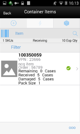

Container Items
Figure 6-11 Container Items Screen
This screen is accessed when you select Create Container or selecting an existing container on the DSD Receiving Containers screen. This is the screen for detailed item level receiving irrespective of the type of deliveries.
You must have proper permissions assigned to access this screen for both creating a new container and editing an existing container.
This screen displays the list of items that are in the container and details for a container on an ASN, or on the fly delivery. All this information is initially from the supplier ASN with the exception of the received and damaged cases. For a new based delivery, the items from the container are pre-loaded on the container items screen from the source. You can add items to the container if permissions are granted for over receiving and adding items. The user will navigate to the Item Detail screen for the item scanned. If the item scanned is a UIN item, the user will navigate to the UIN tab within the Item Detail screen.
For ASN based deliveries, if the item added exists in more than one purchase order and if you have not set any PO for receiving, the system prompts you to select the PO to assign to the item. Use the Select Purchase Order screen by tapping the info bar or Select PO footer menu option to select the PO and add items from that PO.
For a new container created for the on the fly delivery/DEX/Nex, enter/scan the items to receive.
If the user scans a VPN, a validation is done to verify that the VPN scanned belongs to the supplier associated to the delivery.
For a new container created for a PO based but no ASN, use the Select Purchase Order screen by tapping the info bar or Select PO from the footer menu and add the items and also populate the remaining quantity optionally.
Footer Menu
Info: Select this option to access the DSD Receiving Info screen to capture the container information.
Notes: Use this option to enter any notes for the delivery.
Default Regular Qty: Default the expected quantity to the received quantity field. This menu option is only available when the container is in New or In-Progress status and you have the proper permissions.
If the expected quantity is zero (in the case of adding an unexpected item), the received quantity is updated to zero.
If the delivery is flagged for quality control, you cannot default the quantity.
Select PO: Select the Purchase Order for an ASN based delivery.
Clear Qty: Clears the received quantity and damaged quantity fields for all items. This menu option is only available when the container is in New or In-Progress status.
Damage Mode: Scan/enter items and update the Damage Qty field. Once selected, the list header bar is updated to 'Damages' and any item entered or scanned will update the damages quantity. This menu option is only available when all of the following conditions are met:
The Container status is New or In-Progress.
This menu option will display when you are in Regular Mode.
You have the proper permissions.
Regular Mode: This menu option will allow you to switch to scan/enter items and update the Received Qty field. Once selected, the list header bar is updated to 'Receiving' and any item entered or scanned will update the receiving quantity. This menu option will only display when all of the following conditions are met:
When the screen is set to Receiving Damages.
Edit Container: Used to enter container information.
Adjust: This option on the DSD Receiving Container Items screen allows the received container to be reopened for receiving. The system allows you to add items, delete items, modify the quantity, save, or confirm the delivery. All options are available as if the container was never received.
The period at which you are allowed to adjust the deliveries from the time the receipt is confirmed is based on the parameter and also you should also have security permissions to adjust the container. Once the container is moved back to In-Progress, you can work on it as if it was never received.
It is not allowed to move a container back to In-Progress if UINs that were in the container have been processed in another transaction.
Edit CFAs: This menu option allows you to capture values for the CFAs that are set up for the DSD container.
Damage Remaining Qty: This menu option will allow you to update the Damaged Qty for all items in the container where Expected - Received Qty is greater than zero.
If you have not received any items in the container, all items in the container are marked as damaged.
If you have received some items and the Expected - Received Qty is greater than zero, the Damaged Qty field is updated with the remaining quantity.
This menu option is only available when the container status is in New or In-Progress.
Display Only Discrepancies: This menu option will allow you to display only items with a Received + Damaged Qty which does not equal the expected quantity.
This menu option is only available when the screen is in a 'Display All Items' mode.
The discrepancy check will apply to all items, even those with an expected quantity of zero. When an item is added to a container the Expected Qty will be zero. The unexpected items will always be discrepant.
Display All Items: This menu option will allow you to reset to display all items after selecting to Display Only Discrepancies. This menu option is not available for on the fly deliveries.
Confirm: Used to confirm the container. See Delivery Rejections and Supplier Discrepancy Check for additional information.
Save: Saves the container with current changes.
Delete: Deletes the container.
Back: Used to return to the previous screen.
Cancel: Used to cancel any changes and go back to the Containers screen.
Print: Opens the print dialog to print the report.
Print Tickets: Opens the Print Tickets dialog to print the tickets or labels for the current container items. This is described in common usage document with more details.
Figure 6-12 Item Detail Screen
The Item Detail screen is accessed from the Container Items screen when scanning an item that is already in the container or adding a new item to the container.
Scanning or entering an item on this screen in the scan bar updates the quantity per the scan mode and refreshes the Item Detail screen for the item and quantity scanned. If the item scanned is a UIN item, the user will directly navigate to the UIN tab within the Item Detail screen.
You can edit the received or damaged quantity if it is in edit mode and if you have permissions.
The item header portion displays the item information including the image if configured to show. The bottom portion which is detail allows you to edit the quantities if the state of the container allows and you have permissions. The system displays the following fields on the bottom portion.
Received |
This field shows the UOM based on the UOM mode. The value on this field is the received quantity. When this is editable, you can enter the quantity via a popup. User needs permissions to edit the quantity |
Damaged |
This field shows the UOM based on the UOM mode. The value on this field is the damaged quantity. When this is editable, you can enter the quantity via a popup. User needs permissions to edit the quantity. |
Pack Size |
This is the pack size of the item. This field is editable. |
New Cost |
This field is populated with the item supplier cost in case of on the fly deliveries. This field is displayed and editable for on the fly. You can enter the cost of the item at which the item is received from the supplier. This field is displayed only if it is configured to show. In general, if a PO was created by the merchandizing system, the system does not allow the store user to edit the cost as it was defined by the external system. It will also not communicate any cost information to the merchandising system. If the delivery is on the fly, the system will use the cost based on item supplier country information. It is possible with the right permissions to edit this cost and the cost can be communicated to the external system |
Original Cost |
This field is a read only field and only for PO and ASN based deliveries |
Purchase Order |
PO assigned to the current item. |
Expected |
Expected quantity to be delivered from the ASN/PO. |
Remaining |
Balance quantity to be delivered in the order. |
Last Scan |
The details of the last scanned barcode. |
You can navigate through the existing items on the container using the two arrows on the bottom. In between the arrows the system displays the current item number position out of the total number of items.
Perform further operations by selecting the respective footer menu options.
Damage Mode - This menu option will allow you to scan/enter items and update the Damage Qty.
The value selected will update any item entered or scanned after changing.
The receiving mode will stay the same until it is changed by selecting the footer menu again.
When you navigate to this screen from the Container Items screen, the receiving mode will be the same on this screen.
If the user changes the Receiving mode from this screen and navigates to the Container Items screen, the receiving mode will also be changed on the Container Items screen.
The user will remain on this screen.
Regular Mode - This menu option will allow the user to scan/enter items and update the Received Qty.
The value selected will update any item entered, scanned or tapped after changing.
When the user navigates to this screen from the Container Items screen, the receiving mode will be the same on this screen.
Figure 6-13 DSD Receiving Container Info Screen
This screen is accessed from the Container Items screen when you select the Info option from the footer menu. This is a read-only screen and provides the following information about the container.
ID |
Container ID |
Reference Container |
This field is used to identify a misdirected container. |
ASN |
Advance shipment number of this delivery. |
Status |
Current status of the container |
Supplier |
This field shows the supplier id and the name of the supplier who delivered. |
Customer Order |
This indicates whether customer is associated. If a customer order is associated with all the items in the container, it will display <Yes> and if the container contains items with and without customer associated, it will display <Mix>. If there is no CO, it will display <No |
Expected Date |
Original expected date of the delivery. |
Create Date |
Date of creation of the container in the system. |
Create User |
User who created the container. |
Updated Date |
The date on which the container was last update. |
Updated User |
Person who updated the container last. |
Received Date |
The date on which the container was received. Shown only after if it is received. |
Received User |
Person who received the container. Shown only if it is received. |
Total SKUs |
Total number of items. |
Ordered Qty |
This field displays the total remaining ordered quantity. This appears only for the PO based delivery. |
Expected Qty |
This field displays the total expected quantity. Unlike the Container Items screen at the individual item level this is not depending on the permission. This appears only for ASN based delivery. |
Total Qty |
This field displays the total received quantity including the damaged. |
Receive on Shop floor <Yes/No> |
This field displays Yes or No, to indicate whether the receiving happens at the shop floor. |
Damage Reason |
This field displays the damage reason if captured. |
SSCC |
This field displays the GS1 barcode container id if one is entered on the DSD Receiving Edit Container screen. |
Tracking ID |
This field displays the tracking id assigned to the container if one is entered on the DSD Receiving Edit Container screen. |
CFAs |
This screen will show the CFAs captured. |

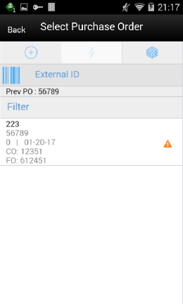

Selecting a Purchase Order for a PO Based Delivery
Figure 6-15 Select Purchase Order Screen
This screen can be reached through the Container Items screen by tapping the document bar or by selecting Select PO in the footer menu. This screen will show the purchase orders and, when you select the purchase order, you are prompted with a popup with the following options.
Use Purchase Order: This menu option will set the PO document referenced in the container to the user selection. Any items added will be updated to the selected document.
There will be validation to see if the item exists on the PO document, but the items are not automatically added to the container.
This will be the option by default selected.
Apply Item(s): This menu option will add all items from the selected PO document to the container without applying the remaining quantity to the received quantity and the system will default the received quantity to zero.
Add Item(s) & Remaining Qty: This menu option will add all items along with their corresponding remaining quantity to the received quantity in the container.
Purchase Order List
Figure 6-16 Purchase Order List Screen
This screen is accessed when you select Purchase Order from the Shipping / Receiving drawer menu.
The Purchase Order List is a screen that allows you to view purchase orders placed to the suppliers to supply goods for your store. The default is to display the list of all active status that is, Approved and In-Progress purchase orders. Use the search criteria screen to filter out the records.
This screen provides the following header level information about the Purchase Order including the ID which is system internally generated, External ID, Supplier, Not Before Date if available, Create date of the PO, current status of the PO, total number of SKUs, and customer order id and fulfillment order id if customer order is associated with the PO.
On the List header, it shows the total number of purchase orders listed.
From the Purchase Order List screen, select a purchase order to go the Purchase Order Items screen to view the item details for the PO.
Purchase orders created internally in the system for on the fly deliveries are also shown in this list.
Purchase Order List Search Criteria
Figure 6-17 Purchase Order List Search Criteria Screen
This is the Purchase Order List Search Criteria screen. It is accessed by tapping the search criteria option shown with the pair of glasses from the Purchase Order List screen. You can filter the purchase orders with a variety of search criteria. After applying the criteria, you are returned to the Purchase Order List screen with the purchase orders displayed per the entered criteria.
Figure 6-18 Purchase Order Items Screen
The Purchase Order Items screen is accessed when you select a purchase order record from the Purchase Order List screen.
The Purchase Order Items screen displays all of the purchase order header and item details for the selected purchase order. This screen is view-only for informational purposes.
The header contains the header information including: Supplier, system created unique Id, External Purchase Order ID, Customer Order (if applicable), Fulfillment Order (if applicable), current status of the PO, Create Date, Not before date, Not after Date, and UOM. You can select the UOM from the drop-down to view the items based on the selected UOM.
The ordered quantity is the total quantity remaining in the order for all the items, the expected quantity is the total ordered quantity in the order for all items and the received quantity is the total of how many quantities quantity received.
The detail level has the item, description, Pack Size, as well as the On Order, Expected and Received.
You can create a receipt from the Purchase Order Items screen by selecting Create Receipt which will navigate to the DSD Receiving Containers screen with the existing purchase order applied to the delivery. You can create container and start the receiving process as previously described.
On this screen, you can perform other operations by selecting the respective option from the footer menu which can be accessed by selecting the ellipsis (…) from the lower right hand corner of the screen.
Footer Menu
Info: Views the PO details which includes the CFAs if available.

Screen Flow
Figure 6-19 Direct Store Delivery JET Mobile Screen Flow
You can access DSD Receiving and Purchase Order options from the Shipping and Receiving menu, Open Transactions or Quick Actions menus. The Direct Deliveries screen that appears after selecting DSD Receiving will by default list all the active deliveries. The active deliveries include the deliveries created on the fly by the store users, ASNs that came from the suppliers and Dex-Nex based deliveries that are not yet completed.
The Create New option will take you to the Create Receipt screen, where you can provide various criteria and create an on-the-fly receipts.
At this point the user has the option to select with or without containers. If they select a delivery that is with containers, they are navigated to the Containers screen that list the containers in the delivery.
If they select a delivery that is without container, they are navigated to the Delivery Items screen.
Through the footer menu, the user has access to additional options from the Containers screen such as Delivery Info, Receipt Adjustments, Print, Notes, Default Quantity to perform various individual functions.
On the Container Items screen, they can select the footer menu for various options such as Info, Default Regular Quantity, Clear Quantities, Adjust and so on to perform various individual functions.
On the Delivery Items footer menu, they will find both the Delivery Info and Receipt Info to view the header level and the receipt level information.
In the Purchase Orders screen that appears after selecting Purchase Order menu , the user can view the purchase order details and create a receipt against a PO.

Direct Deliveries
Figure 6-20 Direct Deliveries Screen
The Direct Deliveries screen is accessed when you select DSD Receiving from the Shipping and Receiving menu or Quick Actions.
The system by default shows all the active deliveries for which you can enter the detailed receiving. This includes all types of deliveries. If the supplier has sent an ASN, it is uploaded and listed here. You can select a delivery and enter the detailed receiving. If the store has received a delivery via DEX/Nex service, it will be listed here, and you can select it to enter the detailed receiving. If you have started the delivery process, it shows the delivery with In Progress status. You can select the In Progress deliveries to continue the receiving process. You can also select the completed deliveries to perform adjustments.
The deliveries that are PO based and no ASN are shown with the type of PO.
From the Direct Deliveries screen, you can do the following:
Select the Search Criteria option, which is shown with the magnifying glass, to filter the list based on the given criteria. Selecting the Search Criteria option takes you to the Search Criteria screen, which is described in the Direct Deliveries Search Criteria topic.
Select the Create New footer button to create an on-the-fly delivery. Upon selecting this option, you are taken to the Create Receipt screen to provide the details to create a receipt.
Select the delivery from the list and perform detailed receiving or edit the delivery. Upon selecting the delivery record from the list, the system takes you to the Containers screen if the delivery is created with containers. If no,t it takes you to the Delivery Items screen
On this screen, you can scan and ASN ID, Container ID or Item to search a delivery .
Figure 6-21 Direct Deliveries Search Criteria Screen
The Direct Deliveries Search Criteria screen is accessed by selecting the Search Criteria option from the Direct Deliveries screen. By default, the system lists the active deliveries. You can use this screen to search for deliveries on various other criteria. After applying the filter, you are returned to the Direct Deliveries screen with the deliveries displayed based on the entered criteria. You can filter on DSD Receipts that are for customer orders as well as search for receipts that are for a specific customer orders or fulfillment orders. DSDs can also be searched based on Fiscal Doc ID/E-way Bill ID.
Select the Include Item Packs switch option, which is enabled only if the item is entered, to search for deliveries that include the pack item of the entered item.
Figure 6-22 Create Receipt Screen (Without Purchase Order)
Figure 6-23 Create Receipt Screen (With Purchase Order)
You can create a new direct delivery receipt on the fly by selecting the Create New option on the Direct Deliveries screen.
For on-the-fly receipts without an ASN, you can create a delivery with or without a purchase order (PO). When creating a receipt, you can select whether to create the delivery with containers or without containers.
You can use the supplier lookup to search for the supplier.
In the case of a receipt with a PO, you can searchfor the PO. Upon selecting the search option, the system will take you to the Purchase Orders screen that lists the active Purchase orders. You can refine search and select the PO to apply for the delivery.
Once you have selected the PO, you can select to apply to items or apply to items and remaining quantity.
When you apply to items alone, the system will associate the delivery and apply the items that are in the selected Purchase order by defaulting the received quantity to zero and allowing the user to override with the actual received quantity.
When you apply to items and remaining quantity, the system references the selected PO to the delivery, adds all items that have a remaining quantity >0 and populate the received quantity with the PO remaining quantity.
After providing all the criteria to create the delivery, if you select the Create option, the system creates a delivery and navigates to Delivery Items if it is without containers, or to Container Items if it is with containers.
New PO deliveries can also be created with or without container. SIOCS can be configured to provide this option to a user, have it pre-defaulted, or hide it. This allows the retailer to configure the system based on needs, since many supplier DSD deliveries on the fly happen without container delivery. Keep in mind that based on other settings like single delivery per PO, not having containers can prevent multiple users from receiving against the same PO.
Delivery without container will still create a container in the backend, however the user will not interact directly with a container screen or have to select a container.Containers
Figure 6-24 Containers Screen
The Containers screen appears when you select a delivery from the Direct Deliveries screen. This screen appears only when you select a delivery that has one or more containers and is not a delivery without container.
If you are receiving a delivery with an ASN type of delivery, it shows the containers. Select the container to go to the Container Items screen to do the detailed item level receiving. You can also create a new container using Create Container which takes you to the Container Items screen to receive unexpected containers.
Tap on the filter field and perform text-based searches on the containers to refine the search on what is listed.
On this screen, you can also perform other operations by selecting the respective option from the footer menu which can be accessed by selecting the ellipsis (...) from the bottom of the screen.
Footer Menu
Create: This menu is the same as Create button for creating a new container.
Info: This screen displays delivery-related information and allows you to view and invoice particulars, carrier, and CFAs. See Delivery Info for more details.
Default Quantity: The default quantity option lets you default the remaining expected quantity to the received quantity in the containers. The system will not default the quantities for the items that are processed earlier, and contains a value including zero. This option is not available for the On-the-Fly delivery. You can perform this process from this menu for all the containers in the current delivery with the New and In-Progress status. For specific containers, go into the detail,, Container Items screen.
If the delivery is flagged for quality control, you cannot default the quantity and would be prompted with a message.
Default Qty sets the status of the integrated UINs to’In Receiving’ for the delivery.
In addition, a validation check is performed to ensure the expected quantity matches the serial numbers for items. If that is not the case, you will not be allowed to receive all items. If there are no UINs available for a UIN required item, the quantity is set to zero.
Confirm: Upon selecting this option, the system will confirm the delivery.
This option can be accessed if you have permission, and the delivery is in’ New’ or ‘In Progress’ status.
When you confirm the delivery, the system performs various processes before it confirms the delivery.
The system will first check whether there are any containers in the delivery and if there is no container, the system prompts with an error message.
The system checks whether the receipt is empty, meaning there are no containers with received or damaged quantities. If it is an empty receipt, the system checks whether you are allowed designate it as an empty receipt, and if allowed, it confirms the delivery and puts all the containers in missing status.
The system perforrns the validation on ASN over receiving and PO over receiving and displays an error if it meets the condition.
Additionally, the system checks for the supplier discrepancies. See Delivery Rejections and Supplier Discrepancy Check section for more details.
Print: Upon selecting this menu, the system opens the print dialog to print the report.
Reject: Select the Reject menu if the delivery has to be rejected. This will reject the delivery and move all the containers to canceled status and move the status of the delivery to Rejected. Rejection of a delivery is possible only for the deliveries that are in In-Progress or New status and it will not allow rejecting if there are any received or damaged containers in the delivery. This will also remove any UINs present in the delivery.
Delete: Select the Delete menu if the delivery has to be deleted. This will cancel the delivery and all the containers inside the delivery.
Receipt Adjustments: Select this menu to view any adjustments done by the external system for the delivery. See Receipt Adjustments.
Notes: Use this option to access the Notes dialog to enter any notes for the delivery.
On the title bar, you can see the Delivery ID, ASN Id if ASN based delivery and status of the delivery.
At the header level, the system displays the total number of containers, total SKUs present in the delivery and the total quantity in the delivery.
Table 6-2 Detail Fields

Delivery Info
Figure 6-25 Delivery Info Screen
This screen is accessed from the Containers screen when you select the Info option from the footer menu.
This screen provides the delivery information and allows you to capture the invoice particulars, carrier details, license plate details and custom flexible attributes if any.
On this screen, you can find information such as Delivery ID, which is internally created in the system, ASN, supplier, number of containers, status, create date, expected date, captured invoice particulars, carrier particulars, license plate, user details, custom flexible attributes if any, and so on. It may also include a field called 'Fiscal Doc ID'. This field would be a placeholder for the government reference ID/E-way Bill ID for the delivery, if available.
If the delivery is associated to any customer order, you can select the View Details link on the customer order field which will take you to the Customer Orders screen to view the details.
The table below defines the fields that are relevant to invoice and carrier particulars of the delivery.
Table 6-3 Delivery Info Fields
Field |
Description |
Invoice Number |
The supplier invoice number of the delivery received. This field will display depending on the configuration. |
Invoice Date |
The invoice date. This field will display depending on the configuration |
Invoice Cost |
This field is used to enter the invoice cost. This field will display depending on the configuration. It is only for information purpose and not integrated. |
Carrier Info |
Name |
The name of the carrier that delivers the products. This is a text entry field. |
Type |
The type of carrier, Corporate or Third Party. This is a drop-down list. |
Code |
The Standard Carrier Alpha Code if the carrier type is Third Party. This field is only available when Third Party is selected. This is a text field. |
License Plate |
The license plate from the Carrier's delivery vehicle. This is a text field. |
From Address |
The address from which the delivery originated. This field is only available when Third Party is selected. This is a text field |
Freight ID |
The industry standard freight codes. This is a text field. |
Bill of Lading |
This screen displays the list of CFAs (custom flexible attributes) that have been set up for the DSD -On the Fly, DSD -PO, DSD PO & ASN and DSD Container in the system The user can enter values for them here.

Figure 6-26 Customer Orders Screen
This screen appears when you select the View Details on the customer order field from the Delivery/Receipt and Container Information screens. It will display the customer order and fulfillment order IDs, along with the container ID, status, total number of orders and total SKUs. This screen is available only for ASN and PO based deliveries regardless of delivery status and not for on-the-fly deliveries.
Receipt Adjustments
Figure 6-27 Receipt Adjustments Screen
You can access this screen from the Containers screen by selecting the Receipt Adjustments footer menu option. This read-only screen displays the ASN and supplier information at the header level and at detail level it displays Purchase Order Number, Date, Item, Description, adjusted quantity and its UOM for the external receiver adjustments that exists for the delivery. You can only access this screen when there are any adjustments created for the delivery from the external system. Store users internally adjusted deliveries in the system are not shown here.
Container/Delivery Items
Figure 6-28 Container/Delivery Items Screen
This section describes the two screens that provide a list of items: Container Items and Delivery Items. For an ASN based delivery, container(s) will always be available, while for DSDs against PO or on the fly, a container could be optional.
You can navigate to this screen in multiple ways:
When you select a container from the Containers screen.
When you create a receipt using the Create Receipt screen.
When you create a new container from the Containers screen.
When a transaction is selected from the Open Transactions screen and it is without a container.
For an ASN based delivery, the items from the container are pre-loaded on the Container Items screen from the source. You can add items to the container if permissions are granted for over receiving and adding items. The user can l navigate to the Item Detail screen for the item scanned. If the item scanned is a UIN item, the user can navigate to the UIN screen within the Item Detail screen.
For ASN based deliveries, the user will need to select a PO when adding an unexpected item. Use the Select Purchase Order screen by tapping the External PO pencil to select the PO and add items from that PO.
Users can edit the quantity of the items from this screen by selecting the pencil icon or + in case of UIN items at the item level. Quantity will also be updated by the barcode qty upon entering the item or scanning the item.
If the item level quantity panel indicates a tick mark, it means the item is fully received and you will not find the pencil icon, but you can still edit the item.

Delivery Info : You will find this option to display the header level information for the non-container based deliveries. This is same as described above in the Delivery Info.
Receipt Info: You will find this option to display the receipt level which is same as container level information for the non-container-based deliveries. This is same as described in the container information section.

Container Info
Figure 6-29 Information/Receipt Information Screen
This screen is accessed from the Container Items/Delivery Items screen when you select the Info/Receipt Info option from the footer menu. This screen displays and captures the receipt/container information.
This screen lets you capture container/receipt information, such as reference container, whether the container is received at shop floor, damage reason ,and SSCC and Tracking Id of the container.
Reference Container: This field captures a reference to a container that was not intended for the current location.
Receive on Shop Floor: The default will be based on the store parameter Direct Delivery Default to Shop floor Receiving. If set to Yes, the switch will be set to receive at shop floor.
You are required to have Receive Direct Delivery on Shop floor permissions to change the value. This indicates whether the delivery will default to receive inventory on the shop floor instead of automatically receiving into the back room or delivery bay.
If this is set to receive on the shop floor, the system increments the shop floor inventory bucket instead of the backroom or delivery bay bucket. If a capacity is defined for the item and Direct Delivery Receive Item Capacity is set to Yes, the maximum shop floor quantity will equal the capacity; otherwise, the shop floor will be updated to the entire receipt amount. If the capacity is used and if the receiving quantity is excess, the balance is incremented to the delivery bay or back room depending on the Replenishment - Delivery Bay Inventory parameter.
If receiving on the shop floor is not set on the delivery, the system increments the back room or delivery bay bucket depending on the Replenishment - Delivery Bay Inventory parameter. If this parameter is on, the system will increment the delivery bay bucket instead of back room. This will increase Stock On Hand as well.
Damage Reason: Identifies the reason for damage on the container, when items in the container have been damaged during transport. This field is optional.
SSCC: This field allows you to identify a GS1 bar code used with the container. There is no validation on this field and it is optional. This is the full 18 digit number.
Tracking ID: This field allows you to type in a tracking id from the delivery service. This is a text field and is not validated. This is an optional field used to track information only.
This screen additionally displays the list of CFAs (custom flexible attributes) that have been set up for the DSD -On the Fly, DSD -PO, DSD PO & ASN and DSD Container in the system and allows you enter values for them.
The CFAs must be configured for the each type of delivery and the container for the container items. The system displays the fields based on the setup for the type of delivery. The CFAs that are set up as 'Required' must have a value entered for it before confirming. The value can be one of the following: Date, Text, Decimal, Long depending on the 'data type' set up for the CFAs, while creating them in the desktop application. Appropriate security permission is needed and the transaction must be in editable status for entering CFA values.
Figure 6-30 Item Detail Screen
The Item Detail screen is accessed from the Container Items/Delivery Items screen when scanning an item that is already in the container or adding a new item to the container.
You can edit the received or damaged quantity if it is in Edit mode and if you have permissions.
The system displays the item information including the image and allows you to capture the quantity.
The table below defines the item Detail fields:
Field |
Description |
Received |
This field shows the UOM based on the UOM mode. The value on this field is the received quantity. When this is editable, you can enter the quantity via a popup. The user needs permissions to edit the quantity. |
Damaged |
This field shows the UOM based on the UOM mode. The value on this field is the damaged quantity. When this is editable, you can enter the quantity via a popup. The user needs permissions to edit the quantity. |
Pack Size |
New Cost |
This field is populated with the item supplier cost in case of on the fly deliveries. This field is displayed and editable on the fly. You can enter the cost of the item that is received from the supplier. This field is displayed only if it is configured to do so. In general, if a PO was created by the merchandising system, the system does not allow the store user to edit the cos,t as it was defined by the external system. It will also not communicate any cost information to the merchandising system. If the delivery is on the fly, the system will use the cost based on item supplier country information. It is possible with the right permissions to edit this cost and the cost can be communicated to the external system. |
Original Cost |
This is a read only field and only for PO and ASN based deliveries. |
Purchase Order |
Expected |
Remaining |
Last Scan |
You can navigate through the existing items on the container using the two arrows on the top. On the top the system displays the current item number position out of the total number of items.
You can filter the items displayed by selecting the filter display option (drop down). The system will show the selected display option and allow you to edit the option. When you select the field, the system displays a pop up for selectingt the option. By default, the system will show all items. You are allowed to filter based on the options below:
All Items
Upon selecting this option, the system will reset any other option selected and display all the items in the container.
Damaged
Upon selecting this option, the system will filter and show only the items having damaged quantity. The list will include items containing received quantity, and discrepant items if applicable
Discrepant
Not available for on-the-fly type deliveries.
Upon selecting this option, the system will filter items and show only the items that are discrepant.
Discrepant items are determined when the Received + Damaged Quantity is not equal to the expected quantity of the item in the container.
If there are no discrepancies to display, the system will display an error message and no changes on the screen
Received
Upon selecting this option, the system will filter items and show only those that have received quantity and no damaged items. The list will include discrepant items if applicable.
Not Received
Upon selecting this option, the system will filter items and show only those that are not received. (Both Received and Damage Quantity is null).
Receiving Mode — Receiving mode is displayed on the header to indicate whether the user is Receiving good units or Damaged units. You can change the mode by selecting the drop down, which will take you to a popup to select the mode of receiving. The system sets the Receiving mode to Receiving by default when the user gets into the Container items/Delivery Items screen.
Figure 6-31 Select Purchase Order Screen
Purchase Orders
Figure 6-32 Purchase Orders Screen
This screen is accessed when you select Purchase Orders from the Shipping / Receiving drawer menu.
The Purchase Orders screen allows you to view purchase orders placed with the suppliers to supply goods for your store. The default is to display the list of all active statuses, Approved and In-Progress purchase orders. Use the search criteria screen to filter out the records.
This screen provides the following header level information about the Purchase Order including the ID that is system internally generated, External ID, Supplier, Not Before Date if available, Create date of the PO, current status of the PO, total number of SKUs, Customer Order ID and Fulfillment Order ID if the customer order is associated with the PO.
The List header shows the total number of purchase orders listed.
From the Purchase Orders screen, select a purchase order to go to the Purchase Order Items screen and view the item details for the PO.
Purchase orders created internally in the system for on-the-fly deliveries are also shown in this list.
Purchase Orders Search Criteria
Figure 6-33 Purchase Orders Search Criteria Screen
This is the Purchase Orders Search Criteria screen. It is accessed by tapping the search criteria option on the Purchase Orders screen.
You can filter the purchase orders with a variety of search criteria. After applying the criteria, you are returned to the Purchase Orders screen with the purchase orders displayed per the entered criteria.
Figure 6-34 Purchase Order Items Screen
The Purchase Order Items screen is accessed when you select a purchase order record from the Purchase Orders screen.
The Purchase Order Items screen displays all the purchase order header information and item details for the selected purchase order. This screen is view-only for informational purposes.
On this screen you can find item details such as item id, description, item image, VPN, UOM, on order quantity, expected quantity, received quantity and so on.
You can access the footer menu and select the Info option to view the details of the PO as described below.
You can create a receipt from the Purchase Order Items screen by selecting Create Receipt which will navigate you to the Create Receipt screen.
Create Receipt (Purchase Order Items)
Figure 6-35 Create Receipt — Purchase Order Items Screen
Create Receipt Details
Container
This option is displayed and editable only when the user has permission to Allow Modify Default Container Method. If the user does not have this permission, the system applies the default container method automatically.
You are allowed to select Create Receipt either With Container or Without Container.
Default : The default value set here is based on the 'Default Container Method for Direct Delivery' store parameter.
Purchase Order Options
Apply Item(s)
This option will set the PO document referenced to the delivery.
Any items added will be added/updated to the selected document.
There will be validations to see if the item exists on the PO document.
This will be the option selected by default.
This option will add all items from the selected PO document to the delivery without applying the remaining quantity to the received quantity, and the system will default the received quantity to NULL.
Apply Item(s) and Remaining QTY
This option will set the PO document referenced.
This option will add all items along with their corresponding remaining quantity to the received quantity in the delivery.
If the Remaining quantity is zero, the system will not include the items and default the quantity. However, the user can add items manually if there are any over receiving. For example, if there are 10 items, out of which 5 are fully received in this PO, the system will not load the 5 fully received items but user can manually add them.
Purchase Order Information
Figure 6-36 Purchase Order — Information Screen
This view only screen is accessed from the Info footer menu on the Purchase Order Items screen. On this screen, you can find information related to the Purchase Order.
This screen provides the following header level information about the Purchase Order: The ID which the system internally generated, External ID, Supplier, Not Before Date if available, Create date of the PO, current status of the PO, total number of SKUs and Customer Order ID and Fulfillment Order ID if the customer order is associated with the PO.
