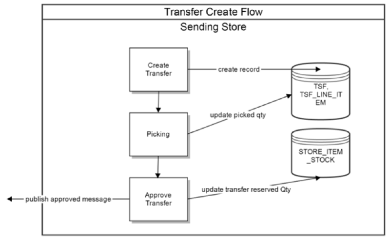

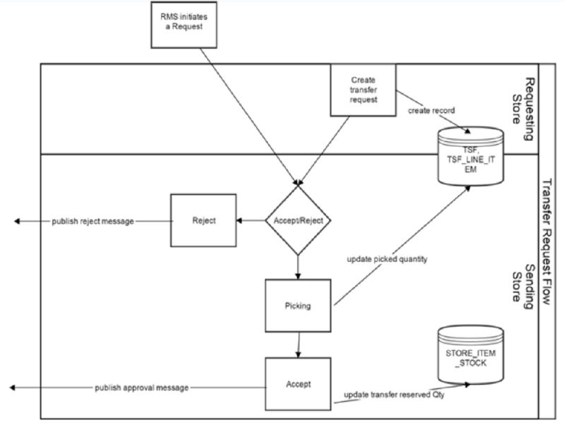

Transfer Creation
Transfer documents can be created in the following ways:
Requesting store can create a transfer request.
Sending store can initiate a transfer by creating a transfer.
Merchandising can create a transfer request.
Each transfer document will have one or more items.

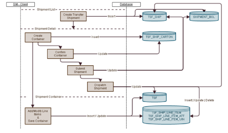

Transfer Shipment Creation
Transfer Shipment describes the containers and the items for the shipment taking place. The shipment may be for one or more transfer documents if the transfer is going to the same destination. Dispatching a shipment will update the transfer document.
The user can create a shipment without referencing existing transfers or can create a new transfer on fly (Ad hoc transfer) based on the shipment information.

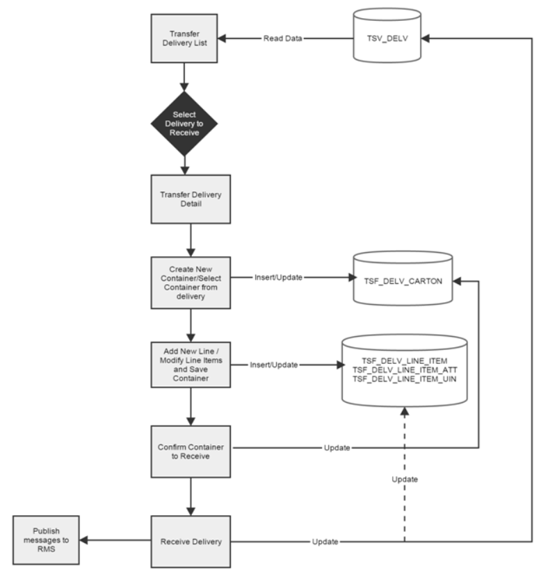

Transfer Receiving
This transaction captures a delivery that took place from a warehouse, store, or finisher to the store receiving the delivery. It describes the containers and the items of the delivery that should be received by the store. Receiving a container of the delivery will update the transfer document.
Figure 3-1 Transfer Request Flow
Figure 3-2 Transfer Create Flow
Figure 3-3 Transfer Shipment Creation Flow
Figure 3-4 Transfer Receiving Process Flow

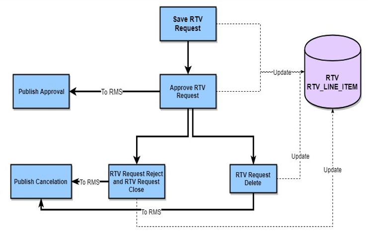

RTV Creation
RTVs can only be created by a request from MERCHANDISING:
Each vendor return will have one or more items.

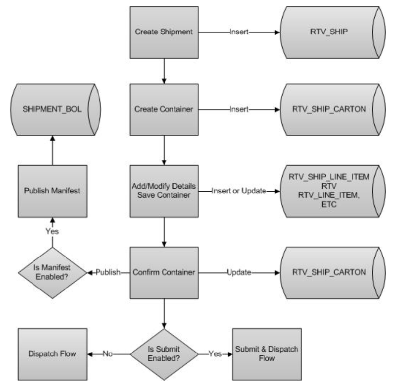

RTV Shipment
Each RTV shipment will tie back to a single vendor return document.
RTV shipment can be created in two ways:
From an externally initiated approved vendor return document.
Creation of ad hoc vendor return shipment which will create an approved vendor return on the fly.
Each vendor return shipment will have one or more containers; each container in turn will have one or more items.

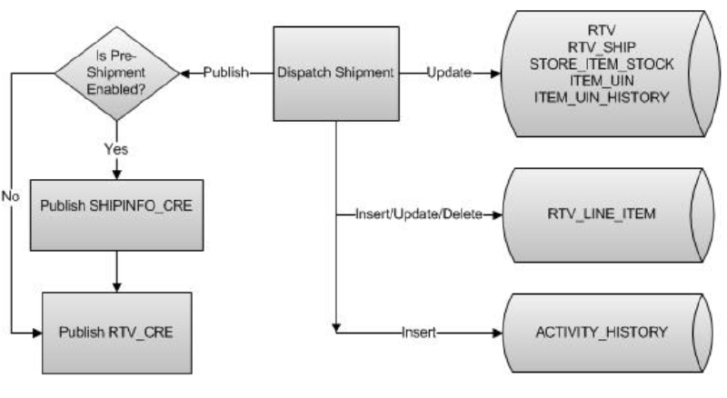

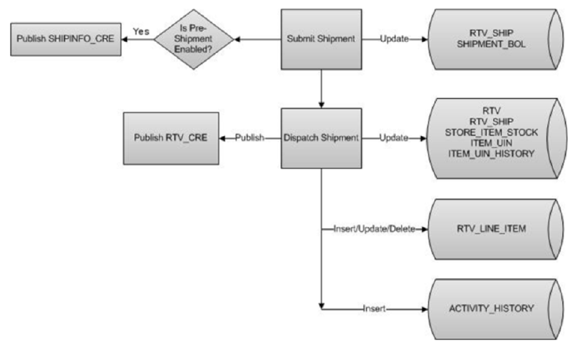

EICS may publish messages when the following happens:
RTV shipment container is updated, and saved (Return To Vendor Publish)
RTV shipment is cancelled or rejected (Return To Vendor Publish)
RTV shipment is dispatched (Return to Vendor Publish and Ship Info Desc Publish, if dispatched without submitting)
RTV shipment is submitted (Ship Info Desc Publish)
RTV shipment container is confirmed (RTV manifesting, if configured)
RTV shipment is submitted (Pre-shipment notification, if configured)
Figure 3-5 RTV Creation Flow
Figure 3-6 RTV Shipment Flow
Figure 3-7 RTV Shipment Submit and Dispatch Flow
Figure 3-8 RTV Shipment Dispatch Flow
